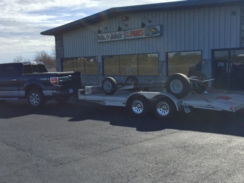

    That weekend the wife had some time off and we were going to do a road trip to look at bodies. I have to touch before I buy. My intent that weekend was to drive to BeBops in Louisiana and look at their body. Something just didn't sit right with me about them and at the last minute I contacted Ed at New Age Motorsports in Connecticut and we changed the direction we were going. After meeting Ed and Chris, and feeling totally comfortable with the quality and care of the product they made, we placed a down payment to hold our place in line and wait 8 month to get the body.

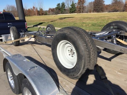

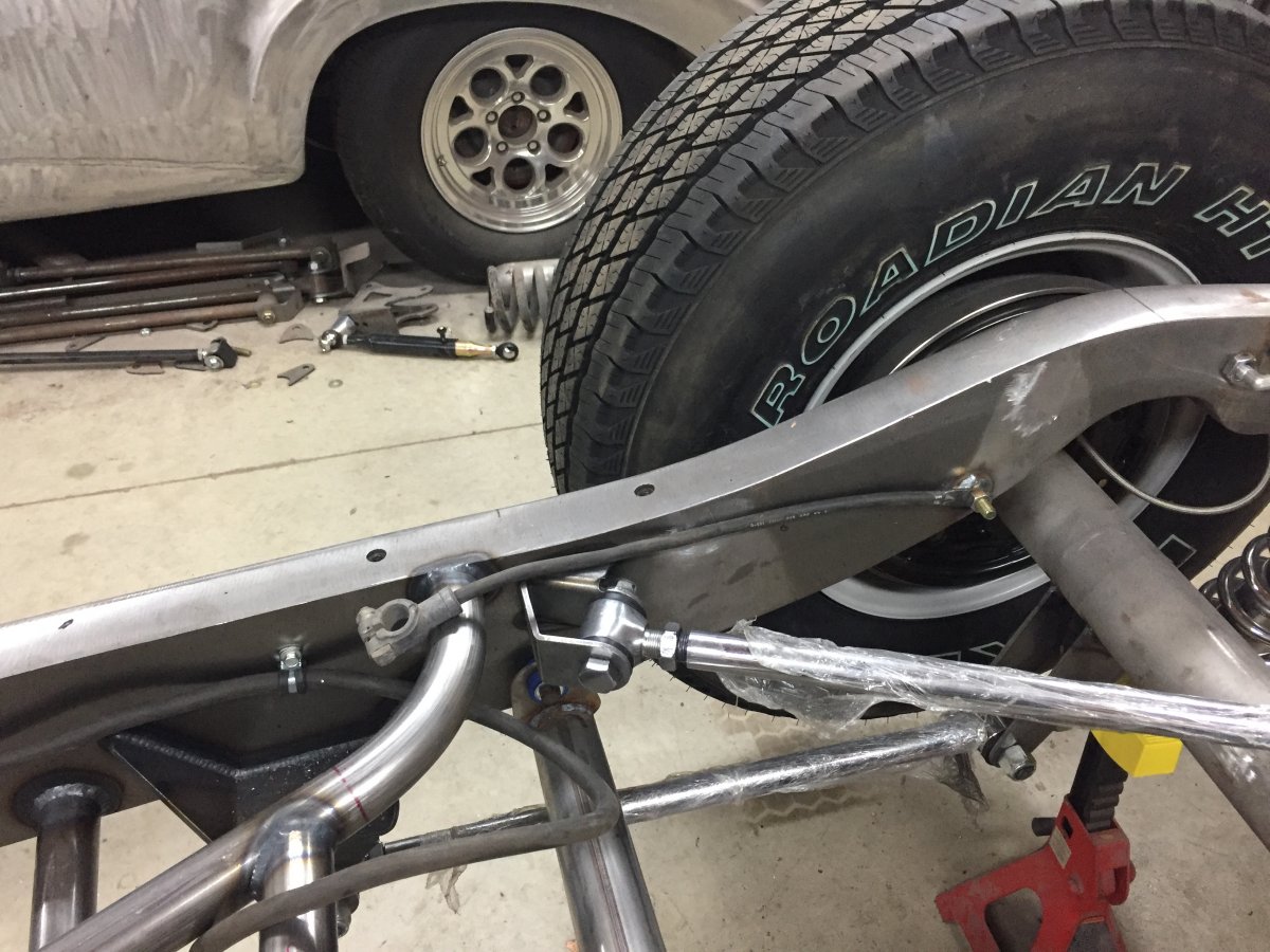

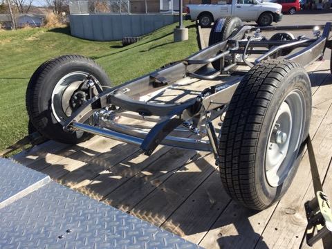

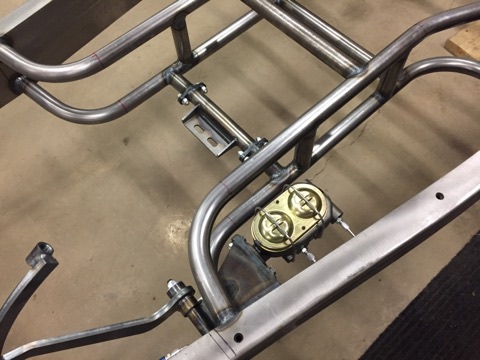

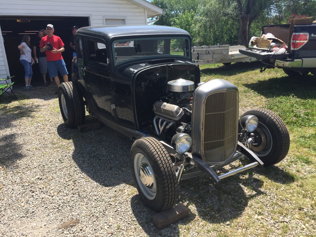

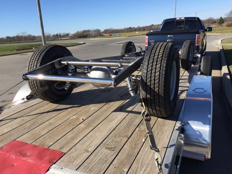

    November 2017 I got the call that the chassis was done so a quick trip down was in order. Threw my tires and wheels in the back of the pickup and drove down to pick up the rolling chassis at Pete and Jakes.

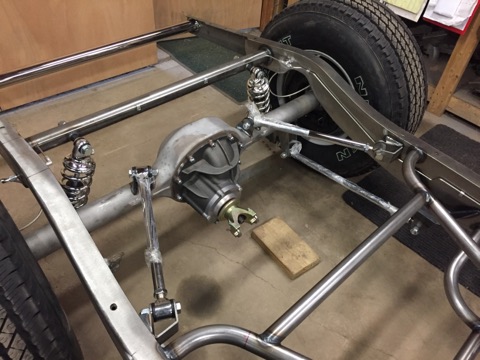

    Got a '32 frame with triangulated 4 bar, hairpin front. The 9" is all new and full of 31 spline axles and a 3.25 gear and has drum brakes and polished aluminum adjustable coilovers and chrome springs. The front end is a Hi Lite polished Alum-I-Beam, chrome Posies spring and some bling mixed with some natural finish parts to paint for contrast. Had them install the stainless brake line system, proportioning valve, Vega cross steering and combo headlight/shock mounts. Since I was doing a hi boy, they filled all the fender mounting holes, too! Also picked up a set of their polished stainless spreader bars.
    I highly recommend working with these folks. Couldn't have been a more pleasant experience from beginning to end. Plus they have a great showroom!

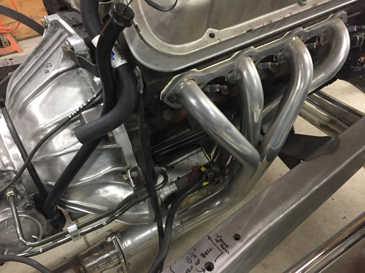

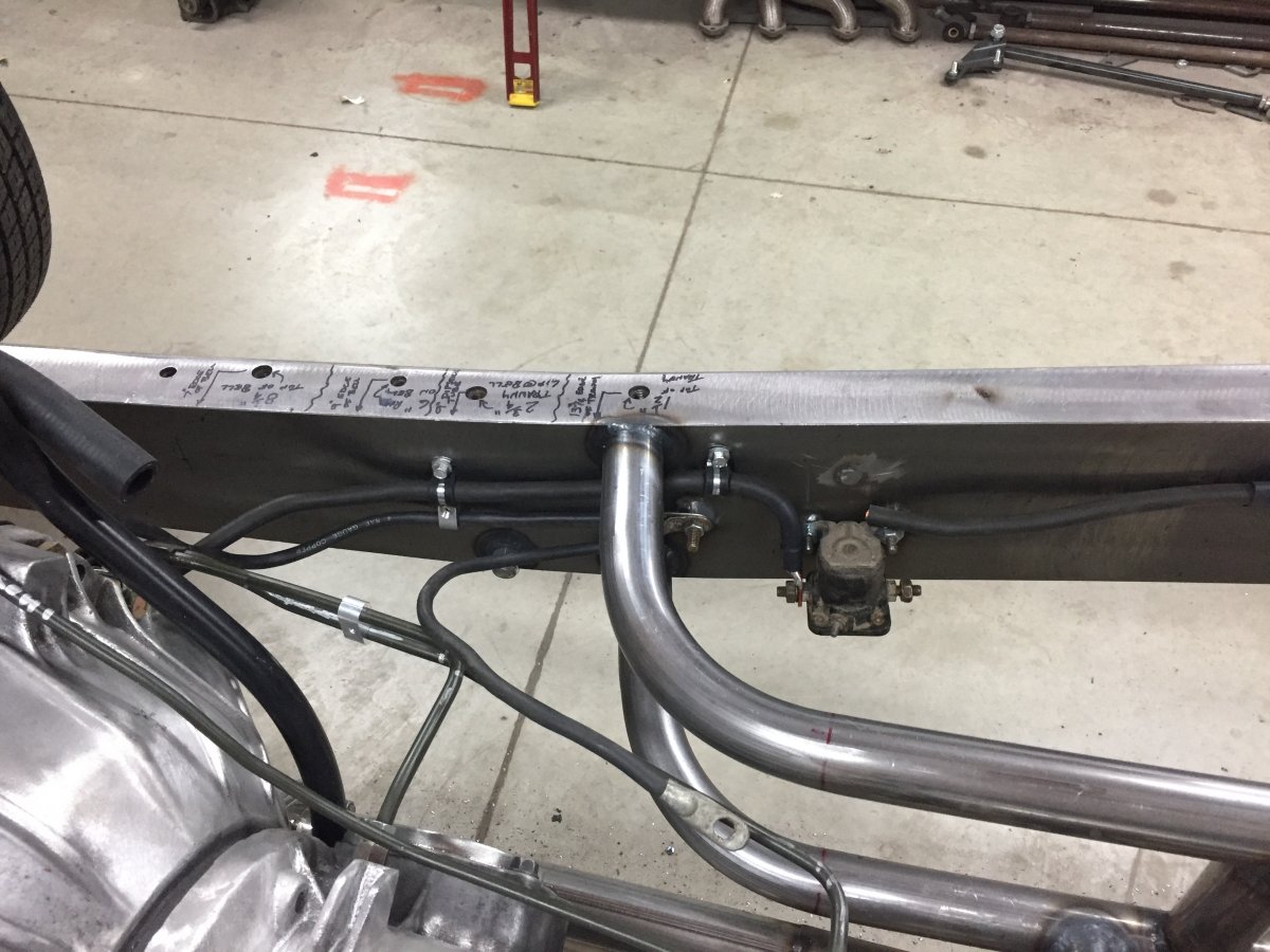

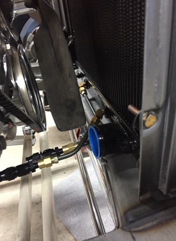

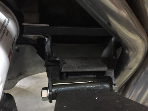

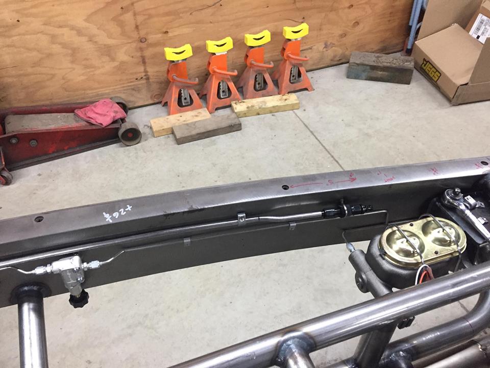

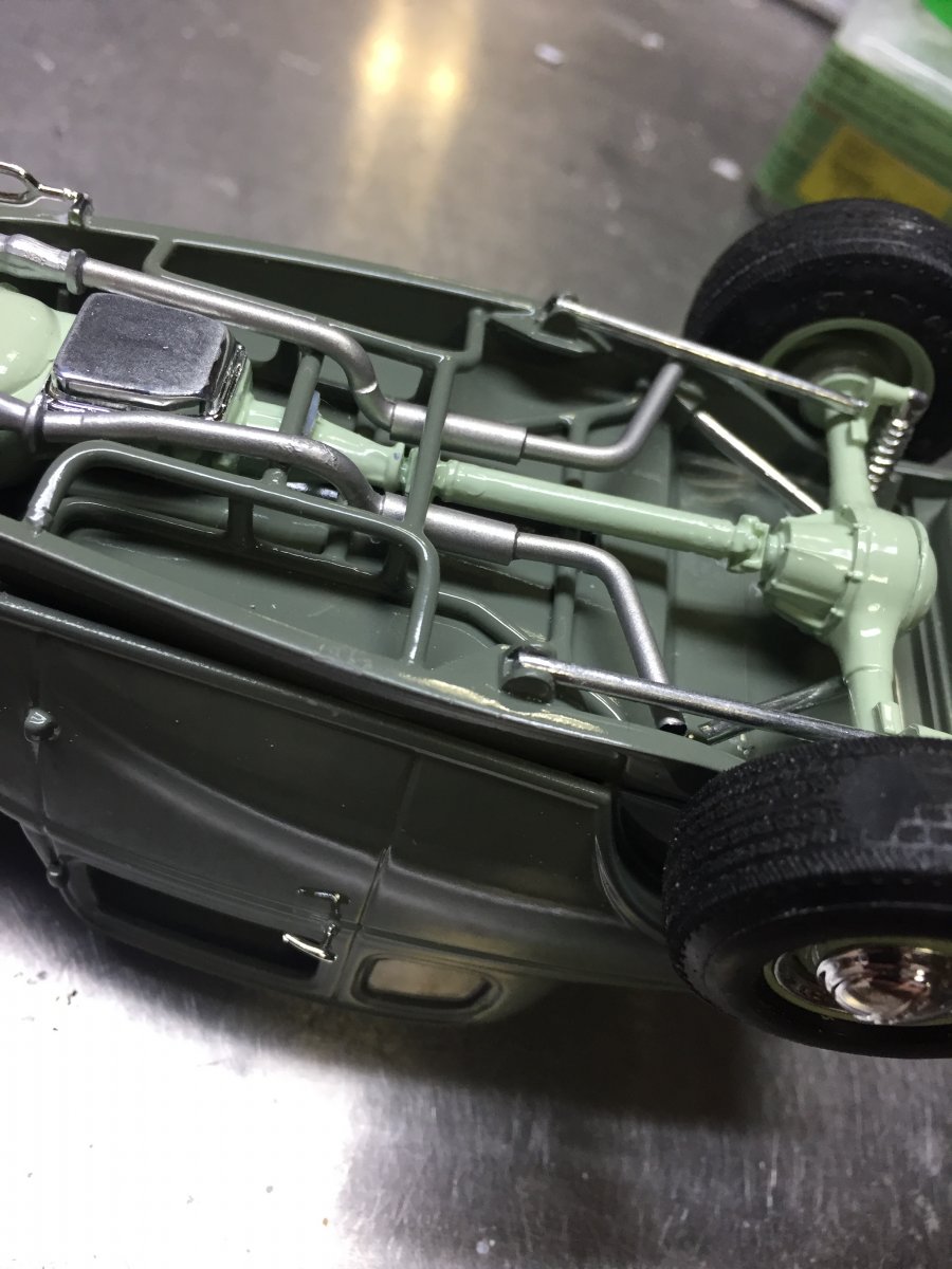

    Once I got that home, I mounted the engine/tranny. I raised the front of the engine 5/8" and the tranny 1/2" to gain some clearance around the oil filter. Also got my fan away from the lower radiator hose. I'm using a '71 style timing cover, '69 water pump (right hand hose) and some early 1 grove pulleys (Speedway chrome parts). The secret to using the early pulleys is a Pro Products balancer. It has 3 bolt and 4 bolt lower pulley mounts. Lets me use the 3 bolt lower pulley on the later crank. I did have to make a 1/4" spacer to fit behind the pulley. Everything lines up great.
    Also ran fuel lines, trany cooler lines, tranny vacuum line and tacked the stainless exhaust together. Starting to look like a chassis!

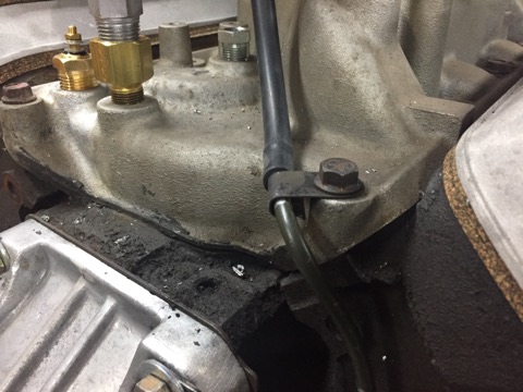

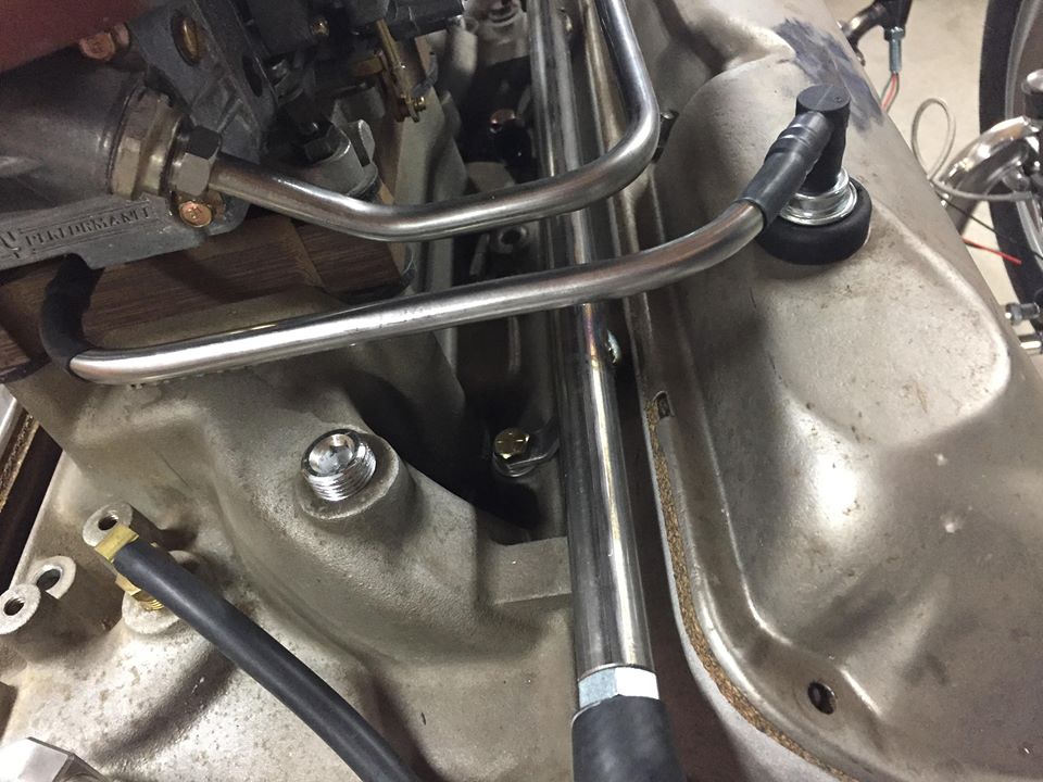

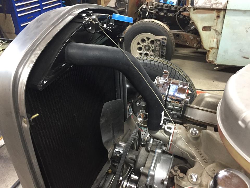

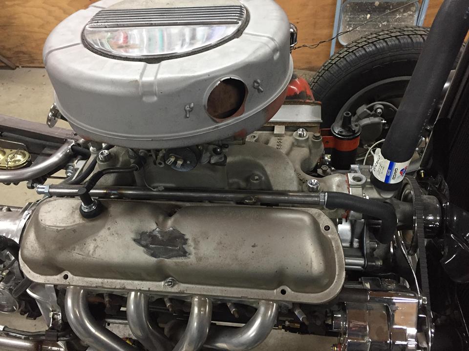

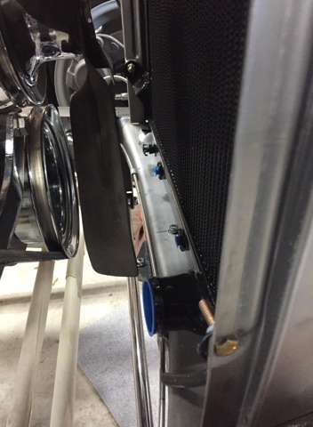

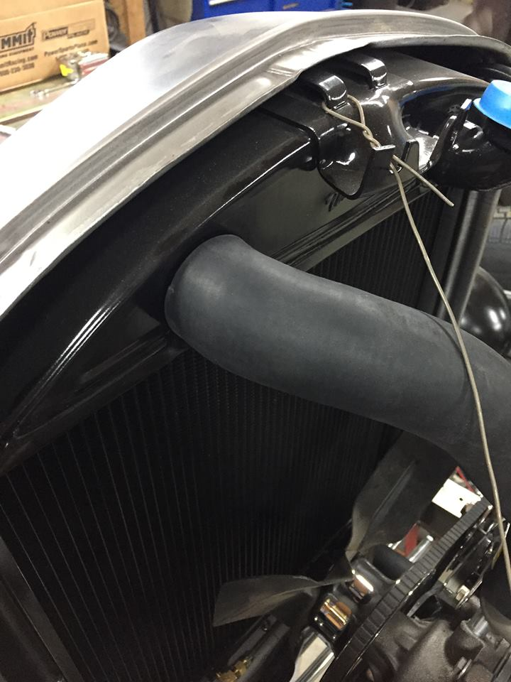

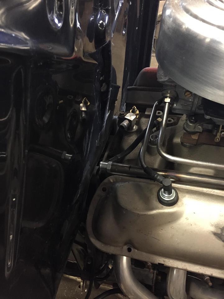

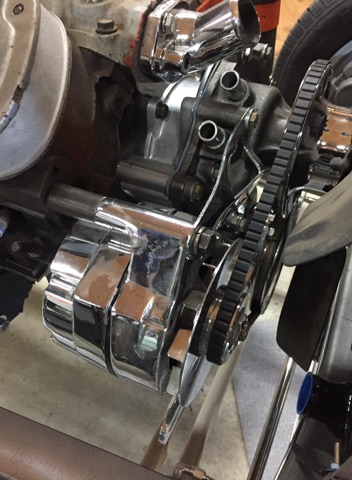

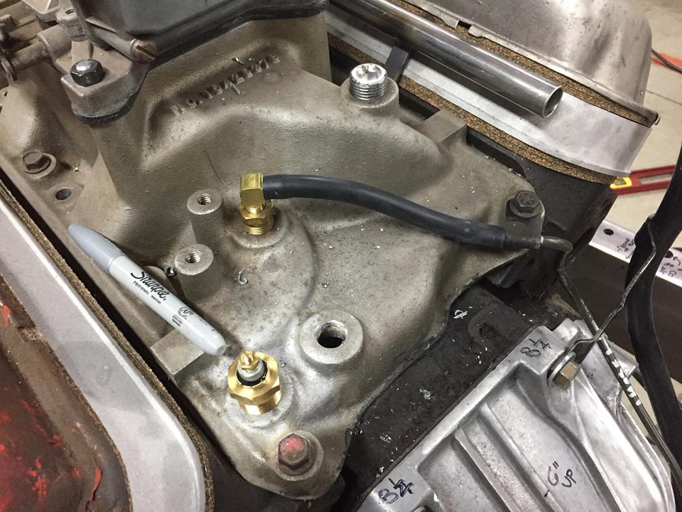

    Hoses. We've all fought the battle. I use the old "bend a welding wire to shape and browse thru the hose supply at the local parts store" method. Found great fitting upper and lower radiator hoses, a stock bypass hose and then I got to the heater hoses.
    I want to hide some things in plain sight on the engine to clean it up a bit. What I ended up doing was a pair of 3/8 NPT to 5/8 hose barb fittings pressed (soon to be welded) into the ends of a piece of 3/4" x .083 wall steel tubing. I then welded tabs to the tubing to mount it on a couple of intake bolts. Another trip to the hose rack and I found a nice molded hose to go from the water pump to the new steel conduit and hopefully I can use some of the cutoff bends to run hose to the heater location once the body is mounted.
    Also mounted the temp sending unit at the back of the intake. Had to drill and tap the holes for the 1/2" NPT fittings.
    I hate flex hoses, molded will always look nicer to me. It's worth the time measuring, trimming and shopping to find it.
    SPark
    heater1.jpg heater3.png heater4.png heater5.jpg heater6.jpg heater7.png heater8.png RadHoseLower.jpg RadHoseLower2.jpg RadHoseLower3.png RadHoseUpper.jpg RadHoseUpper2.png RadHoseUpper3.jpg

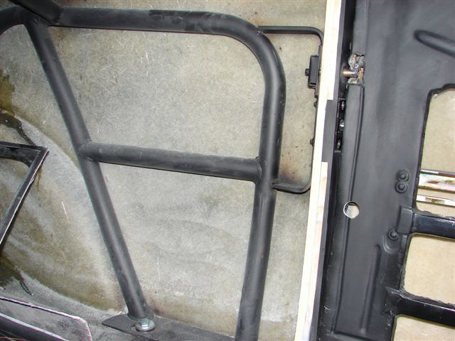

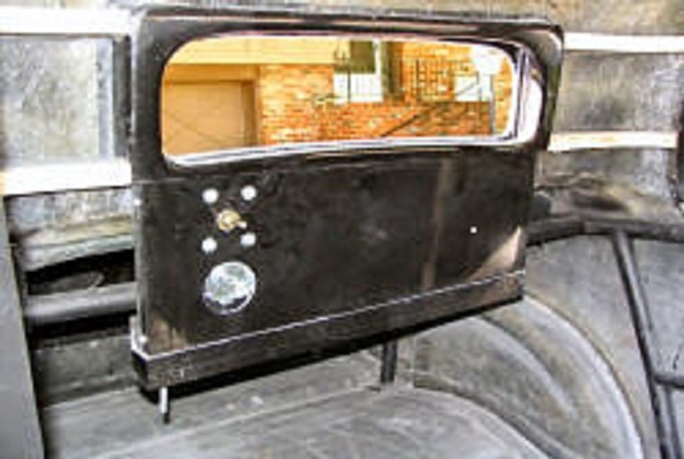

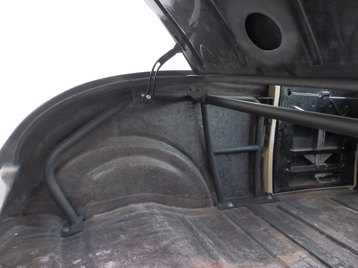

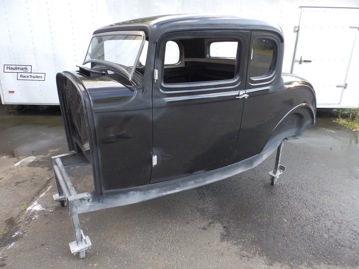

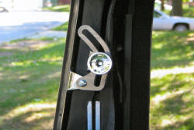

    Got the call from New Age Motorsports! They've started on my body. It will have:
    3" chop
    Filled roof
    Rain gutters
    Stock style firewall set back to clear my engine location
    Custom tranny hump to clear my engine/tranny location
    Flip out windshield
    Working cowl vent
    Hand crank door windows
    Roll down back window
    Stock style trunk drain
    Stock style trunk catch
    Flat dash
    Stock type hinges and handles
    Glass and garnish moldings
    All the internal steel tubing bracing and wood
    Plan is to head back to Connecticut May 25th to pick it up. Only 1200 miles each way, should be a nice summer cruise again.
    Pics taken from the NAM website (their pics show electric windows, mine will be hand crank)
    You are now up to date! Will continue to add to this as things happen.
    Thanks for looking!

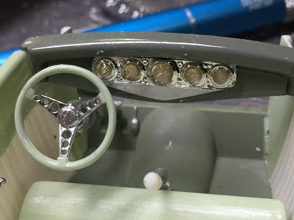

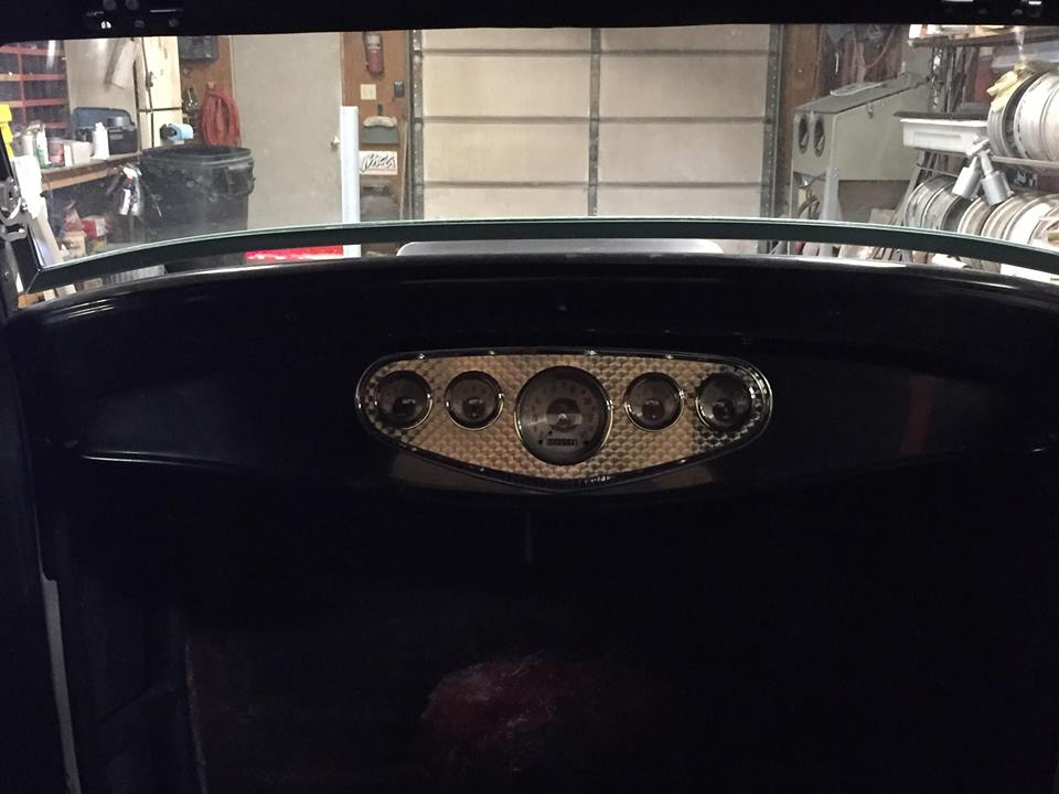

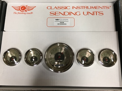

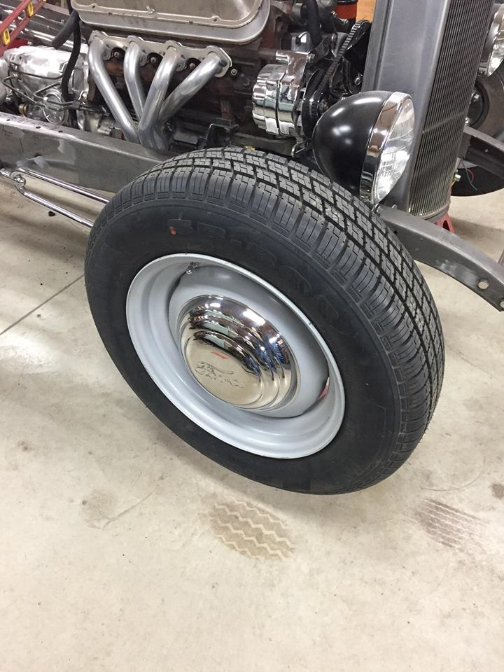

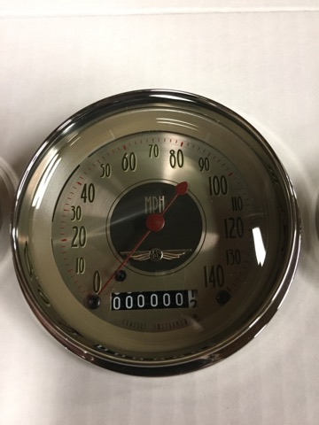

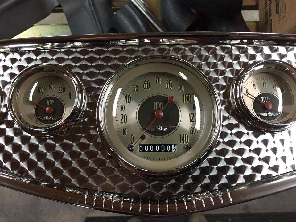

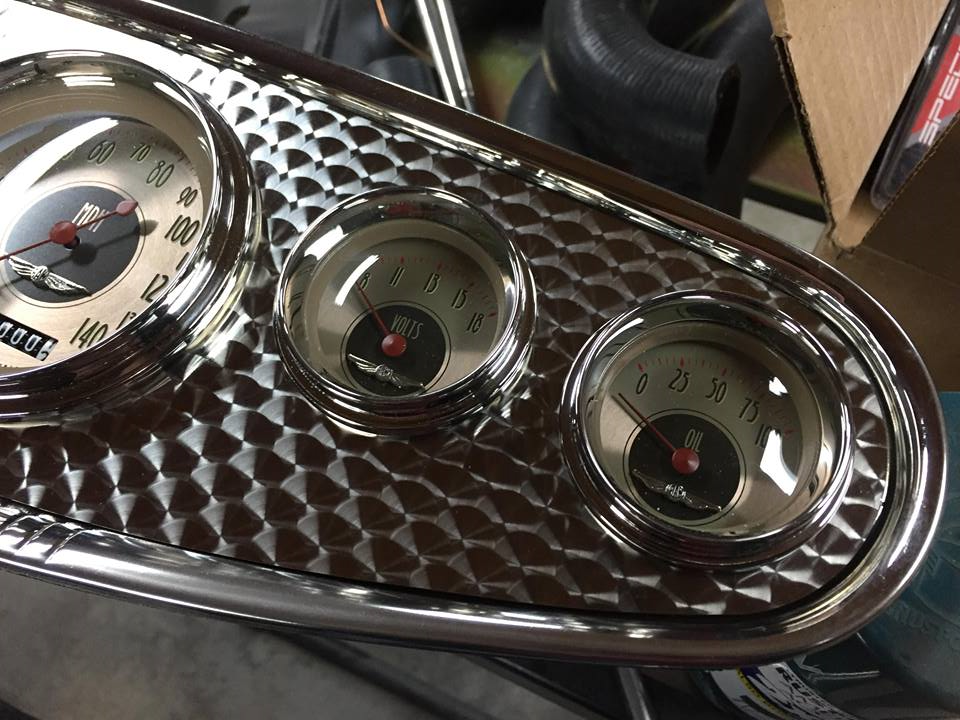

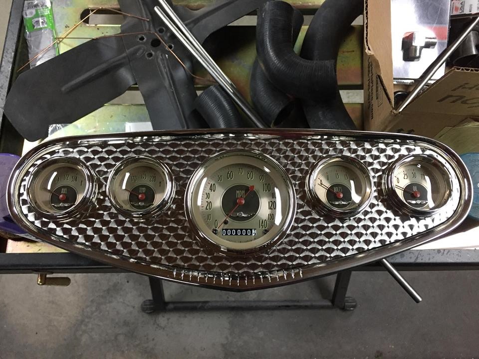

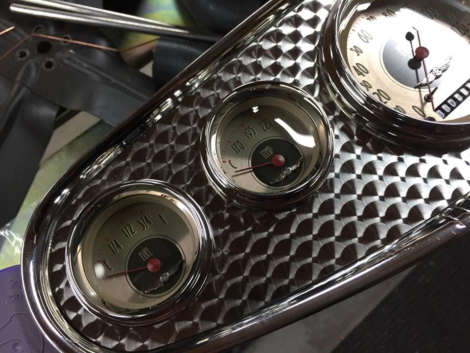

    It was a good day! Cardiologist took me off another med. Down to one half of one blood pressure pill a day! Quite a change from 4 pills for BP and 1 or 2 for heart rhythm every day. Quitting work was a good idea and now hopefully I'll feel like working on my toys more with my heart rhythm back up where it belongs instead of hovering around 45-50 all the time!
    When I got home from the Doc, had a package from Honest Charlie's waiting for me. Got the stainless dash panel and stainless insert. Had the gauges all winter, just needed a pretty home for them. Car porn!
    SPark
  7. falconsprint63
    Joined: May 17, 2007
    Posts: 2,347
    falconsprint63
    from Mayberry
    Been kicking around those gauges in a cluster like that nice to have a chance to see how it looks.

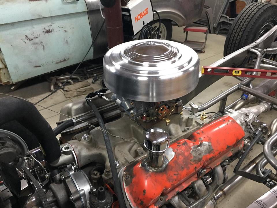

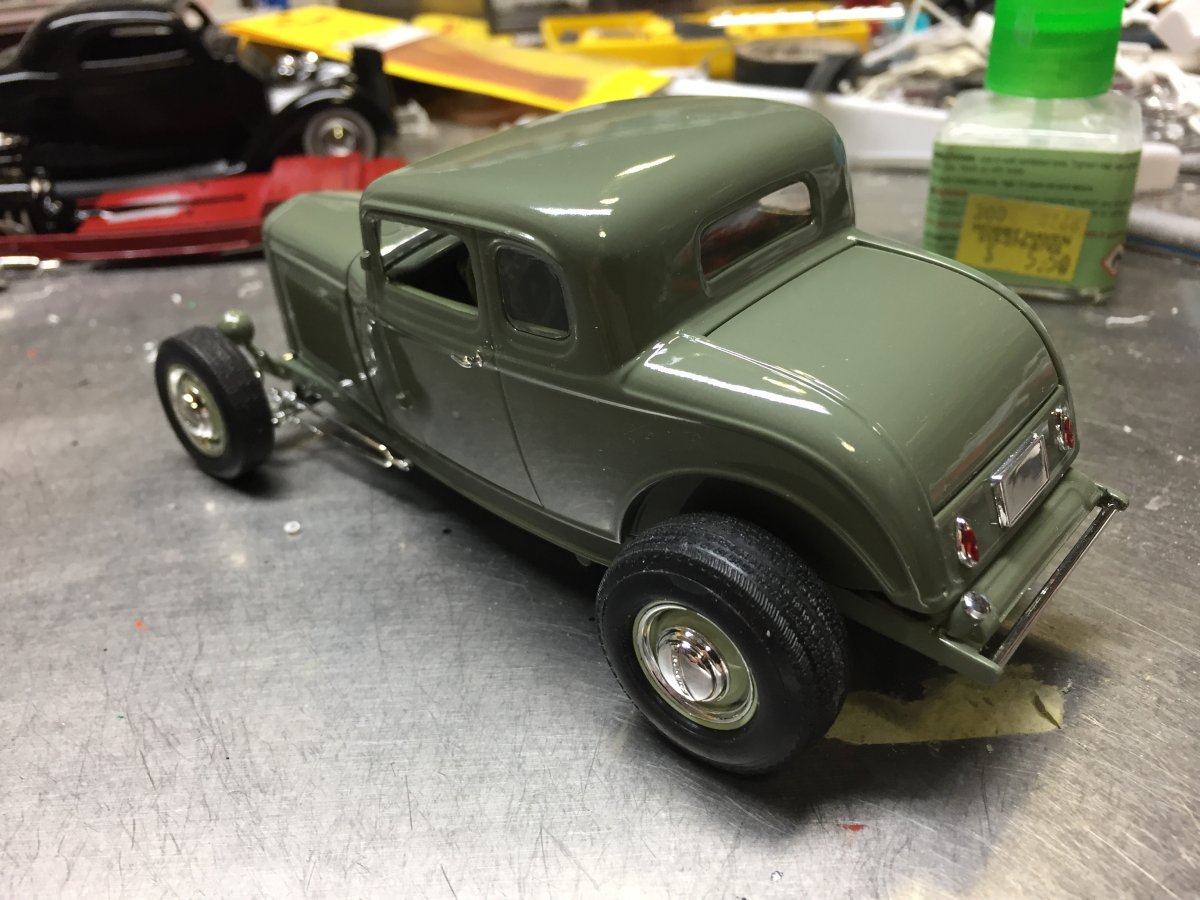

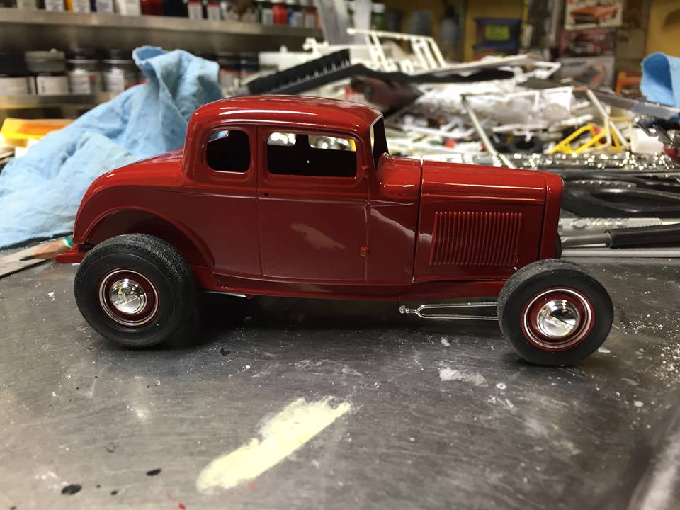

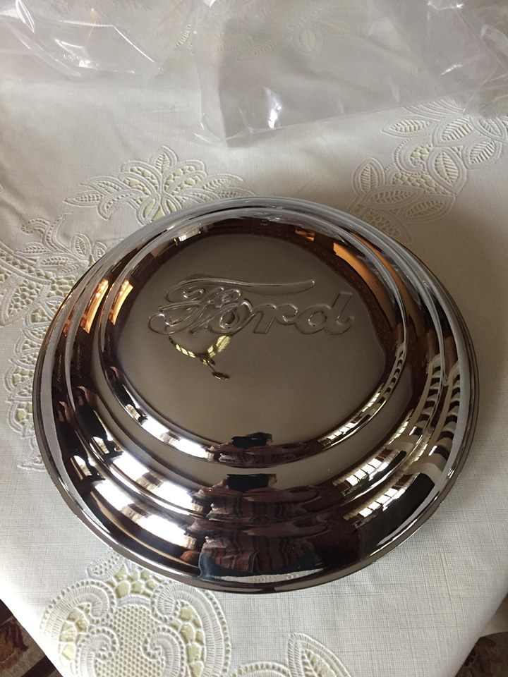

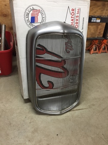

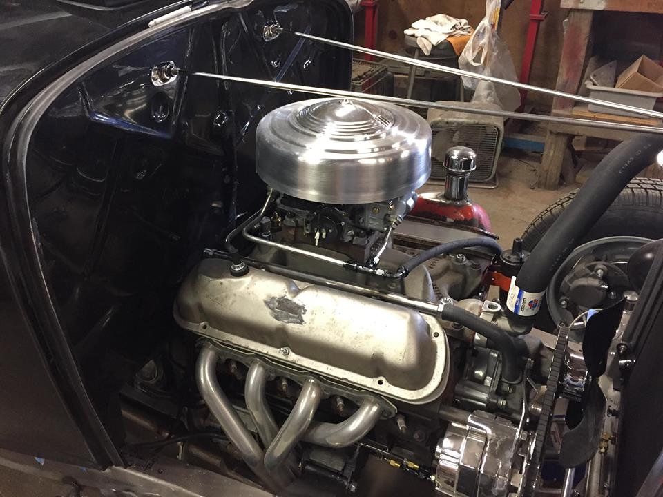

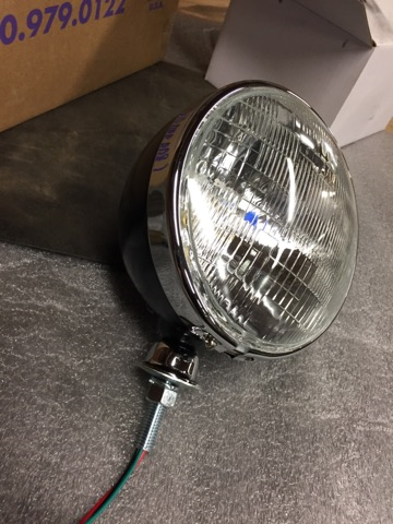

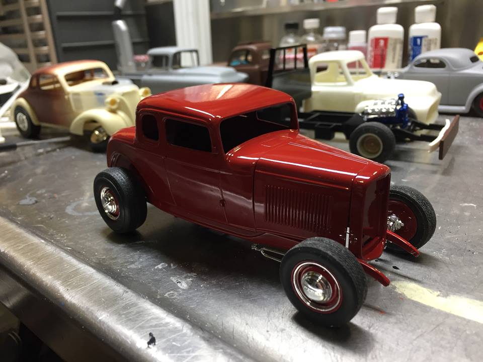

    Decided on an OBT air filter setup, kinda mimics the hub caps.. The main bod will be painted engine color and the dome is polished aluminum. Also got the stainless fuel lines and PCV line made.
    Decided on '41 caps and ribbed trim rings. Got the caps the other day.

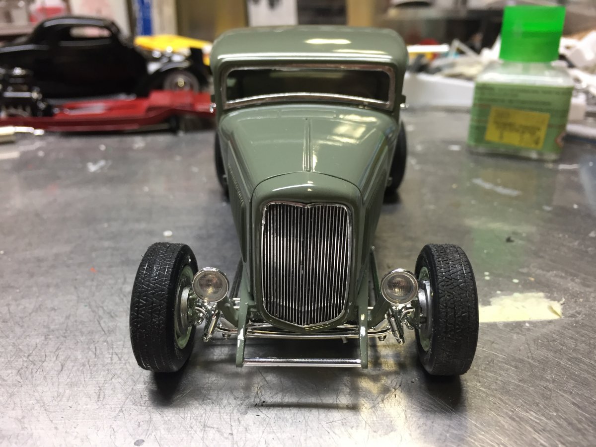

    The last 6 pics are teasers. Took a scale 3" out of the tops of a couple Revell '32 Ford 5 windows to play with some color combinations. Leaning hard towards the Sage Green with Celery Green wheels (not sure why they look so blue in the pictures, they are a pale yellow/green in person) and trim. The red one also looks decent but it's just overdone to me.
    SPark
    AirCleaner1.jpg AirCleaner2.jpg AirCleaner3.jpg AirCleaner4.jpg Fuelline23.jpg Fuelline24.jpg Fuelline25.jpg Fuelline27.jpg hubcap1.png hubcap2.png scalegreen1.jpg scalegreen2.jpg scalegreen3.jpg scalegreen5.jpg scalered5.jpg scalered6.jpg

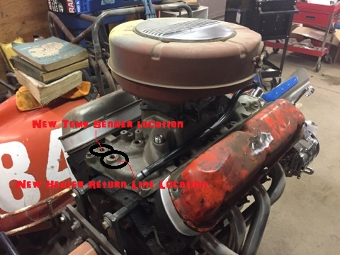

    I am watching your build with great interest. I am building a 32 also with a Ford 5.0 and Walker radiator. I was able to read the part number for the lower radiator hose, could not make out the number for the upper hose, I'd like to ask if you would share the part number.
    Also, are you running a heater, looking at the water pump hose routing leads me to think that you will.
    Thank You in advance.
  11. LM14
    Joined: Dec 18, 2009
    Posts: 1,161
    LM14
    from Iowa
    Upper hose. Attached a picture.
    Using a Ford Motorsports thermostat housing but they don't clear the bypass hose the greatest with this Weiand Stealth intake. Had to do some clearance work on the bottom side by the bypass hose location and will have to tig it back in, kind of hit air in a couple places...
    I plan to run a heater. Looking at this:
    https://www.speedwaymotors.com/Flex-A-Lite-640-Mojave-Universal-Heater,304.html
    with the extra (model 650) plenum on it so I can have defrost. Have to have defrost for the inspection to get a title issued as a specially constructed vehicle, 1932 Ford. They might pass it with a bus fan depending on the officer doing the inspecting but they have to pass a defroster. Also like to hit a few shows at the end of the season where a heater could come in handy!

    Color decided......I think......

    Think we’ve agreed on a color (as of today anyway).
    Sage Green with Celery Green accents. Probably a little pinstriping for accents, too.
    Got all the battery cables routed and secured to the frame. Also chose the solenoid location. Tucked out of the way but easily accessible from the bottom. Ground lugs welded to the frame. Worked on our dirt late models, should work here!

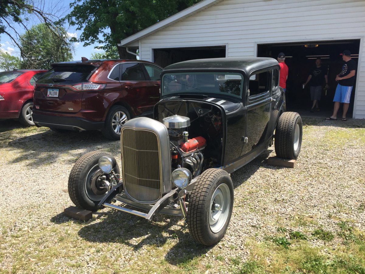

    Pictures tell the story of the last 74.5 hours. Body meets frame tomorrow afternoon!

    Thanks to a great group of friends on a 95* day. At least we had free beer for them!

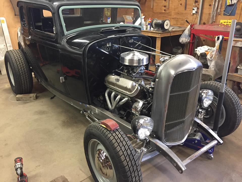

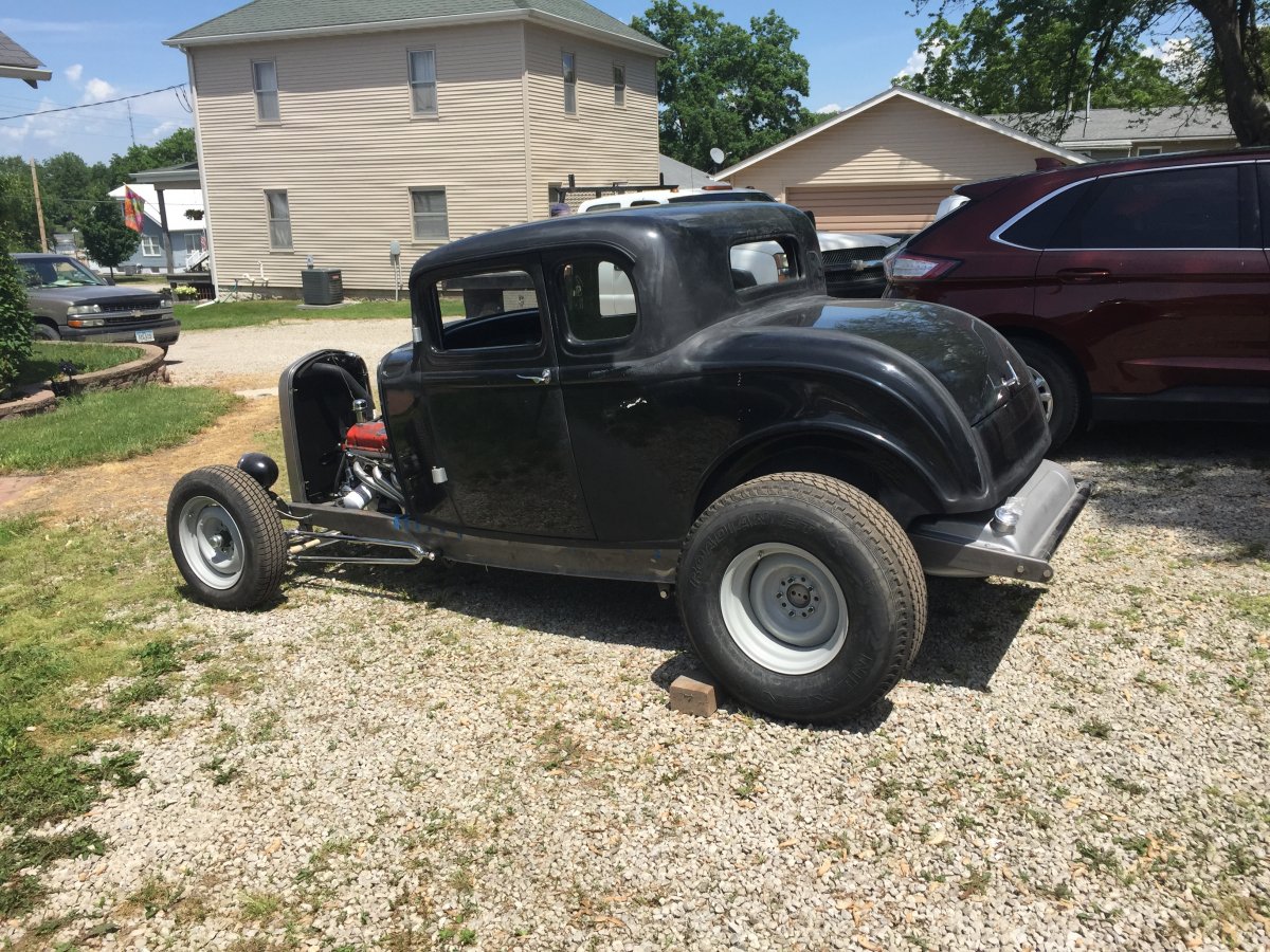

    Body mounted. Had to remove a little boss on the bellhousing before it would come forward all the way. Little fiberglass trimming at the top 2 bellhousing bolts and it slid into place perfect. Engine fits the firewall nice and tight. They did a great job working with the pictures and drawings I supplied for engine/tranny location for creating the firewall and trans tunnel. Great custom fit. Really happy with the body. Doors open and close nicely, everything stayed as build in their jig moving it to my chassis. Happy day!
    SPark
    fweng2.jpg fweng1.jpg fweng7.jpg fweng5.jpg fweng3.jpg fweng4.jpg fweng9.jpg fweng10.jpg
