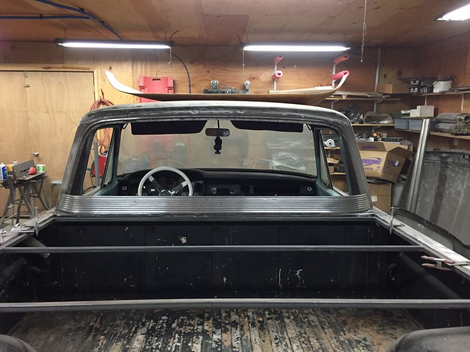

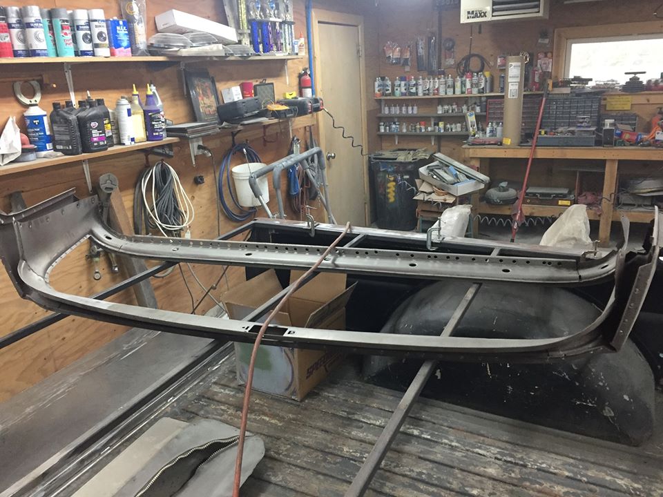

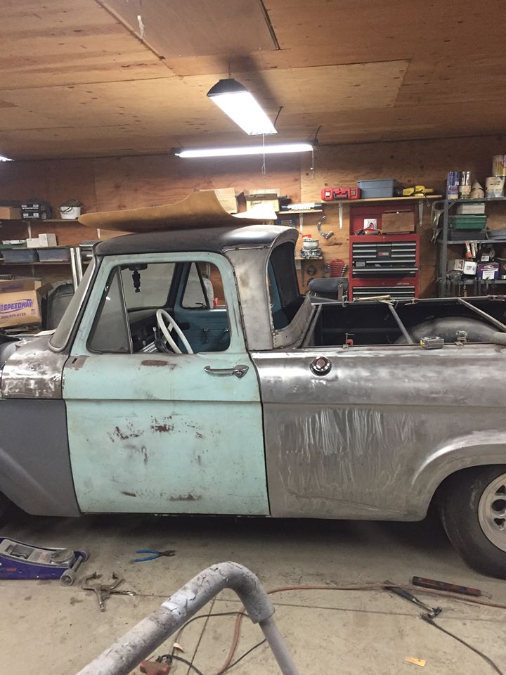

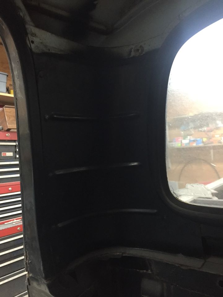

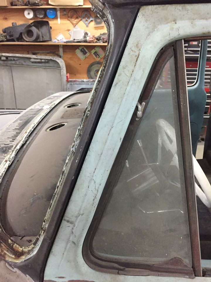

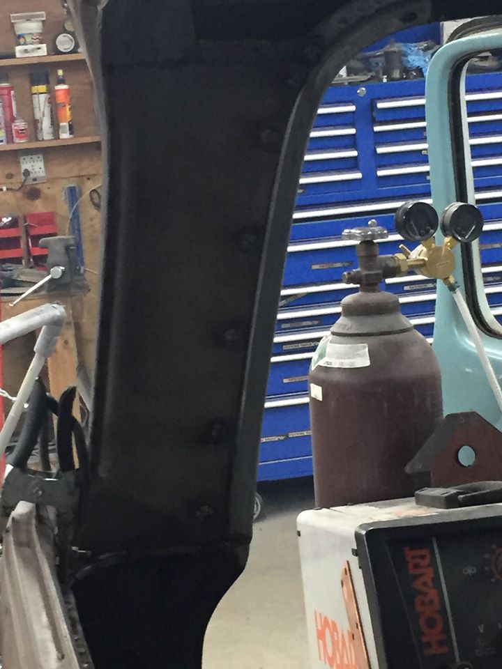

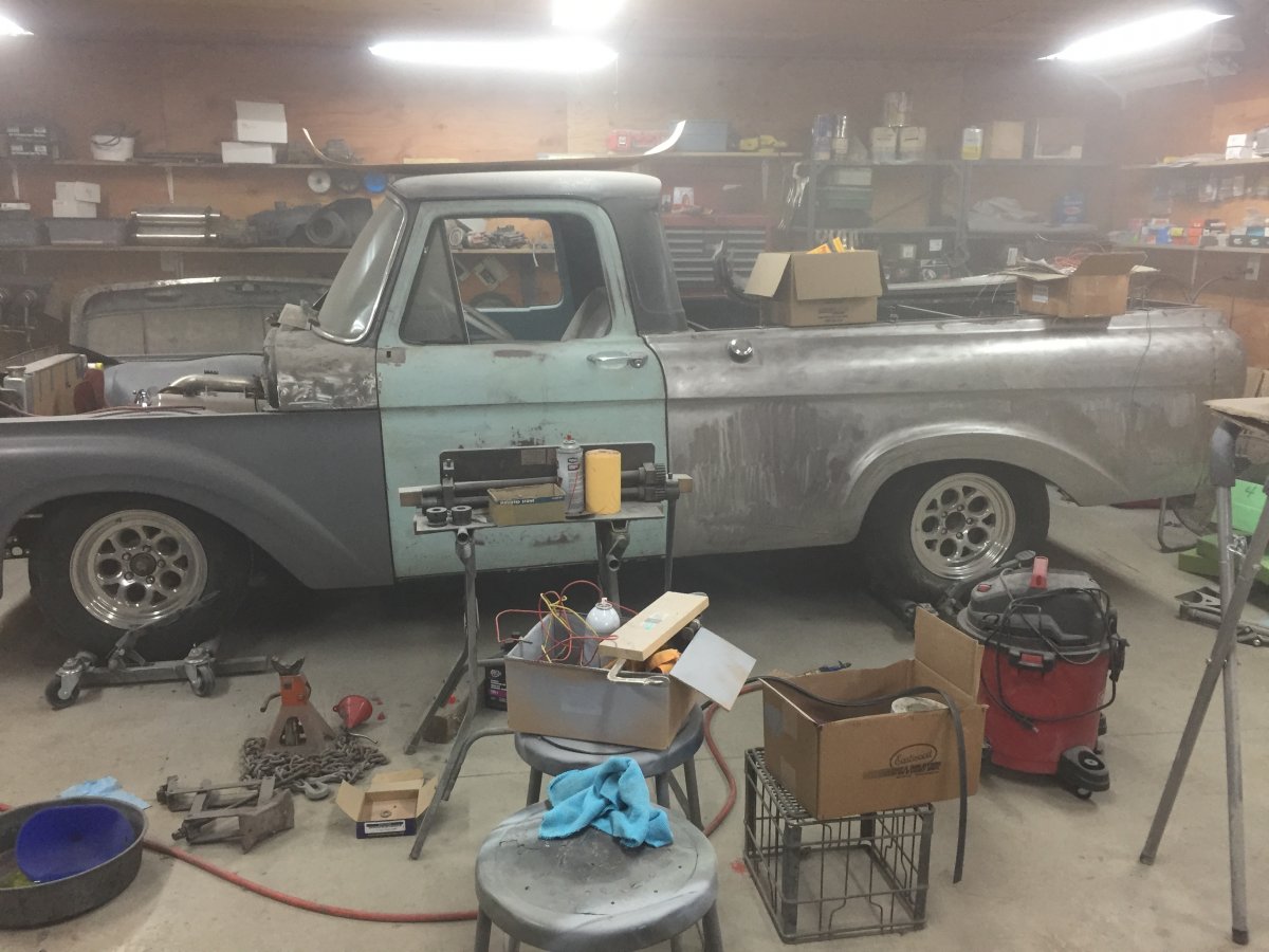

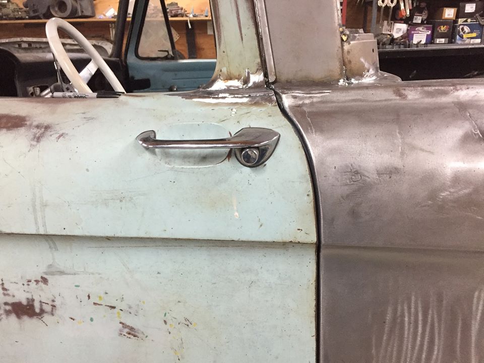

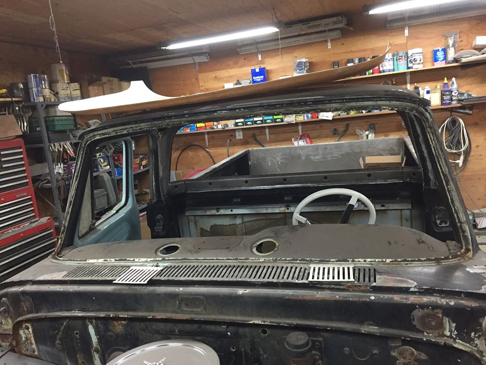

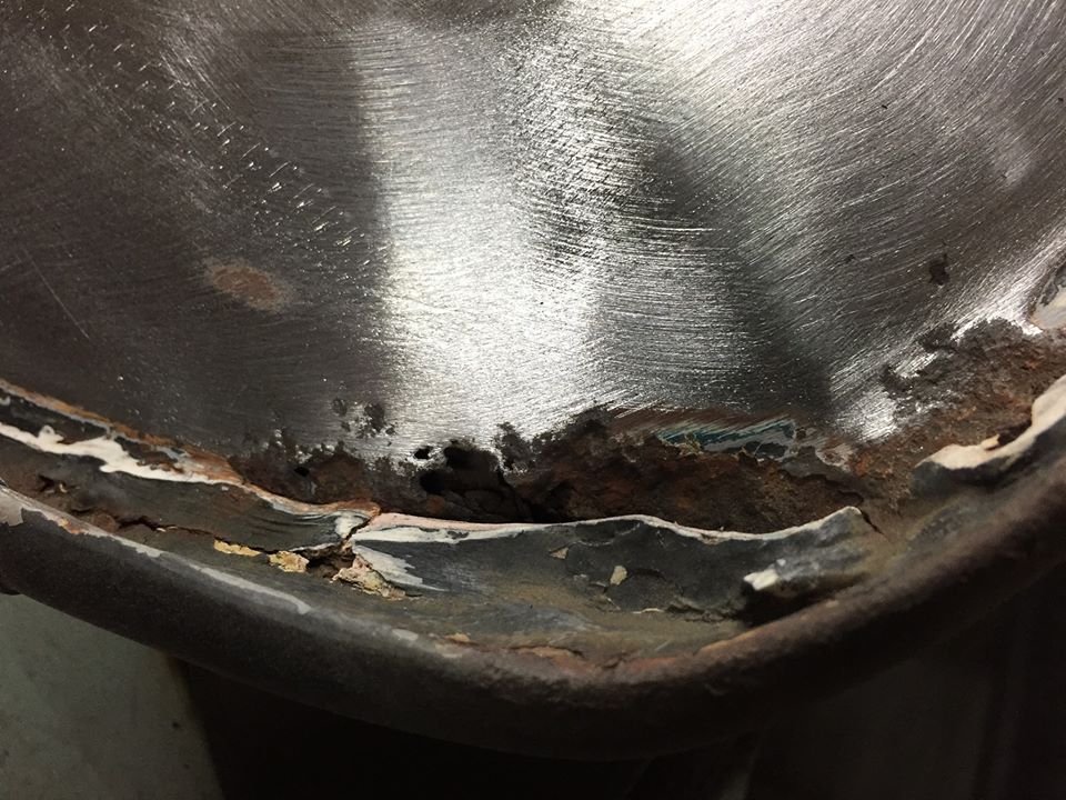

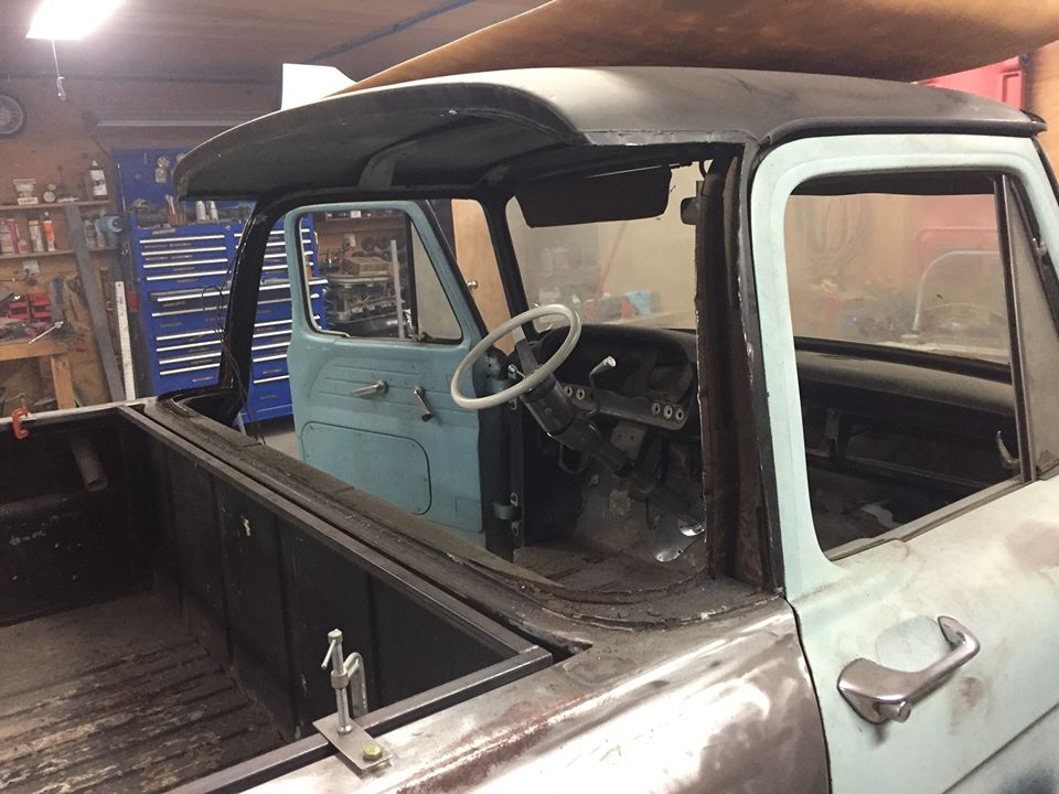

    Merry Christmas to all those following. Much better Christmas than last year. Ended up in the hospital last year and basically don't remember any of it. This year has been good. Having our last Christmas today.

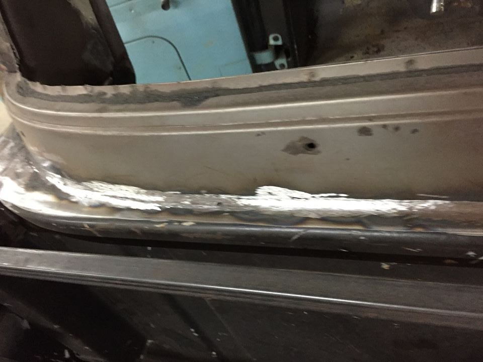

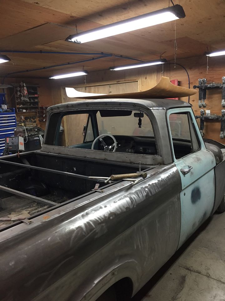

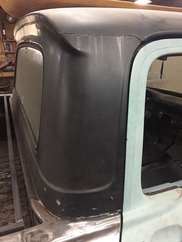

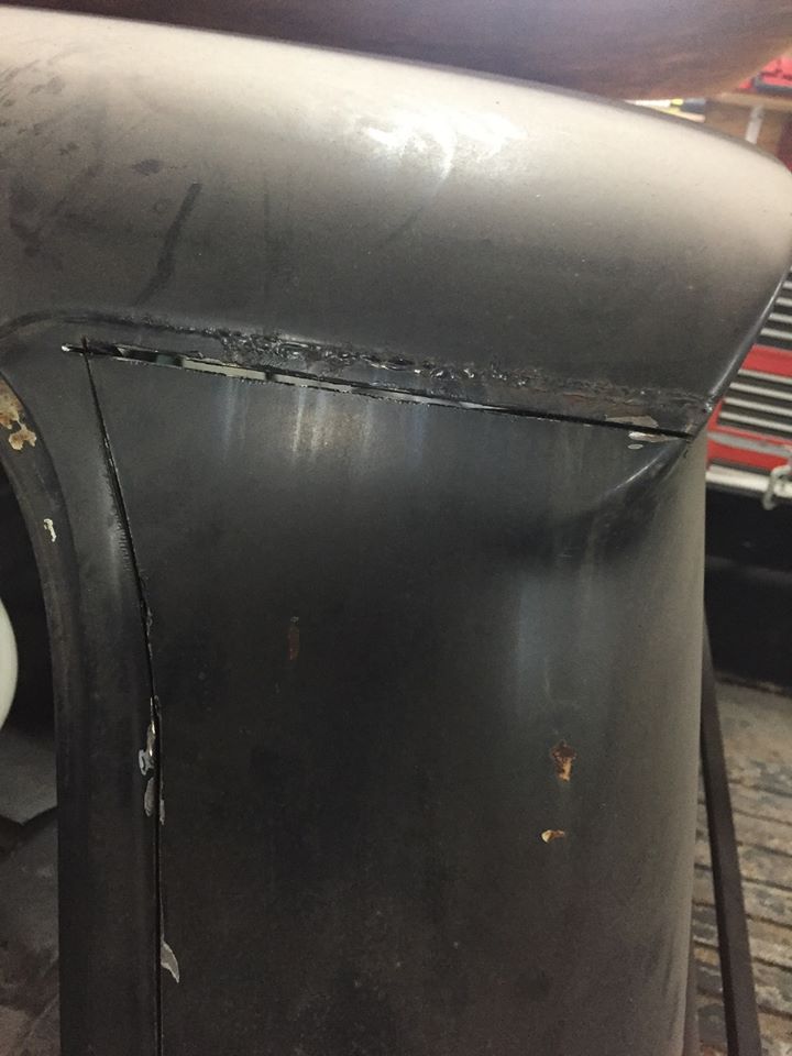

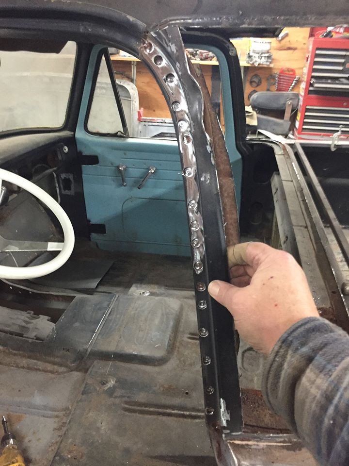

    Been working on the unibody every day while waiting for the '32 to get back from paint. Cutting the back of the cab out to put a big window section in. Almost ready to start putting the back of cab section back in. Hopefully by the middle of this week it's back together.
    SPark

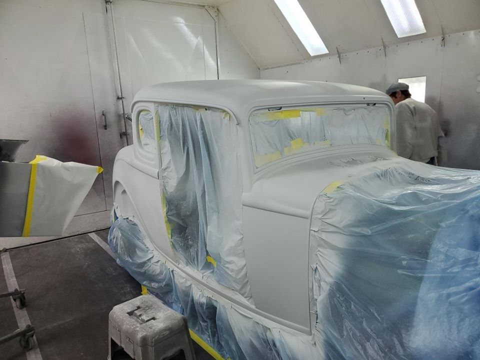

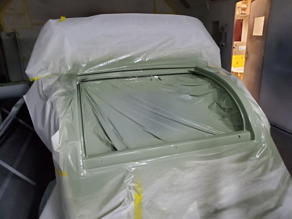

    Got some pictures from the painter. First round of high build is sanded. Going back to hit a few areas with another round then sand again.

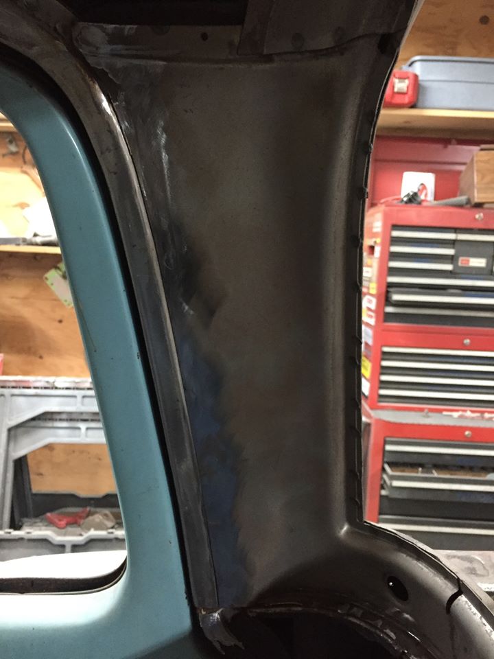

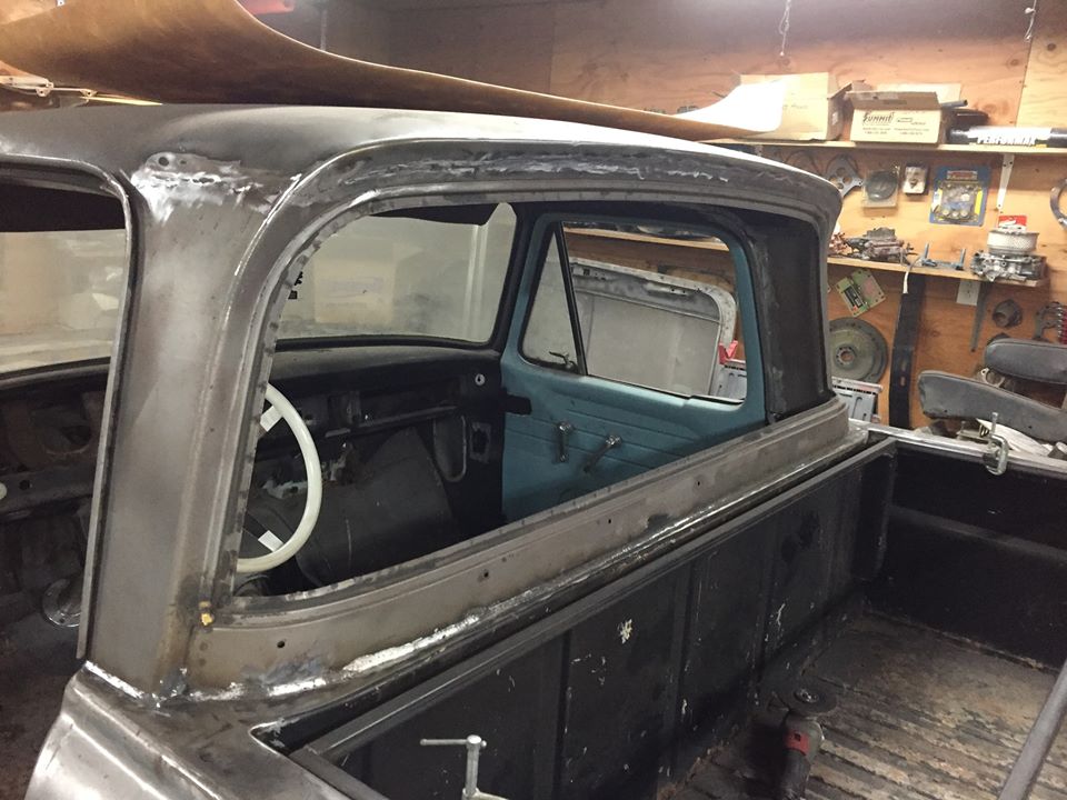

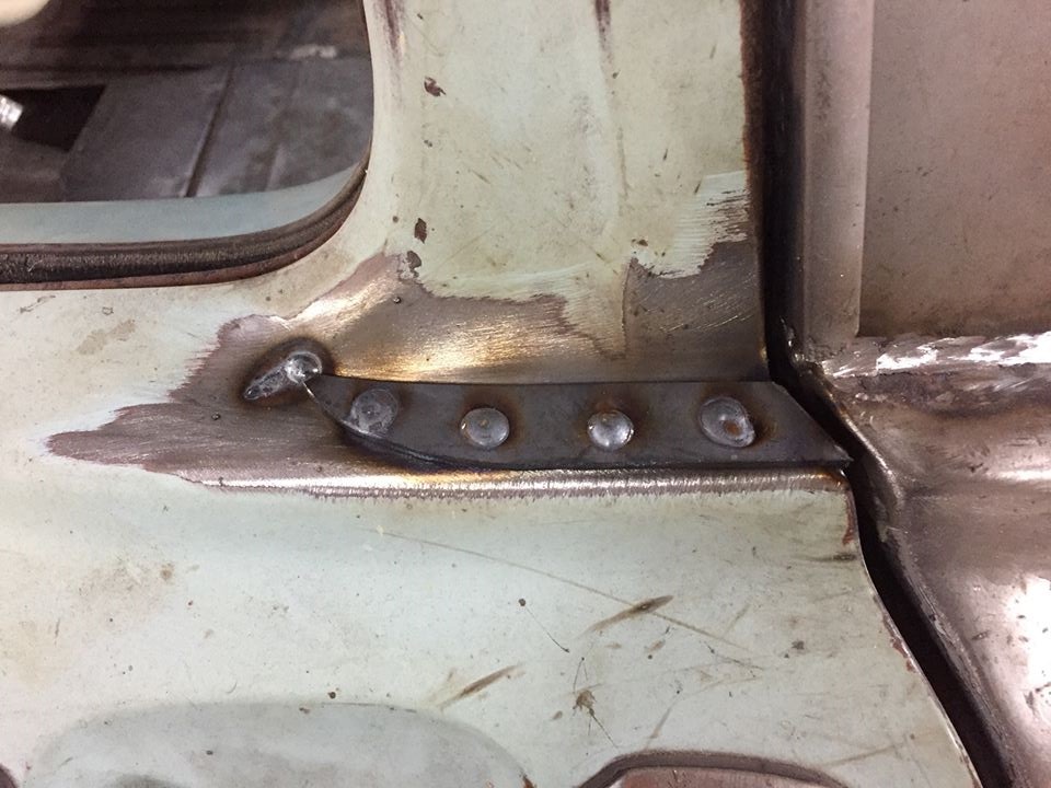

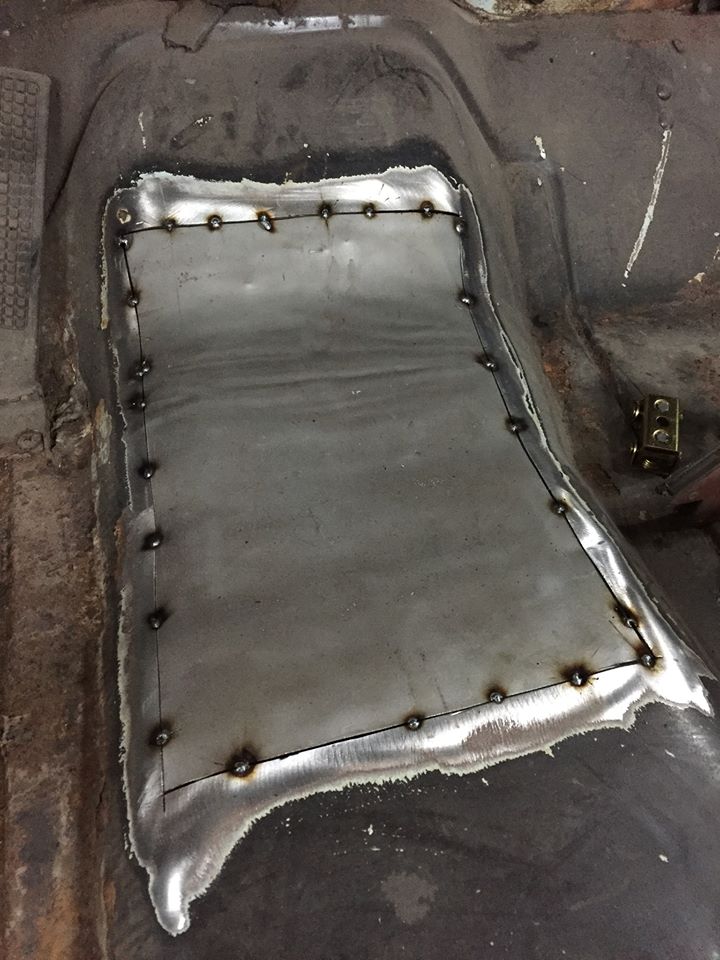

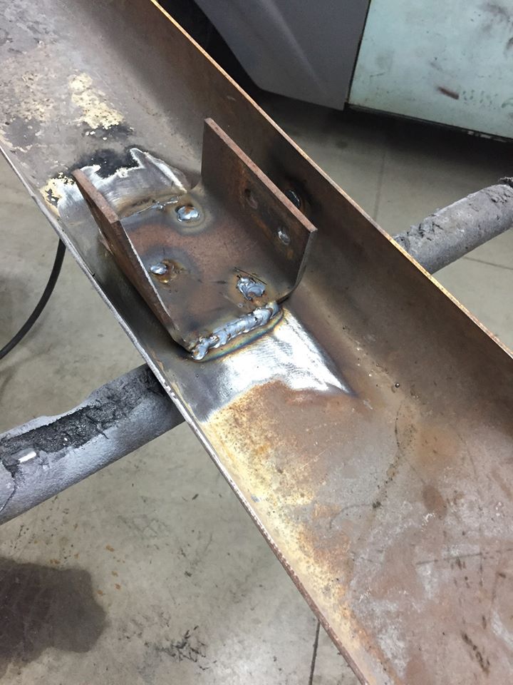

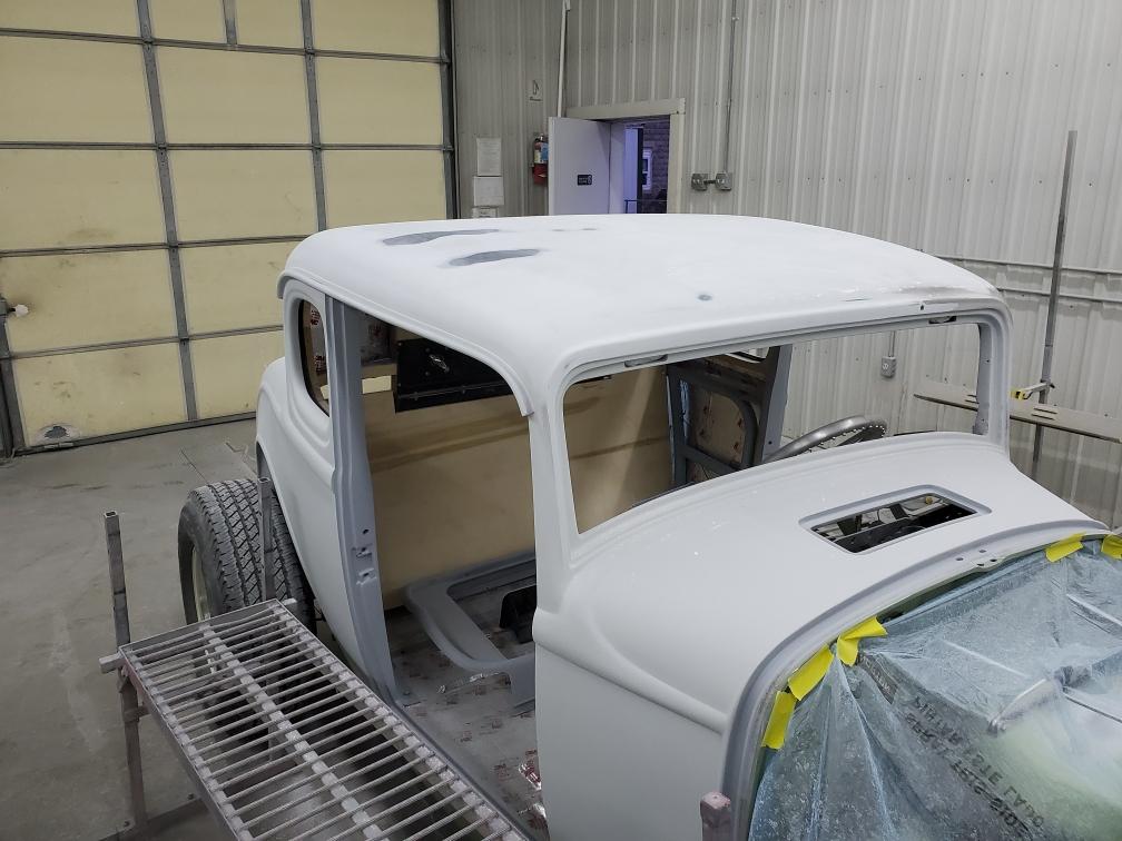

    Stopped at the painter's shop today. Body looks nice. They have a handful of spots to shoot in hi build again and a final block sanding then it should be ready for paint. He said possibly paint it Friday, we'll see. I'm not going to make the 2nd going to upholstery! Already knew that, though. I have another infusion scheduled for Thursday so we weren't going to make that date anyway.

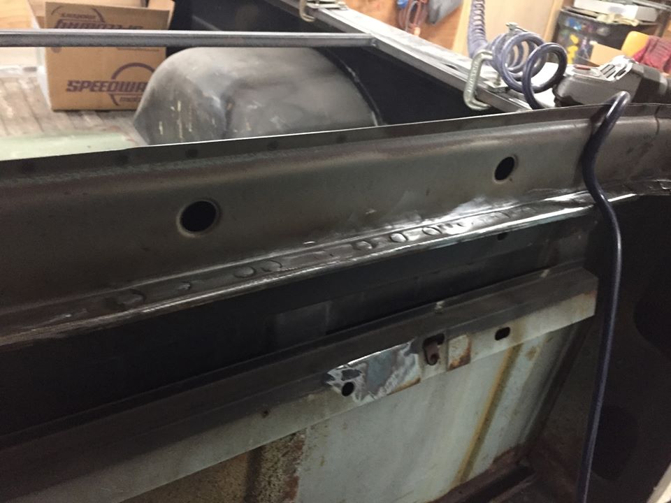

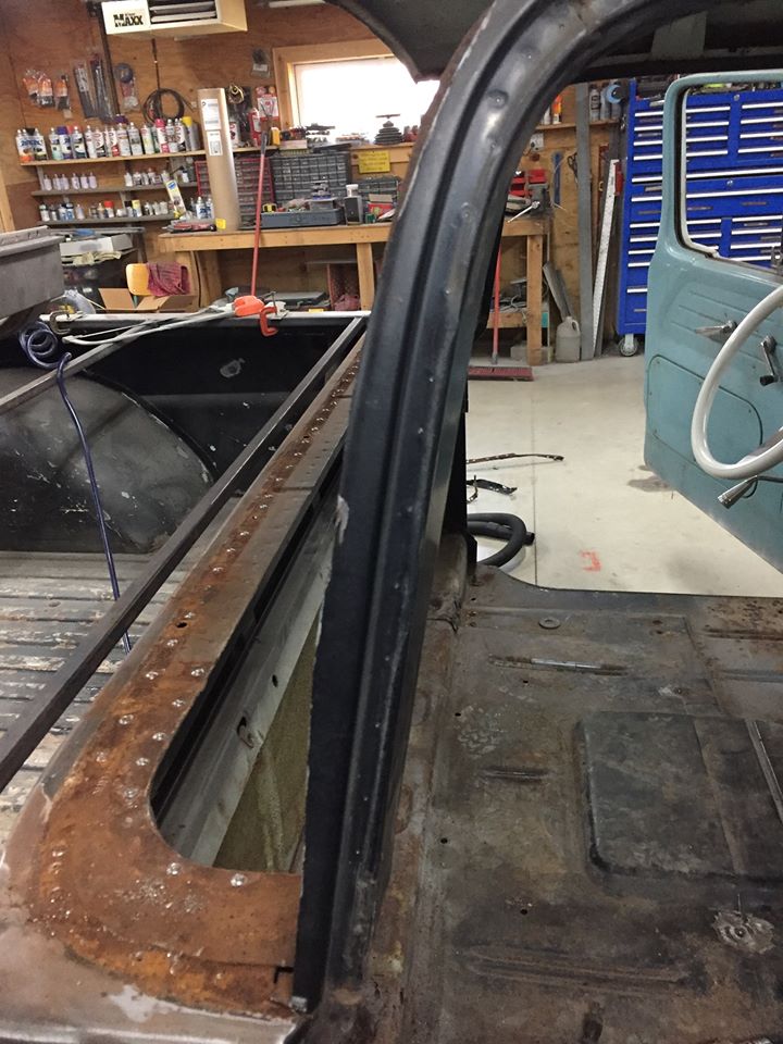

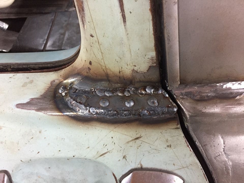

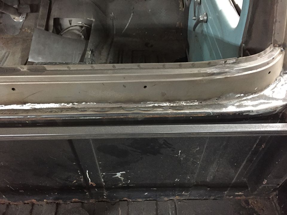

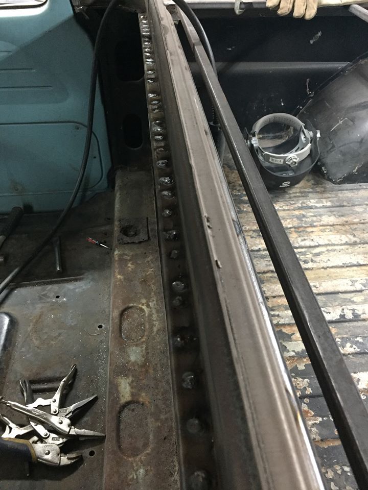

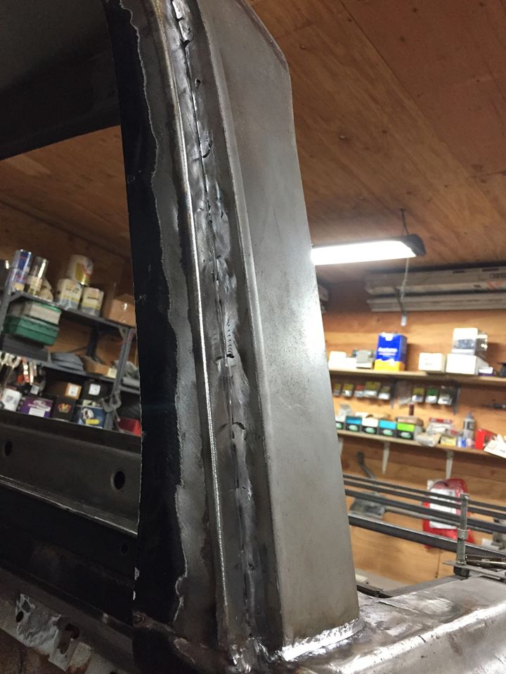

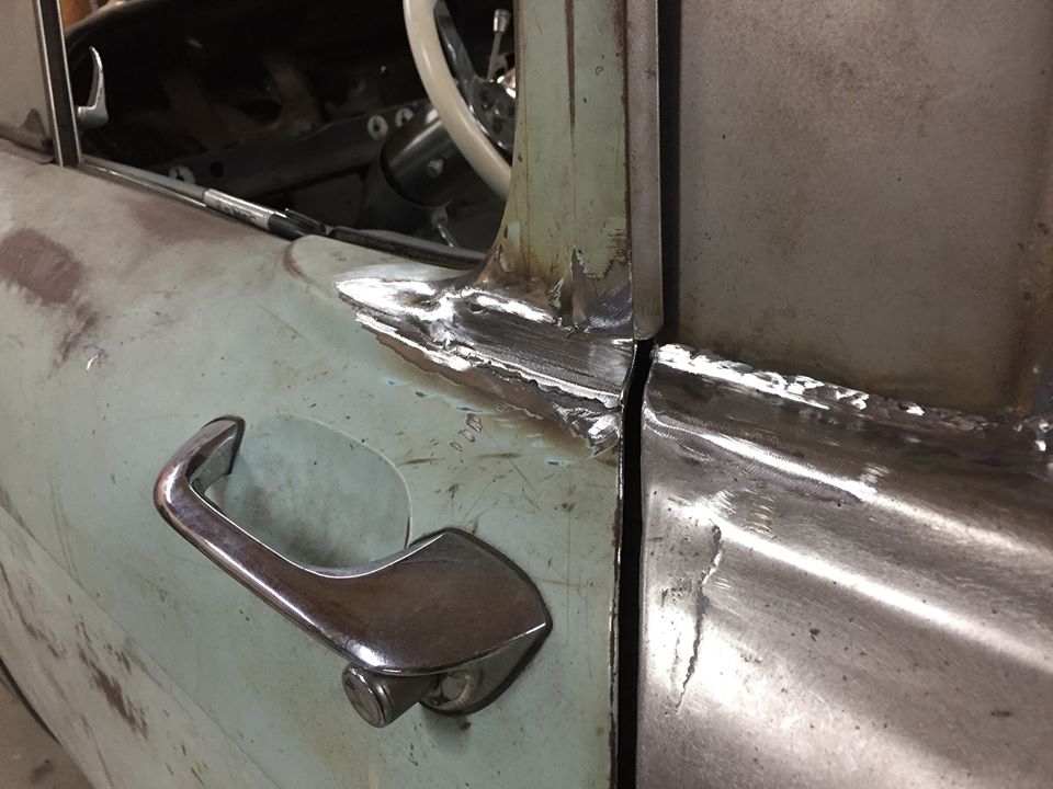

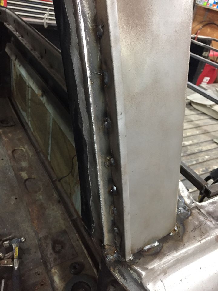

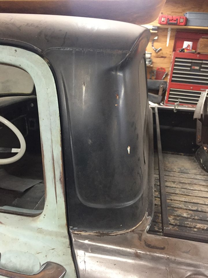

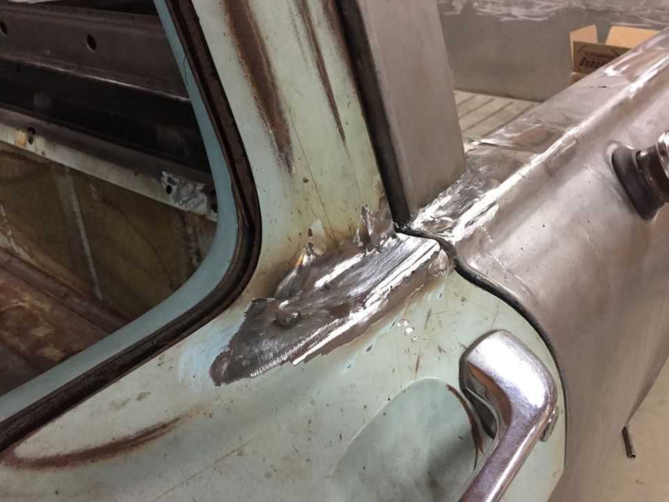

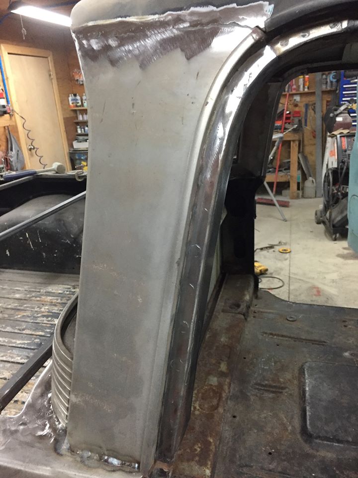

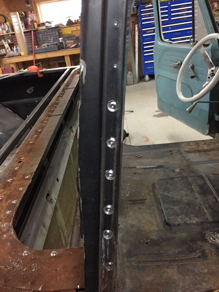

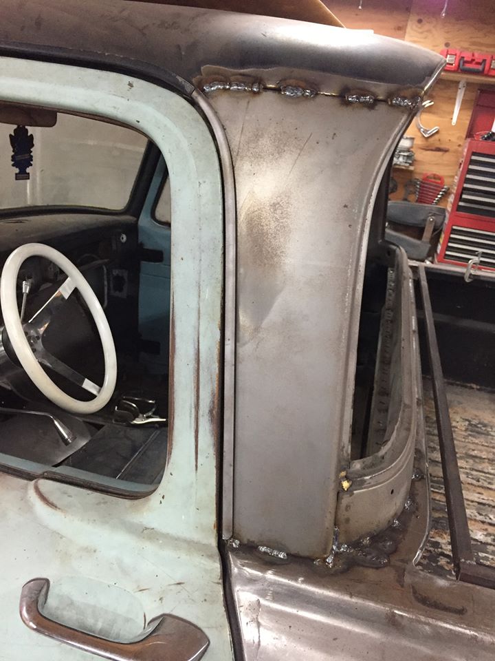

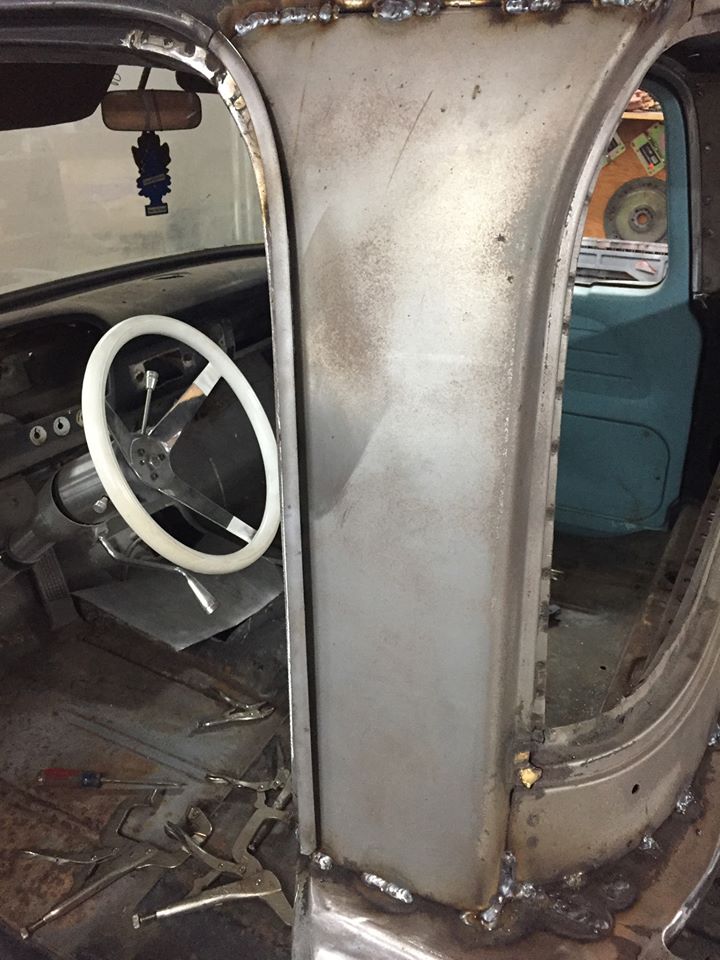

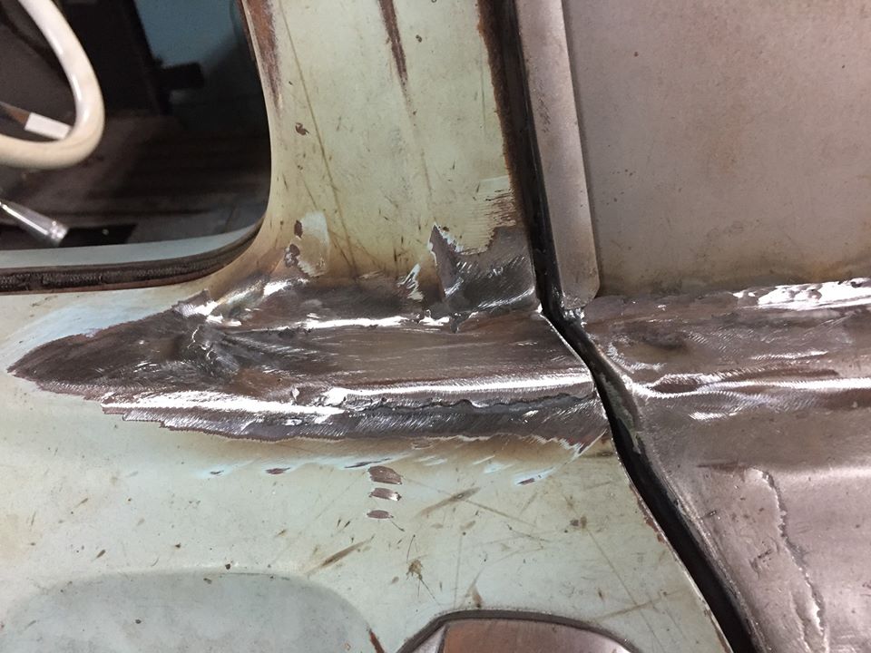

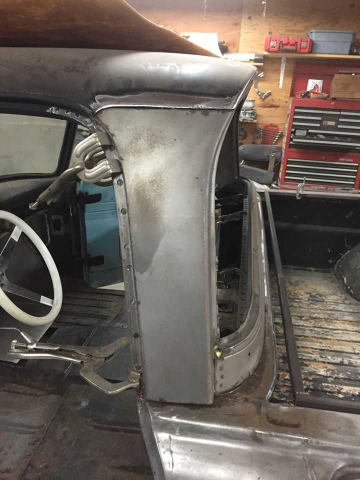

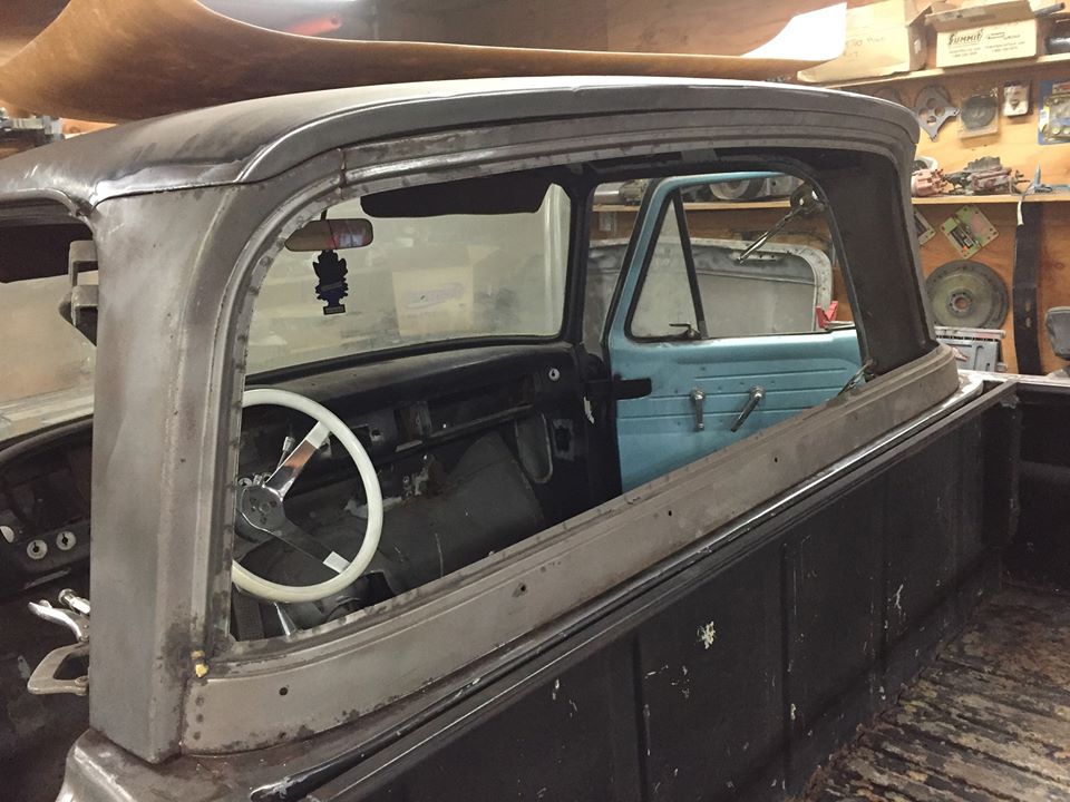

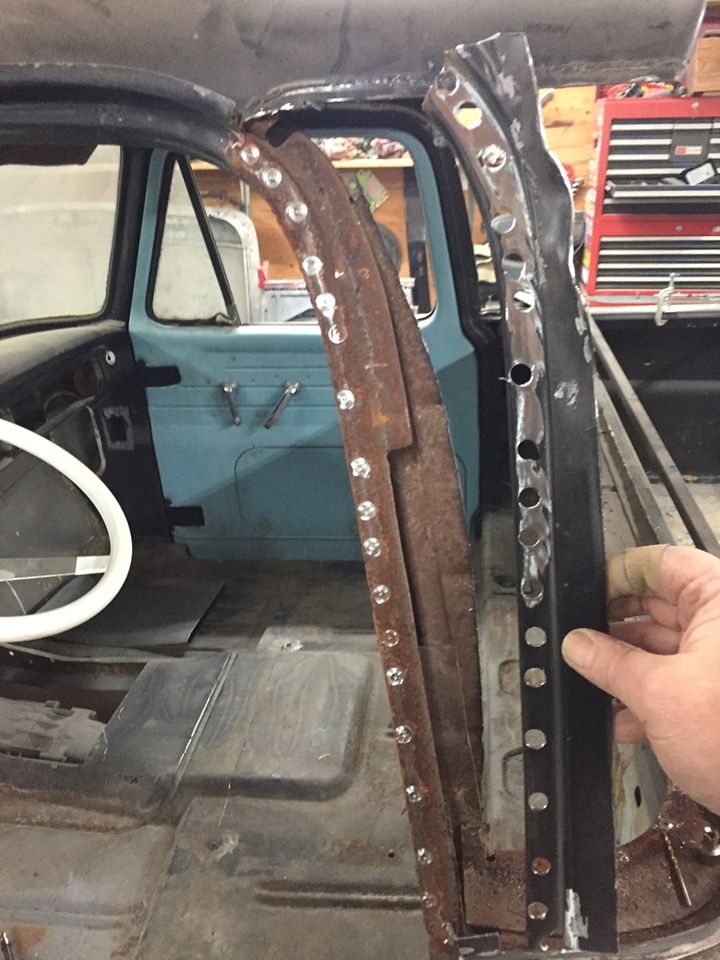

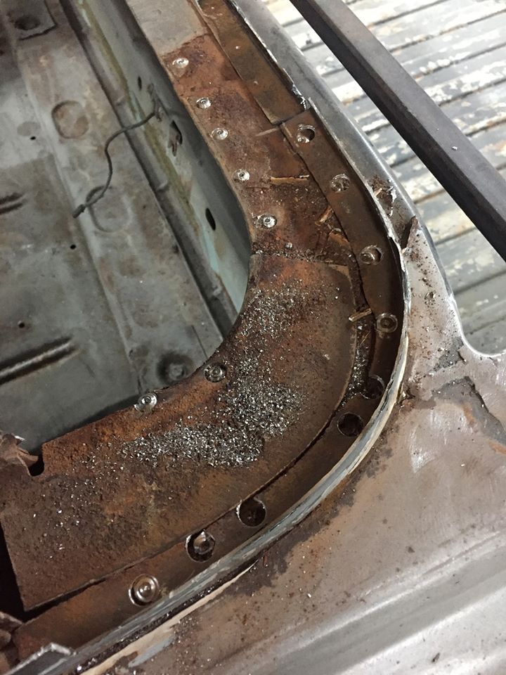

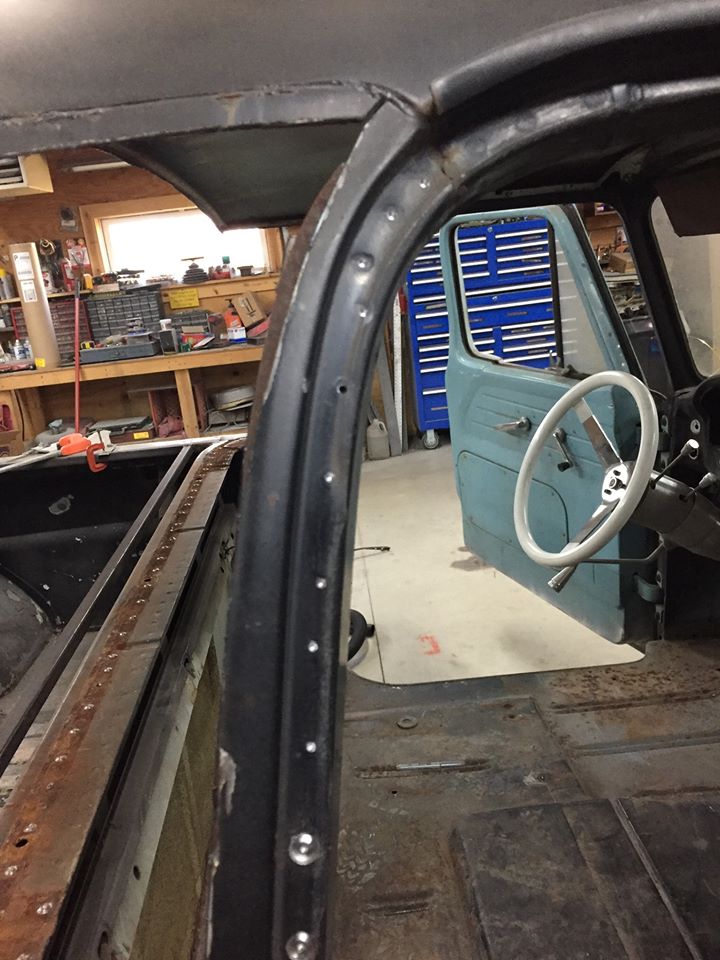

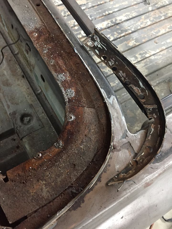

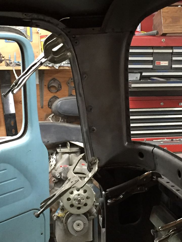

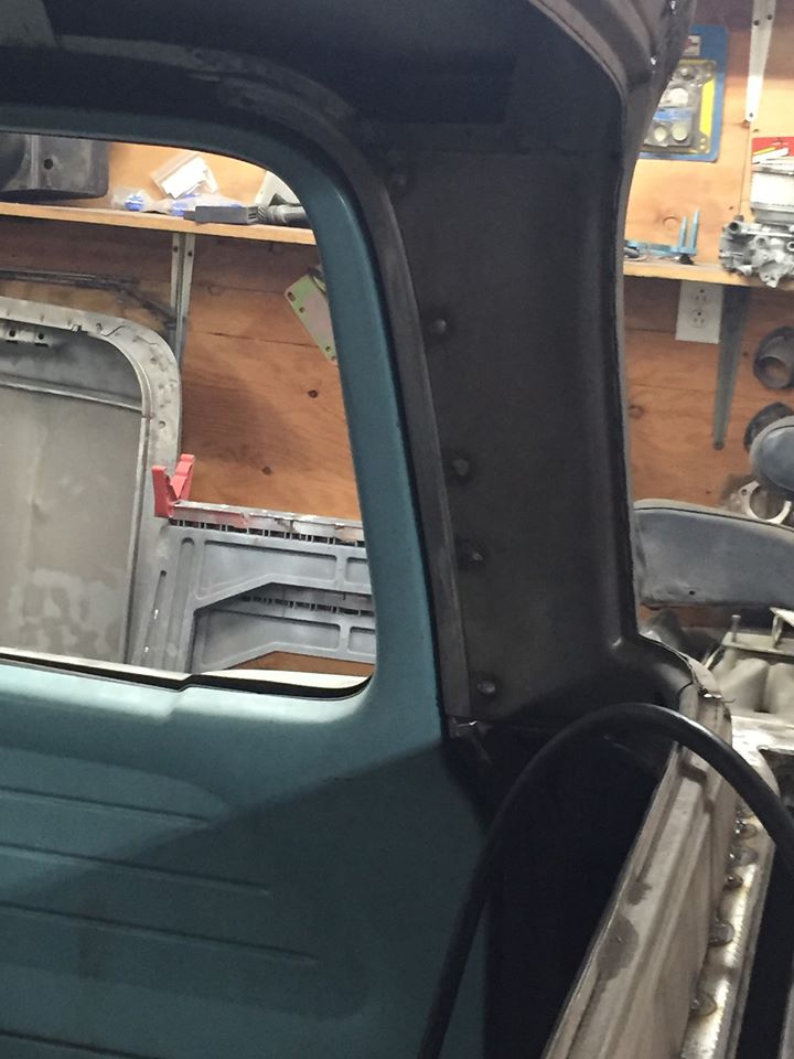

    Been plugging (literally plug welding) along on the unibody. Got the old small window cab section completely removed, cleaned up and literally snapped the big window section into place. Fit great. I was a little worried since this cab section came from a truck that had a tree fall on the roof years ago. Right behind the driver's head there was a place on the outer and inner panel that I cut out, created new pieces and welded them in. There was a short (6 to 8") section that was a little "flat" at the top edge but it will work fine since I'm welding the entire seam shut anyway. As of tonight it's all welded back in and ready to grind some welds down. Then I'm ready to move on to the front of the truck.

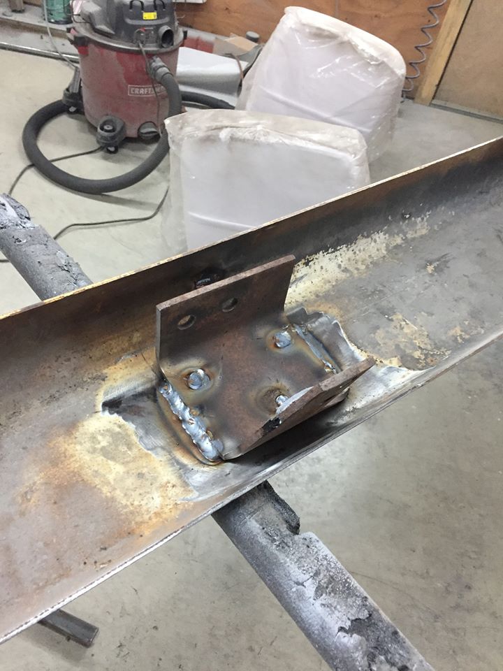

    Get these welds dressed them next up is correcting an issue with the right side frame mount for the engine.

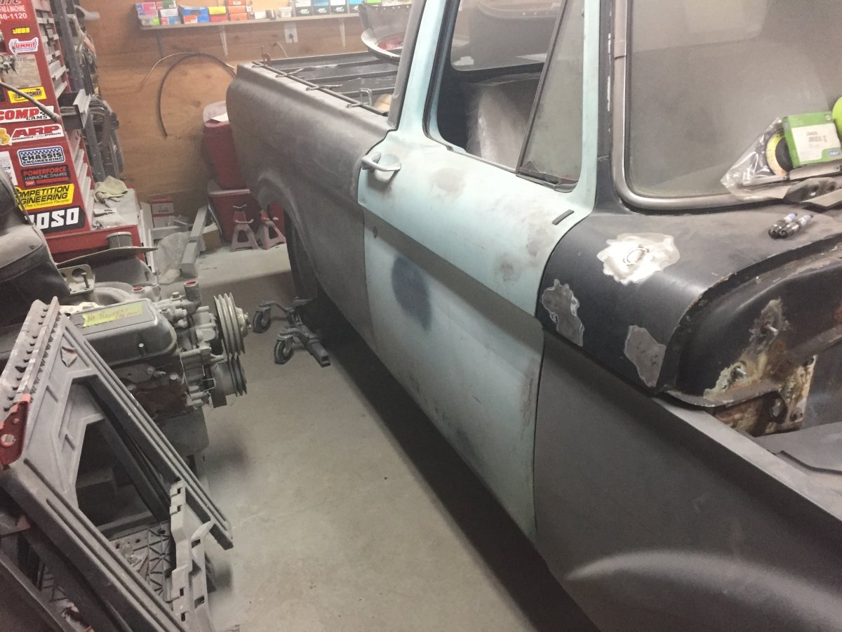

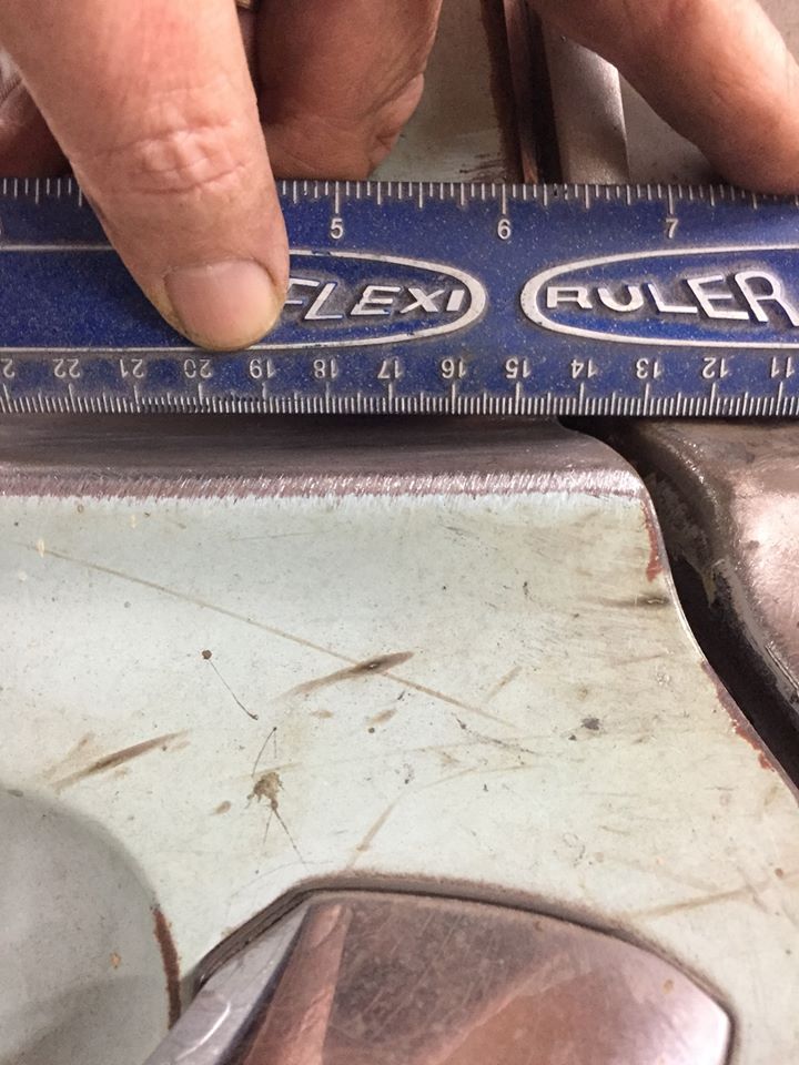

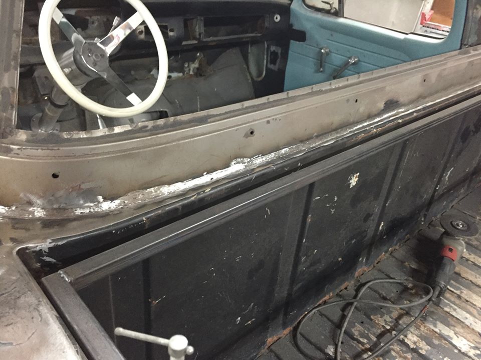

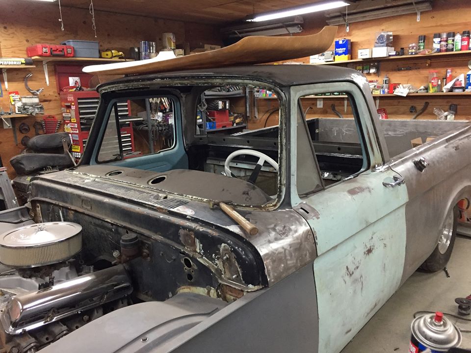

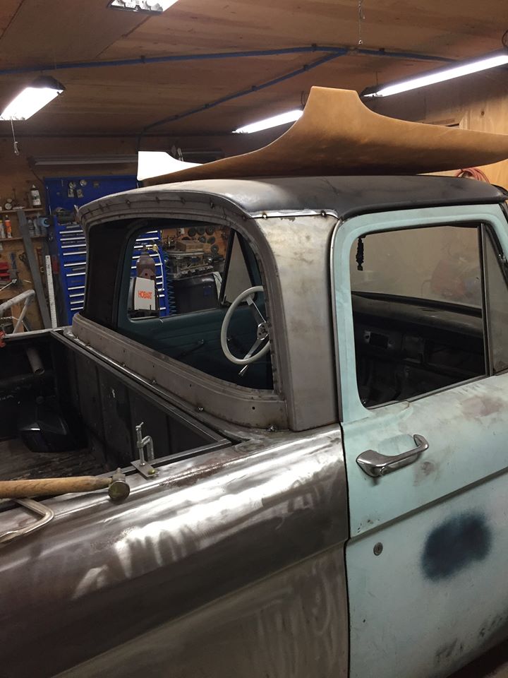

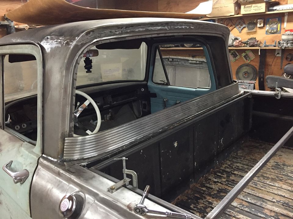

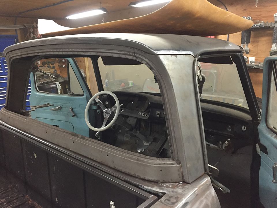

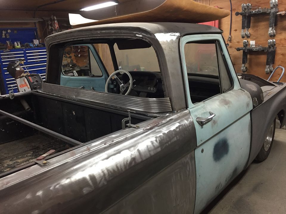

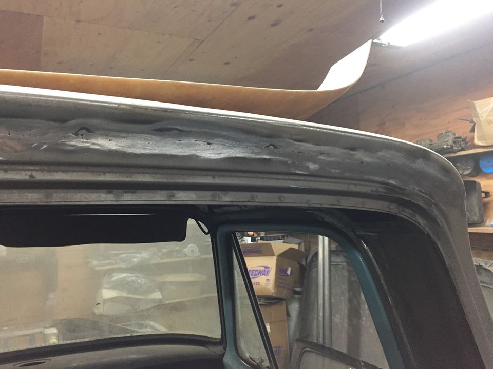

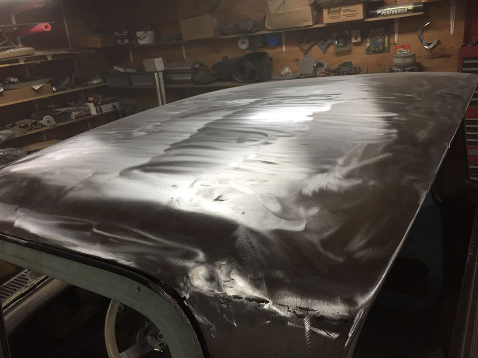

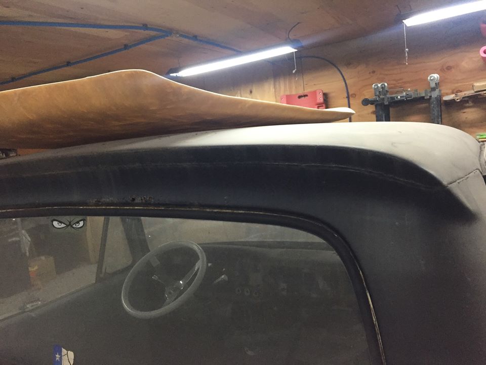

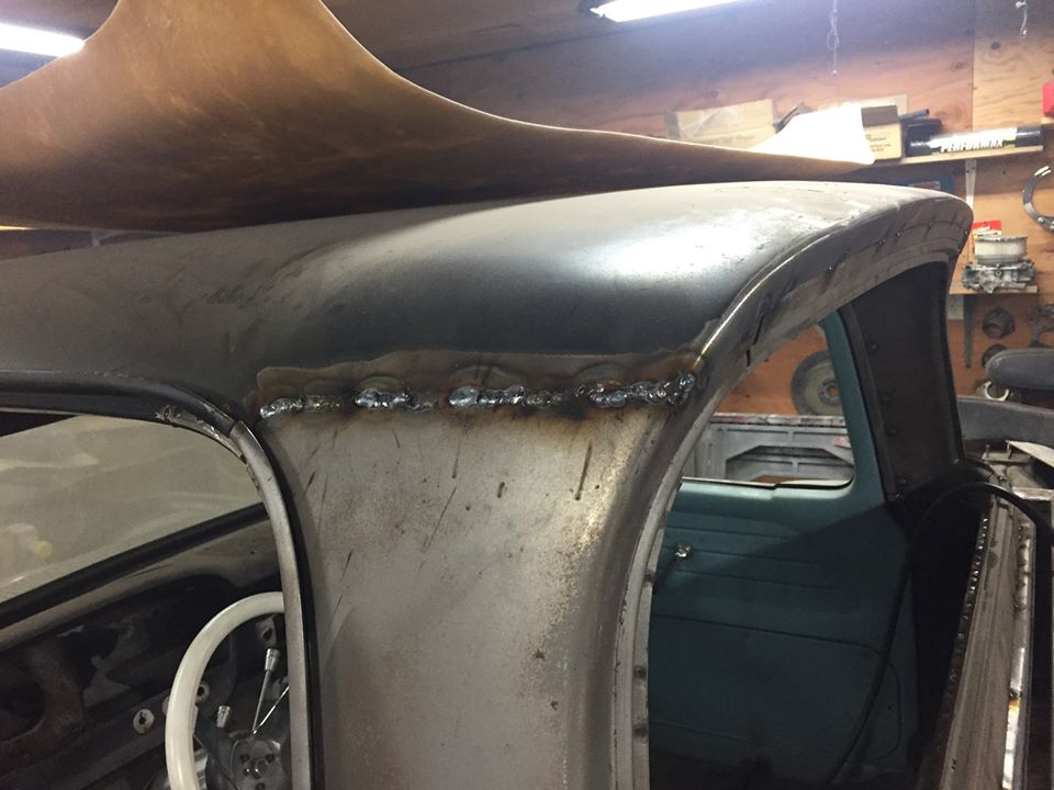

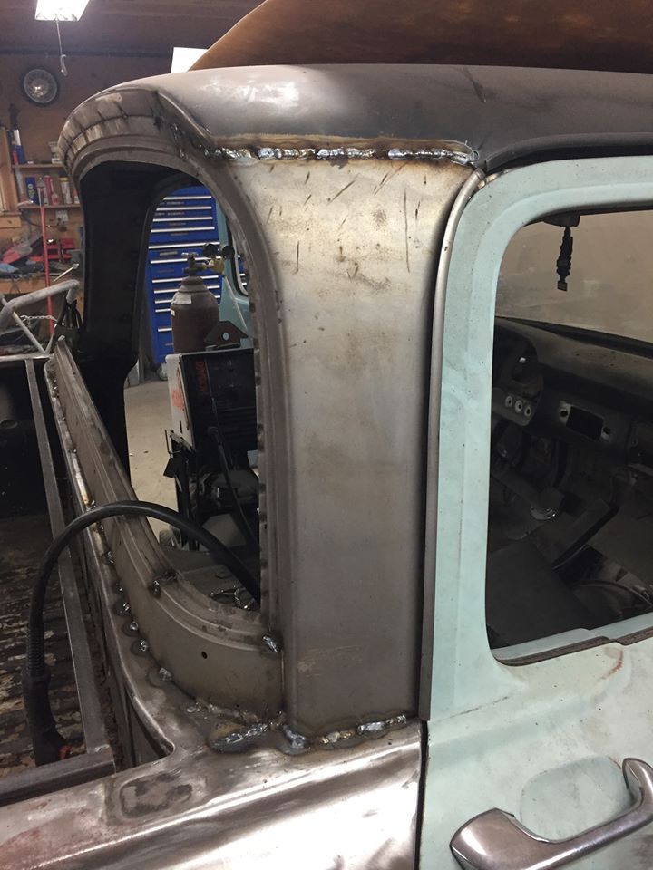

    Still waiting on paint. Hopefully this week it gets done. One of the issues is I agreed when we started this whole process was that I wasn't the top priority for them. He is a very busy shop that does great work. He has the belief that people trying to get to work, get kids to school and make a living are more important than a hot rod. I agree with him. They have had a banner year of deer hits. Not uncommon to get 3 cars in every day. It's been crazy. The upholsterer understands and agrees. At least we're all on the same page and it's winter. As long as it's back home with the "contracted" work done by spring we're good. More time to work on the big window.

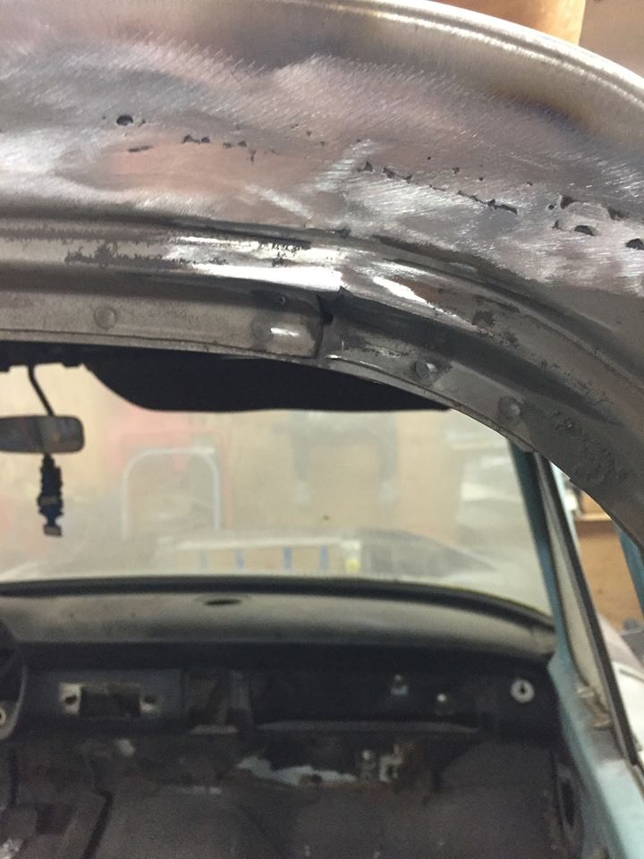

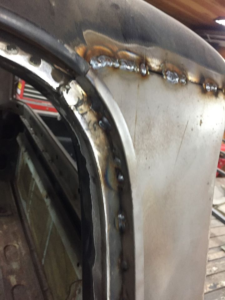

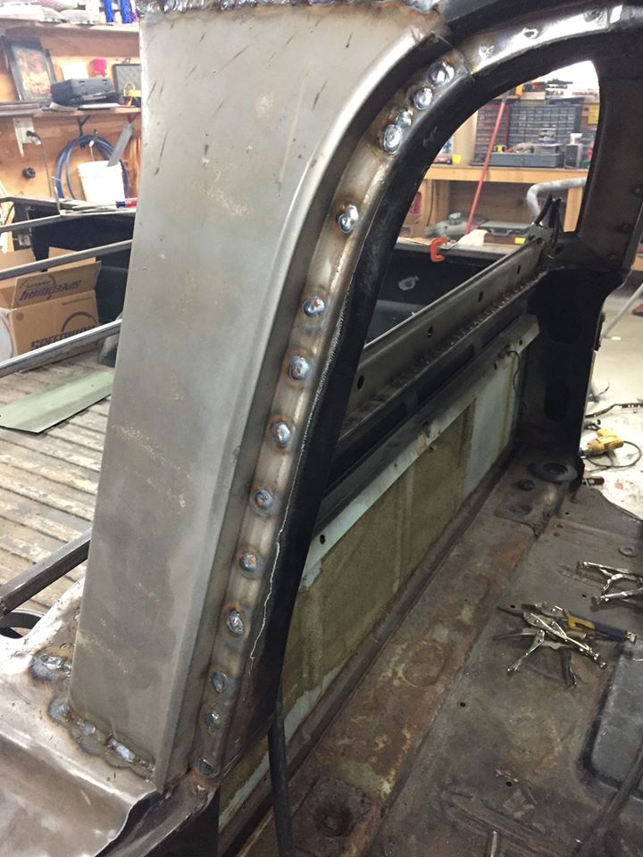

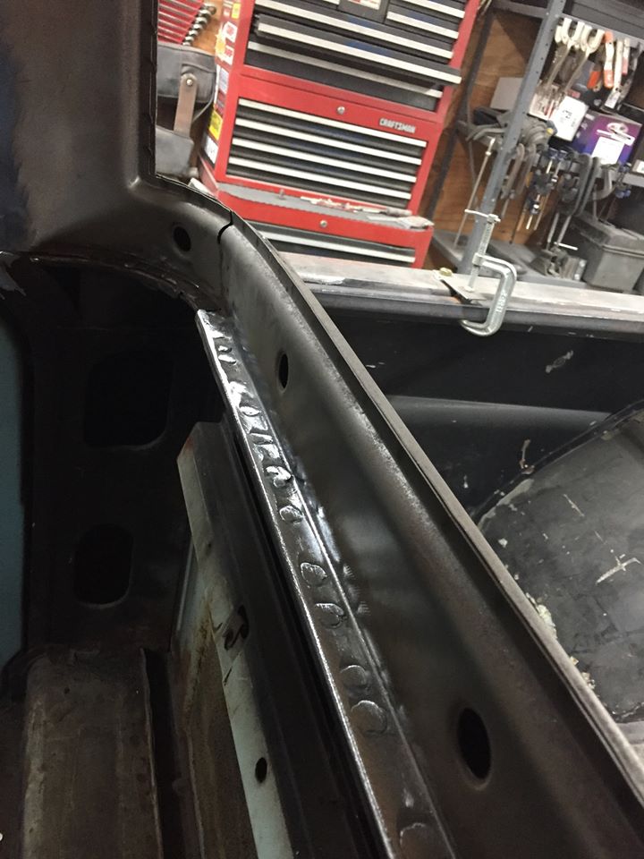

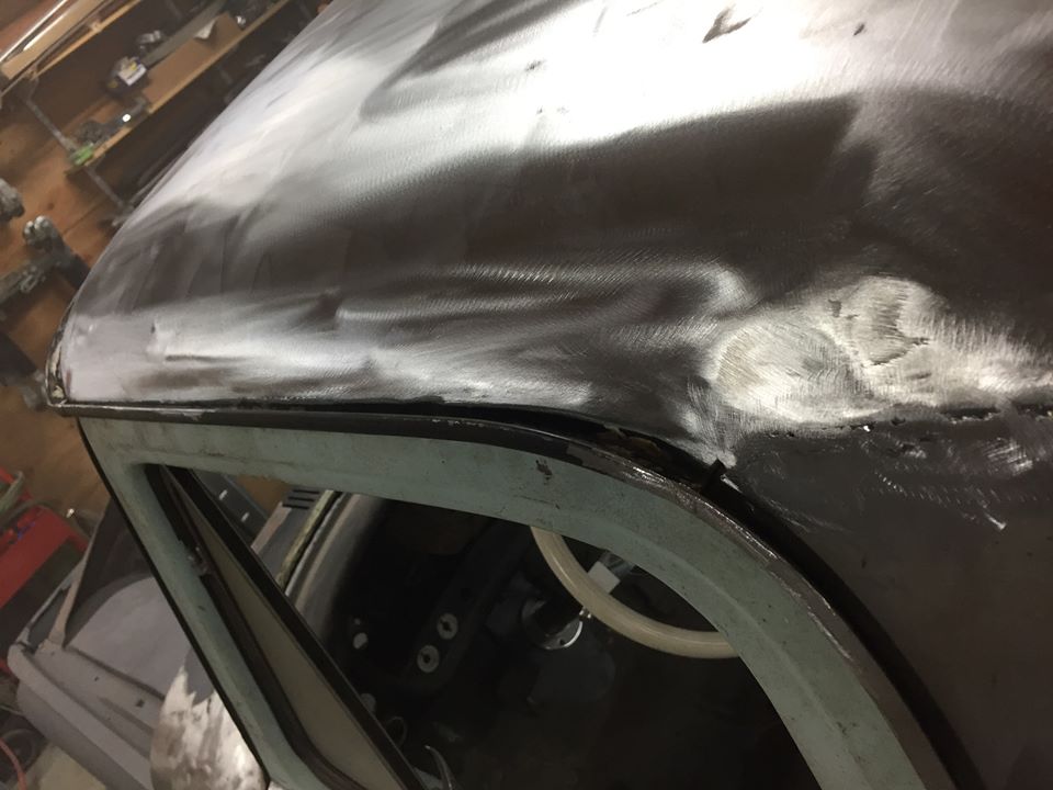

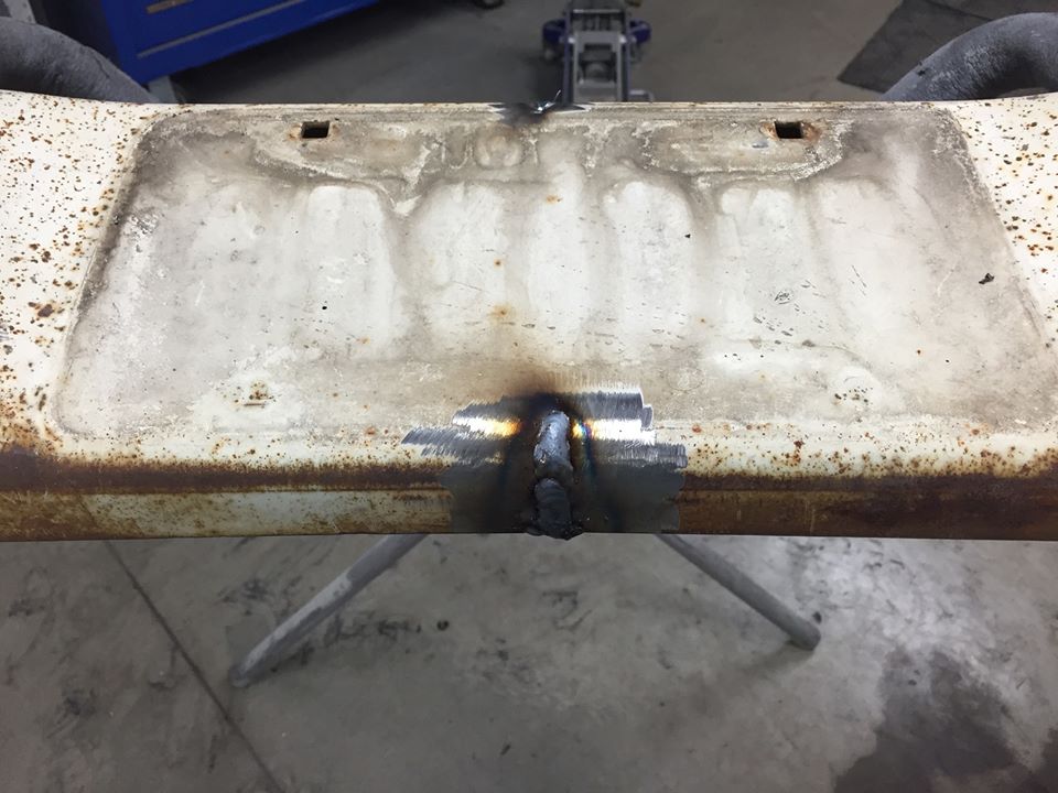

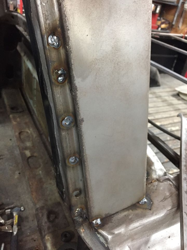

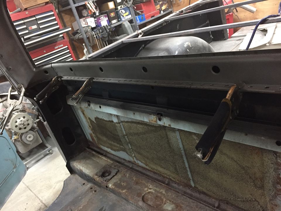

    Did get the big window section completely welded in the'62 unibody and ground down. Still a few small areas that need some detail grinding in tight spots. That can wait for a day when I don't have a massive headache! Trim fits nice and sits square. Also welding in all the seams so it's all smooth when done.

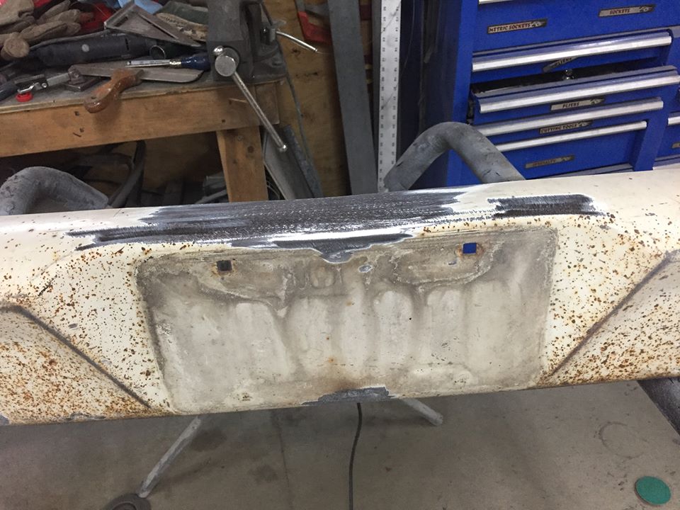

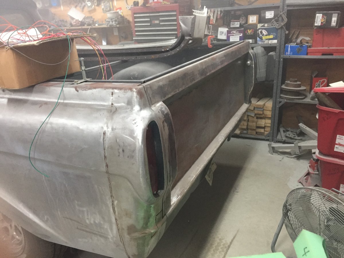

    Next up I mounted a '66 style front bumper with the '62 mounts. Bumper bottom edge was a little bent up so spent some time with a torch, hammers and dollies to straighten that bottom lip. Cut some reliefs in it to change the arc so it followed the gravel pan better. Clamps, bottle jacks, shims.....whatever it took to make the shape correct then I tacked everything in place. Everything is welded up, ground down and the last thing I will do to it is narrow it about 1-1/4" per side. Won't do that until I do the final fit on the front Sheetmetal.
    This week we try to fix that motor mount issue. The wife gave me the cold from hell and been down all weekend. We'll see how that all feels this week. I'm kind of slow to recover on the cancer drugs.
    Had an infusion last week. Things went well. They upped my dose but spread out the time frame. Now on 1300MG every 3 weeks instead of 1000MG every 2 weeks. Like the extra week off in there but the higher dose seems to make me feel a little crappy for a couple days. It'll work. Reports have been good, labs great and the blood pressure has almost behaved itself. Almost.

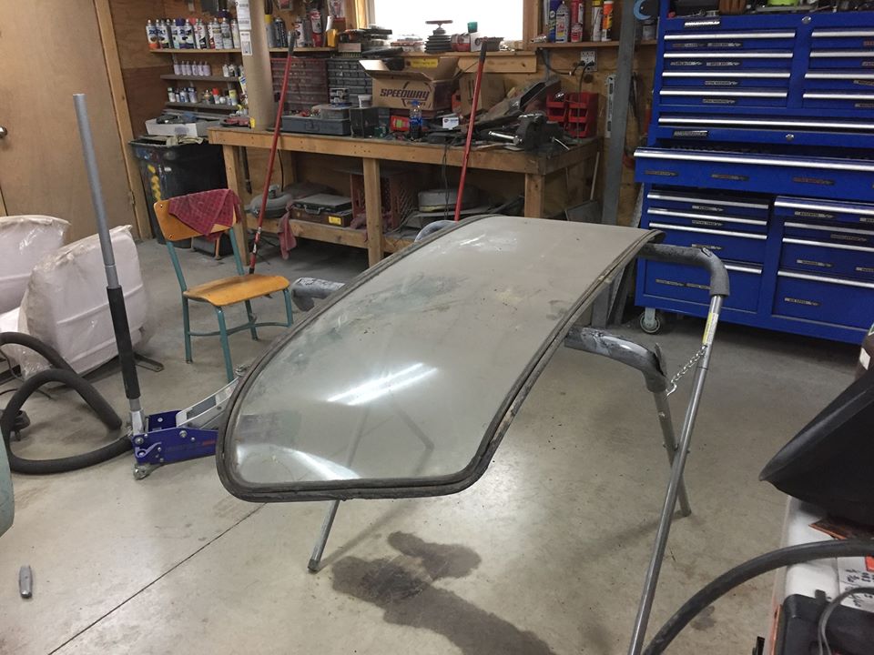

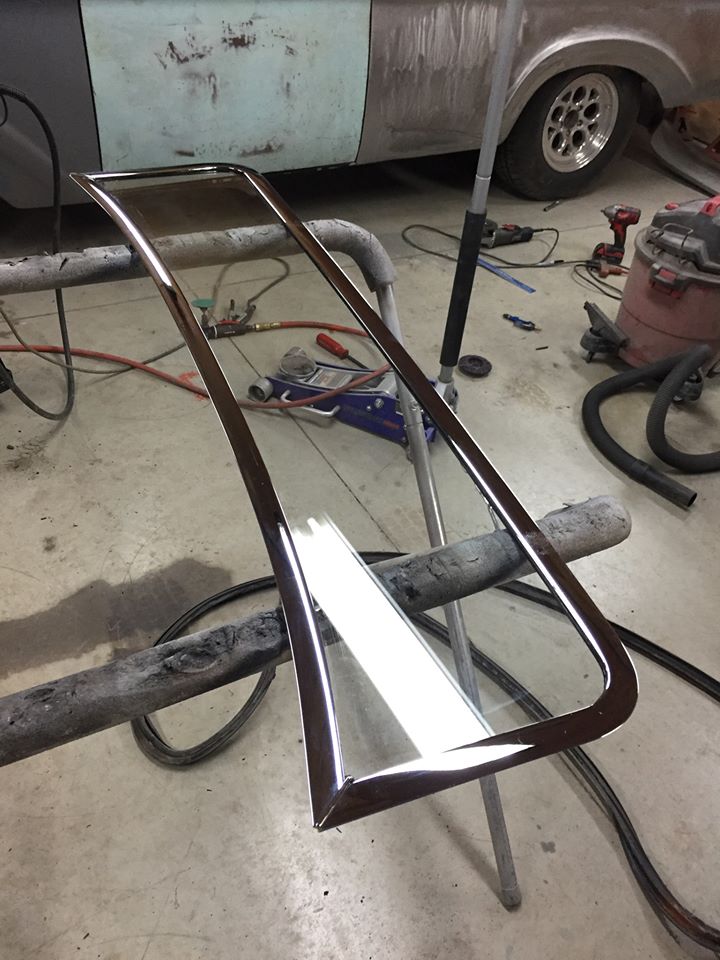

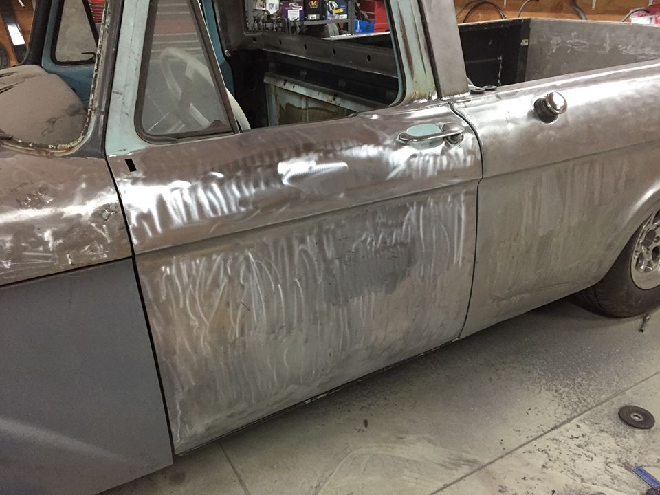

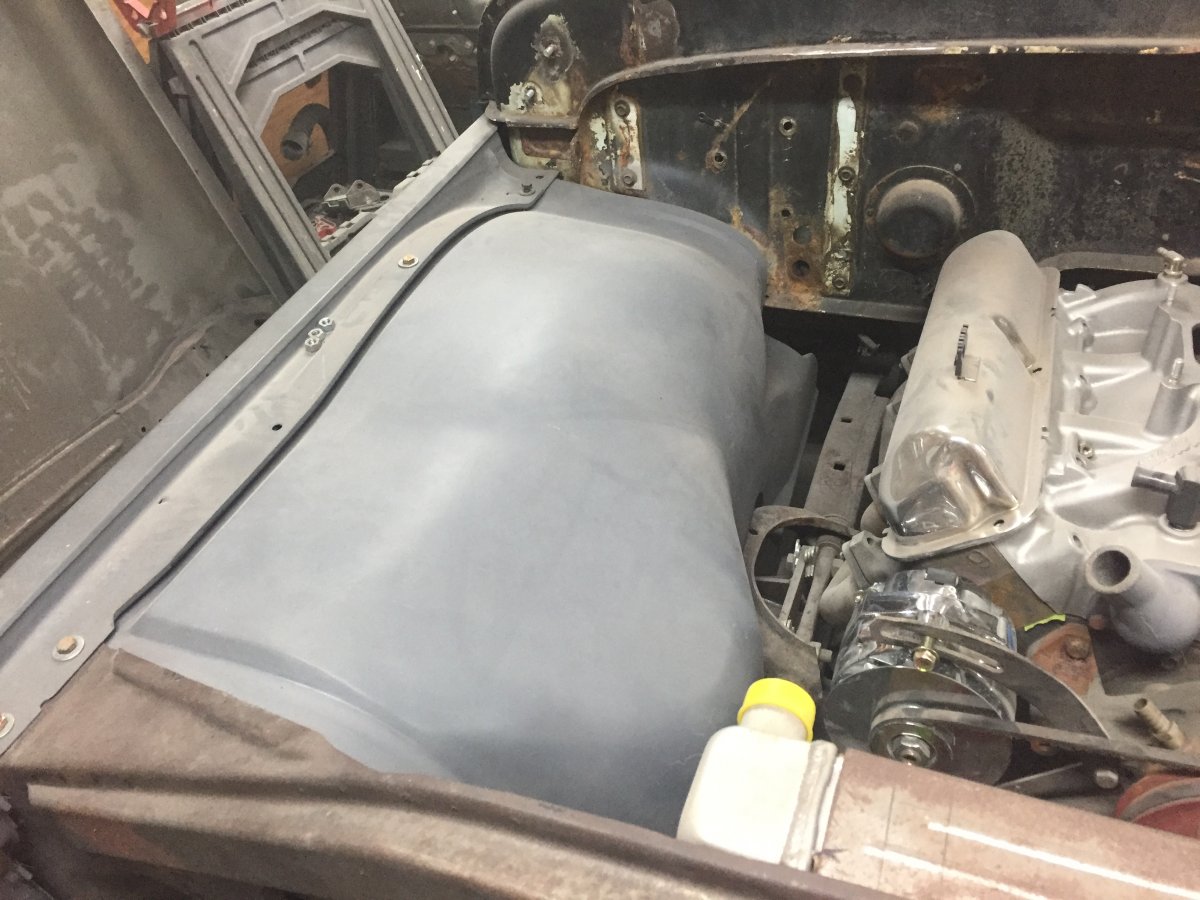

    Got my '32 windshield frame/glass back today! All together. Now I have to detail the brackets, hinges, slides, etc. and get it all put together for the final time.
    Decided it was time to get that cracked windshield out of the unibody. It's now living in a friend's dumpster with the back window.

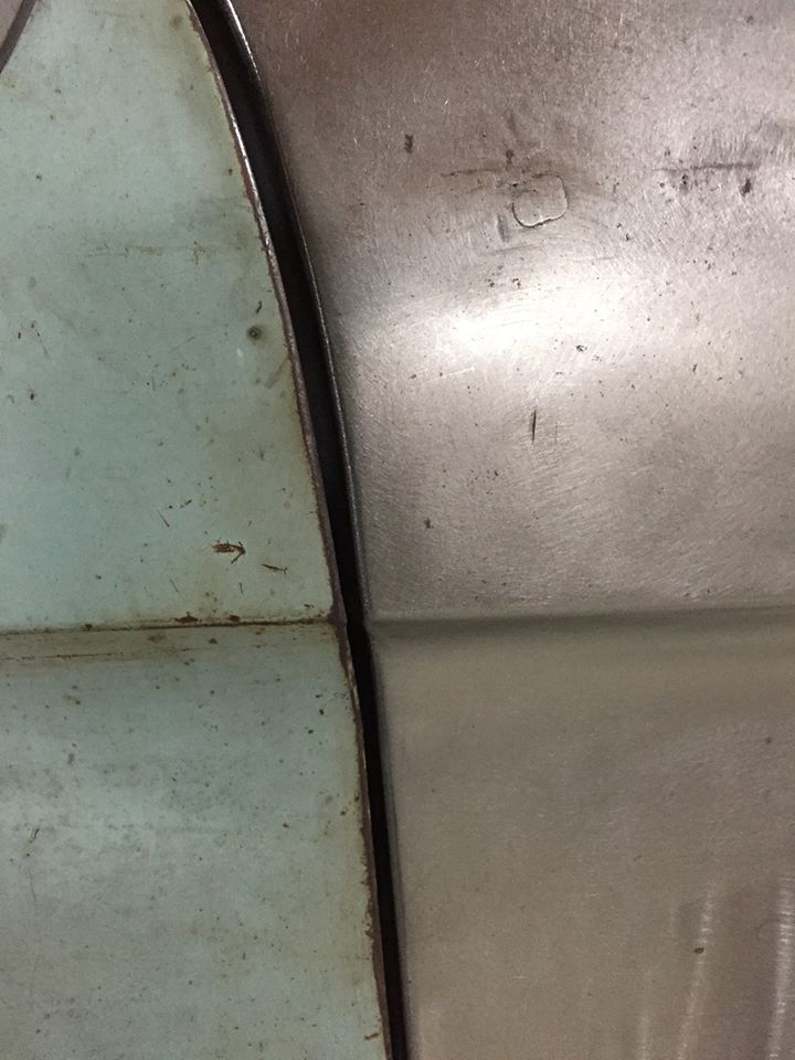

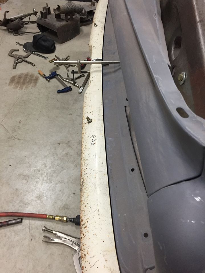

    Have stared at the door fit on the unibody since day 1. They aren't the original doors or hinges and they don't fit worth a damn. The original left door was wrapped back around the fender (somebody backed up with it open and caught it on something before I bought it. I had already repaired the hinge pocket damage years ago.). Decided it was time to deal the fit issue today. Adjusted the door until the gap was workable and the character line running from fender to door to box side all lined up. Once that was done the top of the door, right above the door handle, was right at 1/8" lower than the box was. Created a 1/8" x 1" x 6" filler piece and plug welded then perimeter welded it in place. Ground, sanded and sanded some more. Got it looking decent and still keep my gaps and character line. Details.
    Removed a bit more paint to check the alignment for sure. Looks like a keeper!

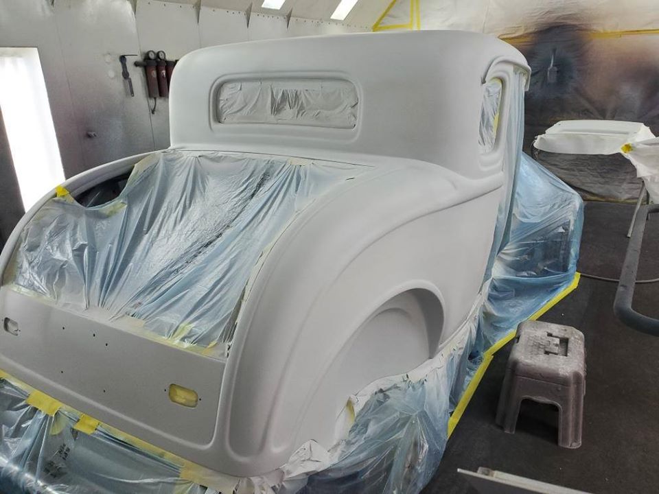

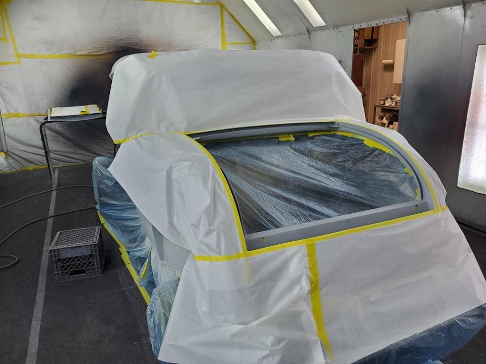

    On the '32 front: Got a few pics from the painter today. Last round of primer (hopefully) and shot the trunk jamb in color! Hoping it's about ready for paint. Was down and looked at it yesterday and discussed a few small areas so everyone was on the same page. Things should move fast now. Should....

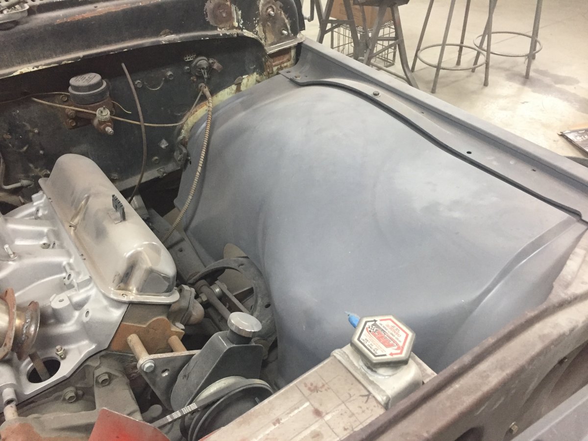

    On the unibody front: Also stripped the last of the paint I'm stripping at home. Everything left will be blasted. Both doors now adjusted, only a couple small rust areas to fix. Several smaller dents to deal with. Really need to stop and clean now. About a half inch of old paint dust laying on the floor now.

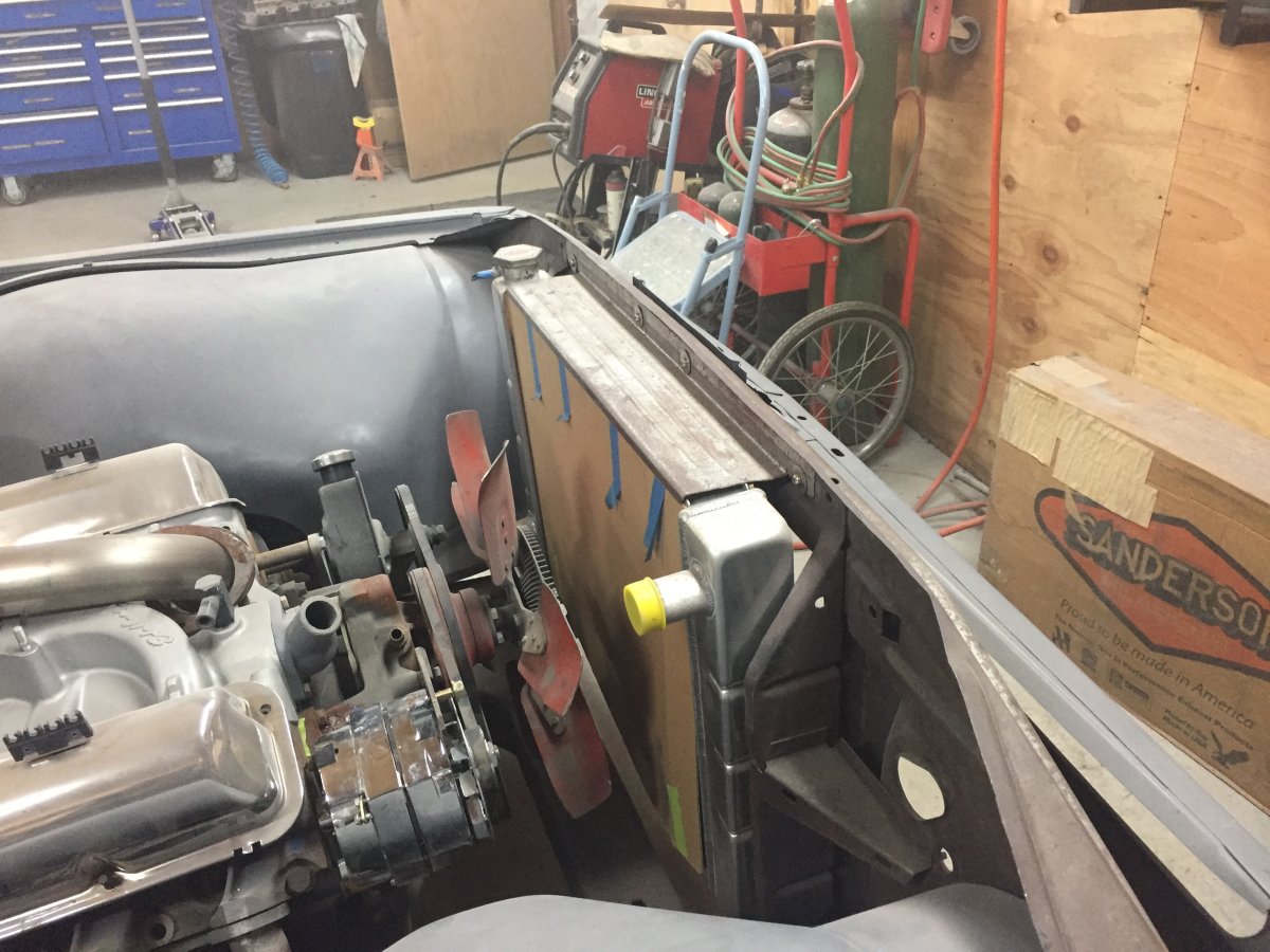

    Years ago I started down the path of putting a 430 MEL in the truck. Had to raise it up 4" to clear the front sump above the rack. That put the tranny into the bottom of the floor. Cut part of the trans tunnel out to make things fit. After selling the MEL and swapping to a 390/C6 I needed to put the floor back together. Started down that path today, too.
    Progress on both fronts.
