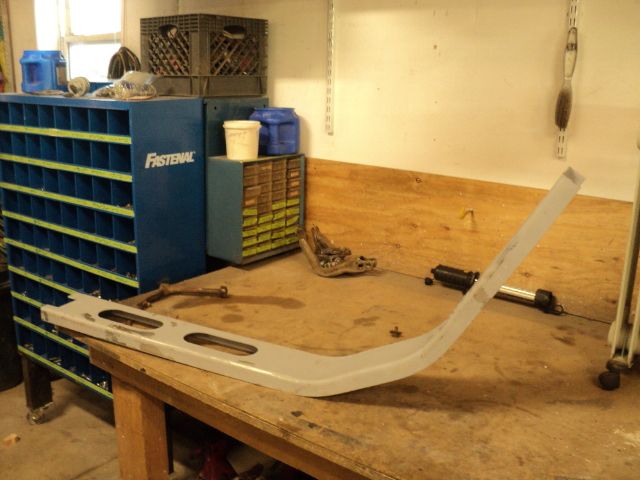

    So as the story goes, I was building this for a customer of mine. He ran behind on the bill, and things got in his way. A few eamily members came down with cancer. That is enough to slow anyone down. This truck was originally being built to be a full fendered truck for him. I am changing this to fit my liking now. So I am doing fenderless with pinched rails, shortened bed, and a mild channel with a few inches off of the top. The build itself is going slower than planned. But we are having a baby soon, so that and my steadily growing buisness are not allowing me much time to get to it right now. But I am still doing a bit every week. Here is here we are so far.
    This is where we started at.
    fit in some 32 k member rails
    when we were building it for him, it was going to have a 4 speed. I just put my 4 speed in my family suburban, so i am going with a 700r4 this time instead. I already had the trans, shifter, and 35o laying around from another project. So I am using what I have to keep the cost down a bit. And besides, the 700r4 will make it a great cruiser.
    this had a drop axle and drop spring set-up but I wanted to go with a different style and get it even lower. This seemed like a great alternative to accomplish that. I pinched the rails. Here you can see they are crudely tacked together at the moment so we can get it all tacked to gether and put it back on the bench for the finish welding.
