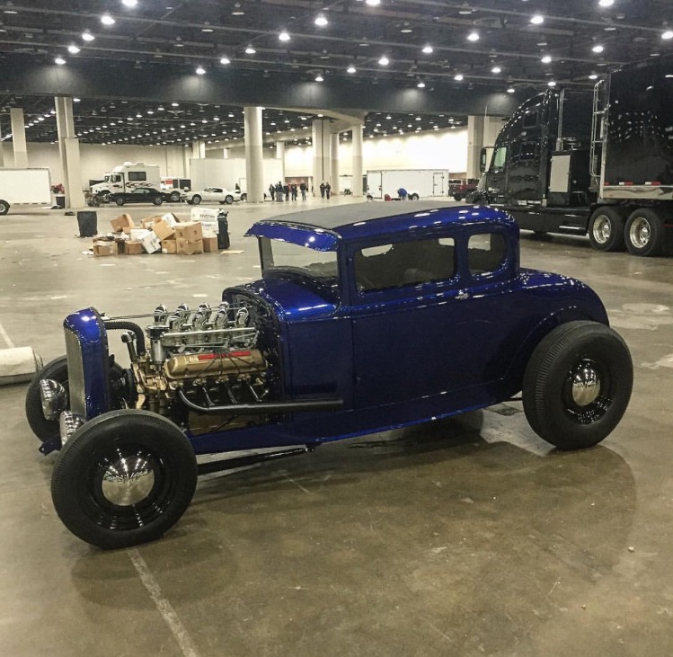

    About 5 years ago I bought a 430 Lincoln/ and 8x2 set-up from Larry Brunkala at Precision Fabrication. At the time I wasn't sure what project it would go in but it was such an imposing combination that I had to have it. He recommended Tony up at Ross Racing Engines as someone who could build this engine properly. As you guys know, they have a plank head similar to a 348/409 and take specially configured pistons etc. to work right. I contacted Tony and he agreed to take it on. We sat on it for a while so I could think about what to put it in. After that he and Bob Hilton started to build his Lil Miss- chevious coupe. I really liked what I saw, so I went out and looked at his finished coupe. One thing led to another and I found a really nice coupe body in Southern Wyo. and hauled it out to them. And Finally! this weekend I got to see the finished car in person!

    Thanks for your comments guys, After running a business for almost 25 years and getting two boys through college, etc. this has been on my mind for a looong time. I was really jacked to see it in person. Here's specs:
    1960 MEL 430 bored/stroked to 487 @ 10.25:1 . Hyd. roller cam. Weiand Drag Star intake. All carbs are functional., the main reason we opened up the engine size. Runs on center 4 then catches outer 4. We'll need to run it to fine tune the transition. Front sump pan was shallowed a little to gain ground clearance as the block is really tall. then floor was lengthened and has trap doors in it. It looks totally original, Tony did a hell of a nice job with that. Holds 13 qts! The deuce chassis was stretched 2"to fit that beast but it doesn't show really., thank you Ford for front-mount distributors! WC T5 with some mods to beef it up. Rear is early nine inch about '59 vintage. '40 rear spring, P&J bars. Lincoln brakes. Original parts wherever we could.
    I didn't really want to re-invent the wheel. Lord knows there's been everything in the world done to these things and I love all of them. I just wanted a good, solid, bad-ass hot rod!
    And I got it.
