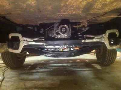

    i ran into a little snag. one step forward two steps back. now that i swapped out the old rear for a 9'' my drive shaft is too short. so instead of getting a drive shaft made for the early ford 3 speed, i might as well go all the way to the dark side and run the th350 that came with the sbc. i have it, i might as well use it. now the big bitch is this cross member.
    i started to grind the rivets out last night

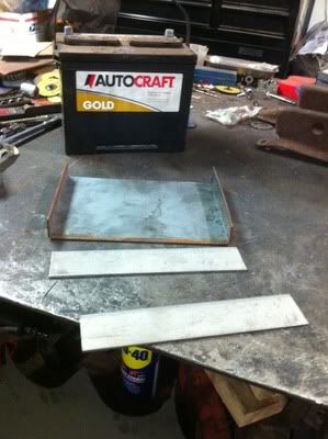

    after the school shootings, holidays and snowstorms i am working on the f1 again. last night i salvaged the battery tray.
