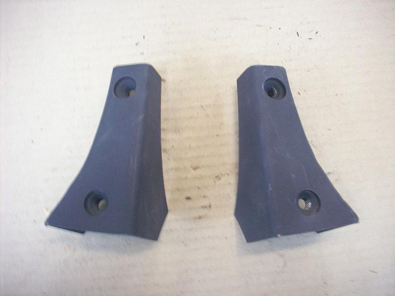

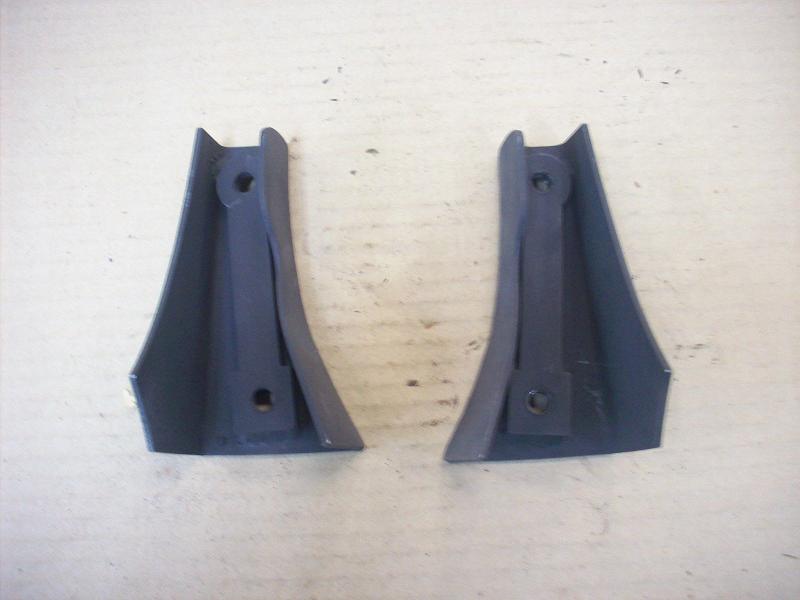

    eBay seller "crazyleeroy" sells replacement cowl post tops/windshield post mounts. No personal experience with them, but they look to be well done. Might be an alternative to cutting up an (expensive) Brookville cowl post.

    I too have a set of those bought a couple years ago. mine don't have the bar and round bungs on the back side, just a couple square nut's tacked on. made out of very thin sheet metal and fit like a saddle on a sow. another 100 dollar piece in the junk pile.
