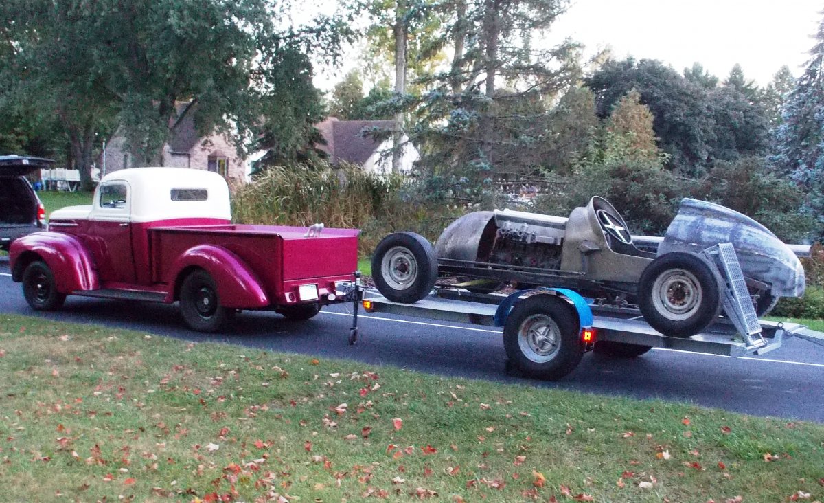

  20. I have decided to take this project in a different direction, and more in line with my family's history.
    It will still be based on a model A Chevy six powered and use all the parts I all ready have!
    A little hint at what is in the works-
    My Great Uncle Don Weyl (Crew member not the driver)
    My father Willard Palmer building his first late model-
    [​IMG][​IMG][​IMG][​IMG]
    The chassis for the second late model-
