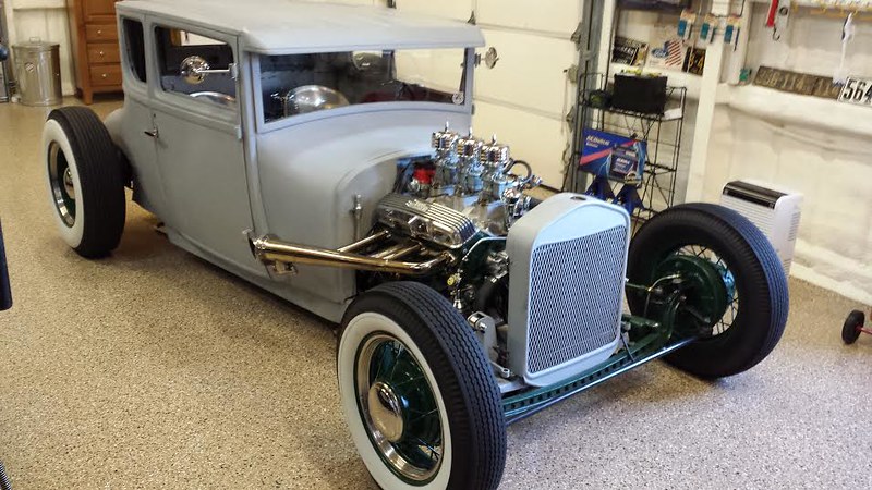

    Hello HAMB,
    My name is Justin and I am 22 years old. A couple of month ago I purchased my first hot rod, a 1926 ford model T coupe. Ever since Ive been a kid going to shows, I knew I had been wanting a rod, as well as seeing my dad and uncles have many old cars ranging from 38 fords, to willys gassers and so on. I bought the car from a guy named jody miller from Iowa. The car is in primer, no interior or windows, and pretty much just needs finishing up. He shared with me some of the build photos, so I will start with sharing those with you all. I cannot wait to finish the car, as it will take me some time though as I kinda spent all of my funds on the car, but I will slowly be making progress. Anyways Lets start!
    The build started with a pretty solid 26 coupe body from an auction in Nebraska. The body has the usual rust spots and was missing trim
    The chassis was then built. It is a custom 2x5 tubing that is pinched in the front and z'd in the rear.
    In the rear, a 7.5 10 bolt rear end with 3.73 gears are used. To hold it in, chrome american coilovers and a ladder bar setup are in place. As well as f100 brake drums.
    For the front, It has 40 ford bones, a 4 inch drop drilled i-beam, and 53 f100 drums. The wheels are 35 ford wires. But the rear wheels have been custom widened 6 inches!
    The chassis became a roller!!

    Rust repair came next.
    Time for a haircut! 7 inches off the top sounds nice.
    Much better. Now for the roof, a 64 impala wagon roof skin was welded in, along with a trim strip around the whole car to make it look nice. A visor was also welded on at this point. Love the ribs and the trim gives it a finished look!
    Cowl vent was shaved next. All rust fixed and primered over!

    Motor time! The engine is a 327 out of a 69 camaro. New heads and roller rockers were installed, along with a 270 lift cam. Eldebrock 3 deuce intake with nine super seven carbs. Eldebrock valve covers and a bunch of chrome goodies.
    Front shock mounts were made. They also hold in the model T headlights!
    Also modified T grill in place
    Chassis roller! The tranny is a th350 with a 2800 stall and lokar shifter
    Flaming river steering box, 40 ford wheel and a custom mount were made
    The floors were welded in and firewall done, and all the odds and ends worked out. Then this is about where I purchased the car.

    On a side note, the last two times I drove the car I got really bad death wobble each time. Does anyone have any tips on how to eliminate this? I heard having 1/16th toe in helps, how/where would I align it? I dont know any shops around me id trust with an old car

    Death wobble, a PIA anytime but I think especially frustrating when you are driving a new car for the first time. The subject is well covered here on earlier threads, search Death Wobble. Here is my 2 cents worth...
    1. Does it start when you hit a bump in the road? If so, caster setting, (7-10'), toe (yes 1/8" in is good on bias tires), all connections tight, steering box properly adjusted. Make sure the front wheel bearings are adjusted properly, the wheel spacer/adapter on the font has moved the load outward and will magnify any bearing slack.
    2. If it begins as you build speed, like 50 MPH and above, I would examine those wheels, they look to be 35 Ford? Just spin them and look for lateral and radial runout. Also the bias ply tires. Have they been balanced properly? A product called Dyna Beads can help smooth out tire balance challenges. The combination of early Ford wires and bias tires can work, but sometimes requires fine tuning.
    Your lower shock mount is well inboard of the wheels. The further away from the wheels, the less dampening they will do as the shocks will barely be moving. So now any hopping, from bumps or imbalanced tires, the spring will not get much help from the shocks.
    Your spindles are mounted in a reversed position, placing the tie rod in front of the axle. This can work, but may make front end tuning a little more touchy.

    Thanks for all the info!! This stuff is all new to me on these old cars. It seems to happen when I hit a bump, because the first time was well over 50mph and the last time at prob 15 mph. Yes they are 35 for wires, I was thinking go with the beads and adjust the alignment. Any tips on how I could possibly go about doing it on this car?

    To set or check the toe in, use a steel tape measure. Hook the tape end into one tire tread and pull the tape back to the other tire. (furthest outside tread you can). The front wheels must be as "straight ahead" as possible. Roll the car back and forth a little to help dial it in. Make the last roll in the forward position. Make your measurement "halfway up" the tire, where the tire is the largest in diameter. Hold your tape level. You will measure the "front side" of the tire, and the rear side. When you measure the rear, there may be some restriction, like the shocks or such that keep you from getting the tape exactly where you want it, try to make your measurements at the height of the kingpin. The rear should measure 1/16 to 1/8 more than the front, using the same treads as you used on the front side measurement. If you need to adjust this, loosen the clamps on the tie rod. Then twist the tie rod. One side is right hand thread the other is left hand thread.
    With the front wheels straight ahead, place an angle finder on the top of the kingpins. The car should be sitting level so be mindful if your garage floor has an obvious grade. Look for 7 - 10 degrees, if so, you are OK.
    You axle appears new, so the camber is probably fine. Camber adjustments are made by bending the axle, that is not a practical job in a home garage. Front end shops that handle large trucks can bend axles to adjust camber.
    You can get Dyna Beads online, just type in Dyna Beads.
