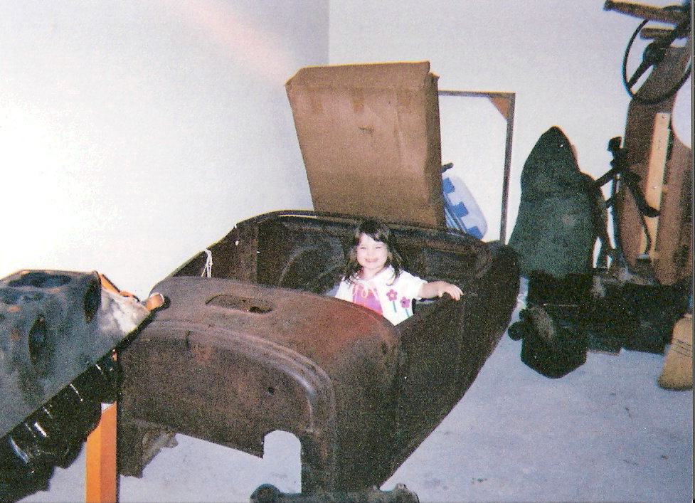

  30. Clayton....your T is amazing. I've been silently stalking it since you first posted this thread.
    Now that I'm nearing completion on my 54 tudor, I'm starting to collect parts for a 26/27 like yours.
    I pulled a body out of a gully in north Texas in the late 90's but had to let it go several years ago. (my daughter in the photo is now 16)
    What's your opinion on using a Model A chassis? Do you think there's anything to be gained from doing so? I ask because they come up for sale around here a lot....T's not so much for some reason.
