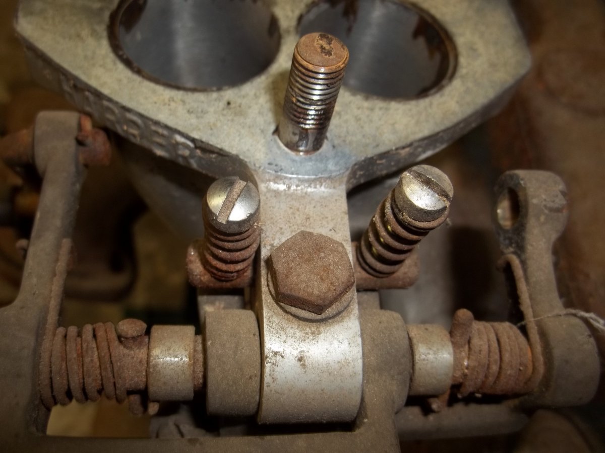

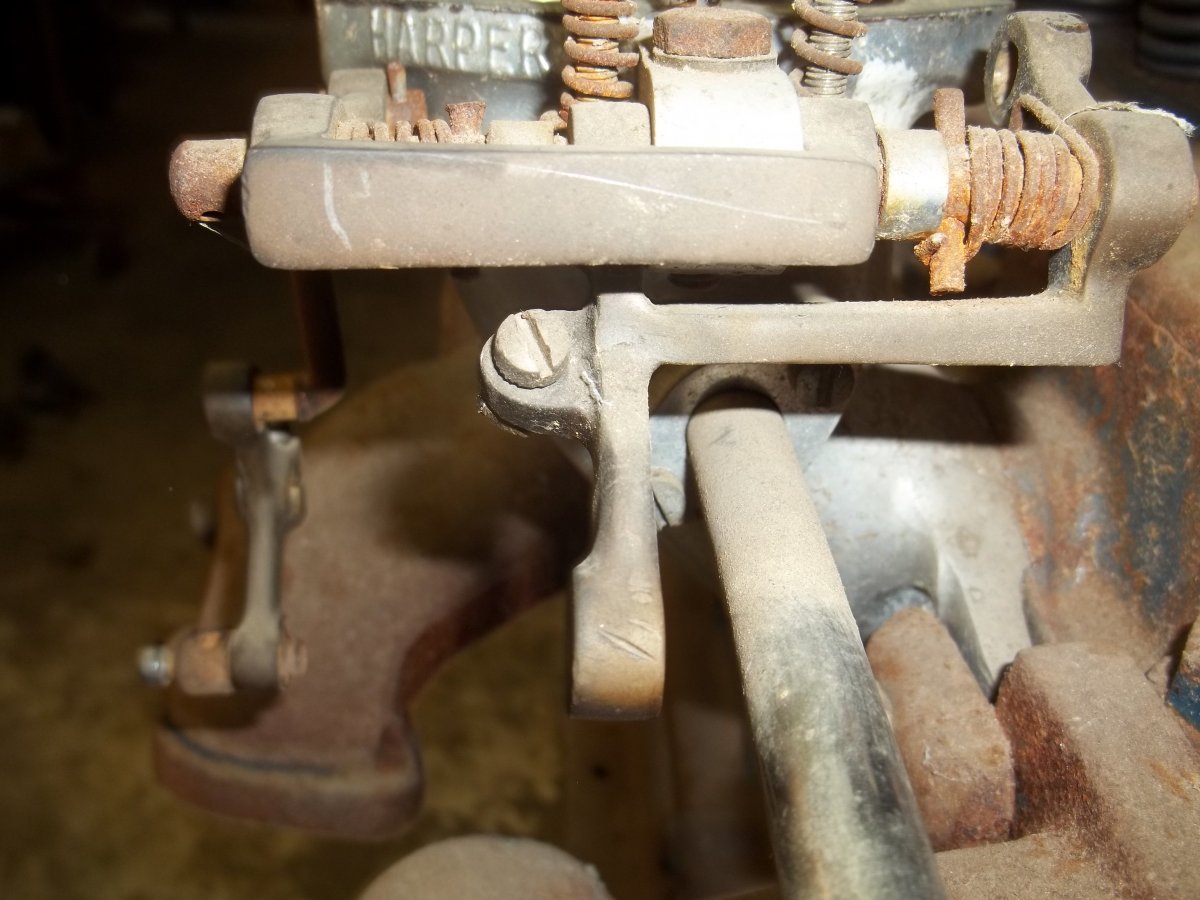

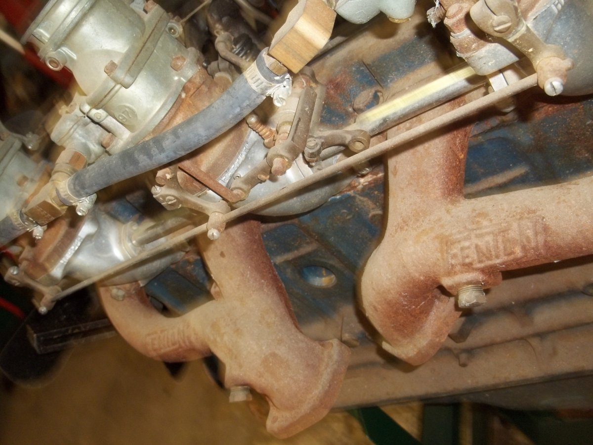

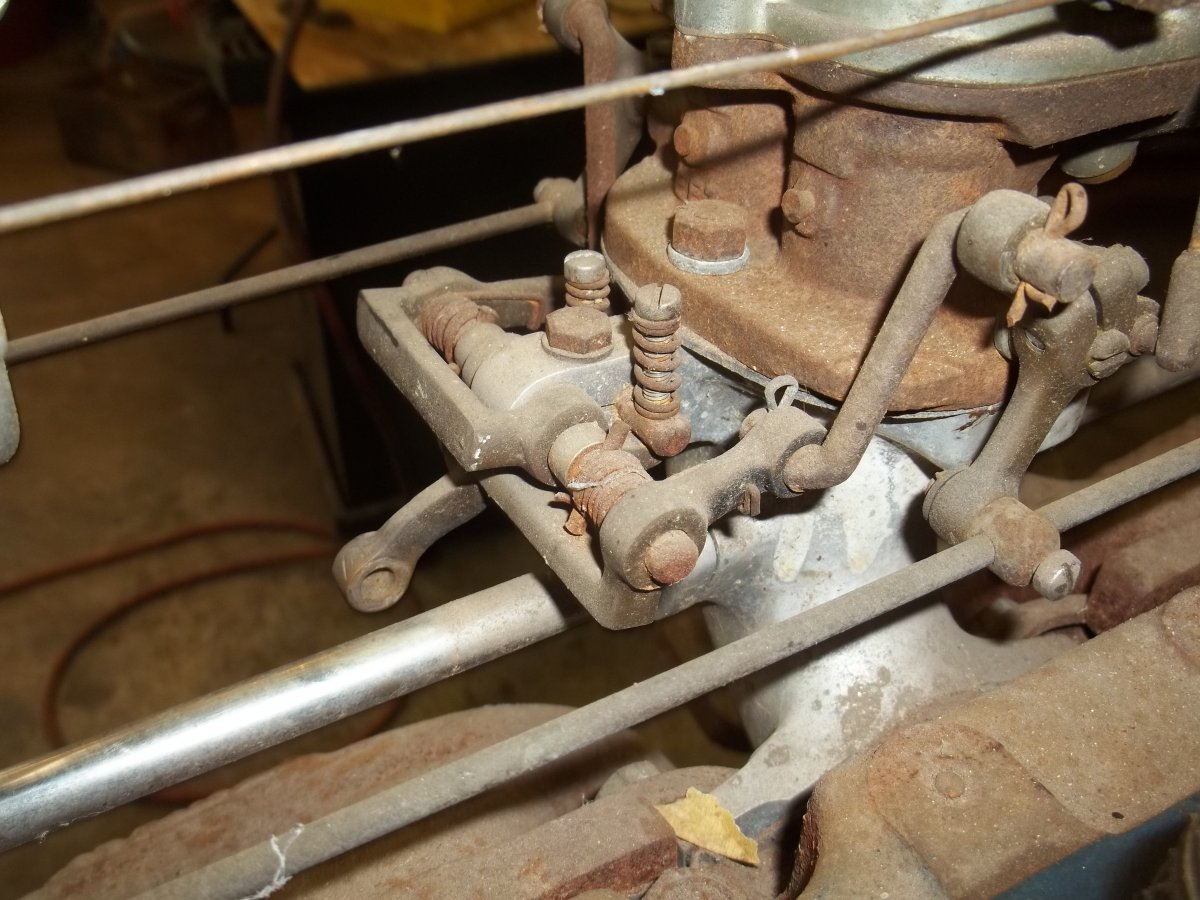

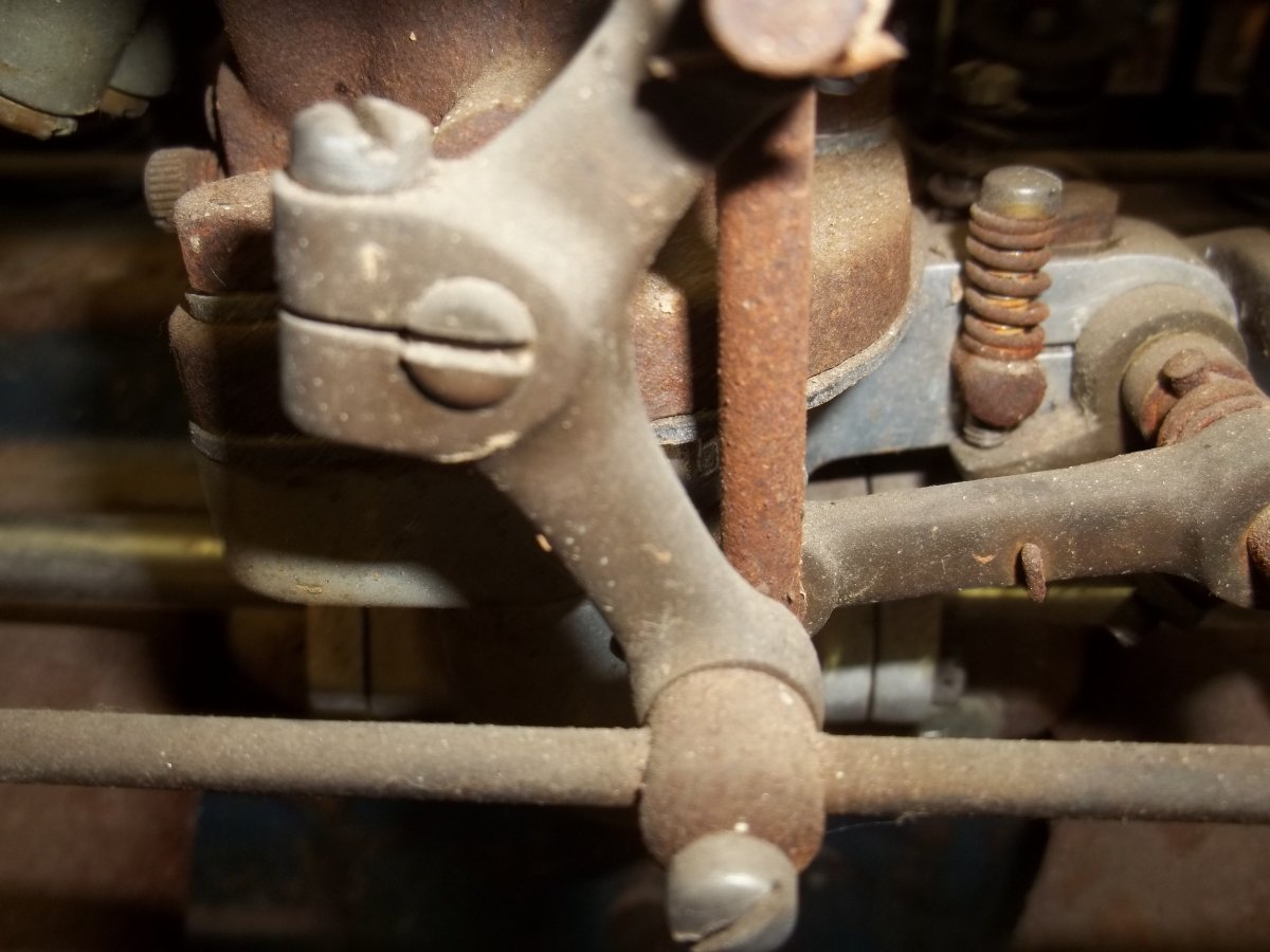

    Here are some more Harper 3X2 pictures. Not mine just posting the pictures for all to see.
    100_2595.JPG 100_2597.JPG 100_2598.JPG 100_2599.JPG 100_2603.JPG 100_2602.JPG 100_2601.JPG 100_2600.JPG 100_2604.JPG

    That's SOME linkage geometry there...let alone splitting the throttle shafts in those Strombergs!
    Not 'new' to it, as I had years of Porsche, and split carburetor shafts were the manner in which Solex 2 bbl carbs were synced. Still, the practice of doing it is unusual, so the curious onlookers at the drags, etc., would be sure to ask about it...

    What do you guys mean by "splitting the throttle shafts"?
  5. Six Ball
    Joined: Oct 8, 2007
    Posts: 5,847
    Six Ball
    from Nevada
    The throttle shaft on each carb was cut in the middle so each 1/2 of the 2 bbl worked independently. One side of each hooked together made the primaries the other side was the secondaries that came on progressively. This evened out fuel delivery on inline engines rather than using a center carb in the middle of the engine as primaries and carbs one the ends as secondaries. Each carb fed an intake port and a large runner was not needed, just the small tube to even out the vacuum. The other choice is all 3 all the time, not really the best street choice.
