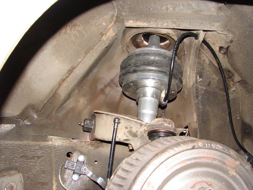

    Since I painted fender wells I had to get the shockwaves for the front but the ones we ordered which are for the 63-64 thunderbirds don't really lower the car without heavy modifications, after taking some measurements they talked to ride tech and found that they have a shockwave that will fit. Here's what the car looks like mocked up 2.5" lower in front
    and with the wrong shock installed

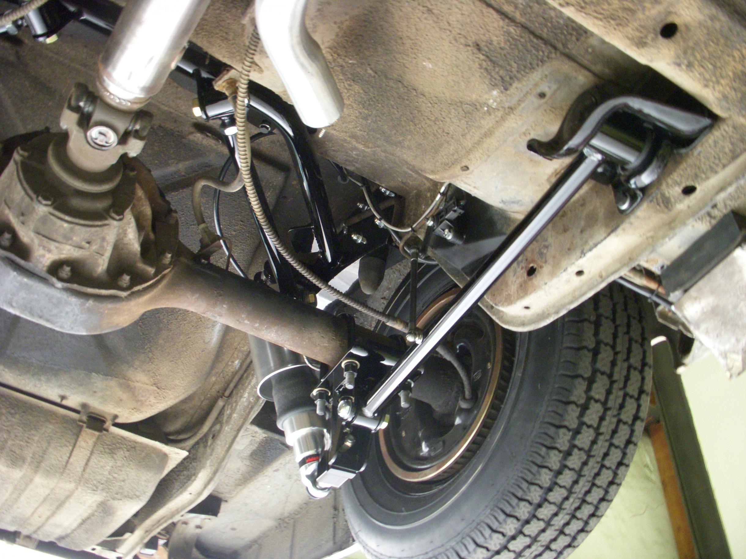

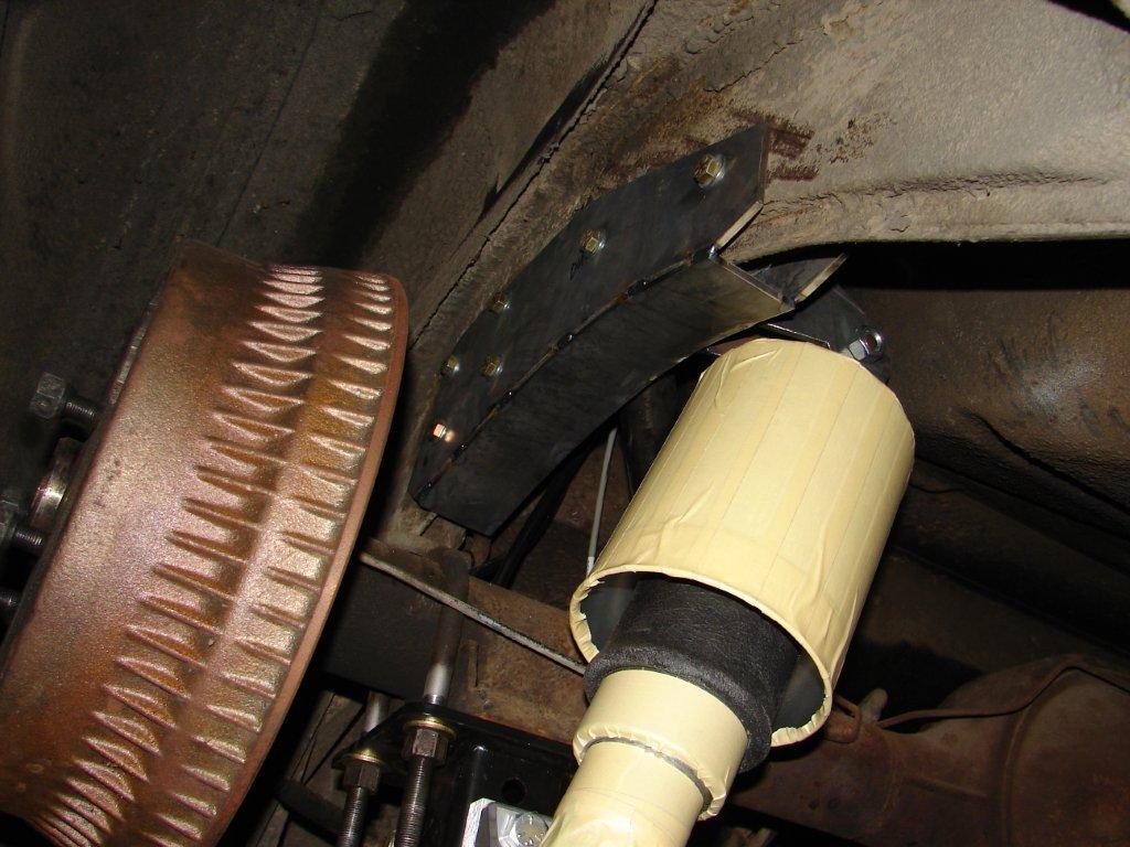

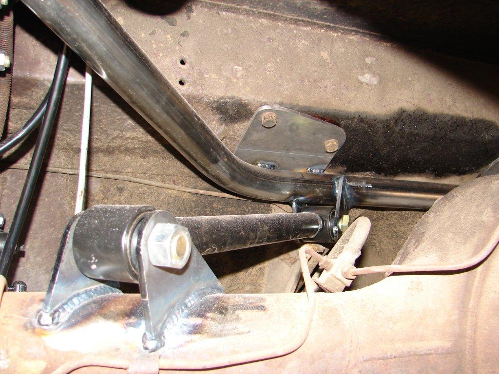

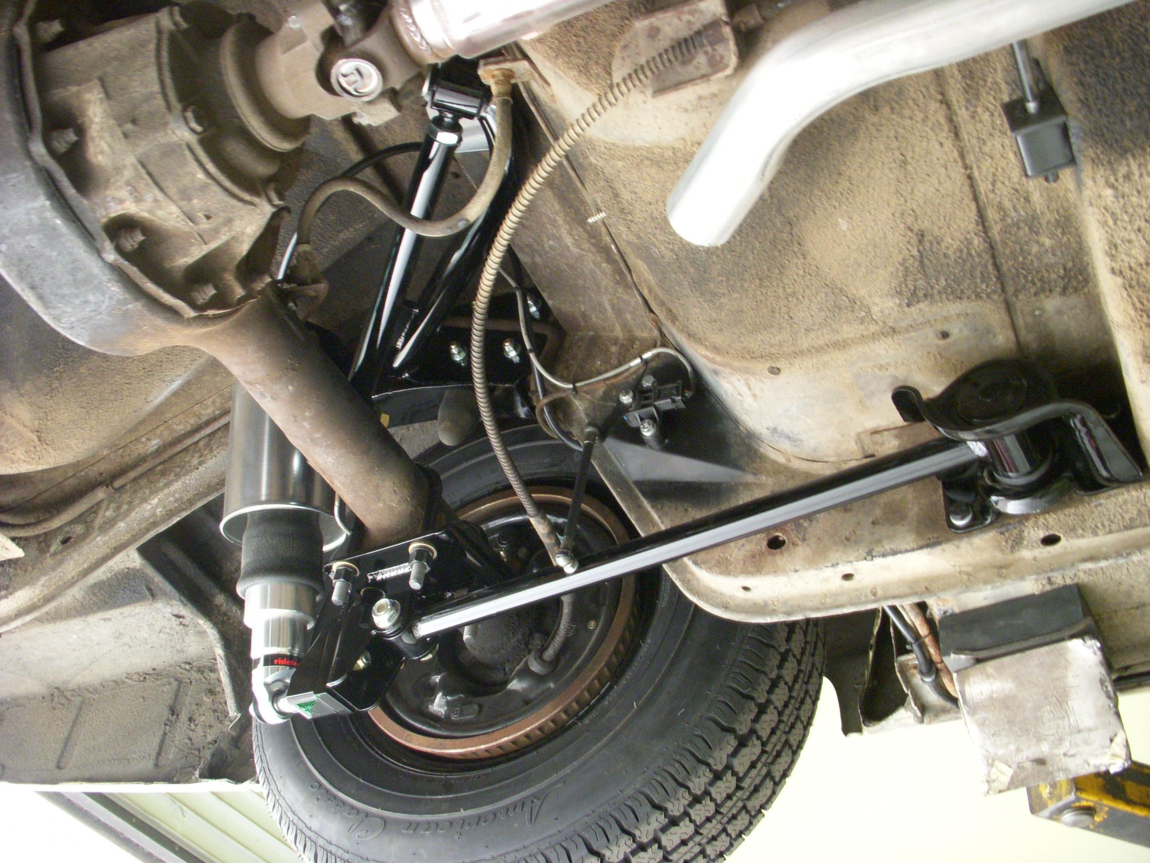

    For the rear suspension I wanted a four link set up. Nobody makes a rear kit set up so we ordered the universal rear kit from ride tech, but when Cotati Speed Shop got the kit they realized without cutting up the back of the car it wouldn't work. So they started looking at different options, they are also building a Starliner which it has the Galaxy kit on the back and they were looking at the kit to compare to and they took some measurements and found that the lower bars are the same size that would be needed on the Thunderbird.
    Cotati Speed Shop ordered parts from the Galaxy kit that they could use and fabricated what they needed to complete the rear,here are some pic's

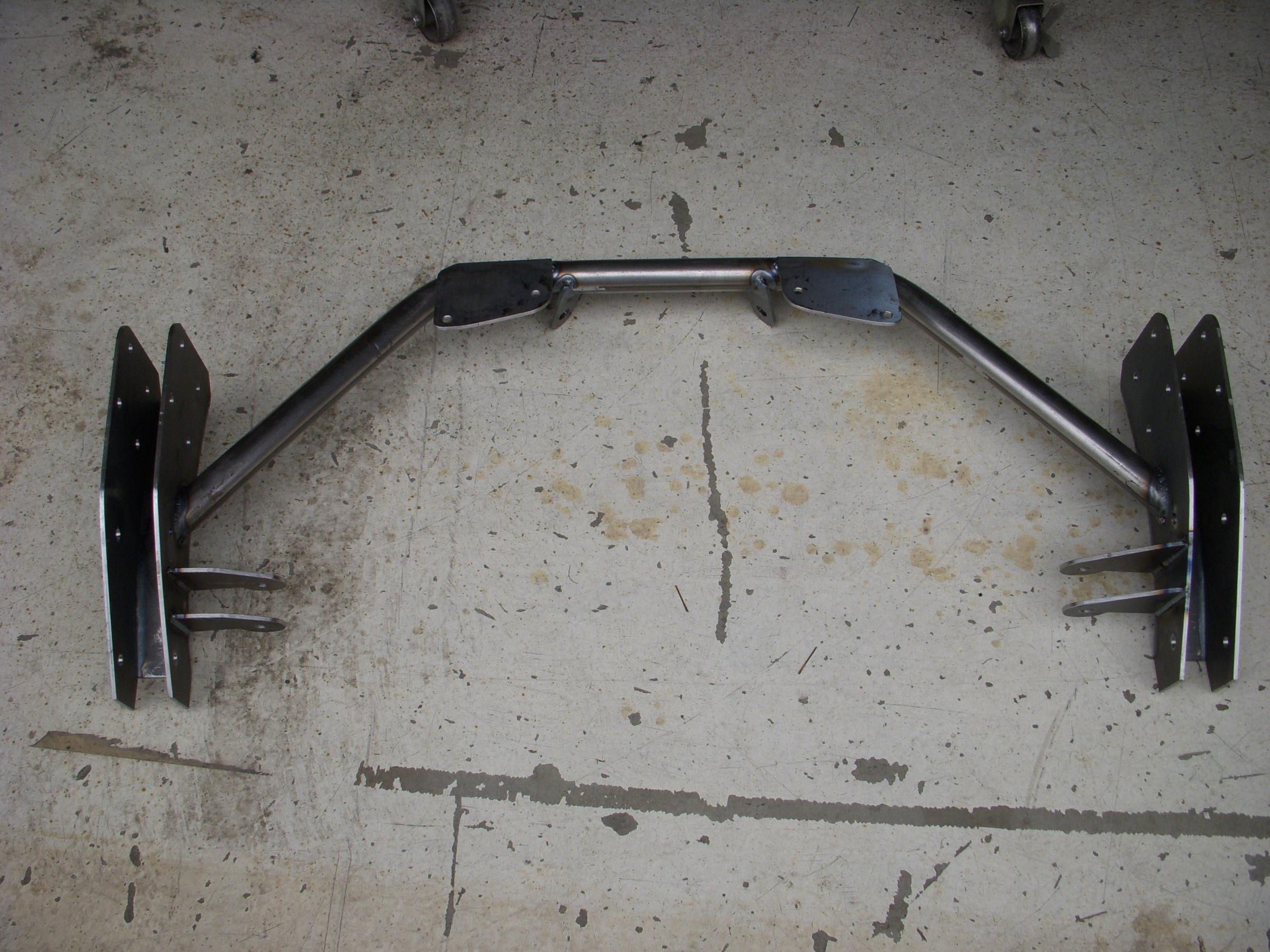

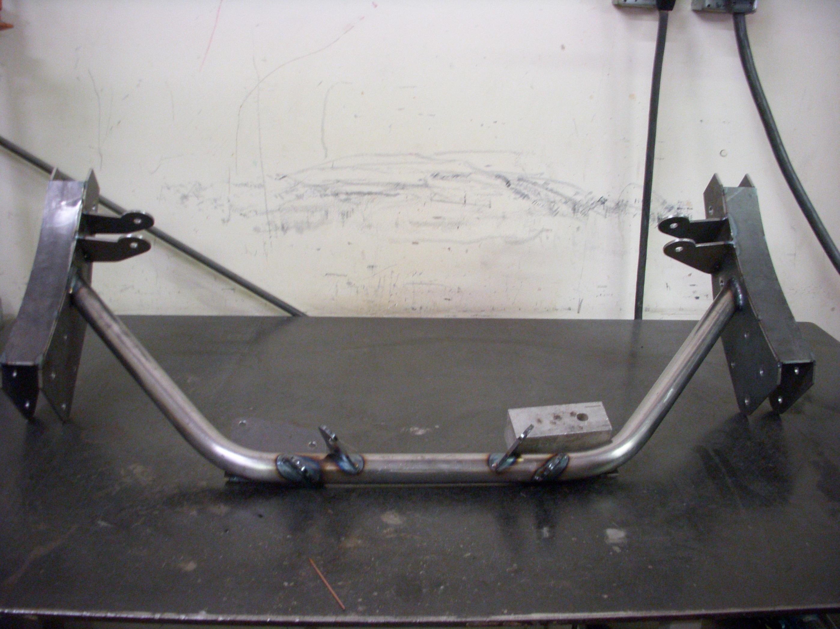

    This is the fabricated cross bar using the stock top shock mounts to bolt to the body
    Here the hardware mounted in the trunk

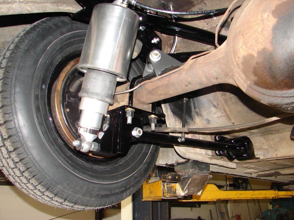

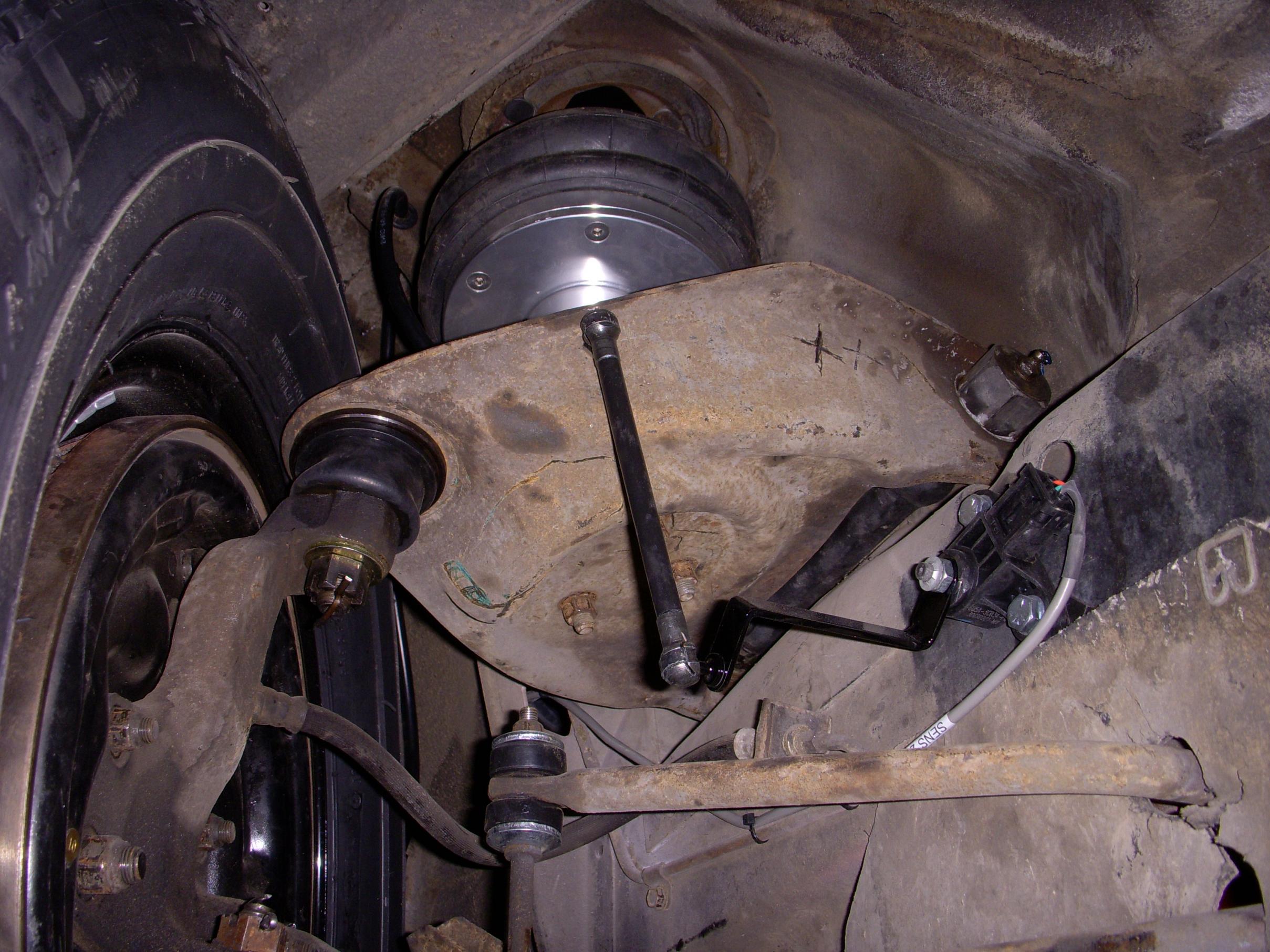

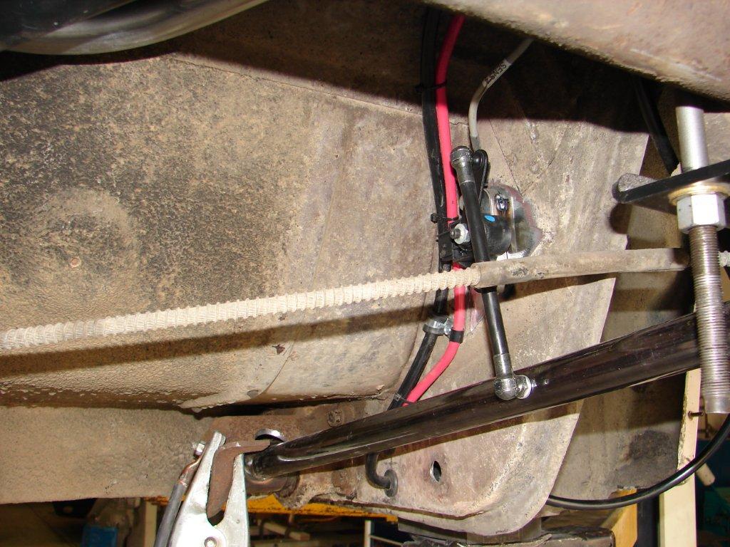

    Here are some more pictures of the work that Cotati Speed Shop did on the suspension.
    The rear
    The front
    As you see in the pic the ride censers are installed, these are from the kit from Accuair. From what I read it this system sound cool and should work great.

    I've had the car back a couple weeks now and let me say that the boys at Cotati Speed Shop did a great job, the car rides great!
    They gave me some of there pictures of the build I thought i would share.
    The first two is the custom bar they made which bolts to the body and mounts the two top bars and shocks
    The rest are everything installed after it was painted.
