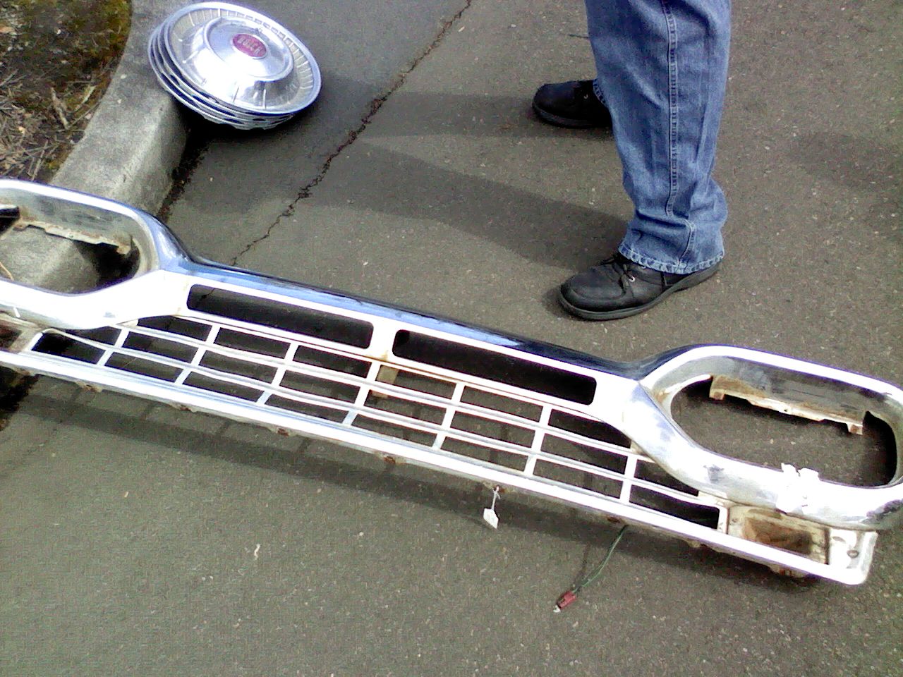

  9. Scored at Portland Swap Meet..picked this baby up for $50! Cleaned it with an SOS pad.
    Before and After

  11. Al Von
    Joined: Nov 19, 2005
    Posts: 257
    Al Von
    Napoleon Dynamite voice: "LUCKY!!!"
    Wow, that would be a $1500-2000 truck here in the rust belt. Good job!

  13. haha yeah I consider myself lucky.
