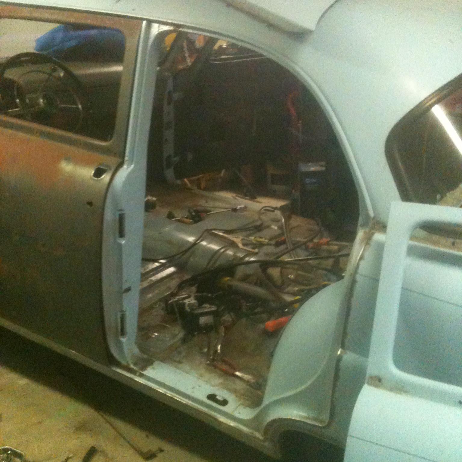

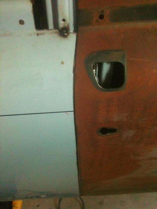

    My first time doing this. I have about 8 hours into this so far. Front door installed, post moved back and welded in. Rear door cut and tack welded in position. I think i'm doing pretty good for the first time.

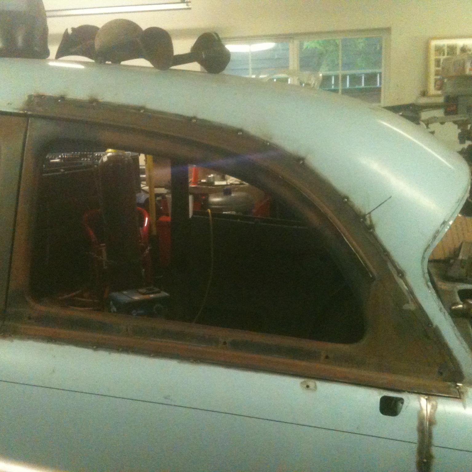

    Here is the drivers side that i worked on this weekend. Got the door installed door post installed and back section tacked into place. Cut out the old back side window and tacked the new frame in.

    Looks good. On both of my conversions, I used the door jamb from the donor car instead of moving back the original pillar. Curious to know why you did that with yours, but it looks like it'll work out nicely regardless.
    Also, if your donor car didn't have a stock front seat in it, your 4 door seat can be made to fold forward by removing a couple of bolts on the sides, making the whole back of the seat fold forward. Not quite as convenient as a split seat but still very functional.

    I don't have a donor car just doors and side window frames that's why I moved the pillar back. The new doors close way better than the stock ones.
