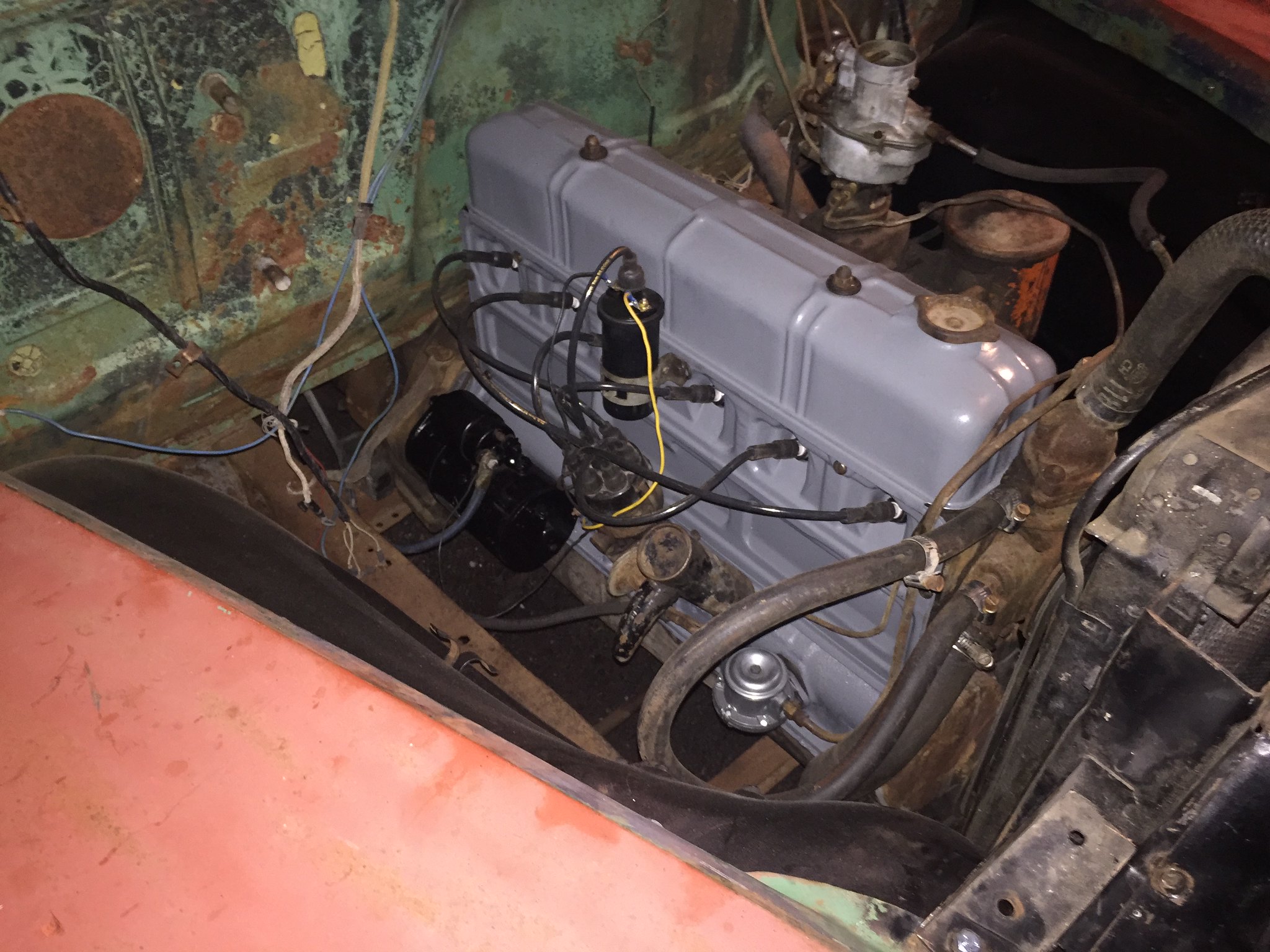

    I have worked to paint the block, valve cover, push-rod cover as well as replace the fuel pump and all relative gaskets for these items. I have also painted the starter and the generator. I'll be painting the other bolt on items (oil pan, water pump, harmonic balancer, distributor, oil filter and air cleaner while breather tube will be getting replaced) and replacing their gaskets in the coming days. Here are some pictures:
    Shots of engine, manifold, starter and generator in painting process

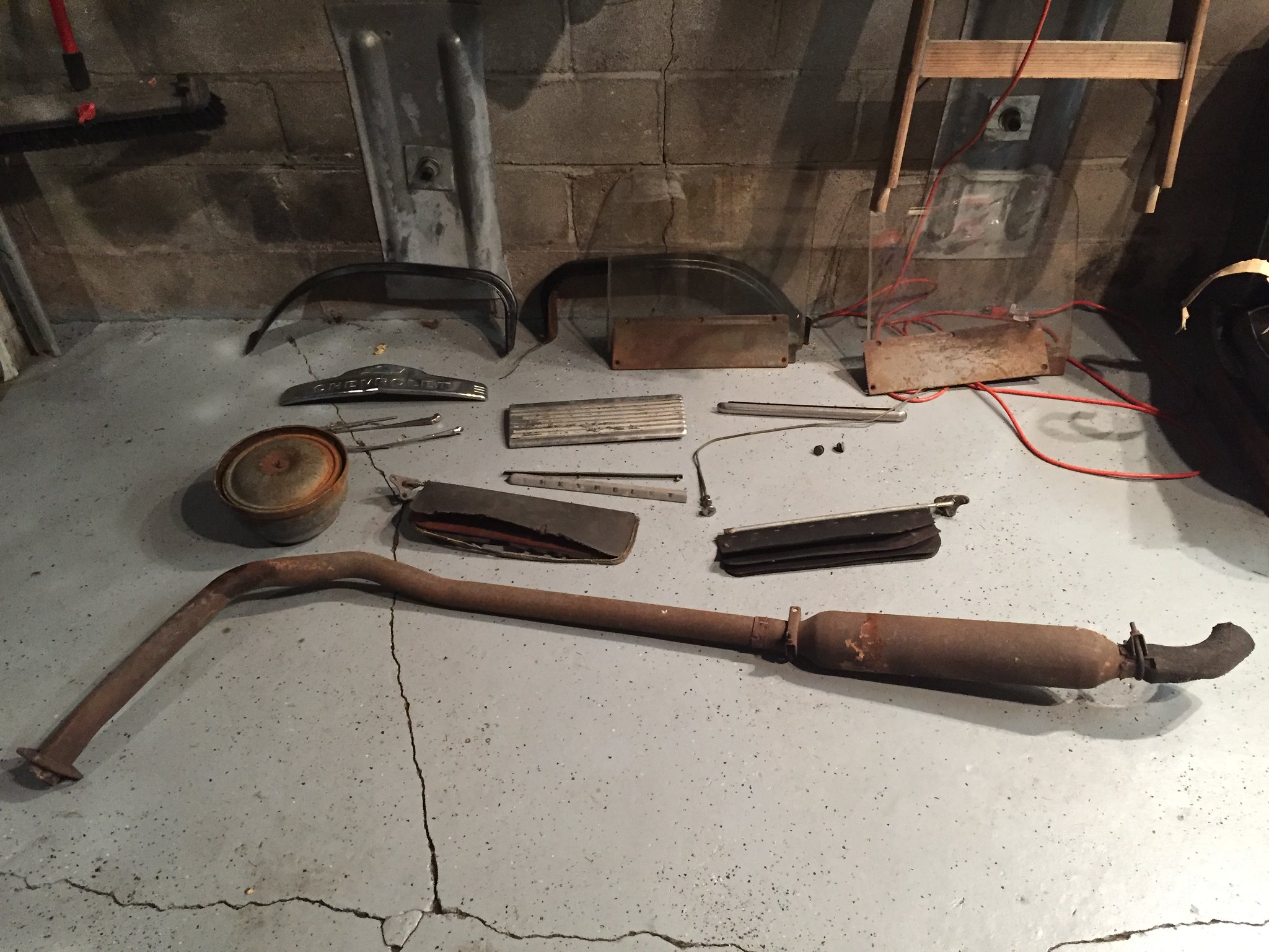

    I also spent last night out in a farmers field picking thru about 5 cabs/partial AD trucks for parts. I scored big time, coming out with the following for peanuts!:
    • Air Cleaner
    • Door Glass (both sides)
    • Front Hood Emblem and brackets
    • Headliner Rod/Bow
    • Visors
    • Glove Box Door
    • Speaker Grill Trim
    • Lower metal door panels
    • Windshield center trim (inner and outer)
    • Throttle Cable
    • Complete exhaust
    • Wiper Arms
    My floor pans are being delivered this afternoon so this weekend will be a fun time of working on the motor items listed, cleaning up and installing the above as well as cutting out my old pans and hopefully putting the new ones in with tack welds for a test-fit!

  5. not that one guy
    Joined: Mar 28, 2011
    Posts: 293
    not that one guy
    from So NV
    Nice start
    Looks like 4 and 5 spark plug wires are crossed in the pic

    1 is closed to the cab correct?
  8. Cosmo49
    Joined: Jan 15, 2007
    Posts: 1,555
    Cosmo49
    No, the first cylinder is next to the radiator.

    Does it currently run? if not make sure it runs well before you spend anymore time on that 216...
  10. markiemark9
    Joined: Sep 23, 2015
    Posts: 36
    markiemark9
    from Omaha, NE
    Skidded - It runs fairly well.
    Cosmo49 - I'll check the firing order / plug wires tomorrow.

  13. markiemark9
    Posts: 36
    markiemark9
    from Omaha, NE
    Cosmo49 - great catch my plug wires were all outta wack.
    Not that one guy - thanks for the pic! I got the rearranged as shown and it runs so much better now! Great help!

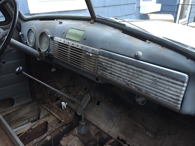

    A very busy weekend. Below is a summary with a handful of photos:
    Got my front hood badge hung:
    Windshield center molding and wipers mounted:
    Side hood emblems mounted:
    Started doing a rough cut to remove rusted floor pans:
    Radio Delete plate, center speaker grill, glovebox door and throttle cable installed:

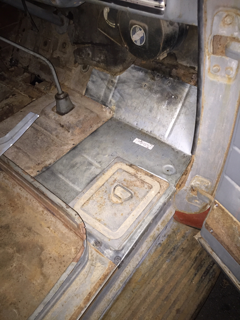

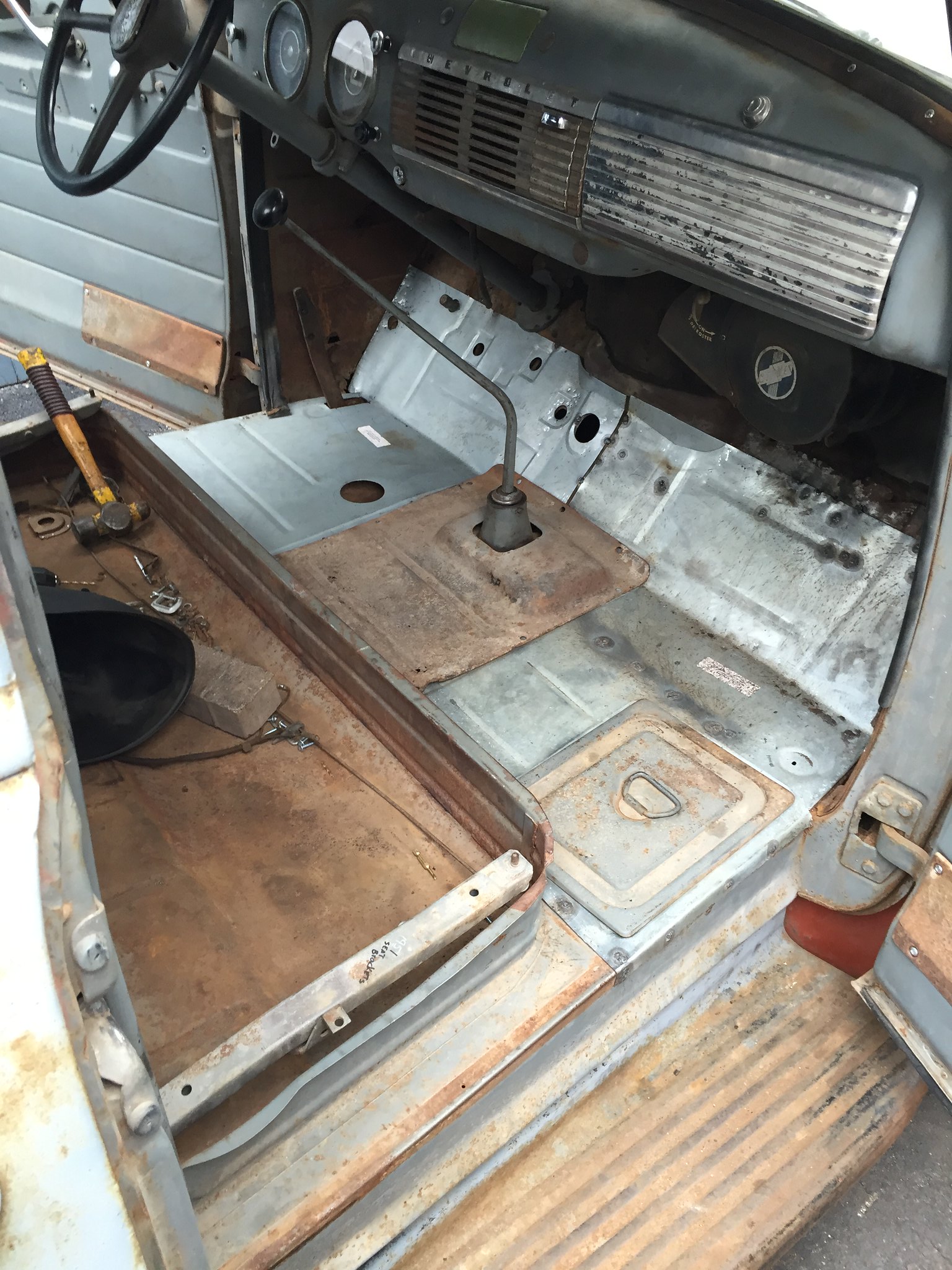

    I haven't posted in a while but that doesn't mean work hasn't been getting done!
    Both floor pan halves welded in (pic 1)
    Both floor pan halves welded in (pic 2)

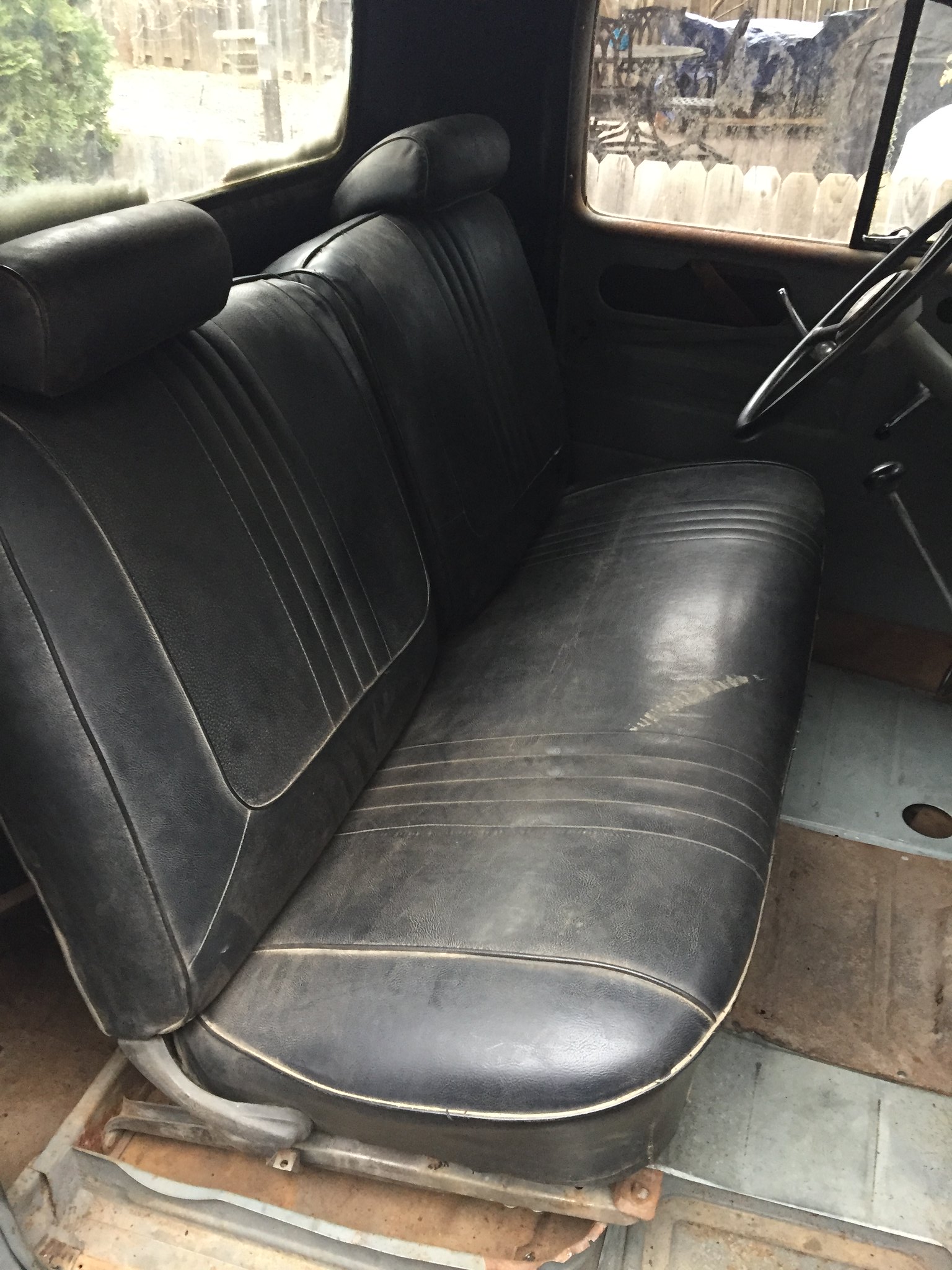

    Seat (non-stock) installed on original runners
