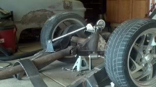

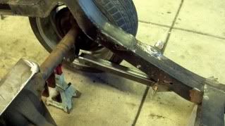

    Frame was notched, needed to get the rear done! Built my own 4 link, diff plate (by my man Craig), had to have some bungs custom made (thanks jeremey) and now to do 6 different mock ups in the middle of July! It was so hot out a lot of my work was done between 11pm and 4am!
    2" box tube (0.25 wall) lower links...why? I got them off craigslist for $10!
    1 fixed, 1 adjustable...2.5" ends
    Diff plate by Craig...
    Top bars are 0.25 wall with 1 fixed, 1 adjustable 2.5" ends
    Pinion Angle test...notice my 2 boys came out to drop the jack for me...still in their pjs.

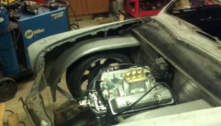

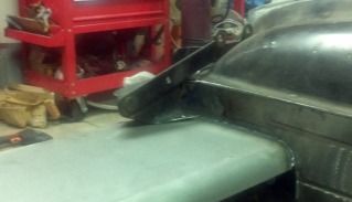

    Car was missing all of the inner fender pieces and the original owner used some angle iron and flatsheet. It wasn't going to give me a clean look or the room I need to lower the car. So I started the mock up of the top of the fender well. Once everything is mocked up, I'll break & bead roll panels to make I nice finished engine bay. And yes, its a 350 sbc...came with the car, I'm still hunting for the final motor to build. But I cleaned this up just in case.
    But now the lower mount for the Hood Hinges was blocked...so I cut!
    Its on at the firewall...but braced with a 2x4 at the front...well it time for scrap pile...a couple bends and holes later...
    Now its pretty sturdy...and level
    Now I set the fenders and I've decided to build box tube mounts with welded nuts. They'll be hiden with the finish panels.
    I'll get more up to date pictures soon.

    Jiging??? It was really just from the hip on jiging.<O:p</O:p
    <O:p</O:p
    1. We found the spot on the 50 frame that was a) closest to the width of the S10 b) behind the firewall & under the body so it was out of sight.
    <O:p</O:p2. Measured from that point forward to the center of the spindle so we knew how much of a clip we needed to work with.<O:p</O:p
    <O:p</O:p
    3. Used that measurement to cut our clip (we shaved 1.5" for adjustment). Then braced the 50 frame about 5" behind where we planned to cut and cut the stock front off.<O:p</O:p
    <O:p</O:p
    4. We actually just sat the frame & clip on the hubs and leveled the frame, my garage floor has a 1/2 slop forward over 20' but that wasn't a huge concern because of the Air Ride that was going on it would be made up for any difference. But we wanted the frame as level as possible.<O:p</O:p
    <O:p</O:p
    5. Using 114" on center wheel base we just squared out the frame. To square it we measured 114" center, then cross point from the center of of rear notch to shock mount hole on clip and body mount under door to frame horn of clip.
    ***I'll look for better close ups.

    How did you make those fenderwells?
