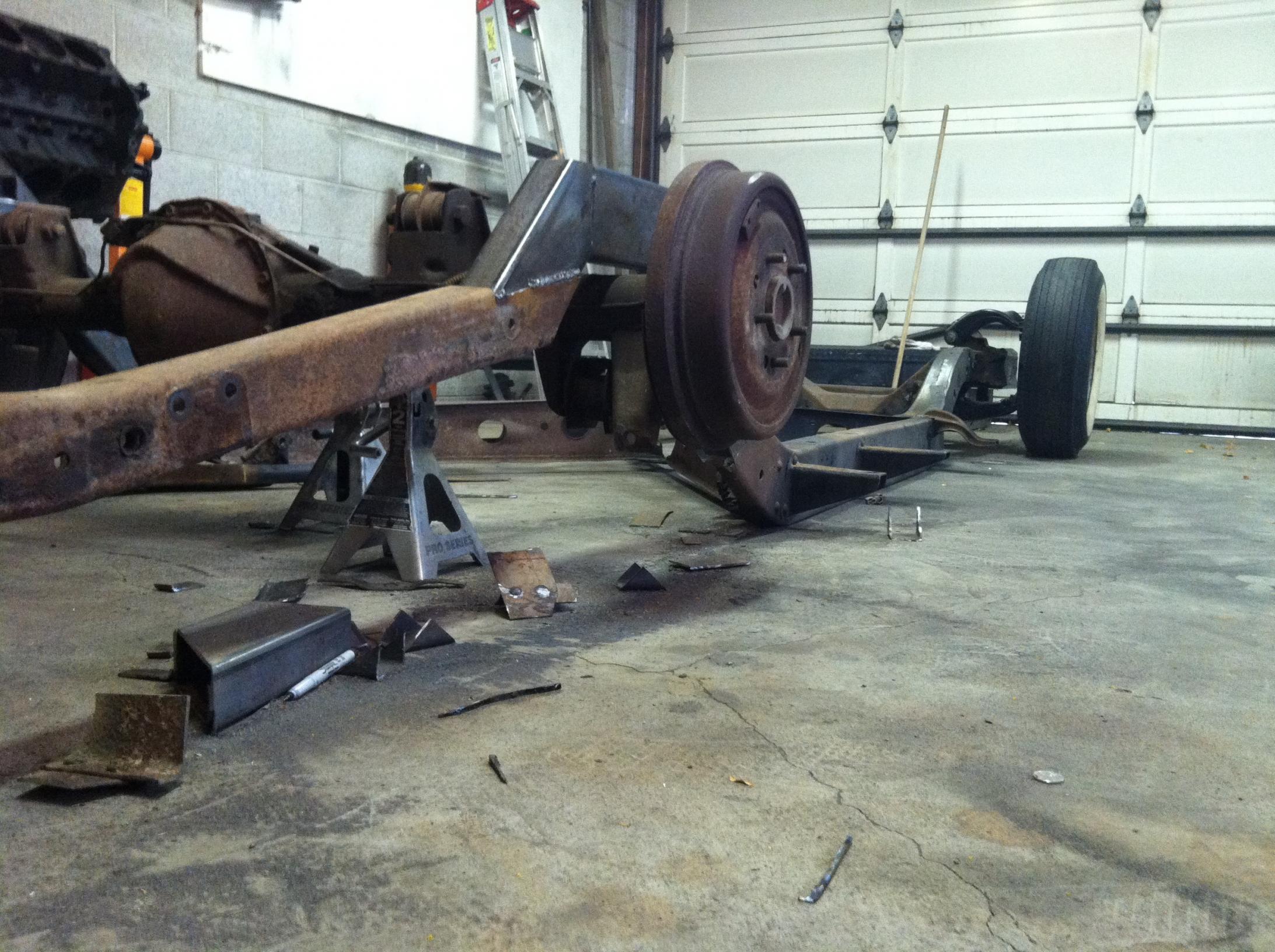

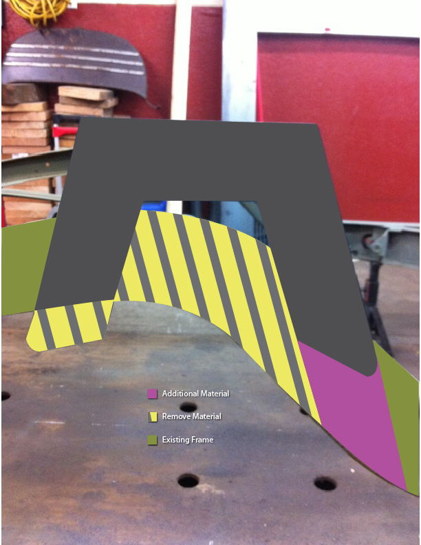

    I need some help with my C Notch ...I purchased a great kit from Alex at Gambino Kustoms and he has some great how to info out there but my frame it a little challenging. The problem is that the kick up in the frame and the c notch shape don't play nice together. Here is what I am talking about
    If I set the front in line with the bottom of the frame I will have almost no notch at all
    Can I set it up like this? I don't see it being easy to make the frame strong if I put it up this high. Should I do this and add more plates to extend it down in front?

    Here's how I'd do it... if you have the possibility of getting a custom notch laser cut do it, if not then after you add material it needs a really strong gusset!!

    what if you flipped the notch plate around. It looks like it is longer in the rear than in the front. Otherwise I agree with chaddilac

    It is much longer in the front just the angle that makes it look that way. I think new side plates might be in order Thanks guys I will take all the help I can get

    yes you can extend the fronts down i would extend them almost all the way to the bottom edge of the frame grind the notch and the extension so there v ' d on each side and weld bolth sides then grind and metal finish smooth what bothers me here is the in dentation on the frame rail i would make some filler pieces that you can use to weld that gap even if you have to do a double pass weld not one after the other of corse spred the heat around when welding . weve extended the notches alot like im telling ya just long as every thing is welded full around that side plate ! as a side not id rather have you call me then send me a pm im not on the hamb alot and when i am im rushed so i miss my pms alot call me 408 561 5744

    i would try to get metal the width of the side plate i think its close to 4 '' in that area also i think there will be enuff material you cut of the back of the top plate to extend down the front even if ther is up to a 1/4 inch gap you can weld it also i would build that notch on the bench instead of on the frame a piece at atime call me so i can help you

    Extended the front - I v prepped the weld joint and I only smoothed the weld so I can add a fish plate over the joint
