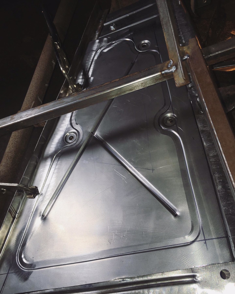

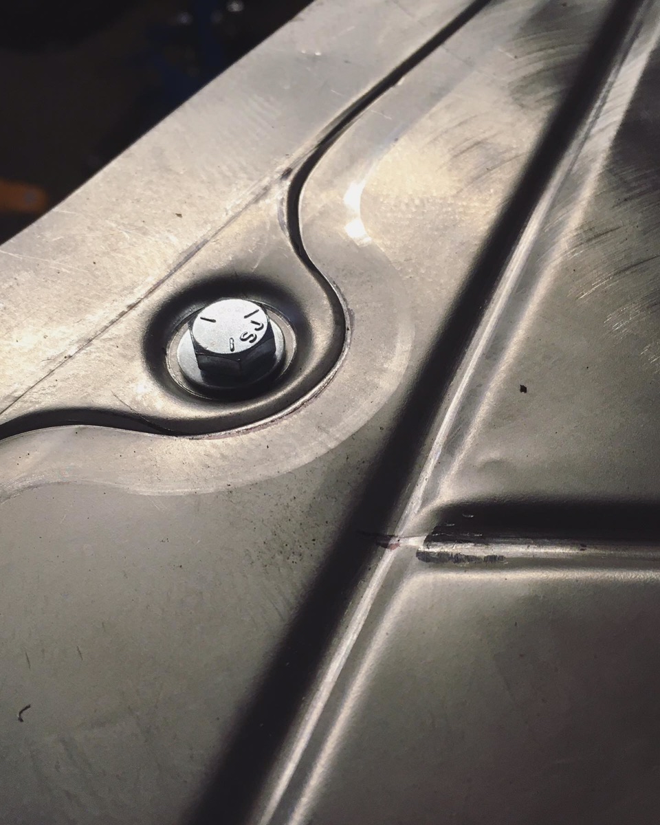

    Today I started off by making a dimple tool to countersink my body bolts into the floor.
    IMG_1304.JPG F6633936-8766-4A88-95B3-C9C461BF623D.jpg 7DAF8FDC-CFE9-4FFC-BAE8-6A318F4339B6.jpg
    Then I made the panel of the other side
    D2BBD9A9-FE87-45B0-8666-5C4A3F19374D.jpg 5EE5C6A7-7932-4F4F-8DE8-035D65D5A398.jpg

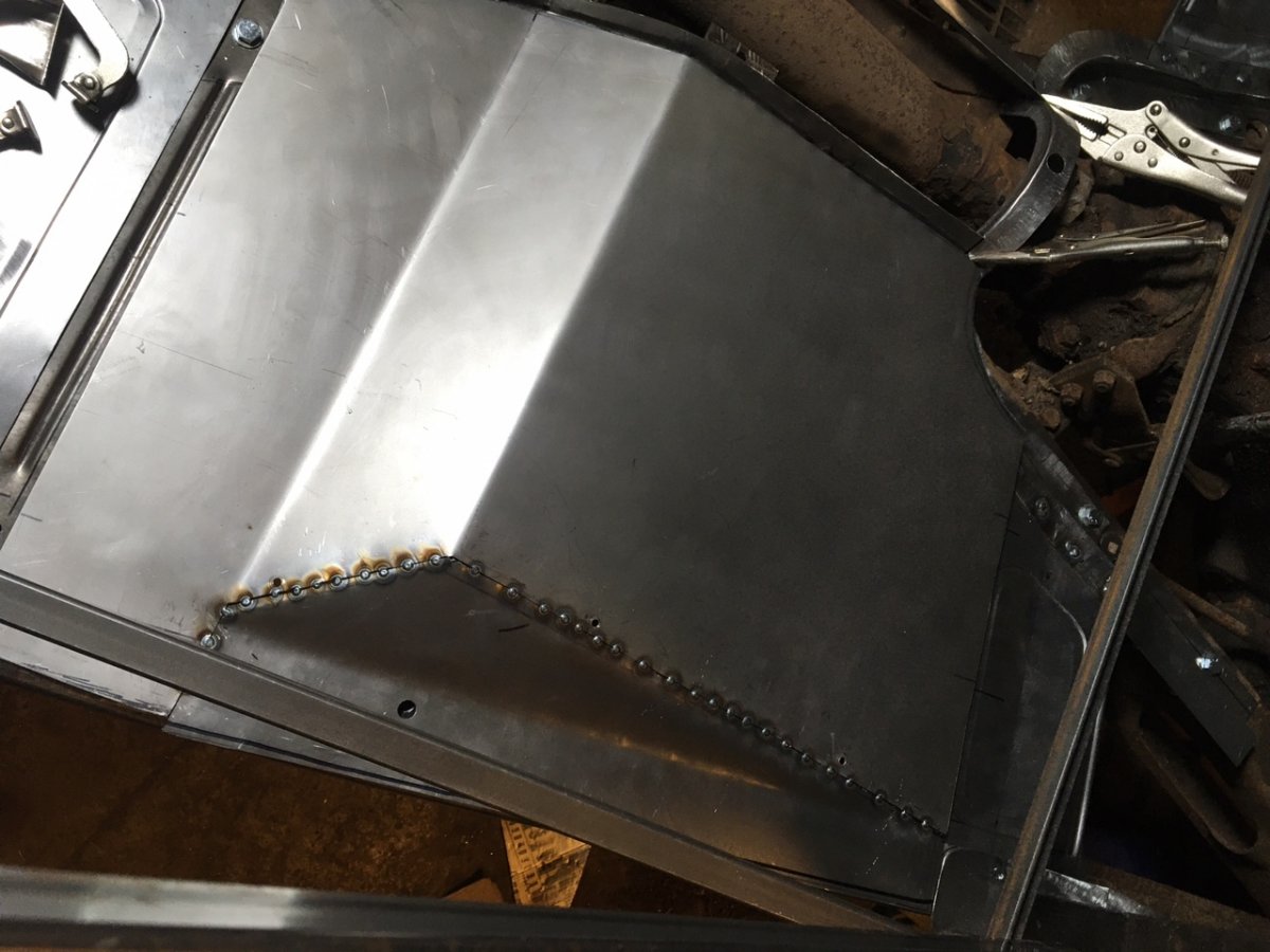

    I got most of what I had on my agenda finished up today.
    Closing in and hope to weld everything into the body by early next week.

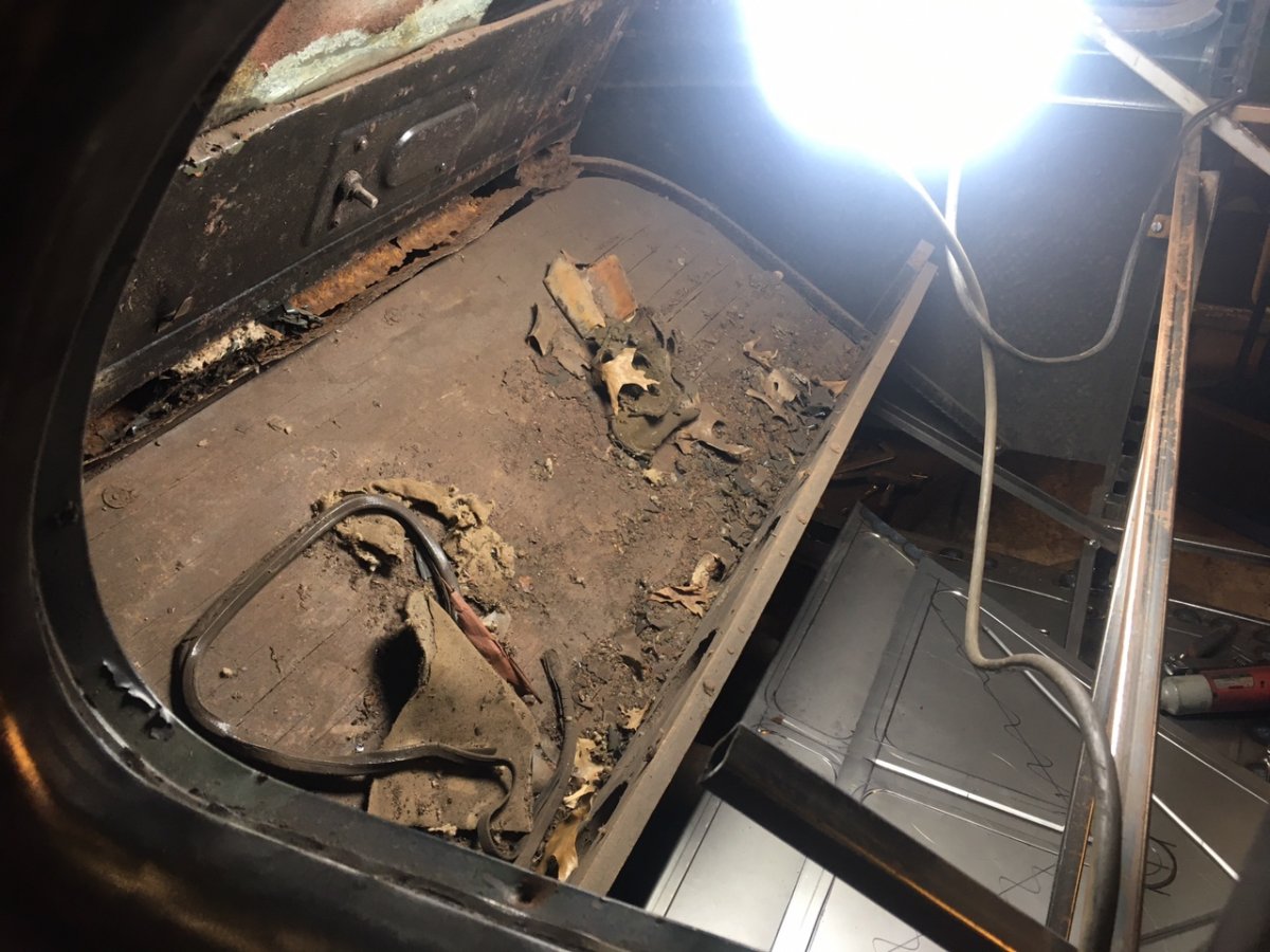

    Had some problem making the driver side floors, I don’t know how my brain malfunctioned but I ended up getting it finished on my second try.
    Tomorrow I have a double shift and then Sunday I should be able to get some more stuff done in preparations for welding it all into the body.
    Then next step after that is bolting it down and chopping the top.

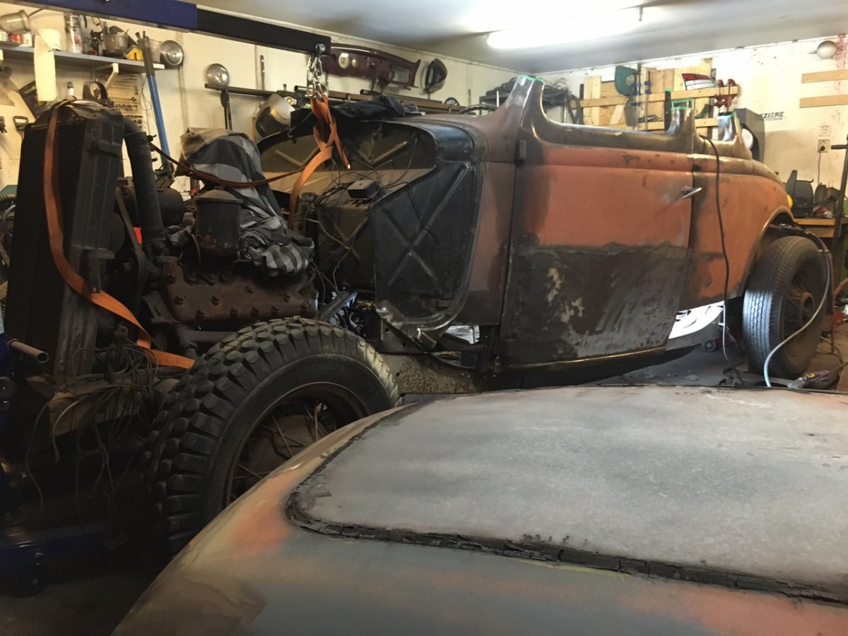

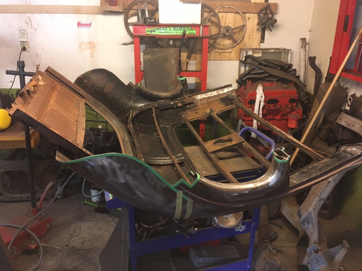

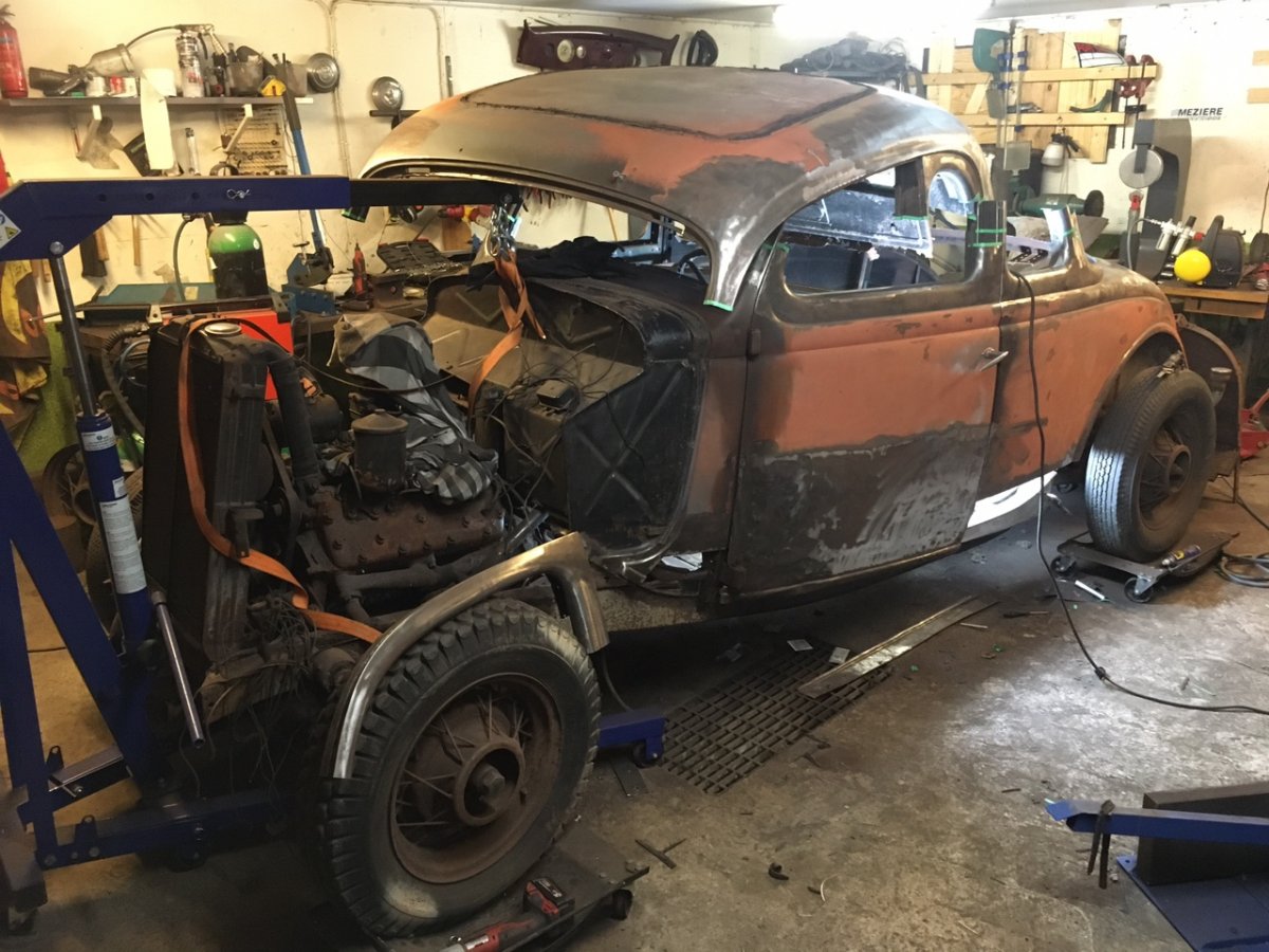

    So today I managed to cut down this tall ol girl.
    First cut!
    IMG_1484.JPG IMG_1488.JPG IMG_1489.JPG IMG_1479.JPG IMG_5236.JPG IMG_5232.JPG IMG_5178.JPG IMG_1495.JPG IMG_1506.JPG IMG_5249.JPG
    Now it’s all cut down and ready to get back together.
    Hopefully I can get someone to help me lift it back on tomorrow, it was a bit of trouble getting off.
    Skickat från min iPhone med H.A.M.B.

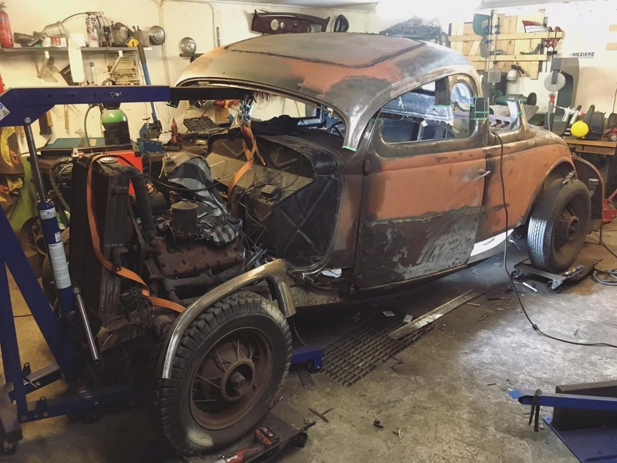

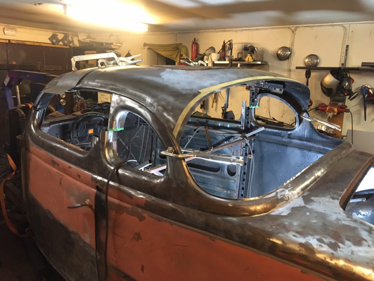

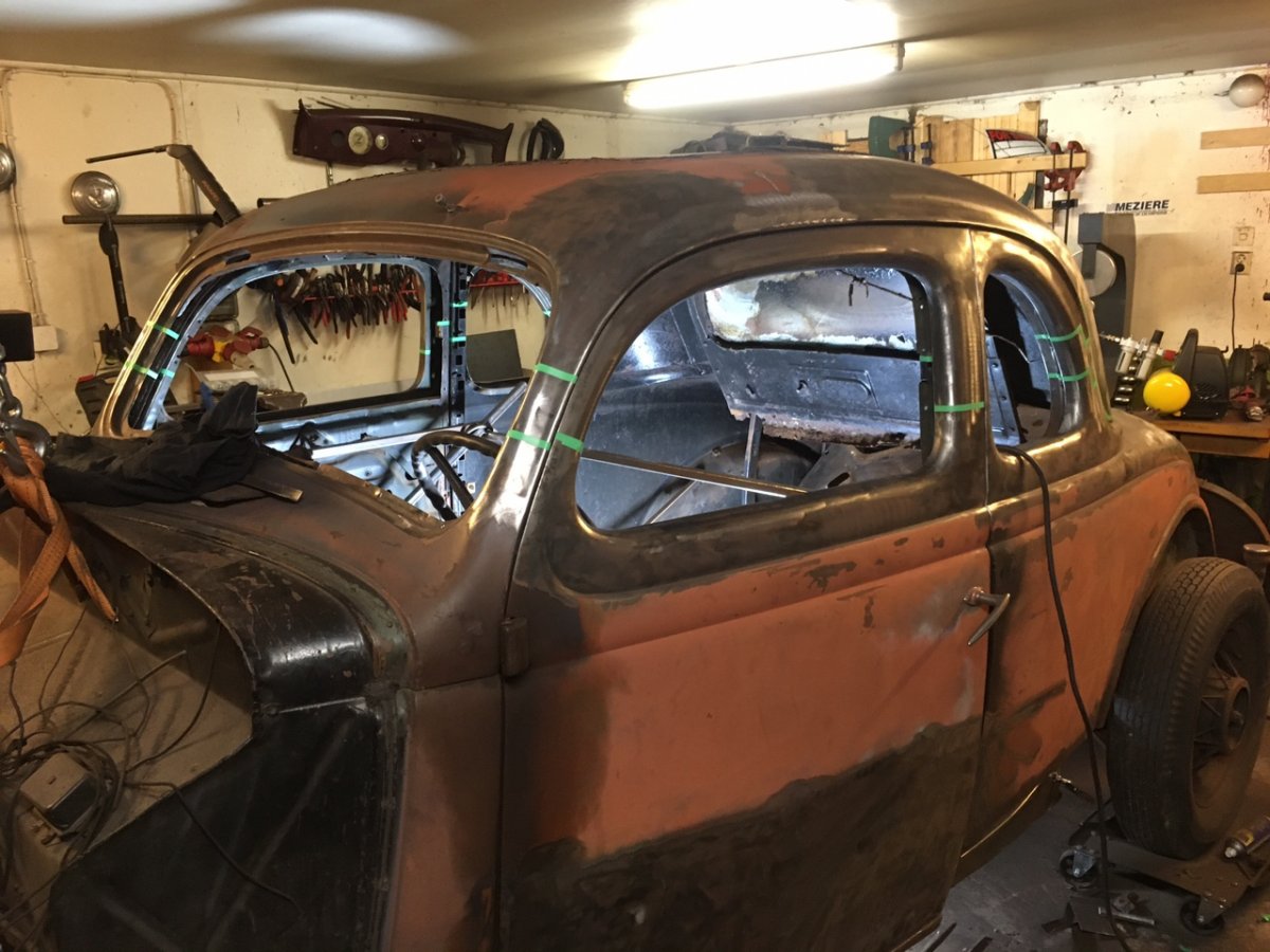

    Today I cut up the roof and moved it around so I can start trimming and get everything in place.
    IMG_1598.JPG IMG_1604.JPG IMG_1606.JPG IMG_1614.JPG IMG_1615.JPG IMG_1619.JPG
    I cut the rear of the roof off, so I can move it up and lean it forward.
    I want to get rid of the hump at the back of the roof.
    Make it flow a bit better.
    It got a bit better than original, but I still feel like it has a bit of a bump so I will have to look into that later this week.
    Either I will have to accept it and leave it or cut and re-shape the entire back half of the roof.
    I only had a few minutes o look at it so hopefully it won’t feel as bad when I look at it tomorrow again.

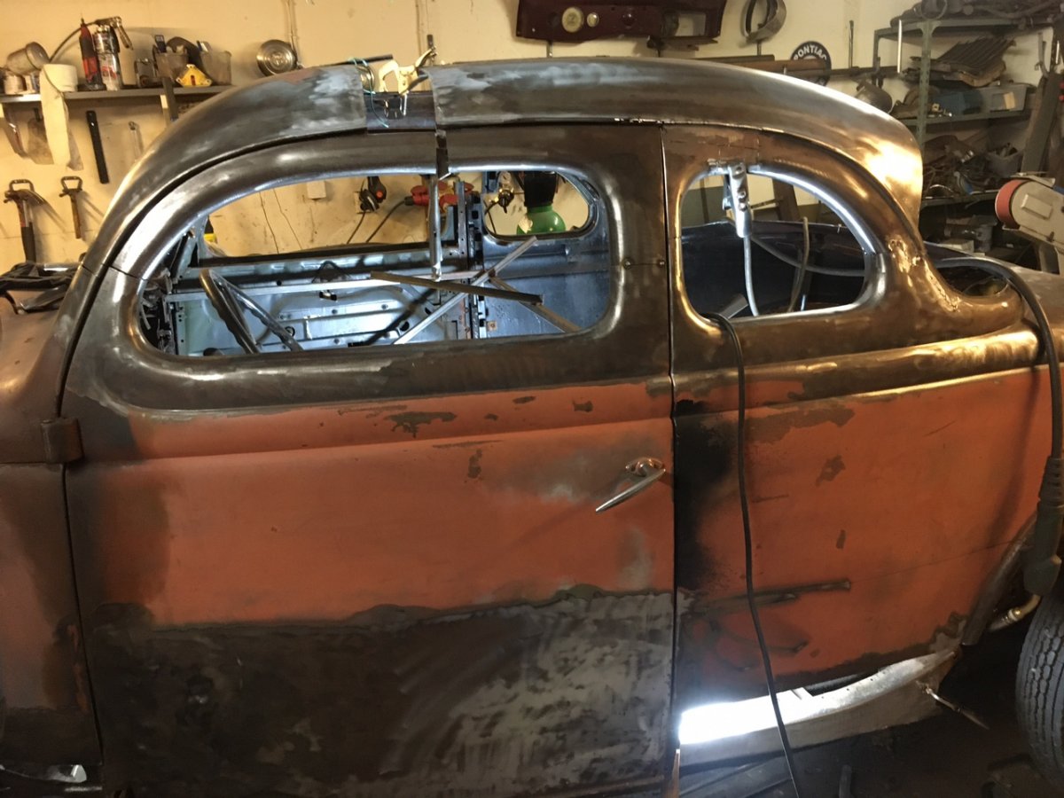

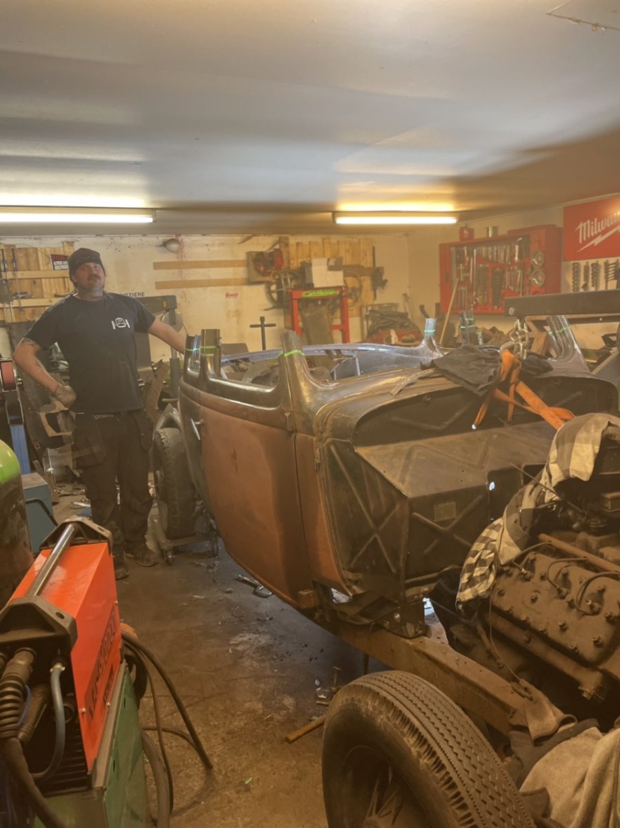

  15. emil
    Joined: Jun 24, 2008
    Posts: 155
    emil
    from sweden

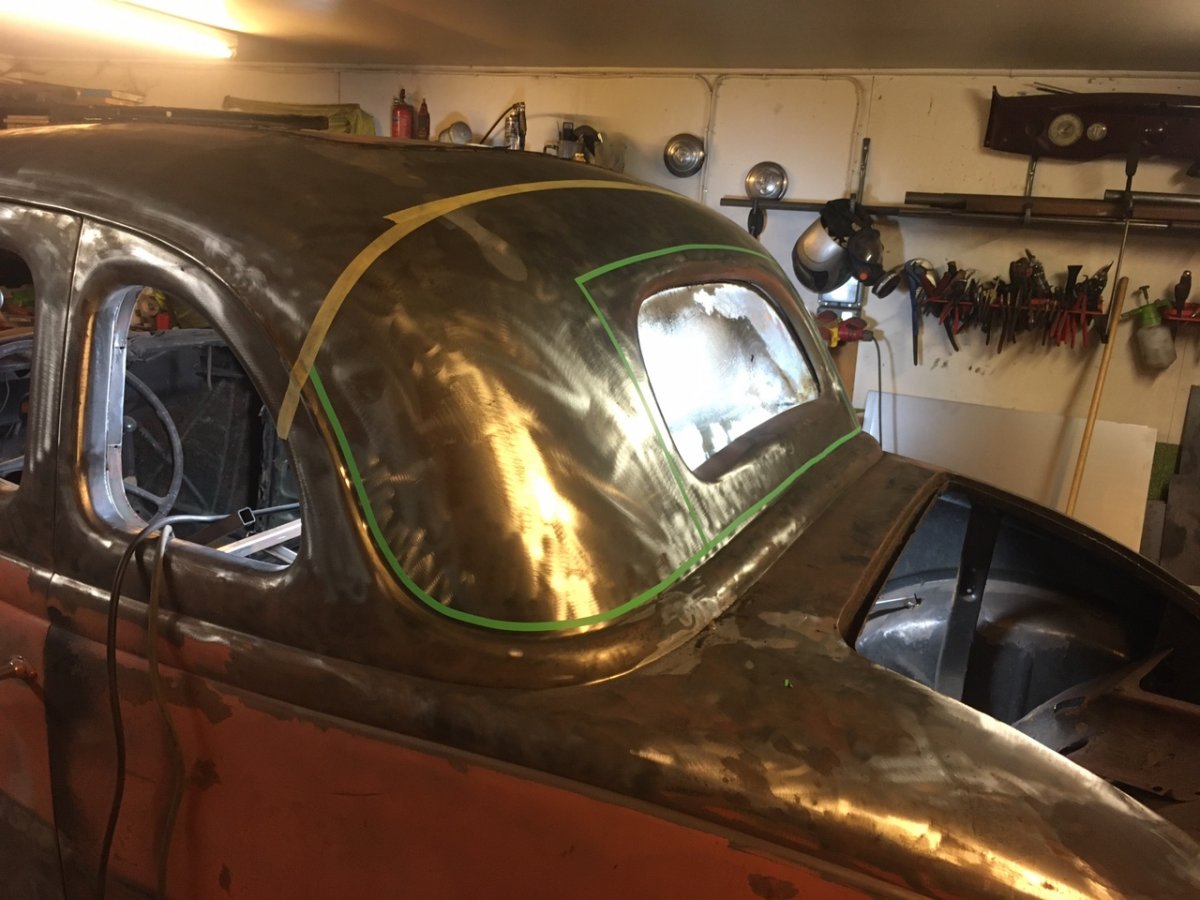

    So after almost a full day of just moving stuff around I finally got it to where I want it!
    Ended up taking another in out of the back and narrowing the roof about half an inch (might take more if needed) to get the flow I was after.
    I also ended up trying to mimic the body line with the flow-in of the bottom of the rear window.
    Made sense when i got it into place.
    More of a streamlined profile and no hump!
    IMG_1667.JPG IMG_1671.JPG IMG_1669.JPG 15C40774-DE4C-42D5-B114-9BEE63AD3D40.jpg
    Got my picture taken by my girlfriend too, was so focused I hardly even noticed she was in the garage until I saw her leave again.
    Sorry about the mess! I need to clean up this weekend, but I also had to repair the whole upper part of the windshield because it was all rotted. Turned out nice I think.
    So this weekend I hope to be able to start trimming everything down and weld it in place.
    What do you guys think? Did I fuck it up or is there more people out there who dislikes humpback roofs?
  16. emil
    Posts: 155
    emil
    from sweden
    Here you can see the difference, with the yellow tape is from before and the other is how it ended up.

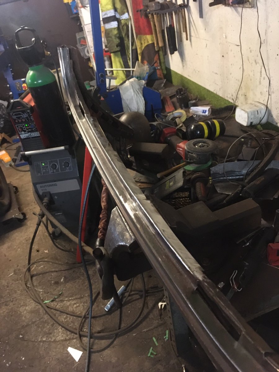

    So today got some pieces done and nested.

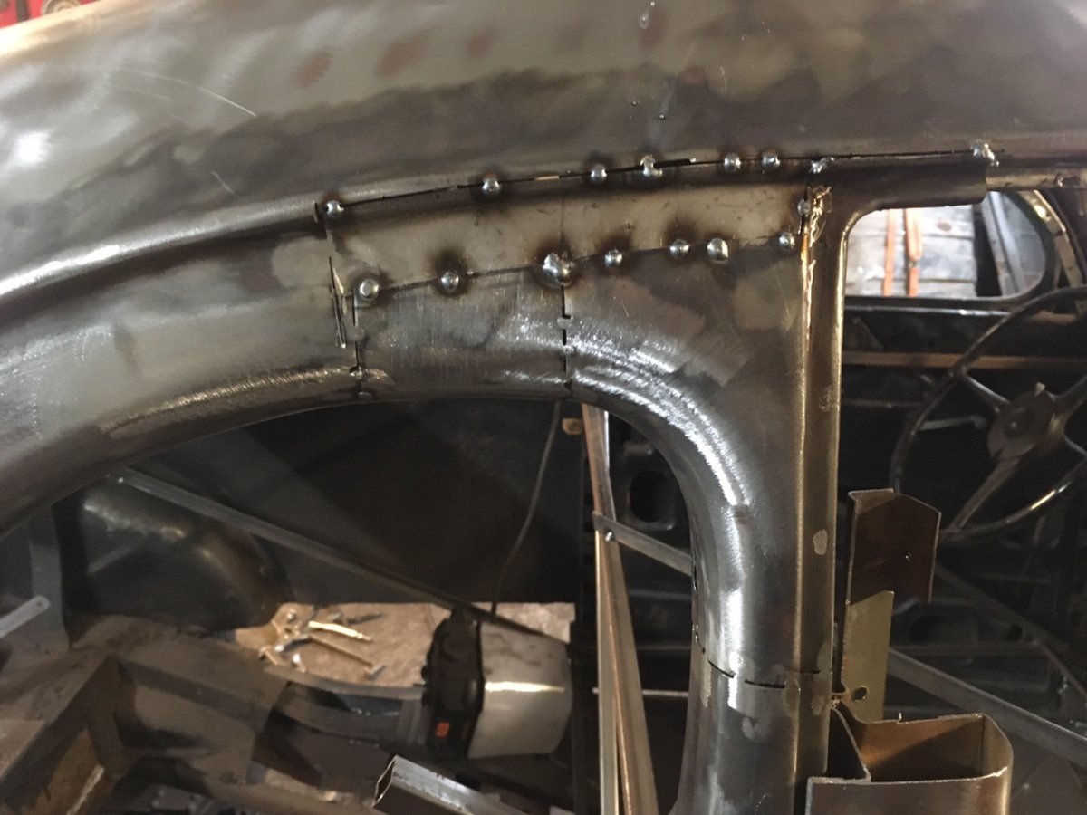

    C-pillars and A-pillars are there just need finishwelding once everything is in place.
    Required some cutting to make it fit good.
    Started fitting the top of the door too, takes a while to trim it down til it fits good.

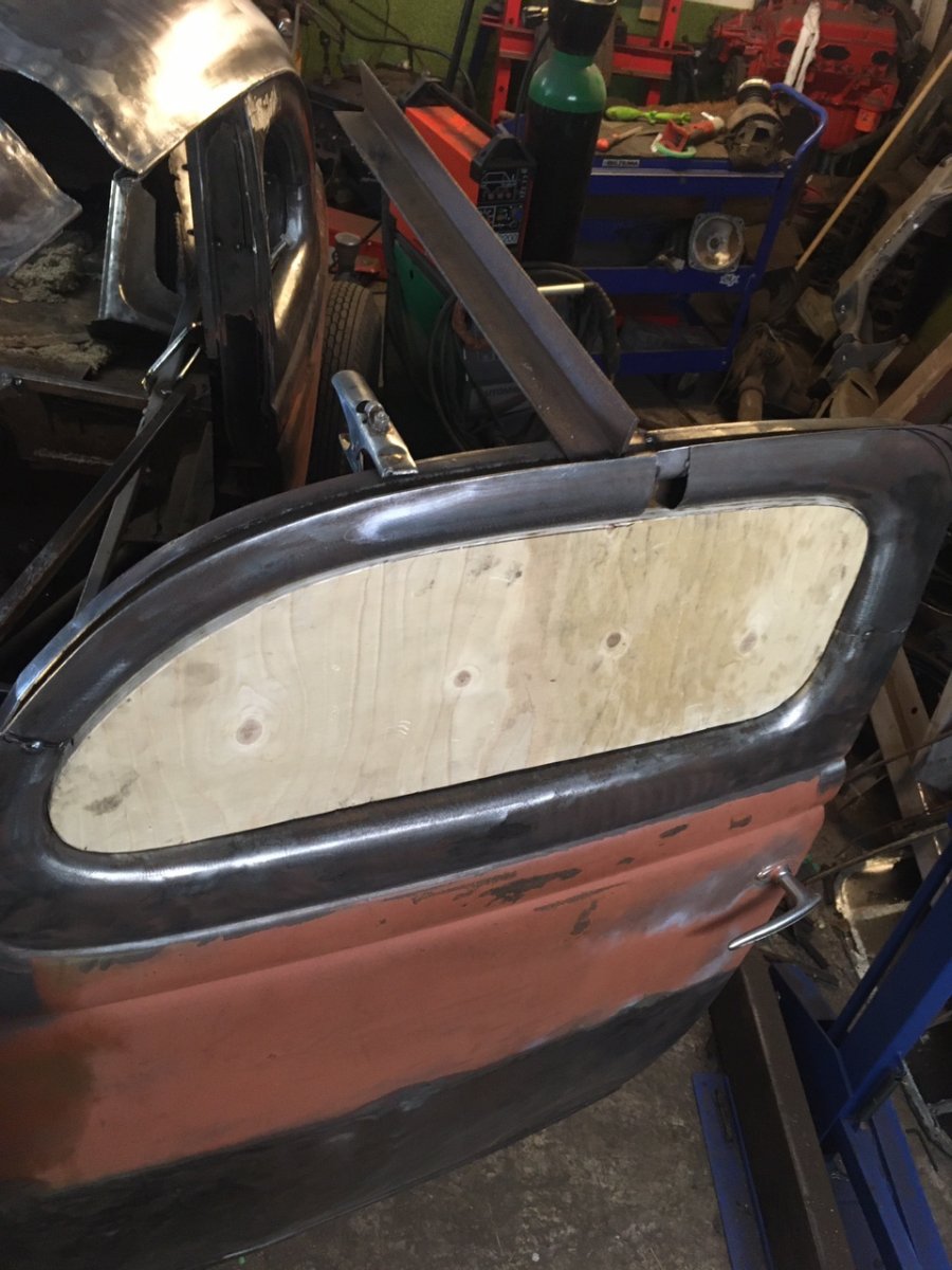

  26. emil
    Posts: 155
    emil
    from sweden

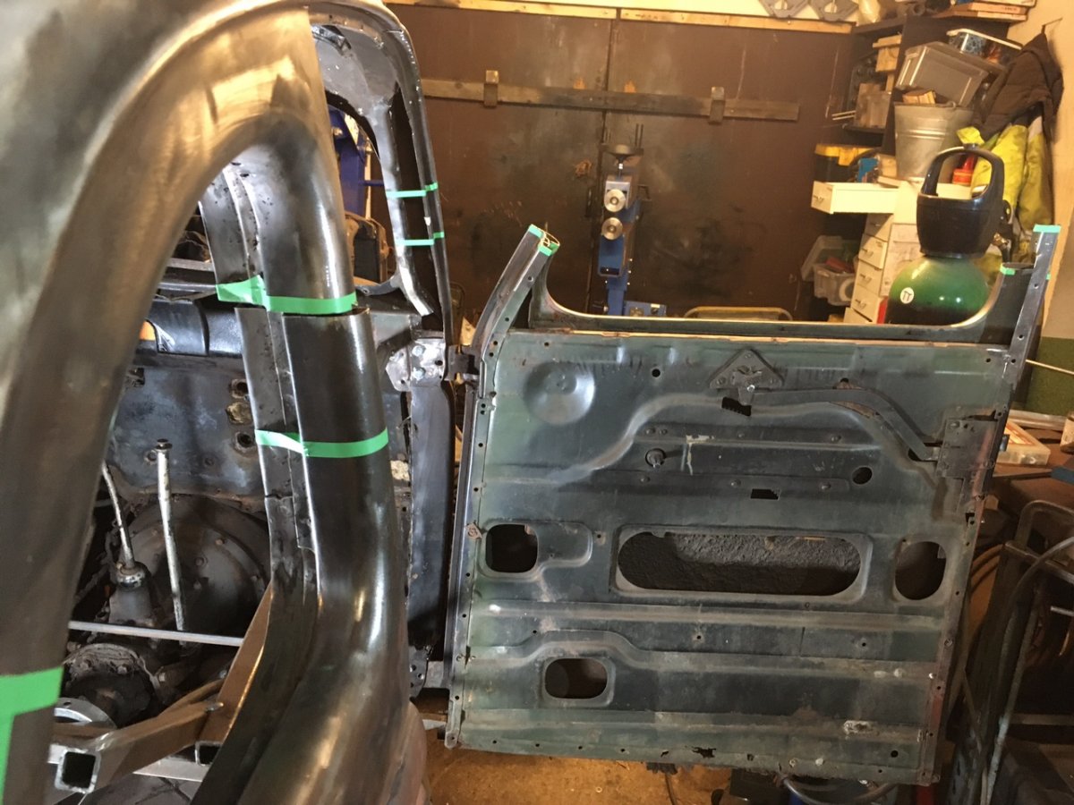

    So I have been very busy with life this last week or so, lots of work and taking care of my family so they don’t forget who I am.
    I managed to sneak in a few moments here and there tho.
    Made a wood template for the window opening in the driver side door, so I could mimic the window as exactly as possible on the other door.
    Here you can see the blue light shining through where it is off.
    So had to bring away some more until it matched the profile.
    Also had to figure out how to fill the gap in the door post, it has a brace inside which I can’t get to and work with without cutting the door all to shit.
    So what I did was fill the outside piece first, all the way from the back of the brace and around, and the I payed the top of the door post in place and folded the outside over like original, then I will do a little angle piece and weld in to complete the brace and the extra material will be hidden by the felt in the top where the glass slides in.
    Didn’t take picture of all that but will post when I get back home again.

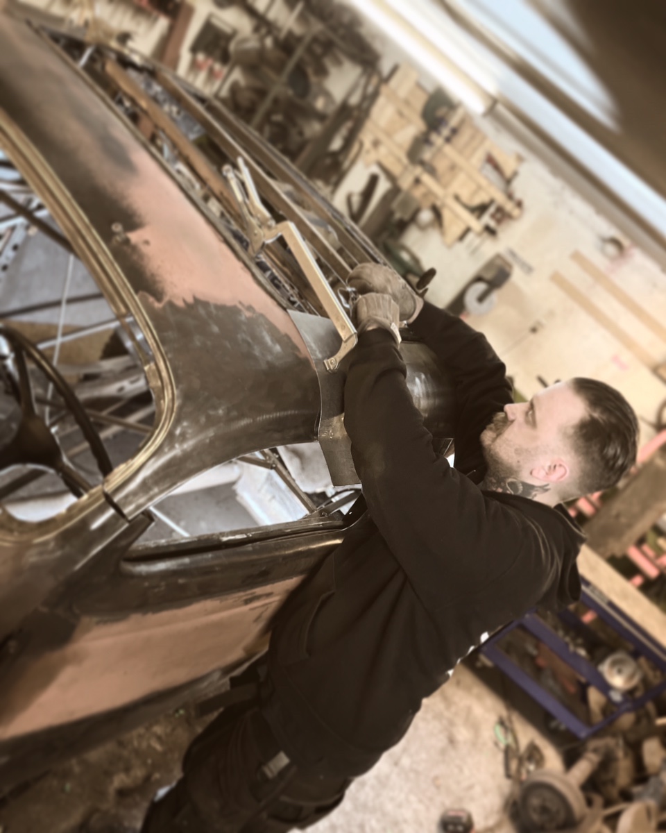

  27. emil
    Posts: 155
    emil
    from sweden

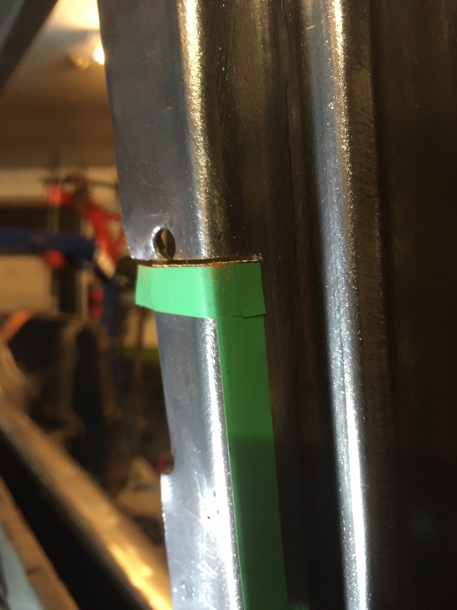

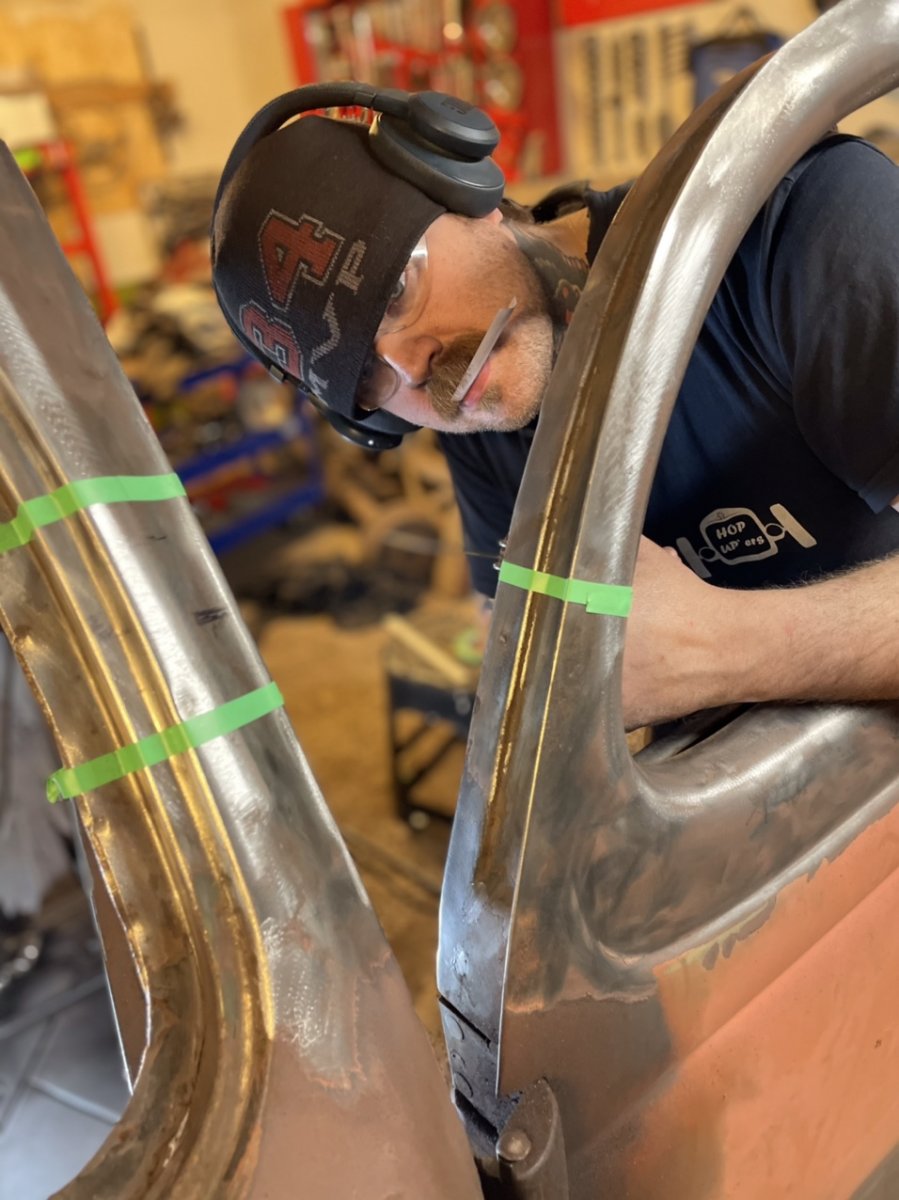

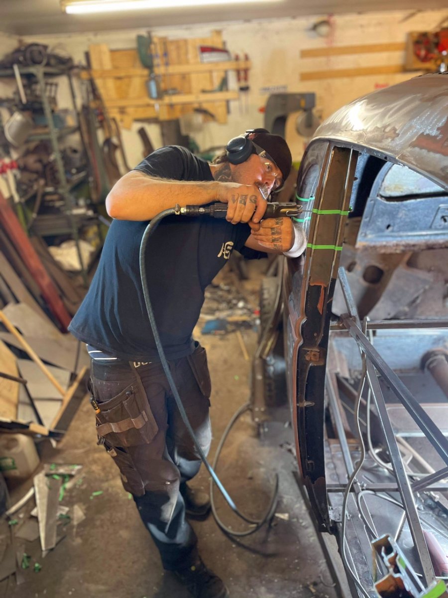

    There was a fair bit of work on this, because the driver side door was twisted, so I had to work it over a bit to get it to line up.
    Here you can see I had to weld an angle iron to the top and pry it down, you can see I put the top part of the door in first here but had to cut it out again.
    So I spotwelded the outside first, the worked over this a bit and the used hammer and dolly (read sledgehammer and a large metal wedge) and pushed the back part up to match before welding up the rest.
    Seems like ol Henry didn’t plan on us cutting these cars up like this
