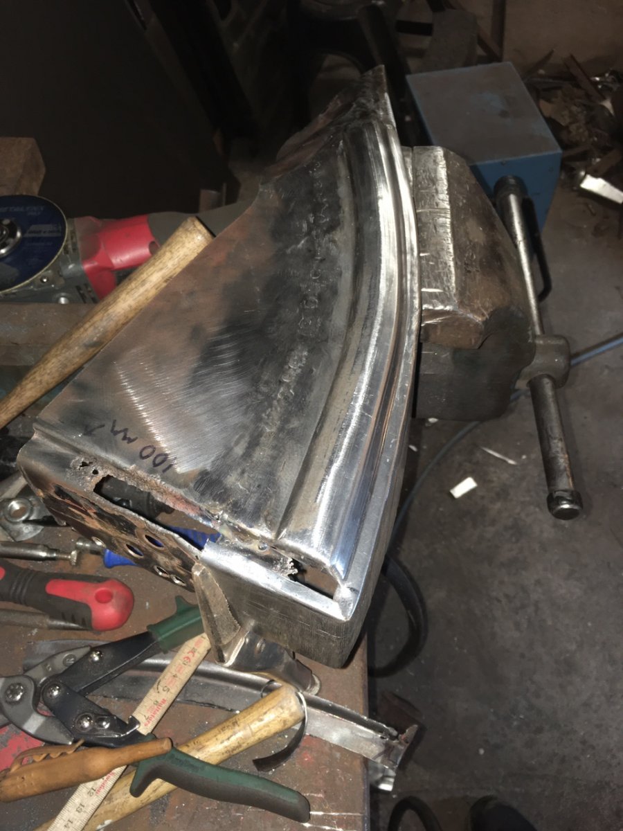

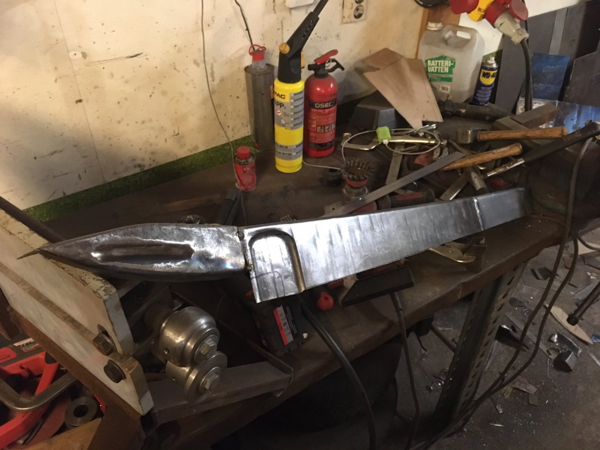

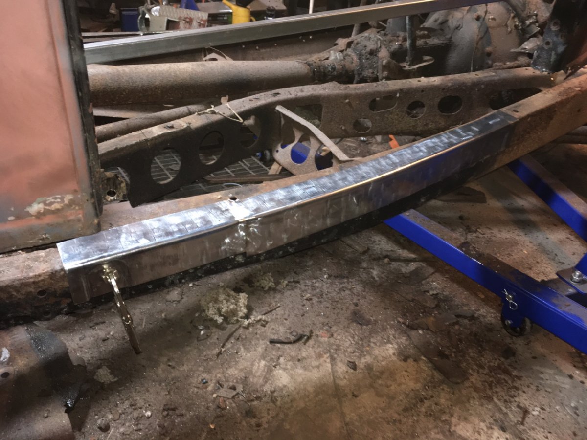

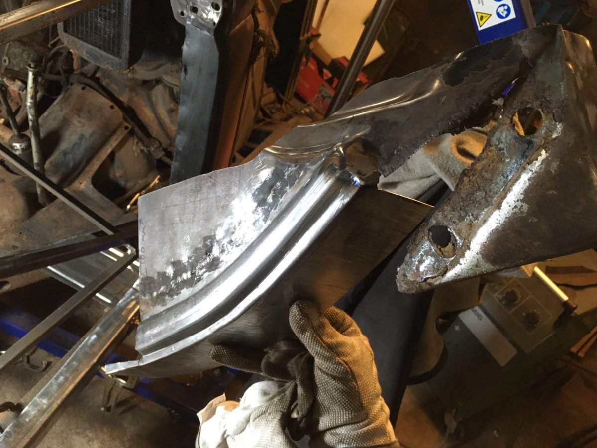

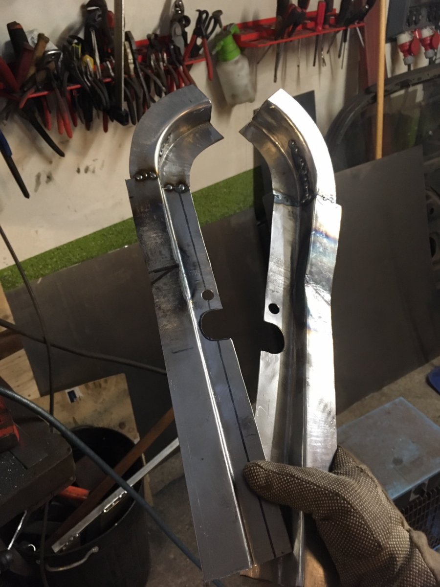

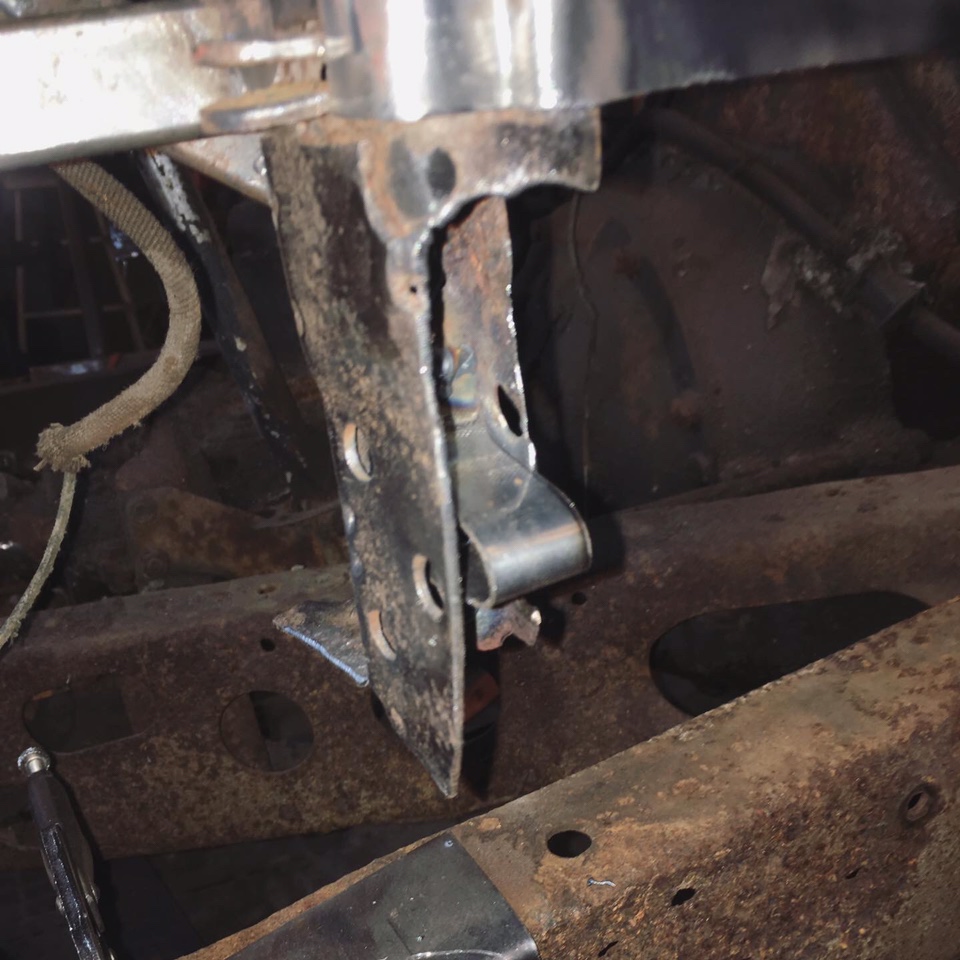

    Got a few hours in today, made some adjustments on the driver side rocker and started making the passenger side.
    I will make both and then lower the body over and weld them in.
    Will order some new tools tomorrow to help make the finishing touches on these before I weld it up.
    A bead roller with electric feed amongst other things, so I don’t have to crank it. Will make it easier to make smooth beads and will go faster.

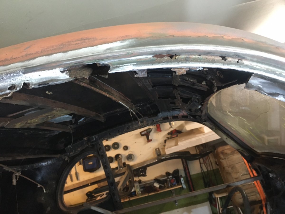

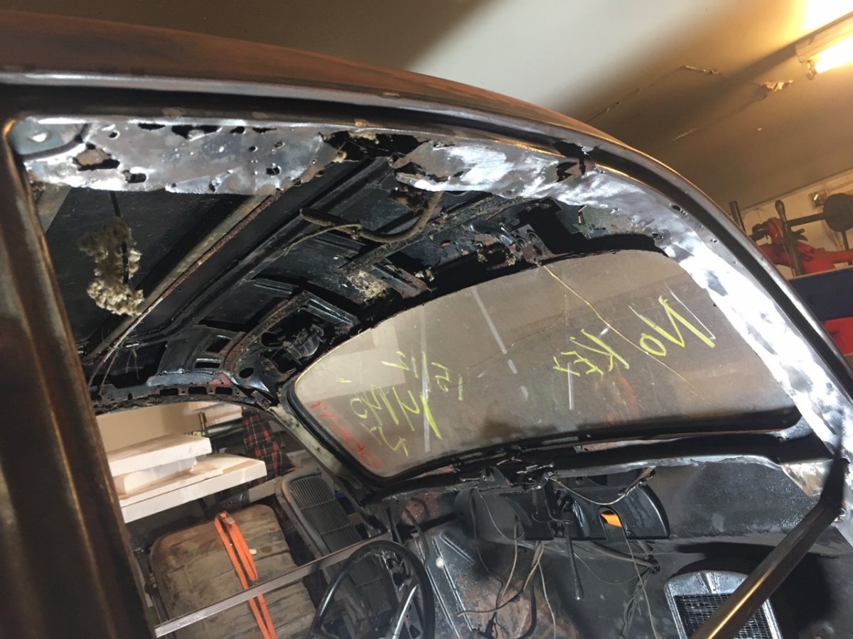

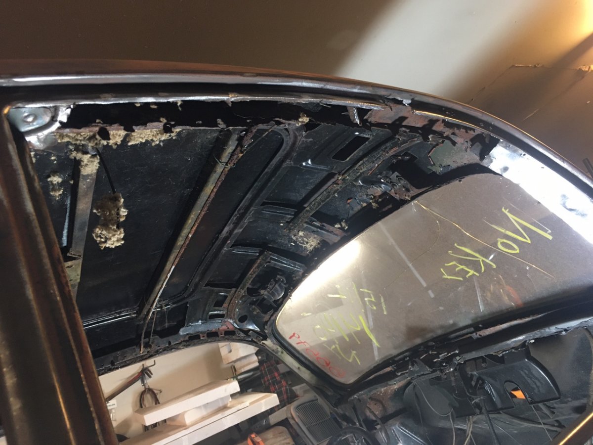

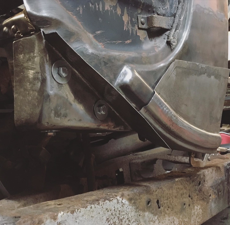

    Today I put some work into the area above the door.
    Mice had built a nest that collected moisture and rotted out everything so had to rebuild it all.

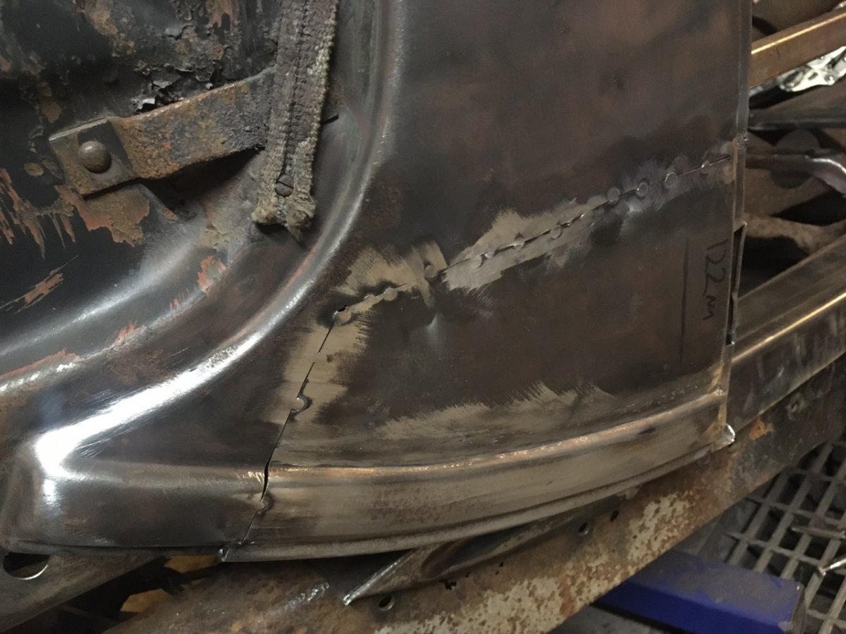

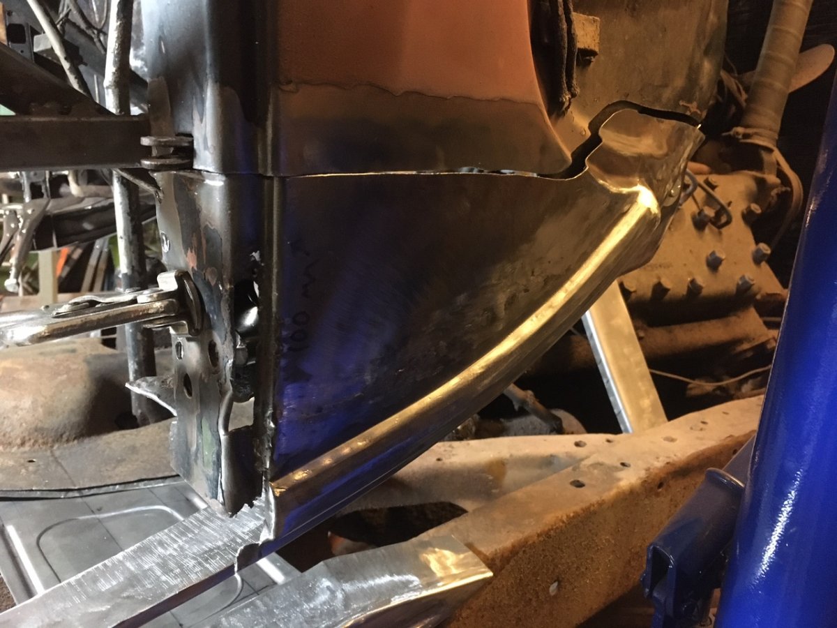

    Had a quick moment in the garage today, made some repairs for the lower part of the a -pillar.
    Tomorrow I get a tool delivery so hope to get a lot done this upcoming week.

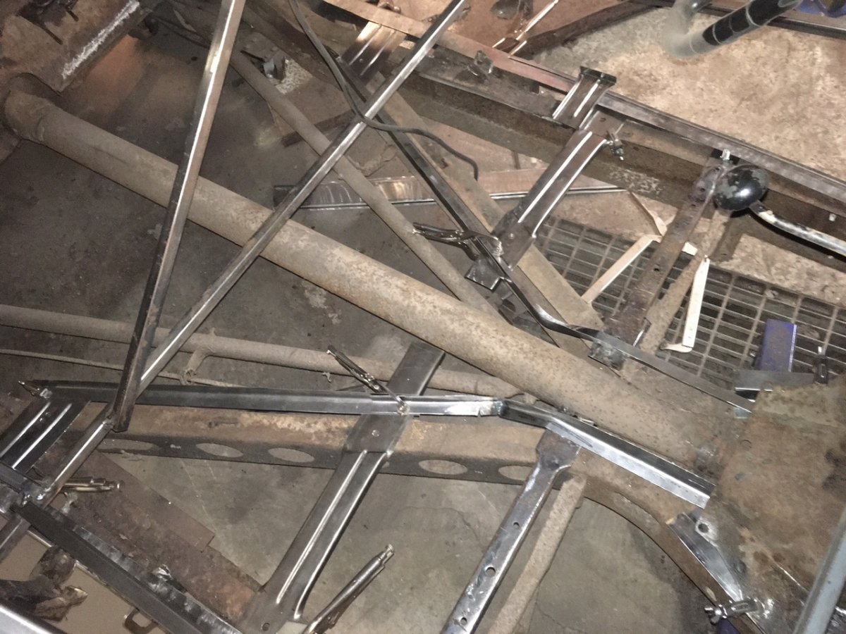

    Today I made most of the pieces for the substructure in the floors, got some awkward pieces done for the transmission cover and welded in the front corner of the body.
    Tomorrow I will start cleaning up the pieces and final weld it in so I can get it ready to weld it all into the body.

    So today I made some of the last pieces for the floor substructure, made some progress on the passengerside corner and cleaned up the pieces to start assembling everything and weld it into the body.
    Took more time than anticipated even tho I feel like I got a good amount of work done.

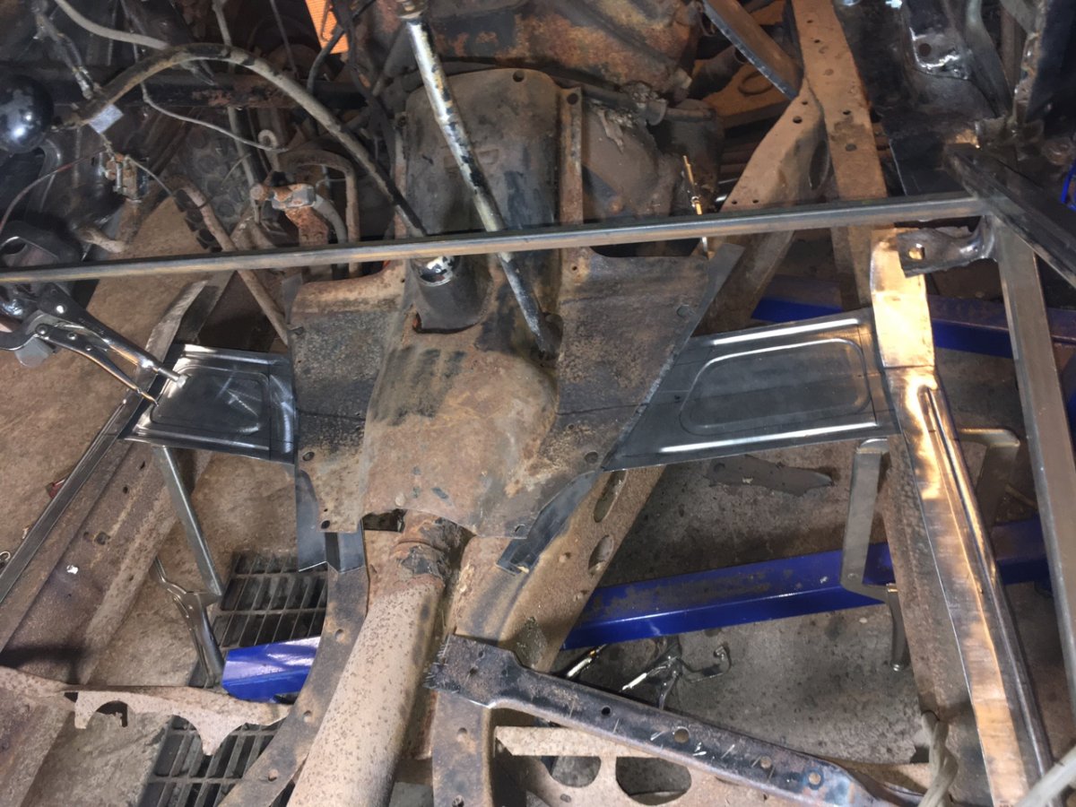

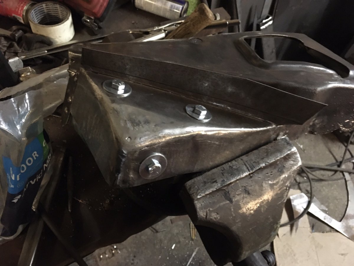

    These are the pieces for the mounting of the trans cover.
    Here they are in place.

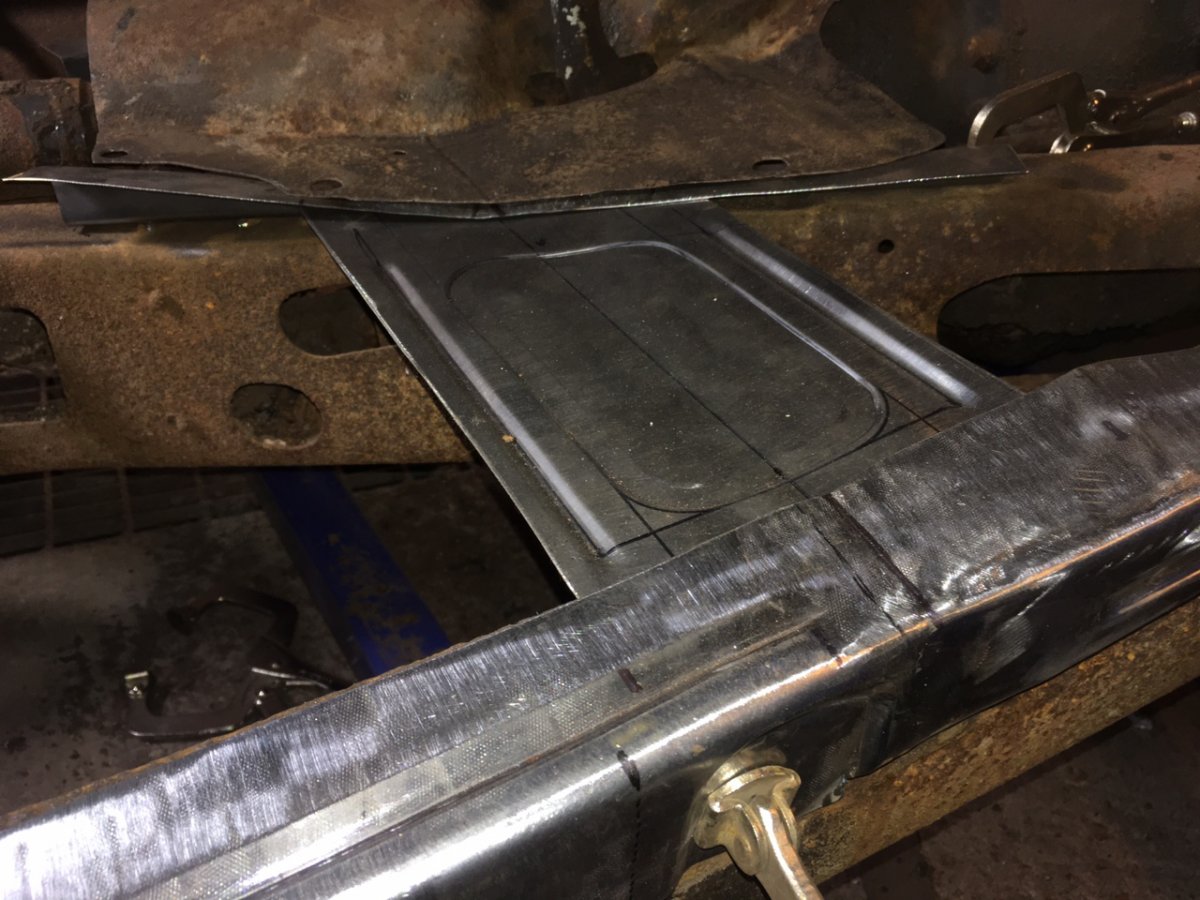

    Here is the start of the floors.
    Most of the pieces are done now and I should be able to finish up these floors pretty quick and the to cut this long haired hippy down a bit.
    Think 3 inches should be good off the top.

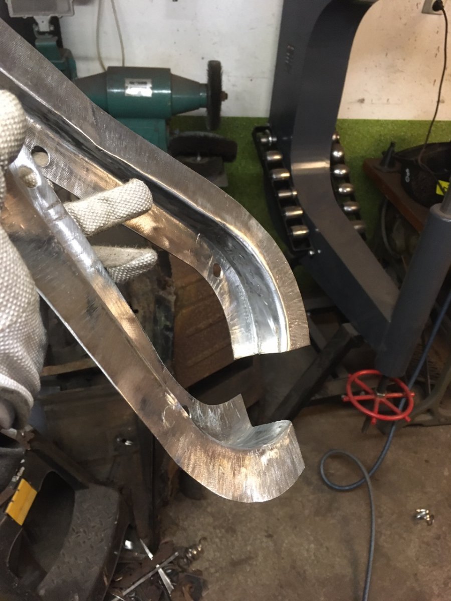

    I had to re-do some stuff on this panel, was in a little hurry when making it the heat time and forgot the mounting holes for the body to the frame..
    Might make a new one, it bugs me that I had to pound out the previous beads but I will wait and make some more progress on the floors first.
    This panel will be behind the seat under the carpet so it might be good enough.
