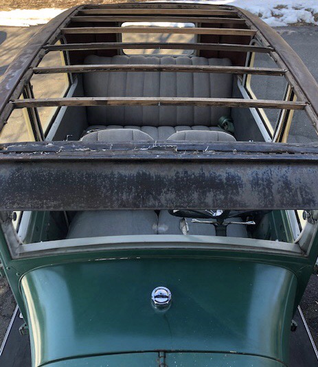

    I probably should hold off till I’m further ahead, but I have to post. It’s 48 degrees here in Bridgewater NJ today. Been driving my 29 Banger as is and loving it! Have had many hot rods in my life but drivin around at 35mph is way too cool! Just got many thumbs up from a few Harley riders. Makes me miss my 2 wheelers, but getting the the approval from my unknown brothers is way cool. I am loving this damn Tudor!.
    Pulled off the top as it was peeling up in the rear. Surprised how good it looked underneath...

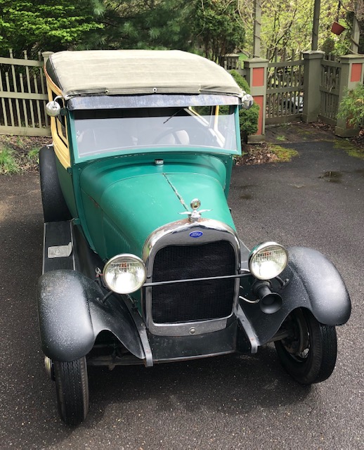

    Not much to report. Saving money for Bager engine rebuil. Did remove those shitty trailer lights on the rear fenders and got 2 new stock units. Wet sanded entire car and sprayed with flat clear. It’s driving great now and I absolutely love it. Did an alignment. Was way off, and as
    So balanced all tires at work. Needed a top. Not sure which way to go. For now, I made a top today from a Tarp I bought on amaz.... took me about 1.5 hrs. I know, most of you will make fun, but hey, I got some shade and if I get stuck in rain it takes 3-5 minutes to throw on after unfolding it!
    See below...(no laughing allowed!)

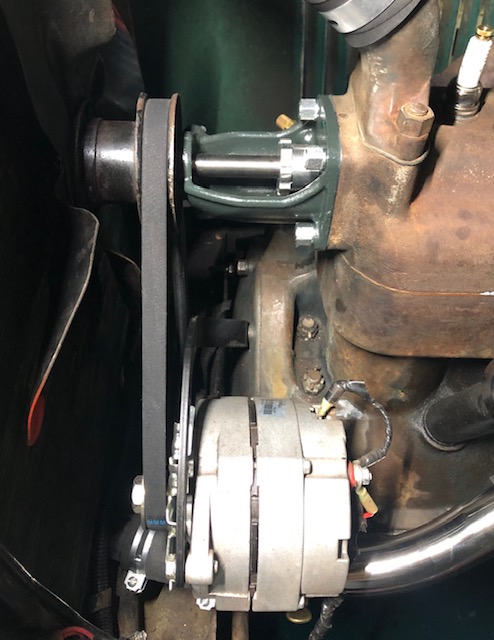

    Moving along slowly. Enjoy driving it so much don’t want to take it apart! So, for starters, because my steering is way bad, I ordered a new steering box from Randy Gross out in CA. One of the nicest guys you will ever speak with. It is the F100 box converted over to the A shaft. I had him do the 31 spline setup in stead of my 29. I did because I ordered the 16” 1940 Ford steering wheel from Limeworks. Supposed to be better ratio and way less play, and overall better steering from what I have read. I also had him cap off the bottom as I do not want to use the original clip on switch assembley. It bolts right in with only having to drill third hole for frame mont. Not required, but he advises to do it, I will. I will post how it rides after I install. Here is a couple of pics...

    So it’s in. Was simple. It lined right up with original holes. Took all but 10 minutes to put it in. Will drill third hole tomorrow. Let all know how it steers when done...
