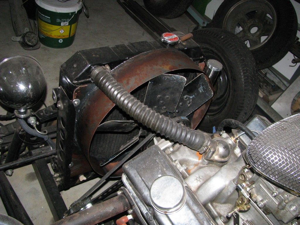

    The overheating wasn't cured by taking off the front grill, so either it needs a bigger fan, or I need to set the ignition timing properly, or both...
    Or maybe the shroud is too close to the rad, not letting air through the whole rad area.

    So, despite getting sick, despite the crappy monsoon season, despite being offshore half the time, I finally got round to attacking this overheating problem.
    I set the timing dead on, but found this distributor won't give more than 12 degrees mechanical advance no matter how high you rev it, so I set it to 12 degrees at idle. I also fitted the vacuum advance to manifold suction.
    It made no difference, still overheated.
    So, I pulled off the stainless 'shroud' and electric fan and fitted a huge Chevy mechanical fan direct to the water pump. This made a bit of a difference: it took longer to reach 240 degrees......
    Then I got serious, pulled all the rad off, and made a big shroud out of sheet steel. it took but a day to make, and some gas welding, and lots of careful measurement, and I put it on without paint just to see if it actually worked before I invested any more time in it.
    I warmed it up in the drive and it sat at 160, so all looked good. Then I went for a fifteen minute drive around the area, slow driving, built up area, and it rose to about 180 and stayed there. Then it stopped. :(
    After stripping and cleaning the carb again due to the crap fuel drying out and clogging it all up, I went for another 20 minute drive, then left it idling in the driveway for 15 minutes. It sits at a steady 180-190 at the highest.
    Seeing as it has a 180f thermostat in I think that is about as good as it gets. :D
    (The shroud does actually blank about 20% of the rad off as I never took it to the bottom corners, so that could be another mod I do when I pull it out for paint, just a bit more metalwork, but it might gain a small advantage)

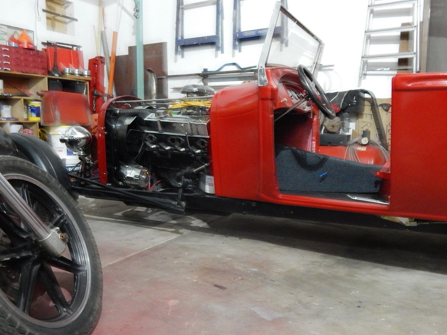

    My my, the time has flown by. Not a lot done to the car, just decided to paint it last week, and it is currently being slathered with red. And flake, i want flake on it, but due to local shortages of the sparkly stuff I'm experimenting with kids glitter. Everything i see on the interweb tells me it can't possibly work, but I've sprayed some mixed in acrylic clear coat and it seems to come out okay. I have an HVLP gun with a 1.4 nozzle, and the flake/glitter is small enough to spray.
    I changed to a darker red after the first couple of coats, as this one turned to bright orange in the sunlight. Not too desirable.
    Got my plywood seats covered, finally. Cost all of $50.

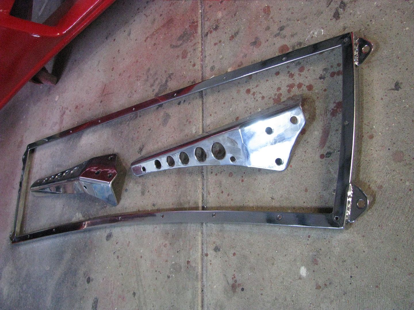

    Got the windscreen stanchions chromed, and the stainless frame polished. The chrome cost about $15 each, and you basically get what you pay for, it ain't great...
    My garage got prettied up to, some paint and flowers last month, courtesy of the wife.

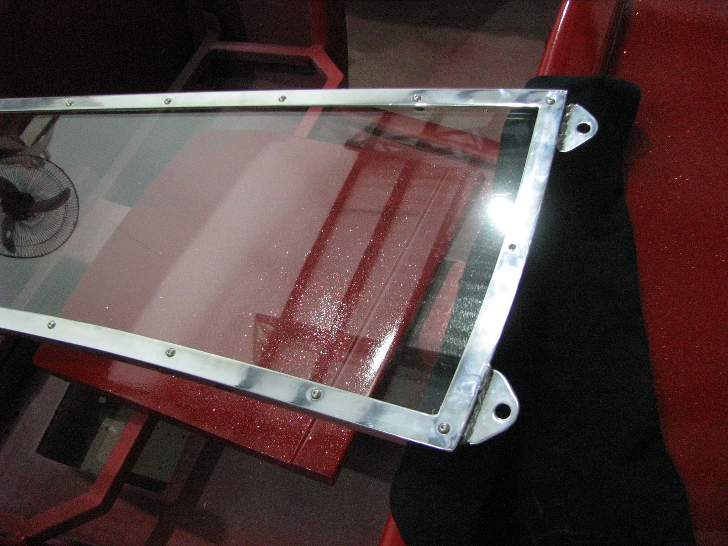

    More bling, I just finished assembling the screen this evening.
    The prices people pay for 'real' flake, I thought it might be worth trying this kiddies glitter stuff. I probably have a bucks worth of 'flake' in this job. Long term it will be interesting to see, but the car is not going to be parked in the sun every day, more like hidden under a car cover in the garage. Then again, it is my first ever car paint job, and I only ever used rattle cans on bikes

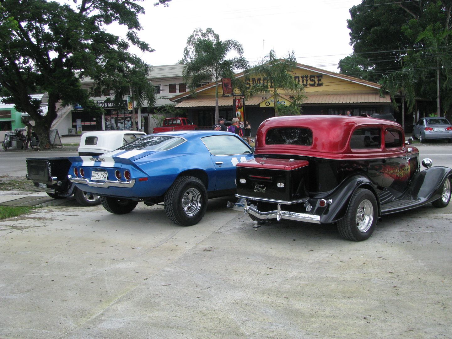

    Met up with some local buddies and held a short cruise. I don't think there have been five real hot rods together ever before in the history of the Philippines.
