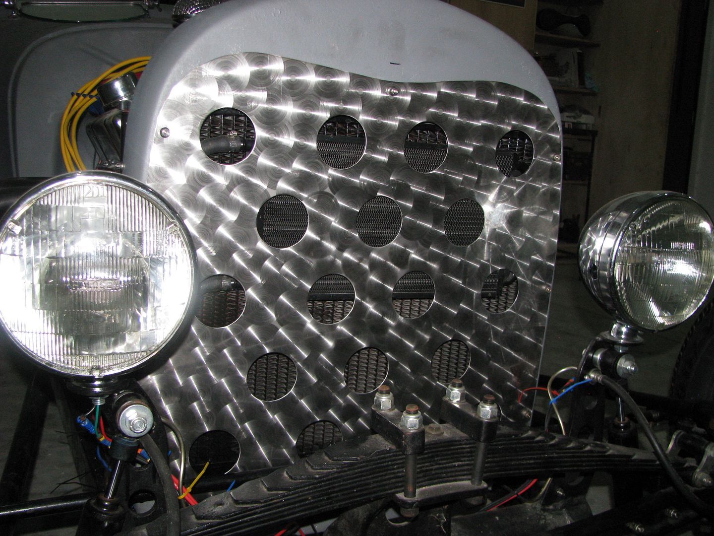

    I also made a front grille out of stainless sheet, with some big holes punched in it. Not sure if I like the look of it in the pics, but it looks okay in the flesh. I'd like it to go inside the grill cover but clearance is tight with the tranny cooler in there as the steering cross link runs pretty close.
    Small holes punched to take the centre bolt of the big punch.
    Punch is an old air force one I blagged some 30 years ago and have never used until now.
    I 'engine turned' it on my drill press, with some little pad thing I found in the cupboard.

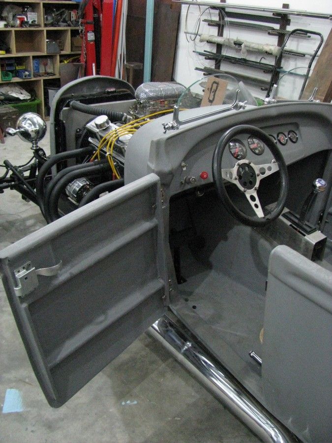

    I decided I didn't want the little Brooklands screens on, so I'm mid-way through building some steel posts. They are pretty hefty, 3/16" steel, but will be ground and drilled a bit then chromed. Screen will likely be poly sheet.

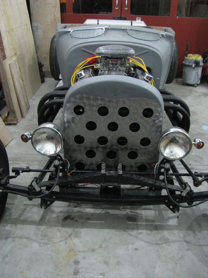

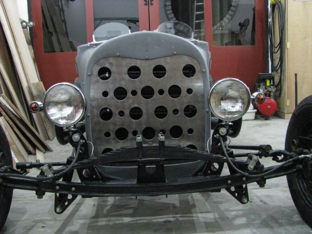

    I made a rad grill from stainless, thought it was brilliant, then took some pics and realised it looked naff.
    So, I did some work on it, put it inside the grill shell instead of on the front, popped some more holes it, took some of the engine turned shine off it, and I think it looks a bit better now.
    Doors and latches are fitted, seem to work okay. Seat bases are cut and fitted, waiting for foam some day.

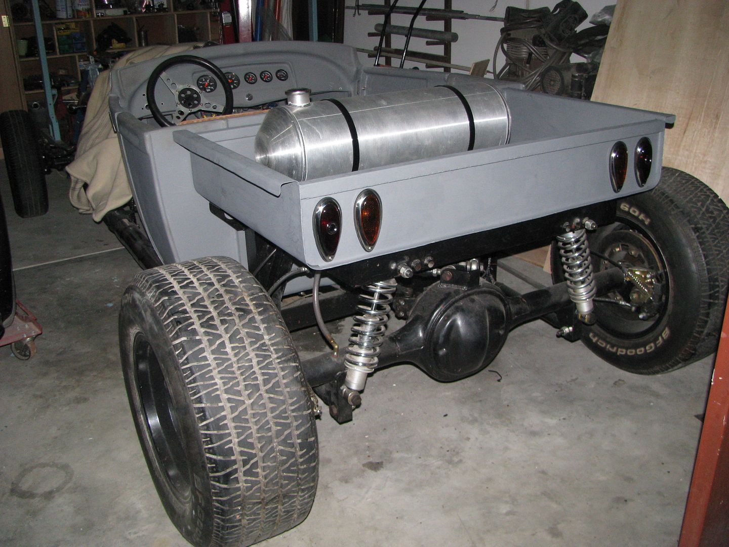

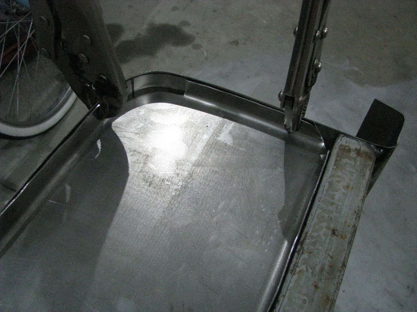

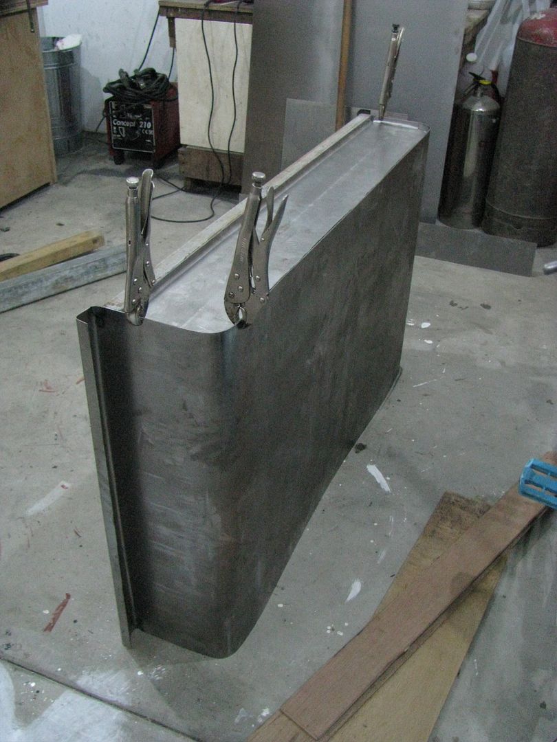

    I've made the pickup bed now. Well, it was done in the last two days as I only got back from the ship a week ago.
    I decided it was easiest to use steel, rather than 'glass. A 4 x 8 sheet of 1.2mm was purchased. Cuts were made with an angle grinder and 1mm cut-off blade. Bends were done over a length of steel or wood. Welding was by gas, as I don't have my Mig set up yet.
    I think the bed need some sort of 'skirt' round it, to cover the frame rails as it looks to high and shallow like it is.
    Of course, once I fitted the bed the fuel tank hit the front cross rail of the bed, so I had to re-make the fuel tank mounts, but it actually worked out okay as I simple put a couple of flat bars across that will support any weight put in the bed.

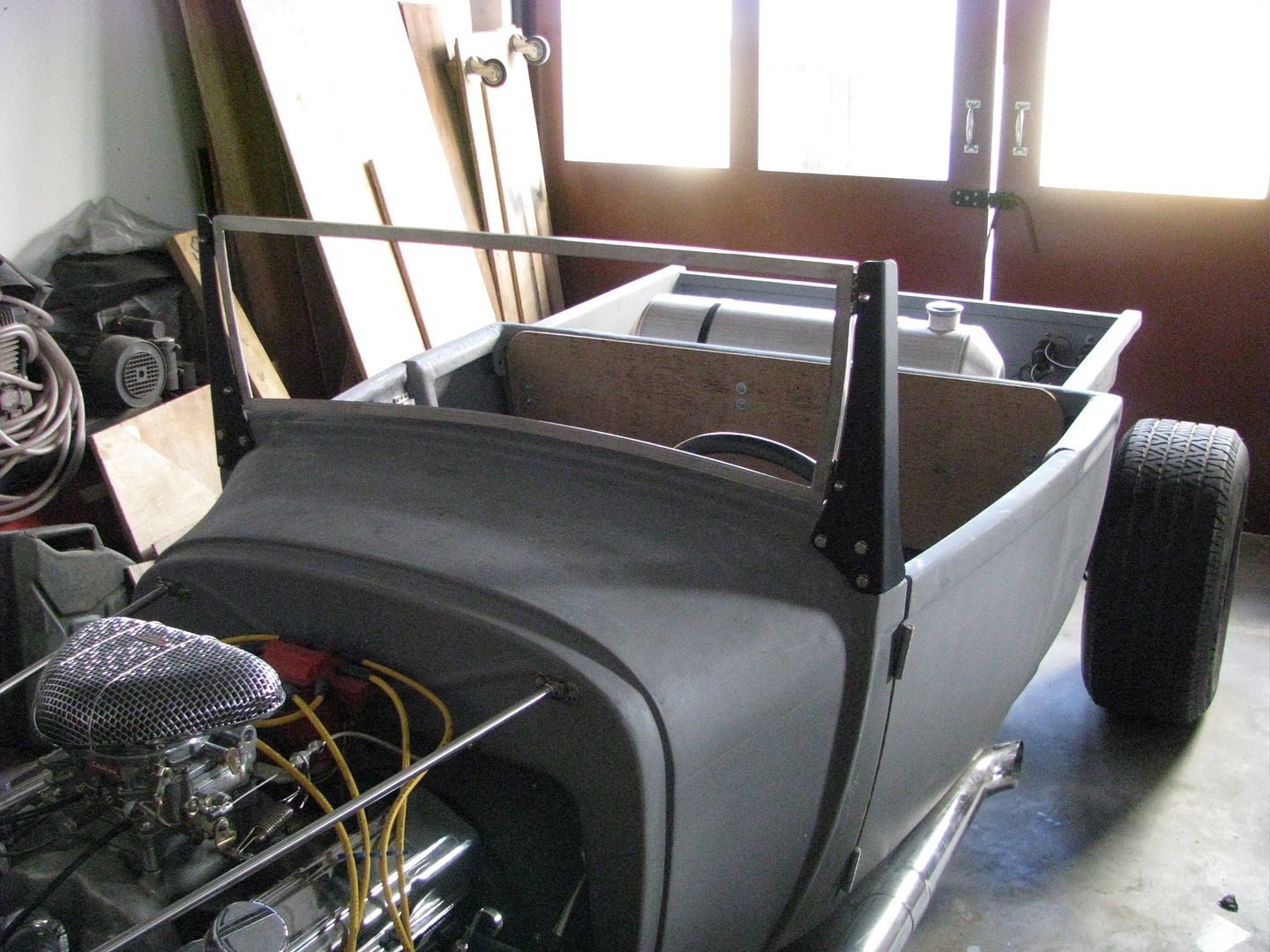

    I finished the steel windscreen posts, then bent up some 1" stainless angle bar to make a frame for a windscreen. It can be unbolted fairly easily if ever I decide to take it down the 1/4 mile. It needs glass in yet, or maybe some similar transparent material. And the frame will be polished some day.
    As simple as it looks, it took nearly a week to do as I had to make some steel bracing inside the cowl, to bolt the uprights to. Then I had to glass up and grind the cowl to they sat exactly upright when bolted on. I really didn't fancy having the whole lot tear out of the glass and hit me in the face at 70mph.....

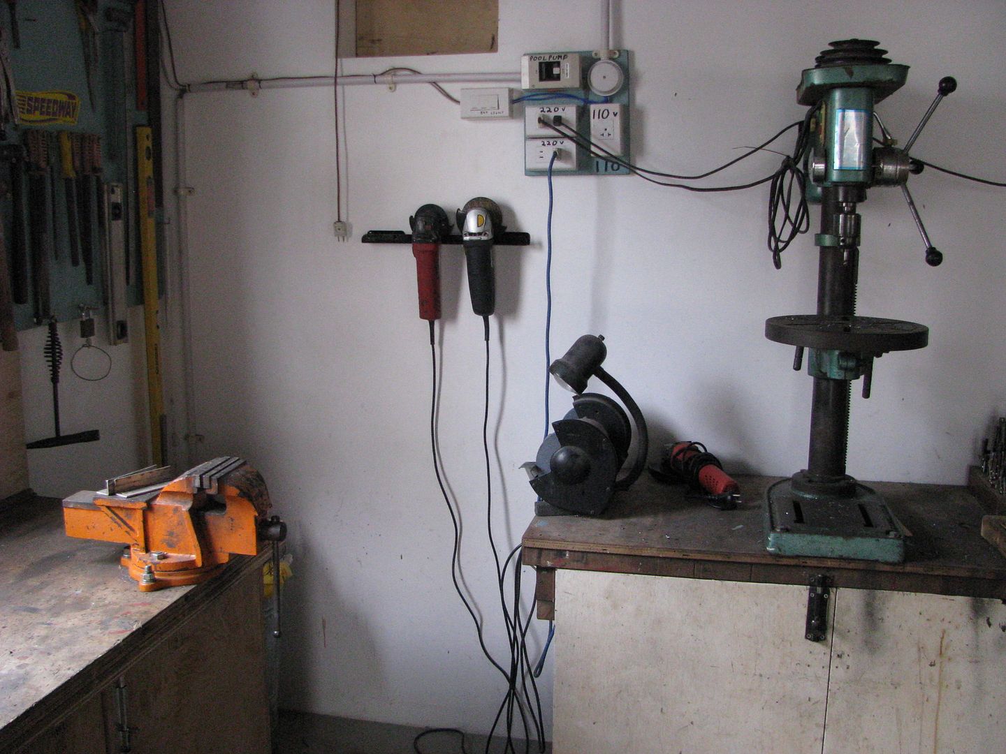

    I then decided to make a simple wall=bracket device to hang my angry grinders on, as I seem to spend bloody hours working metal in the vice and always end up getting the grinders mixed together, cutting a cable, etc when I put them down on the drill bench. One has a flap disc, t'other has a cut-off disc. There's a third with a thick radiusing disc in too, for cleaning up my shit welds.
