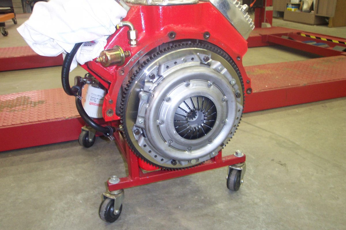

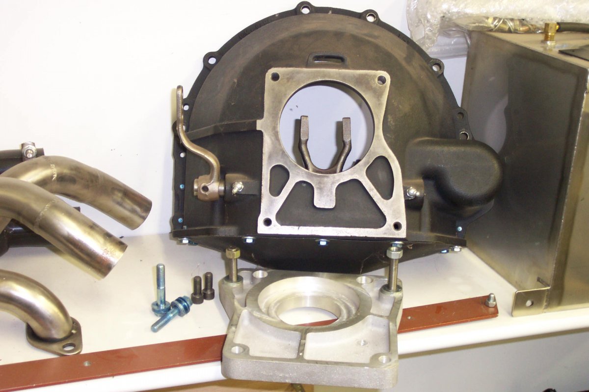

    I am using a '89 Mustang T-5 with an S-10 tail housing behind a '51 Mercury bell. I think '87-'93 Mustang T-5s have the same length inputs and bolt pattern. This requires a 1" thick adapter (because of the 1" longer input) that fits any '49-'53 Ford/'51-'53 Mercury car narrow pattern 4-bolt bell housing, available from Modern Drive Train and maybe others. I'm also using the stock '51 Merc throw-out bearing.
    I'm not sure of the depth comparison between the truck 3" 1/2 bell/hogs head combo and the car full bell housings, something that directly relates to the intended trans input length.
    The Mustang input spline is 1 1/16 x10, not the truck 1 3/8" x10, so a different clutch plate will be needed. You also may want to re-think using the truck 11" pressure plate; a modern diaphragm is a much better choice than the obsolete Long style. (Ford hasn't used the Long since the '70s-is that "vintage enough?) Less pedal effort and lower price are two main advantages. A common off the shelf 10.4" diaphragm will bolt to any '49-'53 Mercury flywheel or aftermarket with the B&B bolt pattern. There are some direct replacement diaphragms that bolt to Long pp patterns.
    Below is the Merc bell and 1" adapter (MCF in my case)
    .... the engine/trans...
    ...and the diaphragm clutch...

    Bob, You are always a wealth of information, and the pics to go along with it ! Thanks.

    Does the diaphragm have the same travel and actuation height as the long pressure plate so that the same clutch pedal linkage and throw out bearing can be used?
    And your color choice is perfect!
