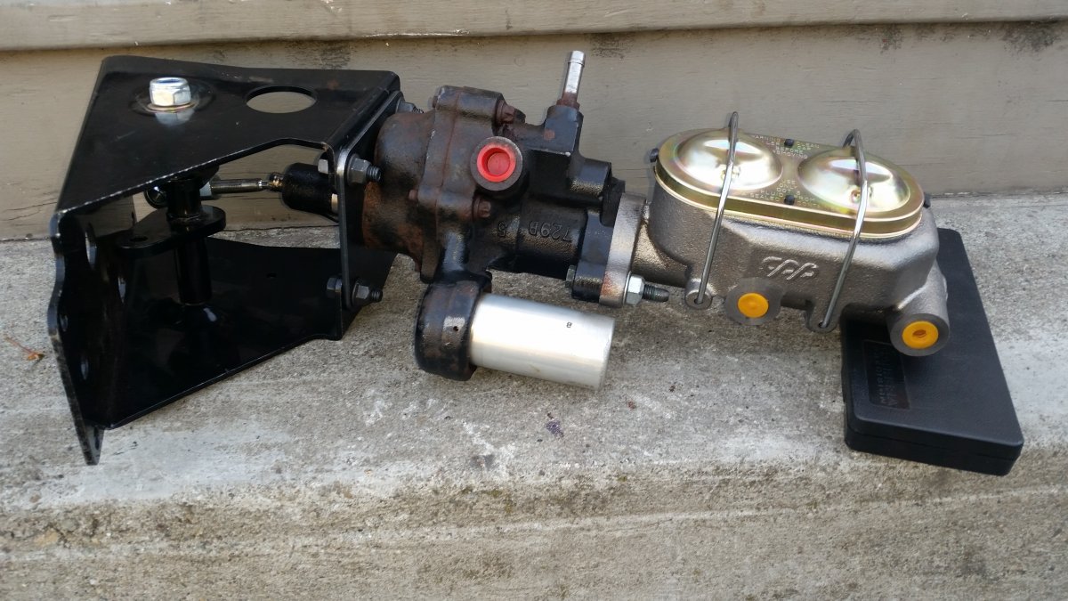

  16. gimpyshotrods
    Joined: May 20, 2009
    Posts: 23,264
    gimpyshotrods
    I have Hydroboost on my Falcon. If you were not wearing your seat belt, you'd go through the windshield.
    Shadow Creek and nunattax like this.
  17. Shadow Creek
    Joined: May 14, 2014
    Posts: 301
    Shadow Creek
    @gimpyshotrods is that a mustang unit? I’m trying to decide which hydroboost unit to run on my project

  21. 49ratfink

  26. Did you ever measure the line pressure generated with the hydro boost?
    He’s at 900 psi (at the caliper I’m guessing) and still can’t stop.

  28. gimpyshotrods
    Posts: 23,264
    gimpyshotrods
    Over 1200psi.
