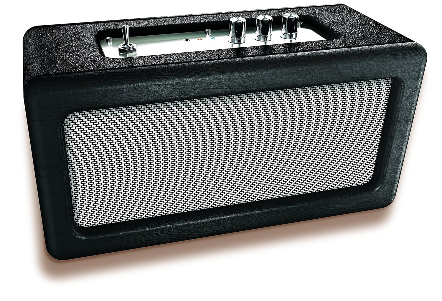

    I'm in the Bluetooth speaker camp too. I was researching these recently. All you really need to fool with is a way to keep it and your phone or other media player charged if need be. Some of the speakers are fairly artsy or at least fairly easily overlooked in a period car too.
