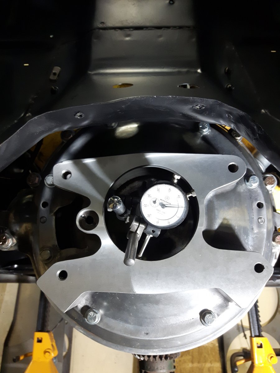

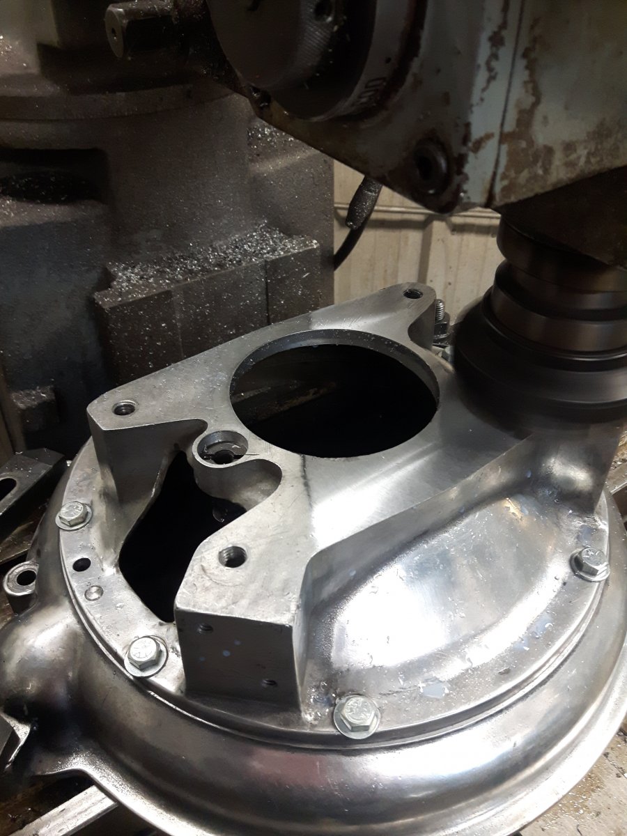

  24. Halfdozen
    Joined: Mar 8, 2008
    Posts: 632
    Halfdozen
    Verify that the bellhousing locates the trans concentric and parallel with the motor. This is time well spent whether you go into the trans or not.
    Pull a flywheel bolt to give you a spot to attach a mag base. Dial the hole and the mounting surface. The bellhousing in the attached pics is an old two piece Offy, it was out of concentric .049, for a TIR of .098. It required a .028 cut on the mounting face to square it up. This much misalignment had been causing the trans to shift hard and pop out of forth, it had trashed the input bearing and the pilot bushing.
    Never assume any bellhousing is accurately machined. Some trans manufacturers warn you to do this before installing a new trans, or they will not warranty it.
