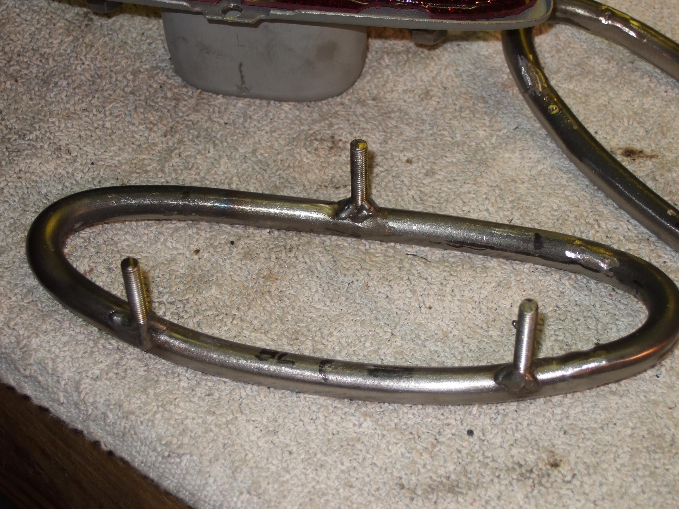

    I'm working on a 50' sedan and the pictures at the start of this thread covering frenching tail lights was very helpful. I want to share one thing I added regarding this section which might be of interest.
    I welded 3 short lenghts of allthread to the back of the new roundbar bezels so when the bezels are welded to the body, I could easily attach the tail light housing from within the trunk (see pics below).
    I also used the Lee Lenses with 3/8" roundbar (soft steel = red color coded).
    Regards,
    X

    The roundbar pieces look good & I like the idea of the studs out the back . It may be a bit more difficult to seal the area between the Lee Lens & the body with your method , but it should work great to align everything . Great job !
