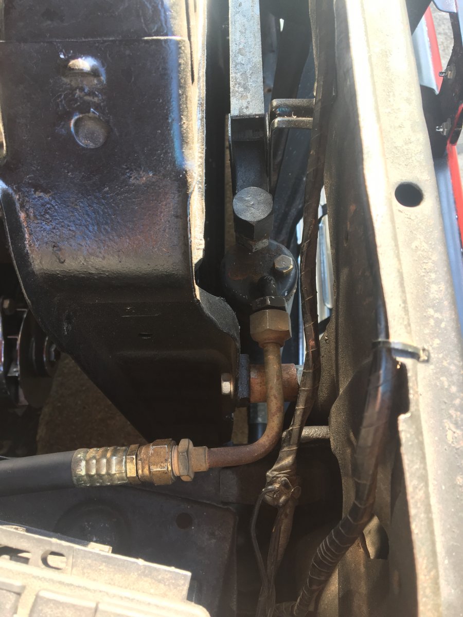

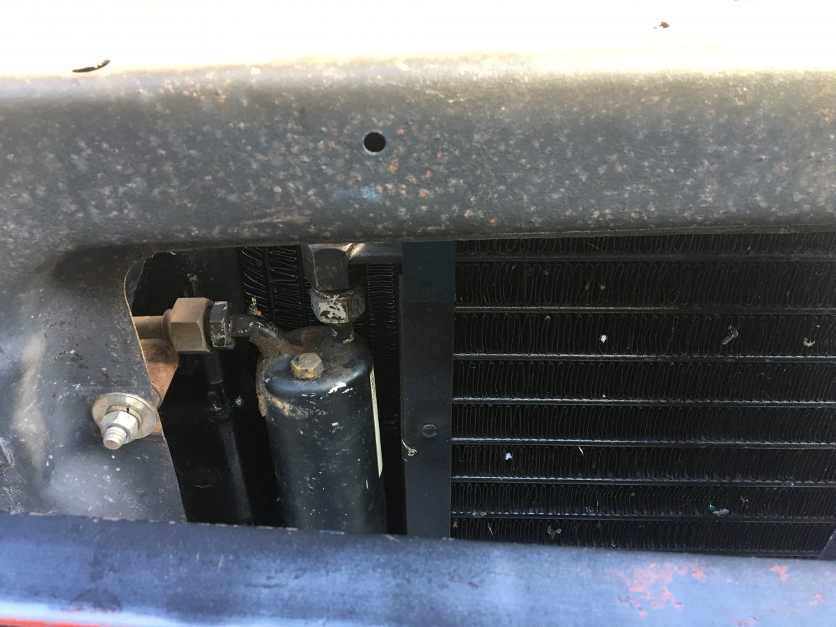

    So I’m using the condenser and dryer from a ‘66 Mustang in my F100 and it’s a great fit.......upside down and reversed. Can I do this or does it have to be right side up? Dryer is directly attached to the condenser. The reason I’m doing this is to get the compressor on the passenger side and to keep the hose lengths as short as possible purely for aesthetics.

    There is no sight glass on the dryer. And according to my Ford shop manual the dryer fittings when mounted are on the bottom.
