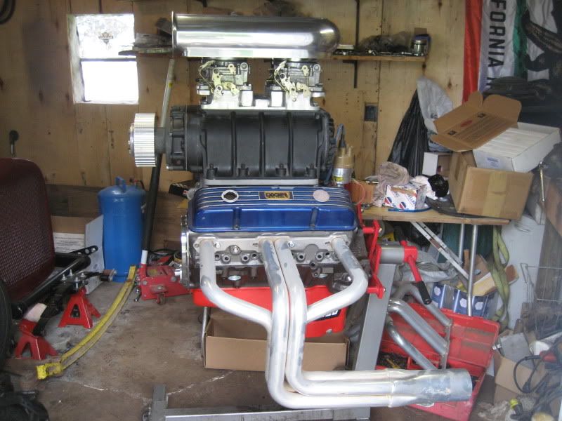

    I finally got my motor to the point were I can drop it in the 27! I just got the tranny back from the GF's Dad, now I can start setting it in the frame.
    I have lakes pipes for the motor and im going to blast those valve covers. Just through anything had around on cuz I was excited.
    Compression is 7.49 with a boost retard box, and pullies are for about 8psi boost.

    nice! probably won't need the boost retard with that little compression and boost level. I run 87 in mine

    I might run a better set of pullies for occasional runs but I like the adjustability that comes with the box. What compression could I run with forged rods, pistons and cast steel crank? 31cc pistons, 76cc heads
    Squirrel, what should I set up my timming at?

    BTW, I ned to trade someone for a shorter carb base! This is a vintage crager unit. But the motoer needs to loose some hight... Preferably a cast one but Im not picky.

  8. are you going to paint it or leave it bare cast iron?

    I am going to paint it, but What color??? the tuff decisions...
    Probly black

    I dont see any head bolts, you might want to double check that.

    its an old picture, I have everything set up now.
