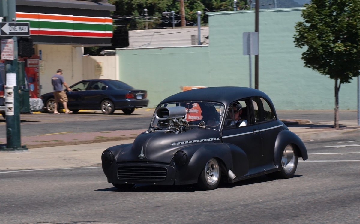

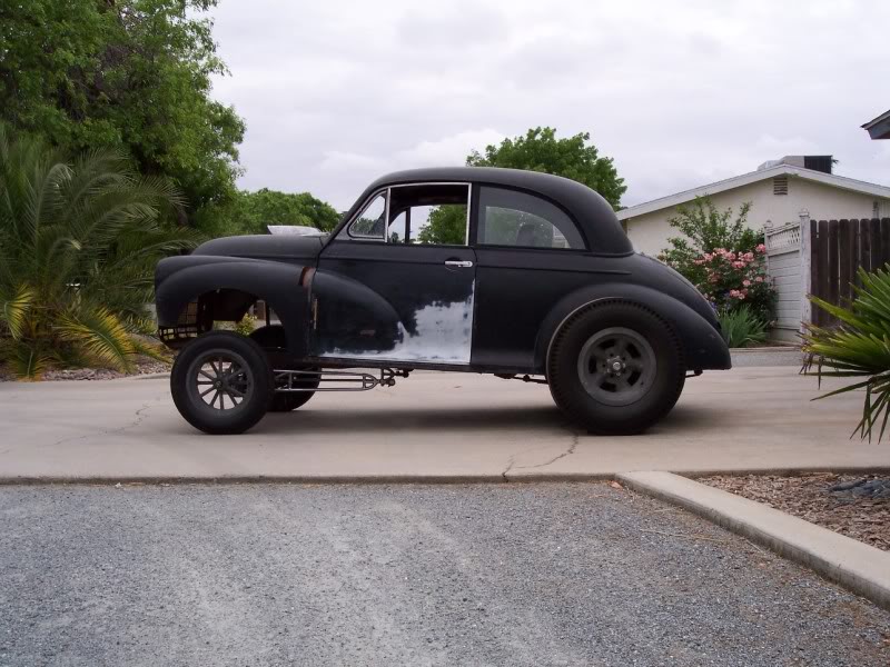

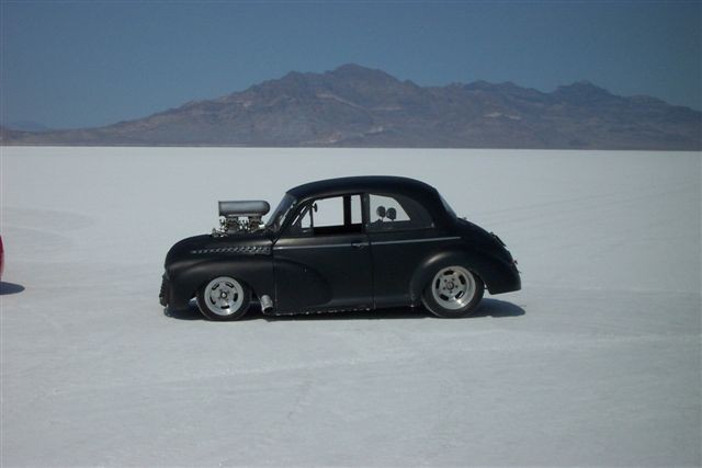

  5. I love 'em....photos of my brother's 61 minor......406 sbc, powerglide/8.75" mopar 3.91, posi. Drove it on the street occasionally, drag raced [10.32 ET] and we even ran it at Bonneville!

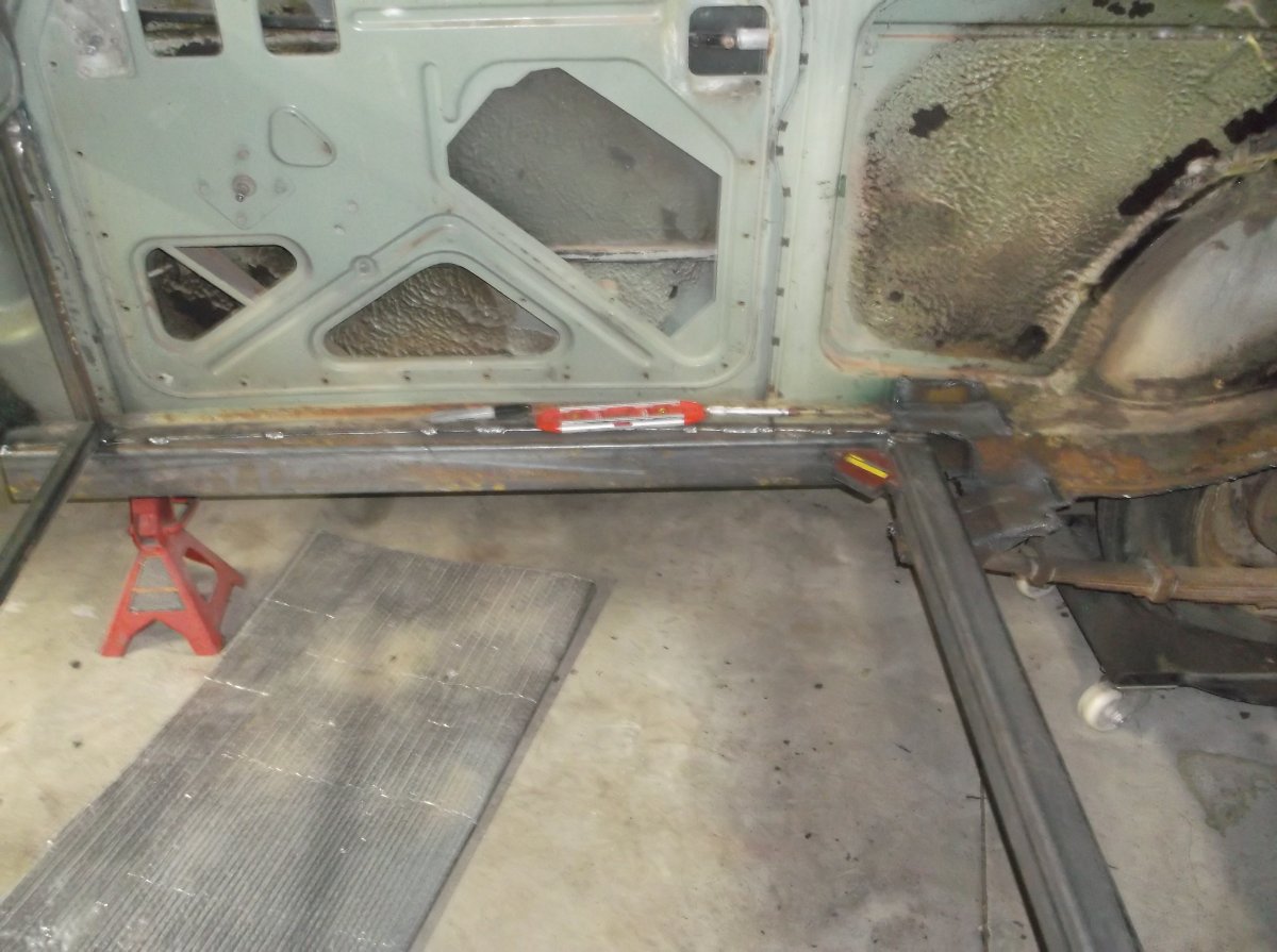

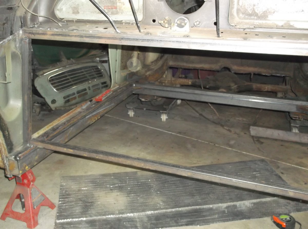

    DSCF3279.JPG DSCF3280.JPG DSCF3282.JPG Here are some more pictures. Pretty boring stuff,stripping out the car and cutting away the old firewall,floor pans inner rockers.
    Southeast Gassers announced a D/Gas class for next year at 10 lbs per cube. So it looks like I may be building the worlds heaviest Morris Minor .It will have to weigh 3060 with me in the car.

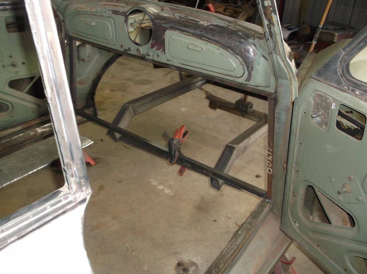

    Since this is not my first V-8 Morris Minor build,this one should go faster. I run 2x3 box tubing down the inner rockers and then tie those to the new main frame rails. It also gives me a good place to tie the cage into. I will be using the original rear springs on floaters with the required 42 in ladder bars.
    That put them almost to the vent windows. The car would work better with 30 in ladder bars ,both for packaging and less tendency to wheel stand. Per the rules I will be stretching the wheelbase 1 inch at each end. Giving me a whopping 89-90 inches. Should drive like a Cadillac.
    I got for free a front axle from a 54 Ford f-100 with disc brakes, so I need to cut about 10 inches out of the middle so the front tires will be even with the inner edge of the fenderwells. I will narrow and drill it and get some shorter springs. I have some mono leafs that came off the axle if anybody needs some .
    I also have a 65 F-100 rear end that I need to narrow. I am going to run a 4.86 gear to start with.
    Looking for a used small block Ford tunnel ram for a 302.

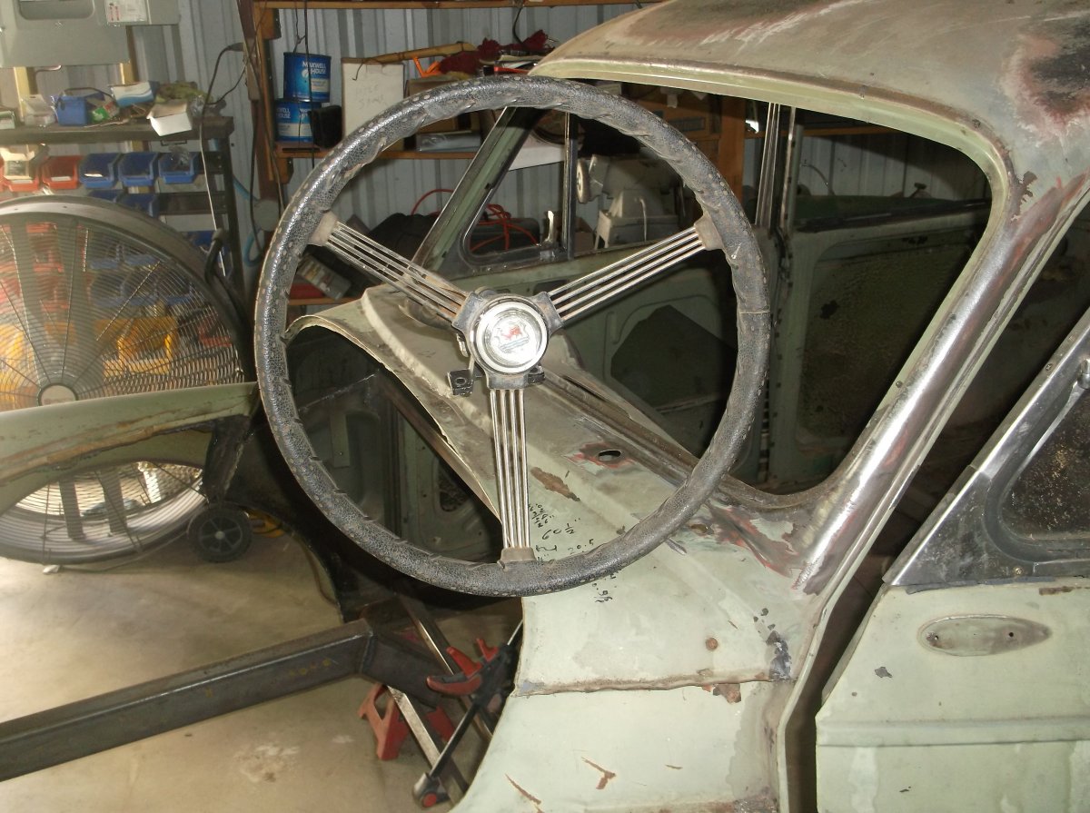

    Going to try and use the original steering wheel and column. They had one of the coolest stock wheels ever made. Going to adapt the original floor mount pedals. DSCF3284.JPG
  14. "Should drive like a Cadillac".
    A Cadillac on meth, haha.
    I have one of those steering wheels too.
    They look great cut down a little.

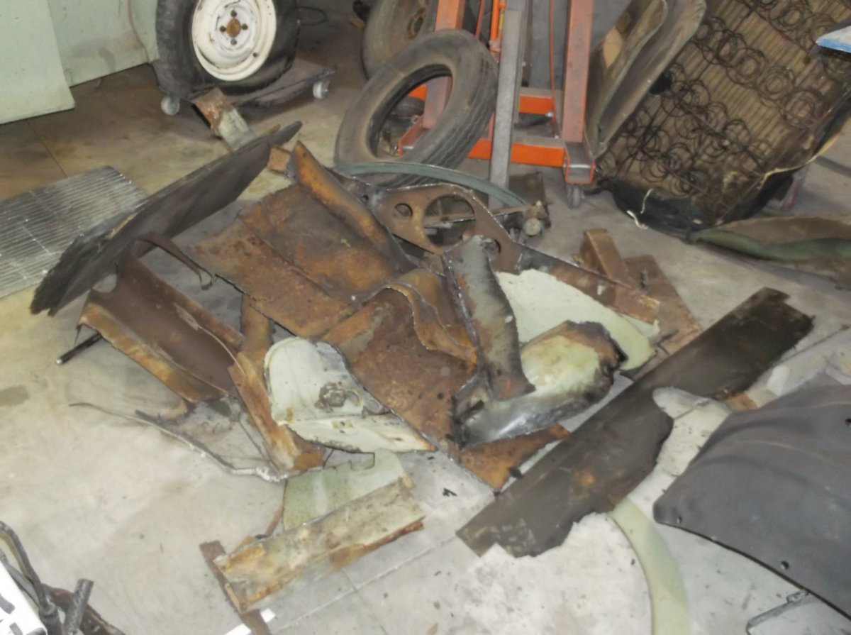

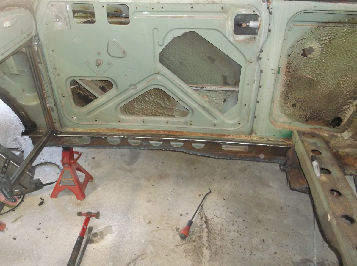

    Got some more uneeded metal cut out and the inner rockers and rear crossmember in.
    Will cut out the middle for a driveshaft loop. I always base the build off the rear cross member
    so it needs to be square as the frame rails and cage are based off that. The bars at the inner rocker
    will get welded and tabs added underneath. That mounts the body. Since this will be an all steel car
    no reinforcements to mount fiberglass parts are needed.

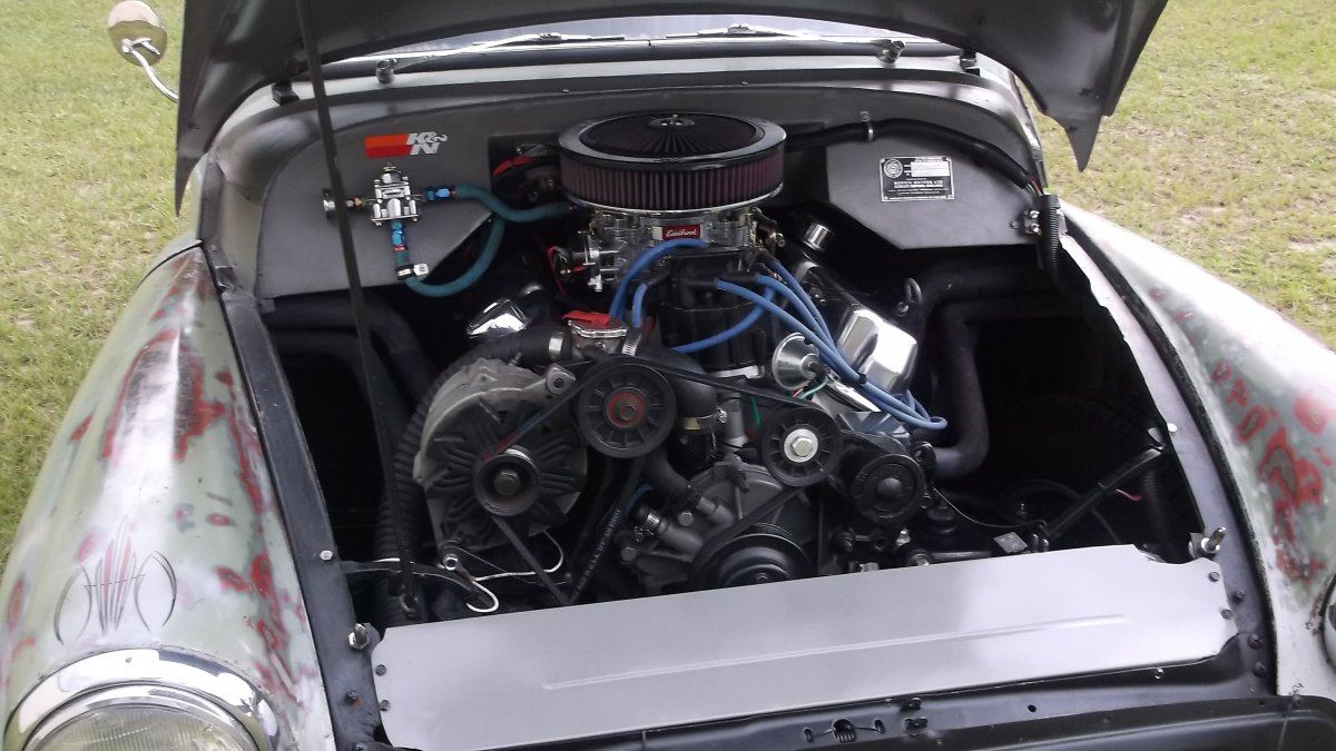

    Even with the added tubing at the rocker panel my last morris weighed 2400 lbs all steel with full street equipment. That's with a iron headed 302 and an aod.
    Here are some pictures of my last Morris street rod ,daily driver. I am having trouble with downloading the stuff I did today.

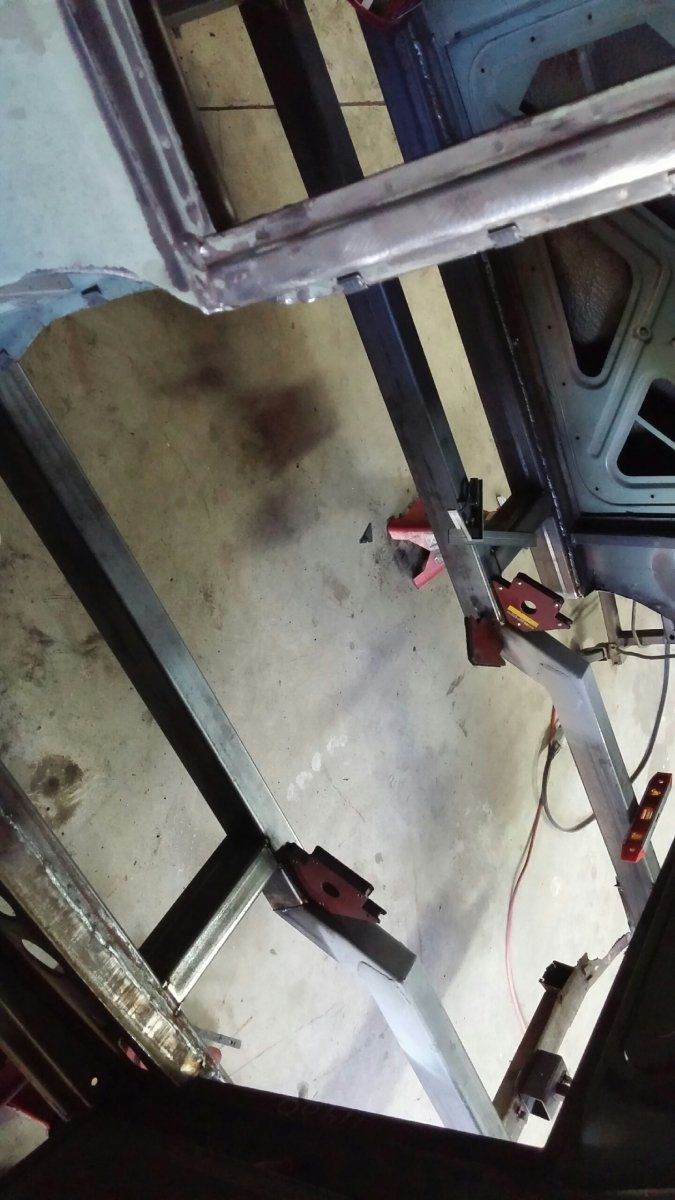

    try again to load some photos. Inner rocker bars and rear crossmember. Rockers will be fully welded and the floor pans will go on top. It will have a removable trans tunnel. Mig welding everything on this car . To be really period correct I should stick weld it. Maybe some gas welded headers, but finding metal coat hangers anymore is tough. Built my first set of headers while working at Midas muffler in 1967 for a small block powered 49 Ford. Go to Midas today and tell them you want a set of headers built. Yeah right. I think they charged $ 200.00 and that included a full exhaust system.

    I am in Crystal River. Nothing new to post. Had to take time to paint a vehicle and I am waiting for my steel order to come in so I can finish the frame and start on the cage. Unless you want to see pictures of
    the pile of junk getting bigger from the trunk of the car being cut out.

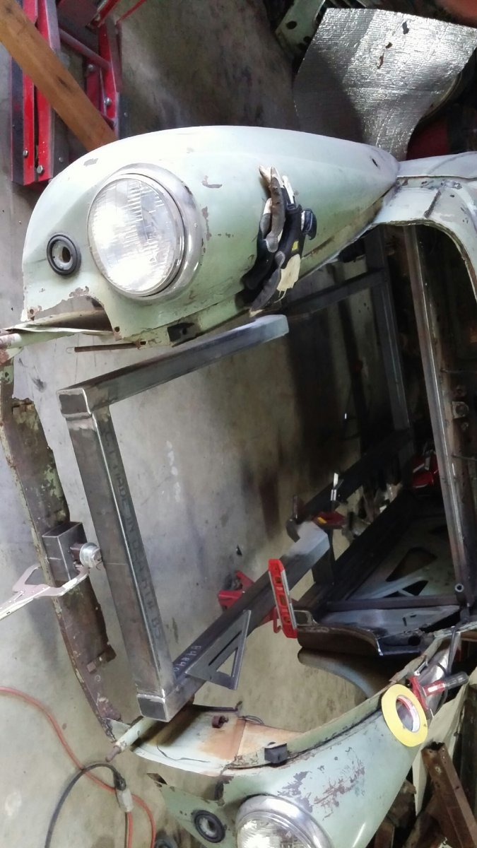

    My steel order came in today and between wet sanding sessions on a customers truck ,I took a little time to cut and fit my front frame rails and get them tacked in place. Got to go to the welding supply store and get some gas for my welder so I can weld them in.
