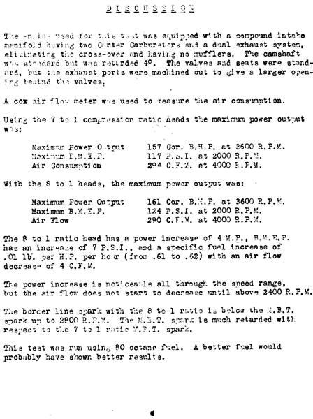

    Rusty, I think you are over-optomistic about getting 200 HP from the above mods, especially with a streetable cam.
    The military raised the compression 1 point, added dual exhaust, and 2x2 carbs. On a 135 HP engine, they got about 25 HP- and that was with the Caddy engine, that had 7:1 CR. The 322 Lasalle had 6.25:1
    That would raise the HP from 125 to 150HP. A good cam, and better fuel may give you 175 HP, but I doubt much more without some port work.
    As for balancing the engine, they are pretty well balanced now-they were factory balanced. The flywheel is a harmonic balancing flywheel- if you lighten it much, you're going to have to balance the internals with it.
    These things are fun to drive, because the long stroke makes awesome torque! 3.375" bore, by 4.5" stroke.
    JMHO.
