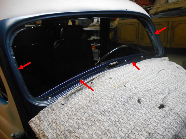

    I'm about to install the tilt-out windshield on my 1935 Dodge. I installed new weatherstripping. However, is there supposed to be weatherstripping or some other rubber seal around the window frame body opening (arrows)? DSCN1609.JPG

    Upholstery has small diameter cloth covered twine weather strip
  3. I believe there are supposed to be two rubber seals for that windshield. One on the frame and one on the car body.
    Barn Find likes this.
  4. Paul
    Joined: Aug 29, 2002
    Posts: 15,462
    Paul
    Editor
    Glass is set in frame with tape,
    Frame has flange style rubber seal.
    The "twine" was actually twisted paper
    wrapped with the same napped material used in headliner.
    Wraps all the way around opening.

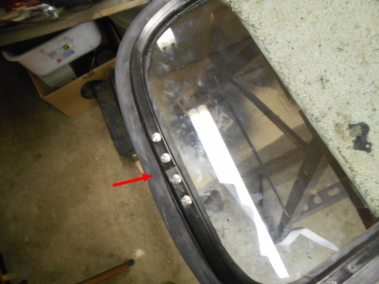

    Thats the way it looks to me. I installed new weatherstripping around the frame itself (image). Do you know what the rubber seal would look like? Would it be a simple flat seal? DSCN1610.JPG

    There is no rubber seal in opening

    Thanks Paul - I set the glass in the frame with new rubber tape. I installed a new weatherstrip around the frame. The thing is the window opening in the body itself looks like there should be some sort of seal there. But then again, maybe not. I will keep the information about the twine in mind when I get around to installing the interior. Thanks again.

    The upholstered trim is a miniature version of the welting around the doors.
    The unbeaded cloth "flange" of the welt is sandwiched between body and dash along lower edge and under metal trim on sides and top.
    I've had two '35 Dodges and one '36 Plymouth and they were all like this..
    Although it's been a couple decades since..
    so memory is a bit fuzzy..
