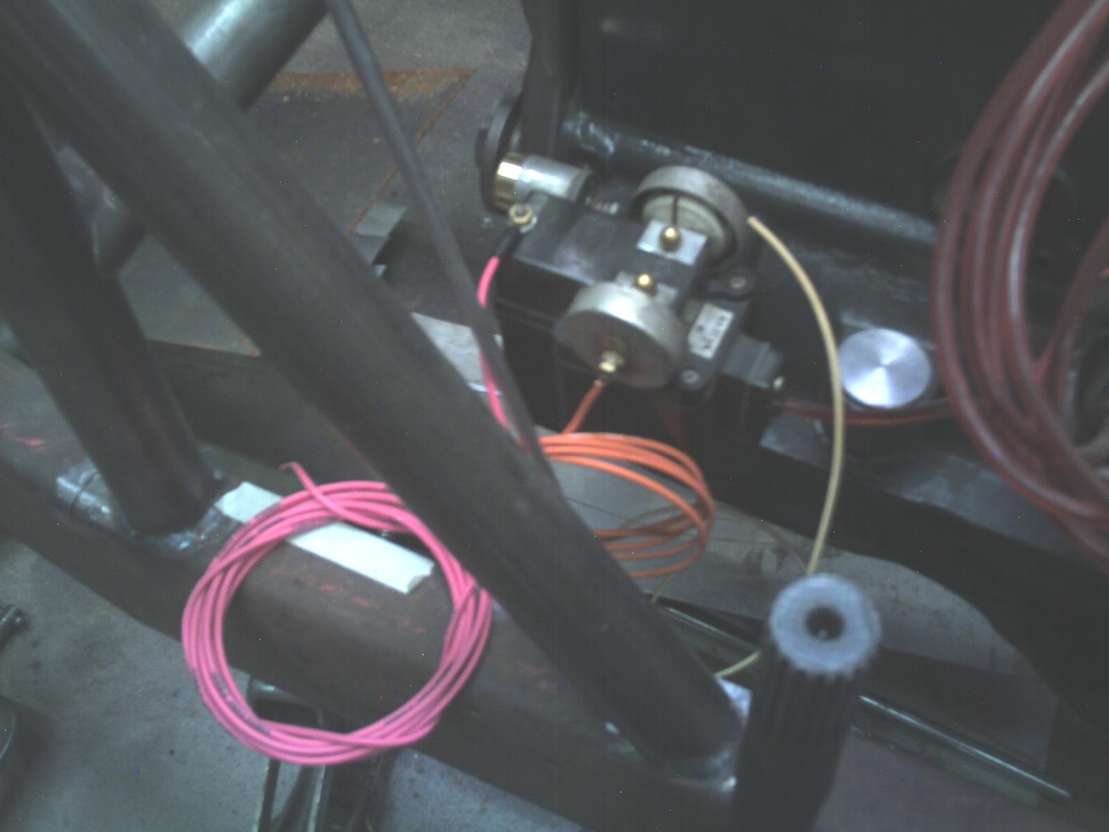

    and, all day today I worked on the battery box! fabbed, mounted, cable routing established. The box is functionally done, the cables are 1/2 done, can't finish them until I take the "jig" down, as it interferes with the cutoff switch.

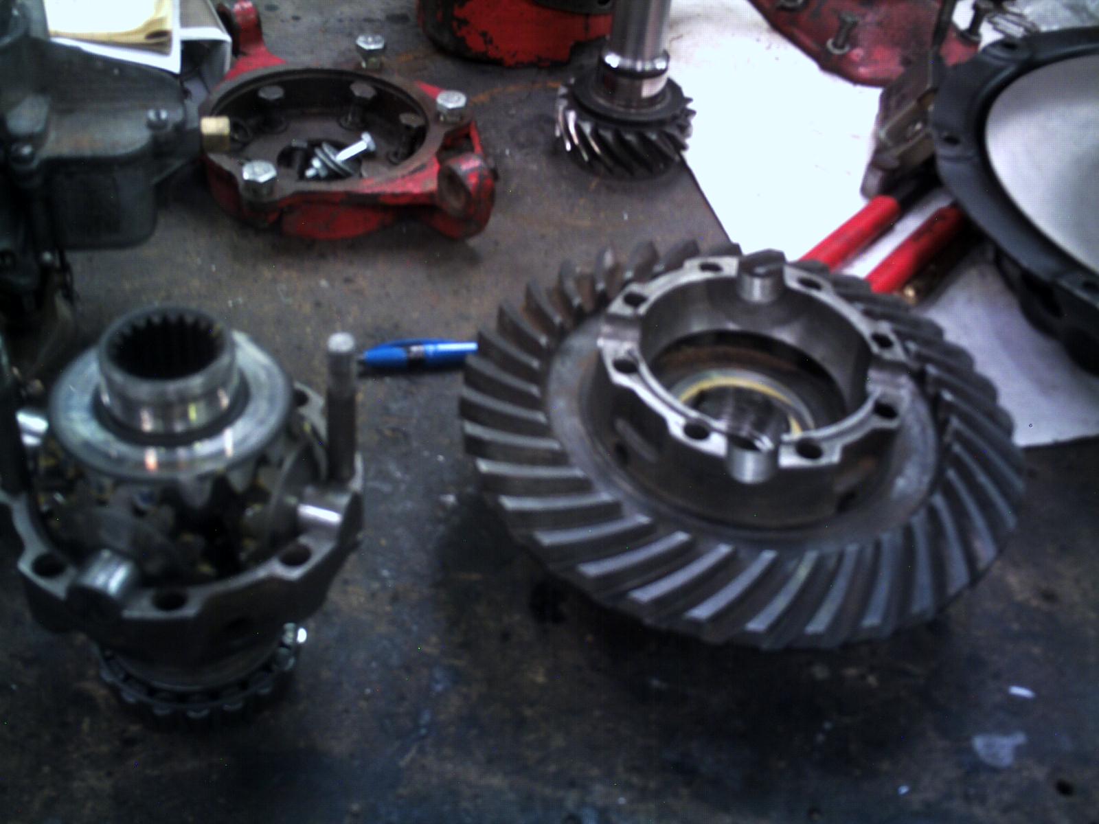

    I'm putting '54 Ford station wagon axles in a '37-'40 Ford "banjo" rear, like this:
    http://www.jalopyjournal.com/forum/showthread.php?t=151&highlight=modern+axles
    but cutting the spiders instead of the carrier and ring, like this:
    homepage.mac.com/s_kraemer
    A friend who used to do these conversions back in the day for the hillclimbers is helping. I got my spiders back from him last week, tried to put the carrier together today. NO JOY!! the spiders and side gears don't mesh properly. So, the rear is on hold until I get the gears sorted.

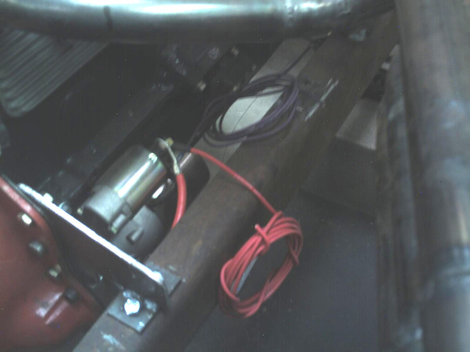

    got all the wiring sorted, and hooked at one end. When more is done on the rest, the wiring can be strung and finished. All the wire is color coded and labeled leftovers from street rod wiring kits. Someday I'll replace it all with cloth-braided, but this stuff is free.

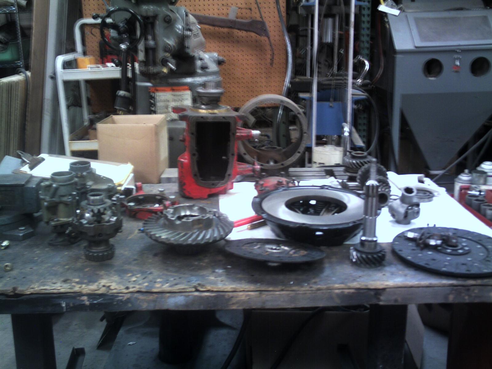

  10. despite my lack of attention to the car, it has marched on, seemingly without me. The week or two before the drags a whole bench full of "work to do" showed up- the carbs came home from Tennessee, the input shaft for the Lasalle came home from Denver, and the clutch parts all came home from the local clutch builder. Dif parts also made it before that week was out. Alas, the output shaft for the Lasalle didn't make it in time for the drags, it showed up yesterday.
    I put the carbs on, discovered my linkage wasn't right, so I've been working on a replacement.
    I put the front of the trans together to start setting up the clutch. The pressure plate isn't going to work, so I have to go "back to the drawing board" on that one. Not much room inside a Chevy bellhousing when using the flathead six crank and flywheel!
