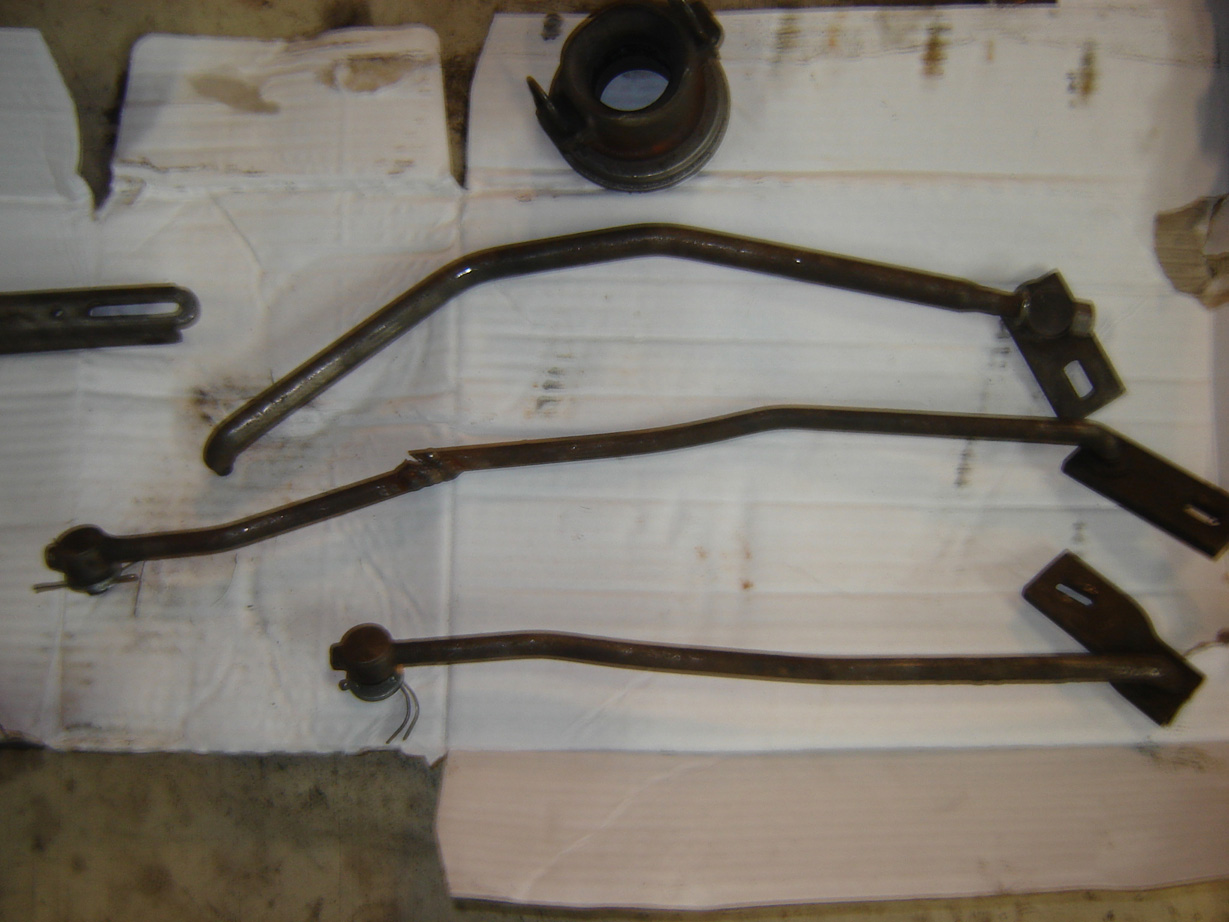

    One of the arms for the shifter linkage is bent and have had some "bad" repairs done on it. Can it be repaired better and work or is it very important that these arms are 100% correct for the transmission to work correct?

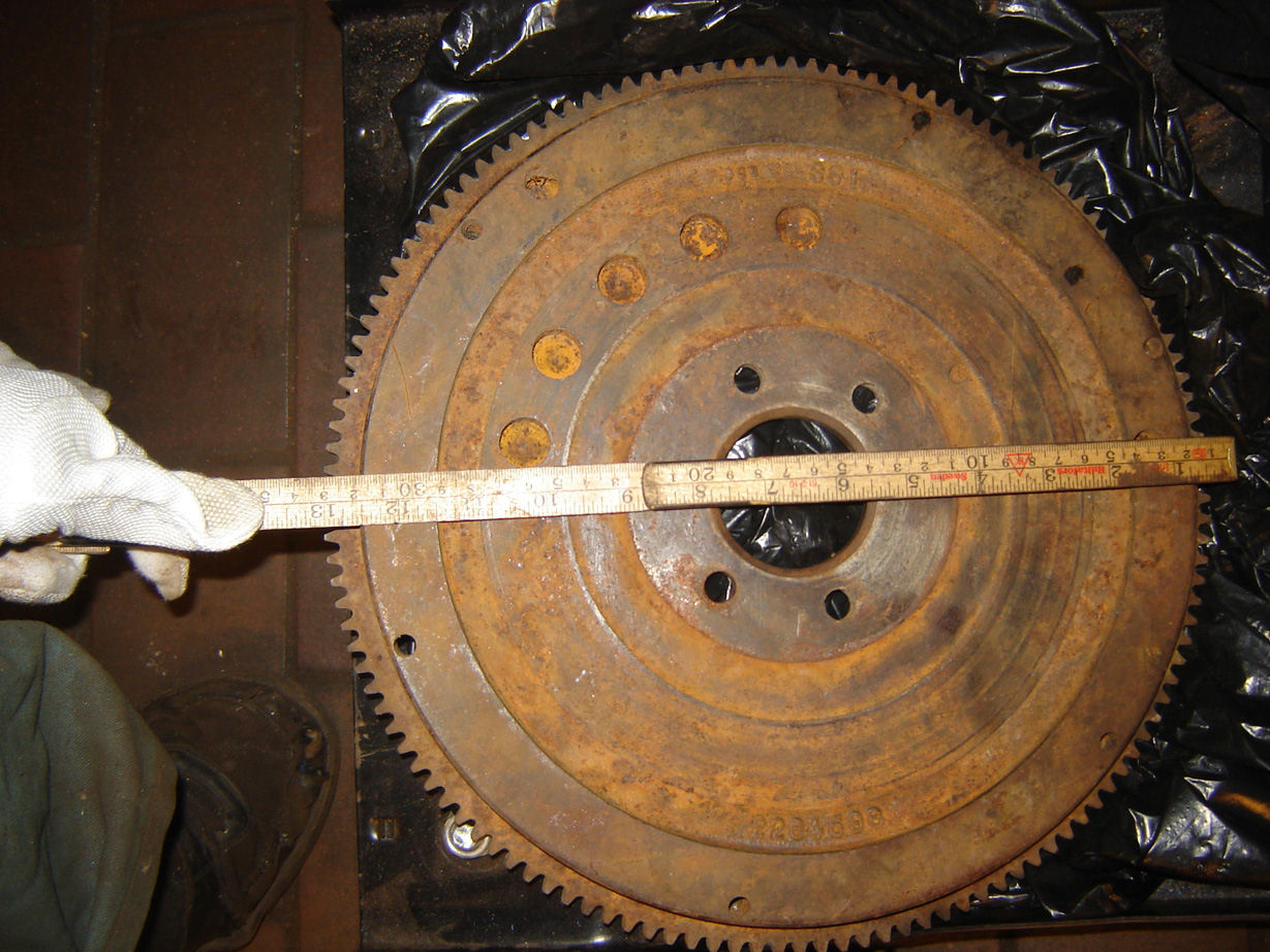

    We got a flywheel with the transmission, but I am not sure what kind of engine it is balanced for. Is there any way of finding this out without any special equipment? The casting number says its to a 340, but it has six small drilled wholes in the same place as you would drill three big holes in a flywheel to a 318 to make it balanced for a 360. (I don't think this is original for a 340 flywheel?)
    If it's balanced for anything other than a 360, how do I re-balance it? Do I have to drill or can I fit weights to it? Something like this for example: http://www.kmjent.com/cart/product.php?productid=2077&cat=7109852

    Bent arm??? You mean one of the shift rods? Competition Plus shifters have bent rods....But if concerned....mount shifter and install a pin in it's side so it's locked into neutral, then install the trans levers and click trans into neutral...modify or adjust rods to easily install into shifter and trans levers...
    I'd be looking for a 360 flywheel or an aftermarket one that I was sure was balanced for a 360...

    The 360 is externally balanced, so it needs a specific flywheel. The 340 is internally balanced, so the flywheel you have wont work on the 360.
  4. The 360 flywheels have a VERY obvious offset weight cast into them. You cannot (without spending a LOT of money) use a 318/340 flywheel on a 360. X2 on finding an aftermarket flywheel.

  6. A flywheel for a 360 is external ballanced, and will have three half inch holes to make up for the almost 20 oz inballance. A cast crank 340 is only a 4 oz. out of ballance, so they wount directly interchange. I thought the mopar chassis book had a diagram how to drill this out, but I cant find it. Your best bet may be to just brake down and buy a new flywheel.

    Well. No.. I mean bent off and welded back together by someone who can't weld... =) I know they are bent by default, and the question is if we can repair this broken rod so it can fit proper. I will take your advice and try it out.

    Yea I know about the three holes to be drilled. And as I said mine has six holes, but smaller ones. I tought that maybe this removed the same weight as the three bigger ones, so that maybe mine was balanced for 360 in a different manner... far reach, I know, but worth finding out I thought...

    The 70-71 are internal, the 72-73 are external
    The 360 flywheel must look like this:
    Does the transmission fit properly to the bellhousing?
    If there is a mis-match then consider that some 70's and 80's 360 use a 143 tooth flywheel which is larger OD than the 130 tooth flywheel. The flywheel must match the bellhousing or else the starter will not engage.

    Is the bell & flywheel you have even from a V8 car? Many 64 & 65 A body's were slant 6 engines, that bell won't fit a V8 at all. If you have a V8 assembly, it may be cheaper to reballance your existing flywheel then to have one shipped in.

    Yea rebalancing seems cheaper, but need to find someone who can do it. And since our flywheel already have 6 small drilled holes I woun't be as easy as just drilling three big holes... Better just try and looking for a used or aftermarked 360 flywheel...

    Okey now I got some pictures and numbers. It seems like most of the parts is good right? The clutch is 10 1/2 inches and the bell housing is the appropriate size for this. The drive shaft has trunnion on one side and u-joint on the other, so it will fit both the transmission and the 8 3/4 axle. One of the linkages is broke as you can see, but doesn't seem to bad. Seems like it would work just to redo the welding job a bit better...
    Transmission has part number C 95639 which tells me it is the one from 64-65, and it will then fit with the hurst shifter from the barracuda 1967.
    The flywheel on the other hand. Does anyone recognize it? The part number is 2264598, and as far as I can find out that makes it a 318 flywheel. But I haven't seen those five drilled holes in the same place as there should be three drilled wholes if it were balanced for a 360. Is it balanced for an externally balanced 340?

    I think I would just go for the 360 balance on your flywheel. They should be able to tell if your current flywheel is neutral balanced, and I would think they should be able to adjust to the correct 360 balance. I've seen a lot of flywheels that had holes drilled or fly cuts on them from the factory to get to the neutral balance. Gene
