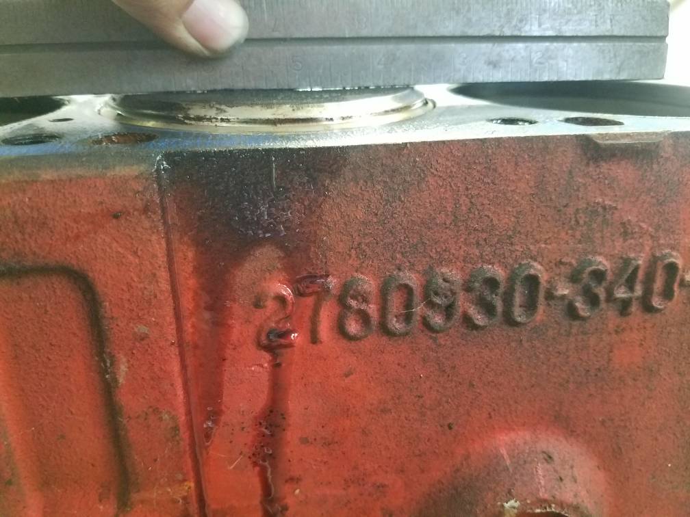

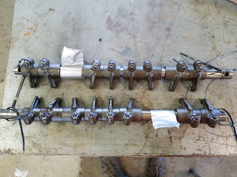

    It has adjustable rockers that are specific to the heads. The block is just a normal 1970 340 block. I don't have it together right now but I did get the heads back from shop today. They have the block for cleaning and magnafluxing . They are also checking crank and I will assemble. If there are any tips or tricks for assembly I would be willing to listen.

    squirrel
    are the pushrod holes offset?

  9. squirrel
    Joined: Sep 23, 2004
    Posts: 56,085
    squirrel
    looks like they do have the offset pushrod holes. Neat...never seen any in real life.

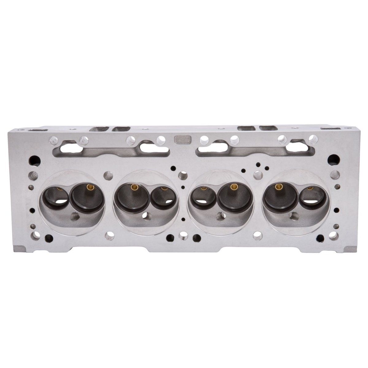

  12. Deuces
    Joined: Nov 3, 2009
    Posts: 23,920
    Deuces
    Edelbrock 340 cylinder head....
    OLSKOOL57 likes this.

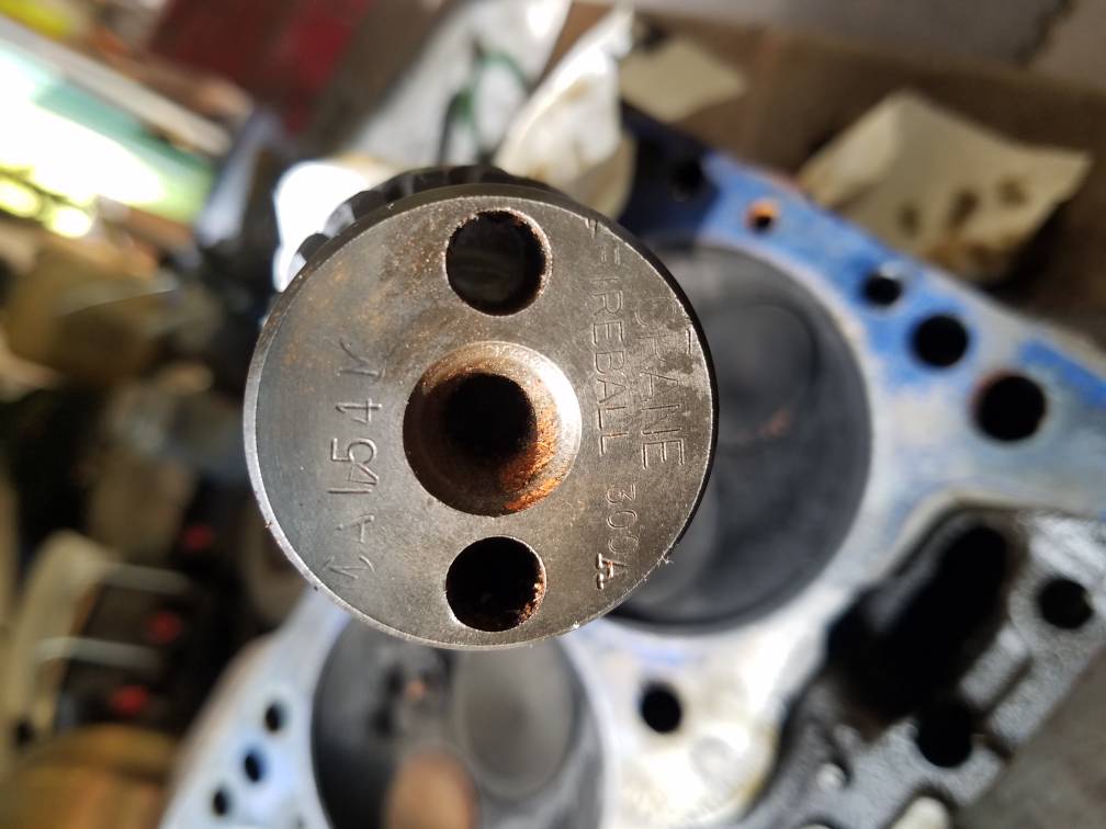

    If anyone can tell me about the cam that would be great, cant find much info on line about it.

  14. 26Troadster
    Joined: Nov 20, 2010
    Posts: 788
    26Troadster
    all i could find. i built a 360 for a buddy years ago and looked at this cam, but ended up going with the old direct connection 280º purple shaft.
    Crane Fireball #300A
    Should be .447" / .447" Lift with an advertised Duration of 300*
    Duration @ .050" = 222* to 232*

  15. squirrel
    Posts: 56,085
    squirrel
    If you have some idea what year the engine was built (perhaps the date code on a bearing insert) you could start a thread asking if anyone has a Crane catalog from that era, and give the numbers on the cam, and maybe someone will look it up and tell you the specs?

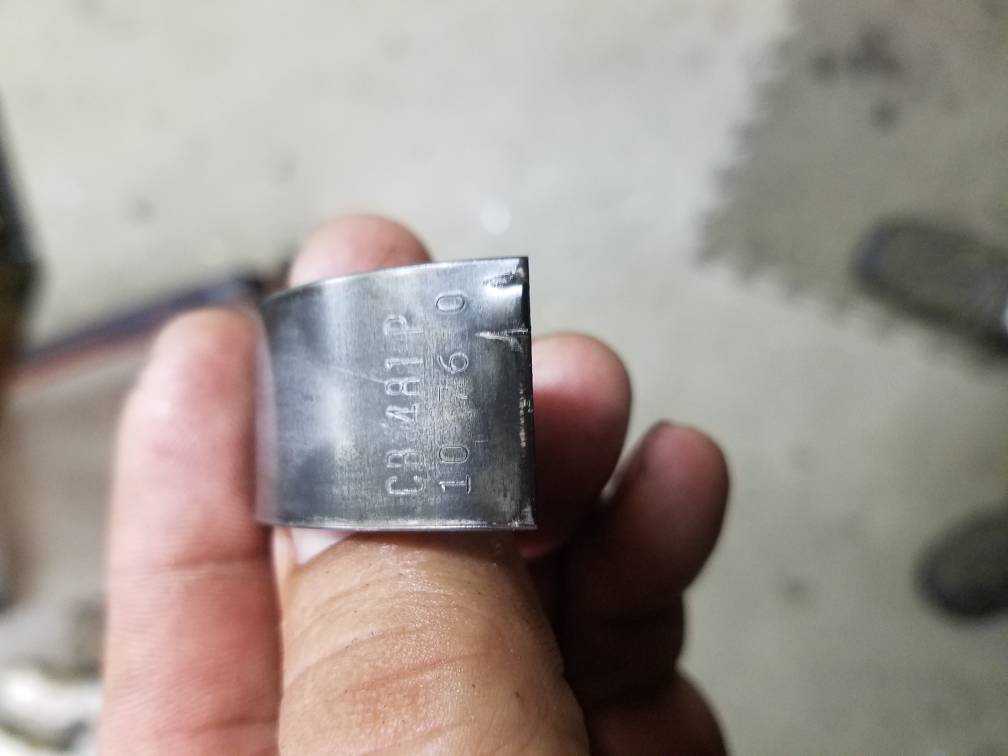

    Here is a rod bearing i pulled out. They way this motor is built it is close to a 400 hp street motor im guessing. 20190728_200504.jpeg
    Sent from my SM-G930V using The H.A.M.B. mobile app

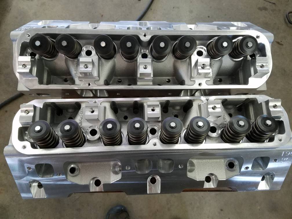

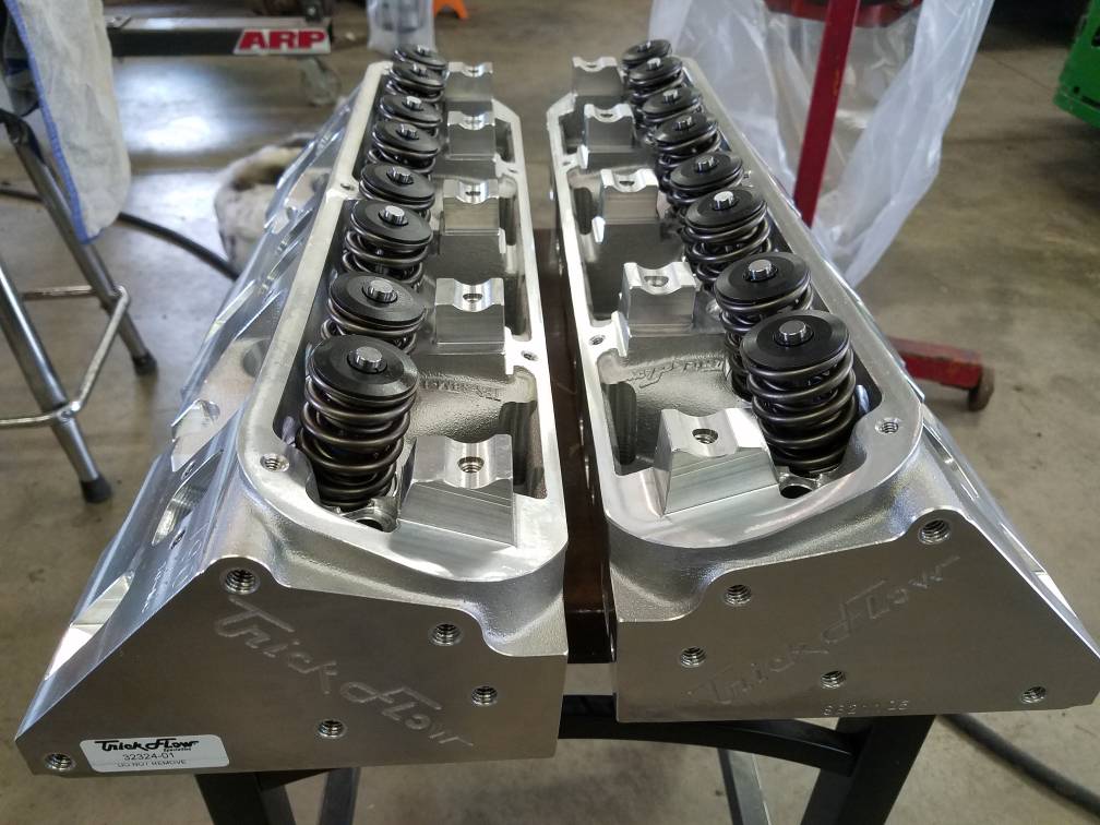

    I looked at them and the would work, but looking for a assembled set. I started looking at the trick flow 190, and they only have a 60cc chamber. It had a .040 head gasket, and I believe I could get a .060 gasket and make up the difference. I will have to puddy the cylinder. One down side I have is if I put head studs in and have to pull the head I would have to pull the stud to get it off. Are the ARP bolts just as good as the studs or do I have to go with the studs.
    Tony
  19. mcmopar
    Joined: Nov 12, 2012
    Posts: 1,734
    mcmopar
    from Strum, wi

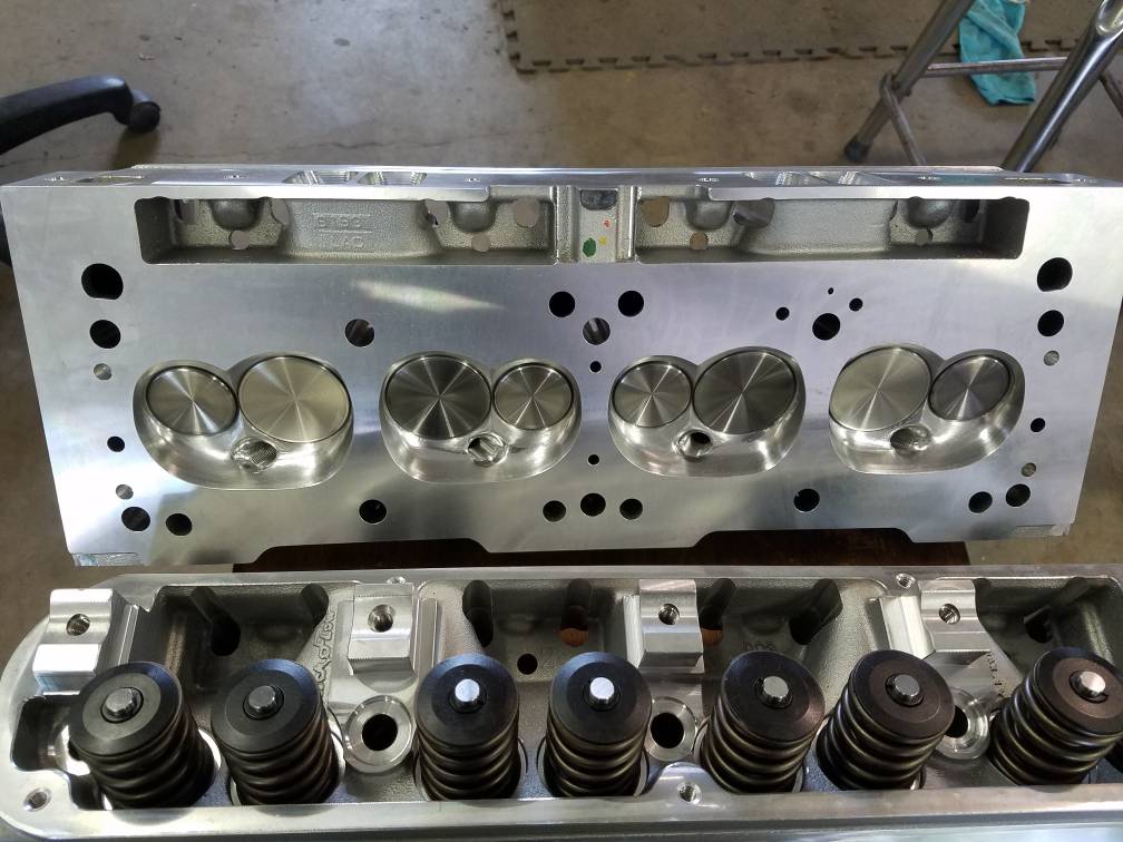

    Got a present and more is showing up during the week. Trying to get it together for drag week. 20190818_130123.jpeg 20190818_130108.jpeg 20190818_130134.jpeg 20190818_130156.jpeg 20190818_130207.jpeg
