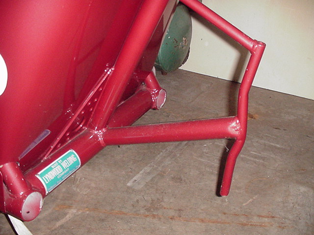

  21. The37Kid
    Joined: Apr 30, 2004
    Posts: 30,729
    The37Kid
    If you look at the push bar on my Lyndwood it sort of looks likan "S", Scooter.
