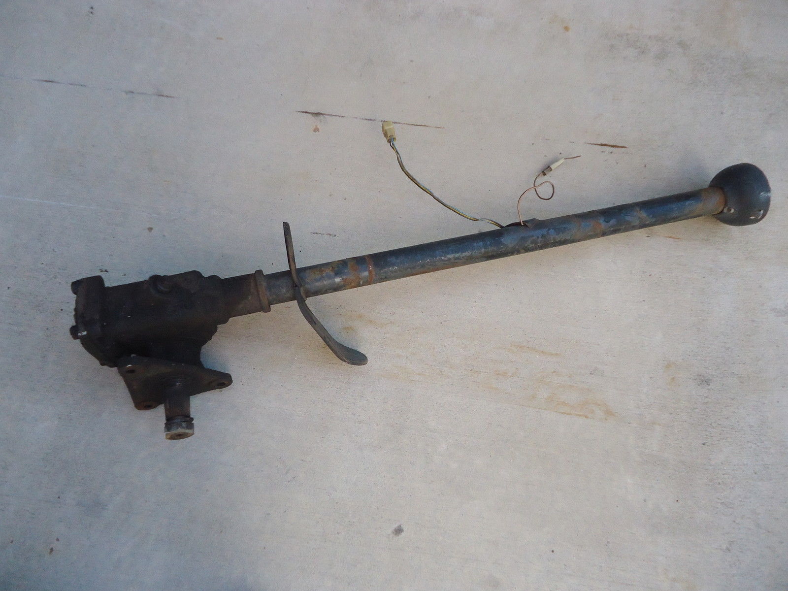

    Anybody have any input on the later 50's truck boxes? Like a 58 Viking steering box perhaps?

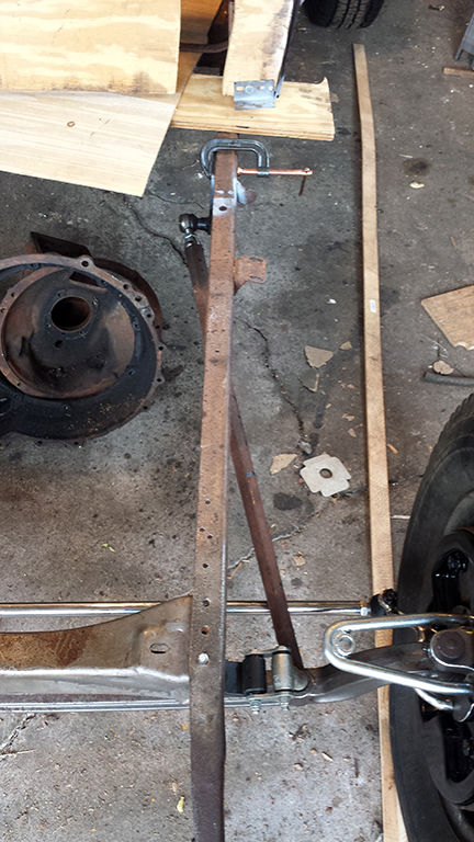

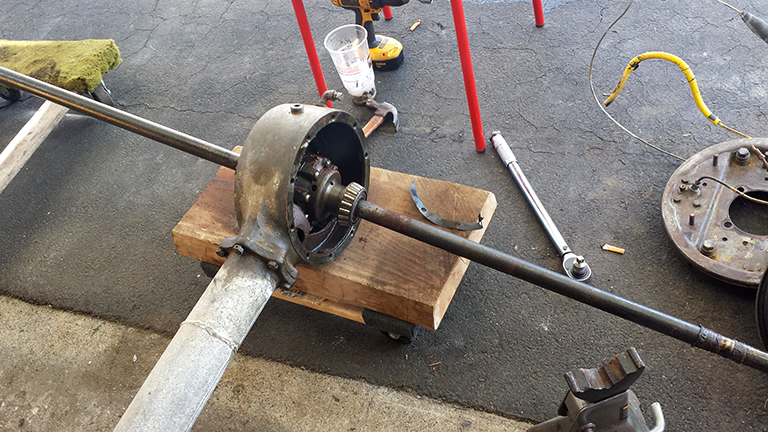

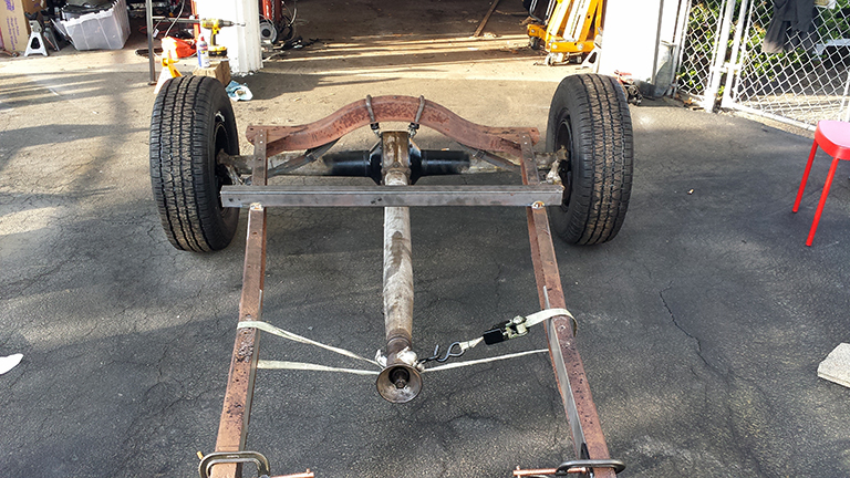

    Took Monday off so I can have 2 3-day weekends in a row on the project. Got a lot done but ran out of daylight and steam yesterday so next weekend will be mocking up the engine mounts and cutting the frame. I got just about everything else handled.
    I got the boxing plates in and found they will need to be shortened, which I didn't do this weekend. I called 504 (the guys that make them) and they were very helpful with answering my questions about how they are intended to fit and confirmed that they are indeed left a little long on purpose.
    Here's the photodump from this weekends' labor:
    20150516_163007.jpg 20150516_164625.jpg 20150517_154929.jpg 20150517_181551.jpg 20150517_181556.jpg 20150517_185736.jpg 20150518_103954.jpg 20150518_104350.jpg 20150518_104358.jpg 20150518_112355.jpg 20150518_164435.jpg 20150518_175940.jpg 20150518_175948.jpg 20150518_182543.jpg

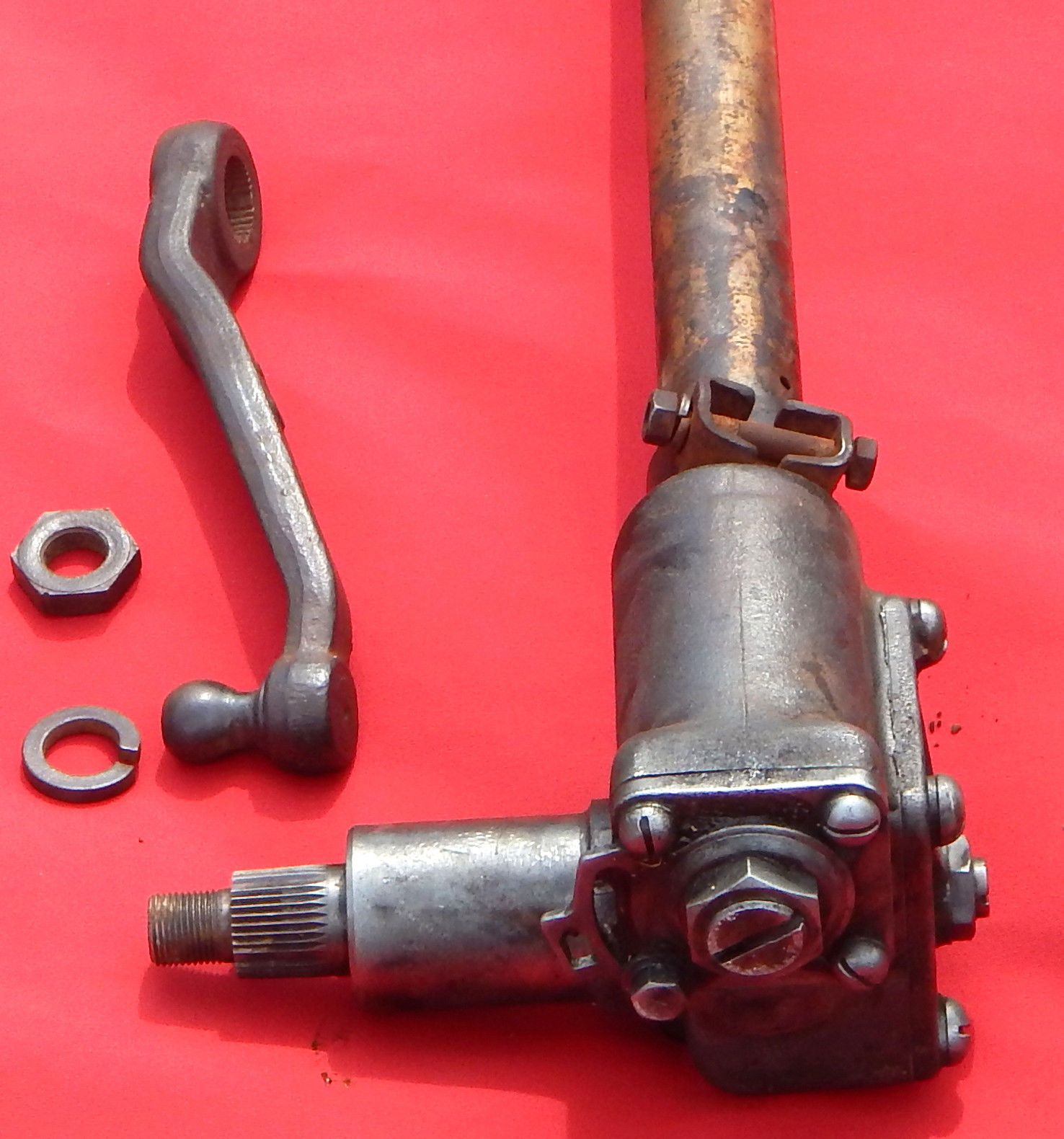

    BUT, I went ahead and bought a Saginaw box off ePay for less than a hundred bucks to my door. It's a 38-46 Chevy/GMC truck box (or was at least described as such). More importantly, it appears to be the one that's essentially an improved knockoff of the Gemmer F1 box (or actually, perhaps the superior original?) from what I understand. I'm fairly certain they are close to the same size at least.
    Looks like I'll be saving my cross steer boxes for something else!

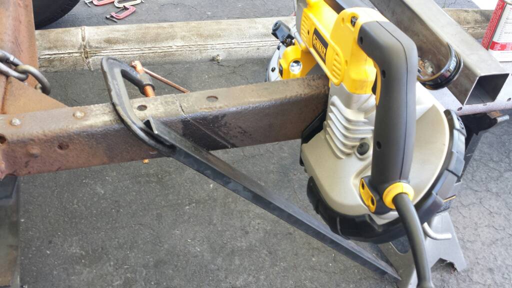

    First cut! Placed it 7.5" ahead of the rear crossmember for a variety of reasons. First off I needed the portaband to clear the crossmember. This also gives me more meat to work with as far as contact with the frame.
