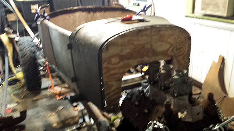

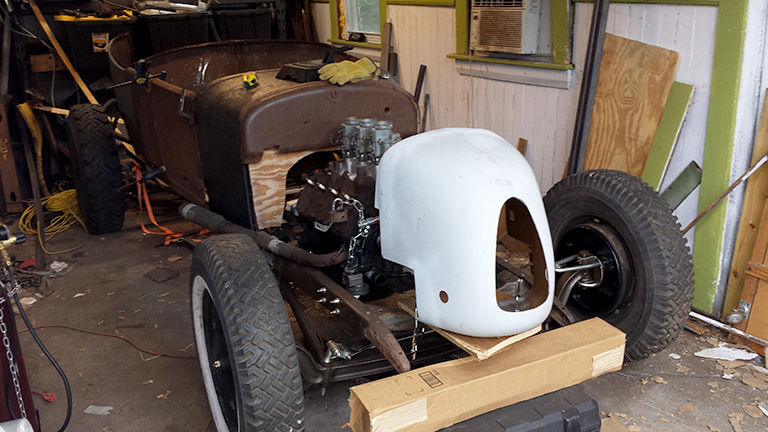

    Long weekend with too many projects and distractions. All I got done was cutting on the rear quarters and some layout work. I'm going back and forth on how to locate and attach the runners that the panels will sit on. I'm trying to get the angle right and when I did some math on the original I can up with a strange number (like 6.54° fstrange).
    Also debating using .125 tubing instead of the .065 to be easier to weld and make the subframe into a bit more of a cage. The weight though...
    Anyway, Here's the body as it sits, clamped together loosely and sitting on the mocked up subframe. You can see the rear panel is going to take a little doing around the rear crossmember. I can go quick and dirty with just a couple brake bends or I can get creative and contour around it. IDK yet. If I run that little red tank or something like it I may want to recess it in too.

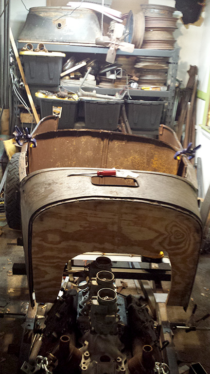

    Also, the channel as it sits is only 1" as I'm accounting for half inch wood/spacers/bushings.
    You really can't see it in the pic because the sun glare is so bad. I gotta start taking pictures in the morning or evening.

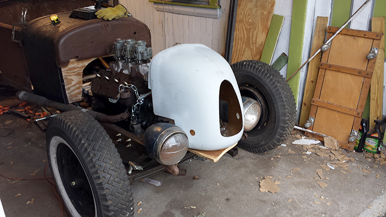

    Ok, you can kinda see the cowl better in this glamour shot of my new welder:

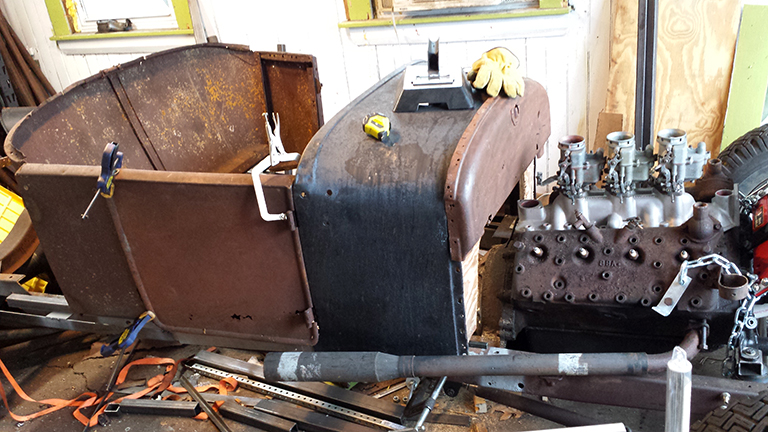

    I finally got back to work in the shop Saturday. I got the subframe shored up with a piece of tube and angle iron.
    After doing this the body panels sat much better with very light clamping, so I must be on the right track.

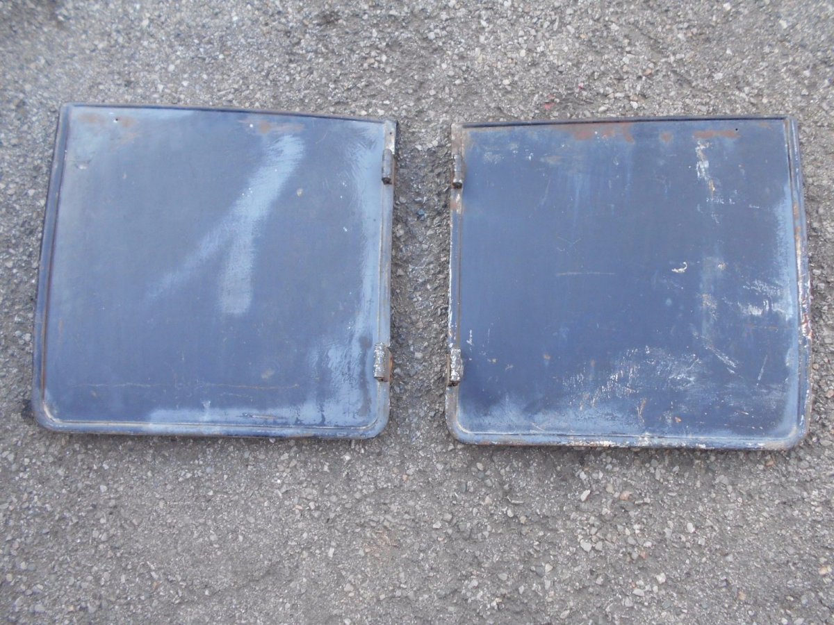

    OK, so, we left off with me stepping up and throwing some money at a set of nice doors. Last night I finally got them on the body and overall, I'm very happy. I can actually line the body up now.
    Doors themselves have a couple minor issues I can deal with, but other than that, they're nice and have old paint on them, so, they're mint compared to my other stuff. I haven't taken any of it out yet to check for dates, but they are packed with newspaper for some reason. I guess these may be late 27 doors (?) because there are actually holes and reliefs to access the door hinge nuts as well as a bead along the inside top panels.

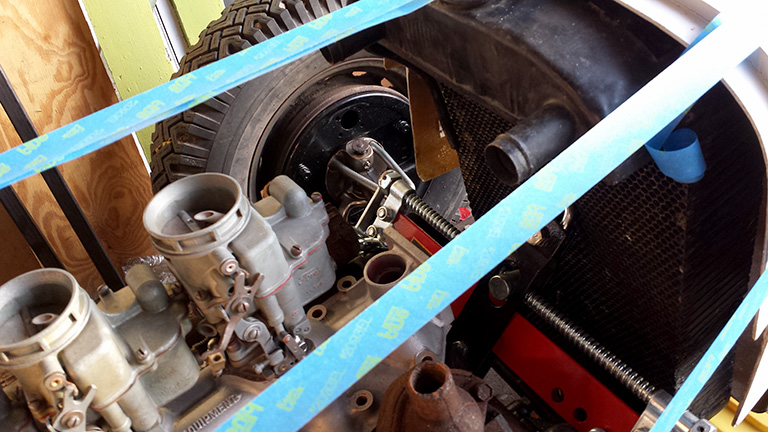

    This is with the radiator ON the crossmember:
