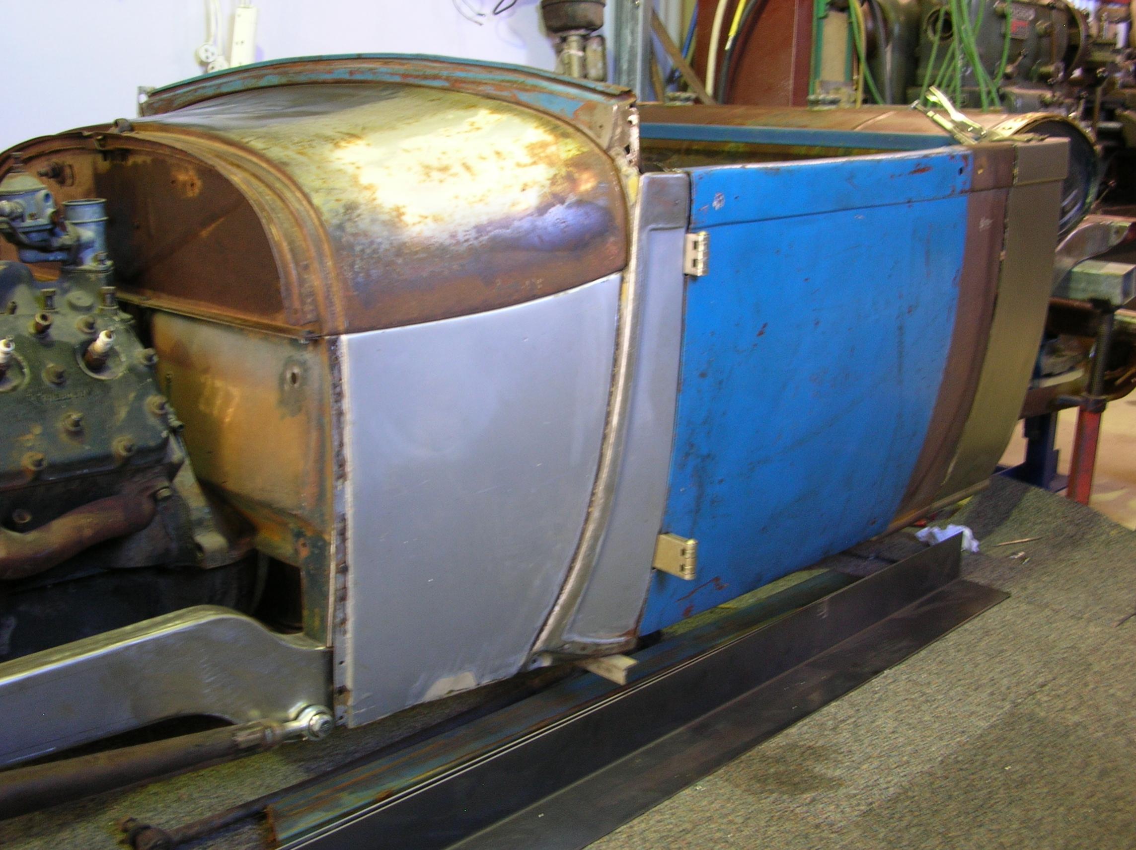

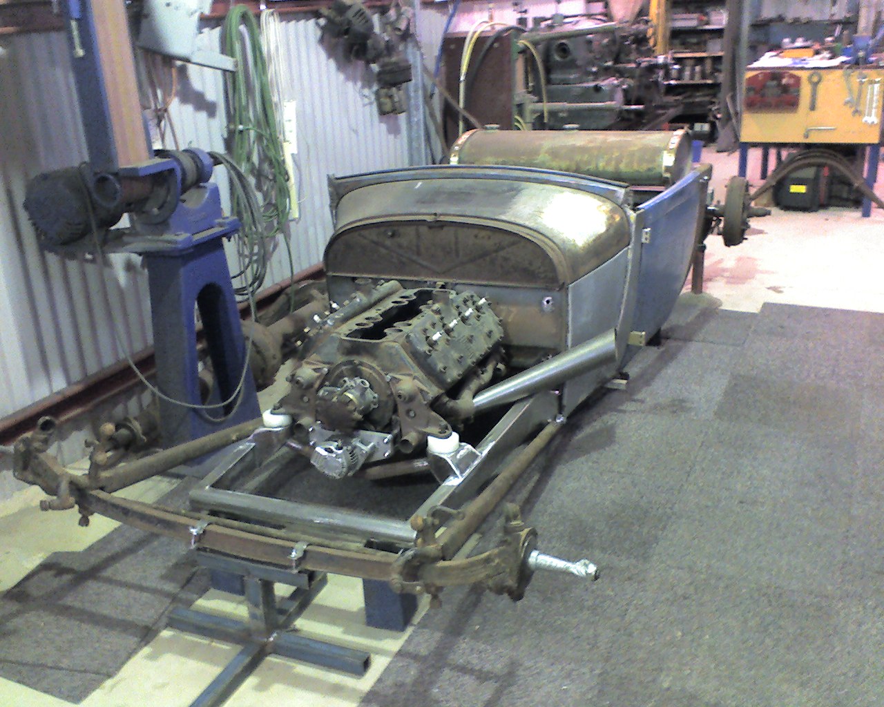

    the start

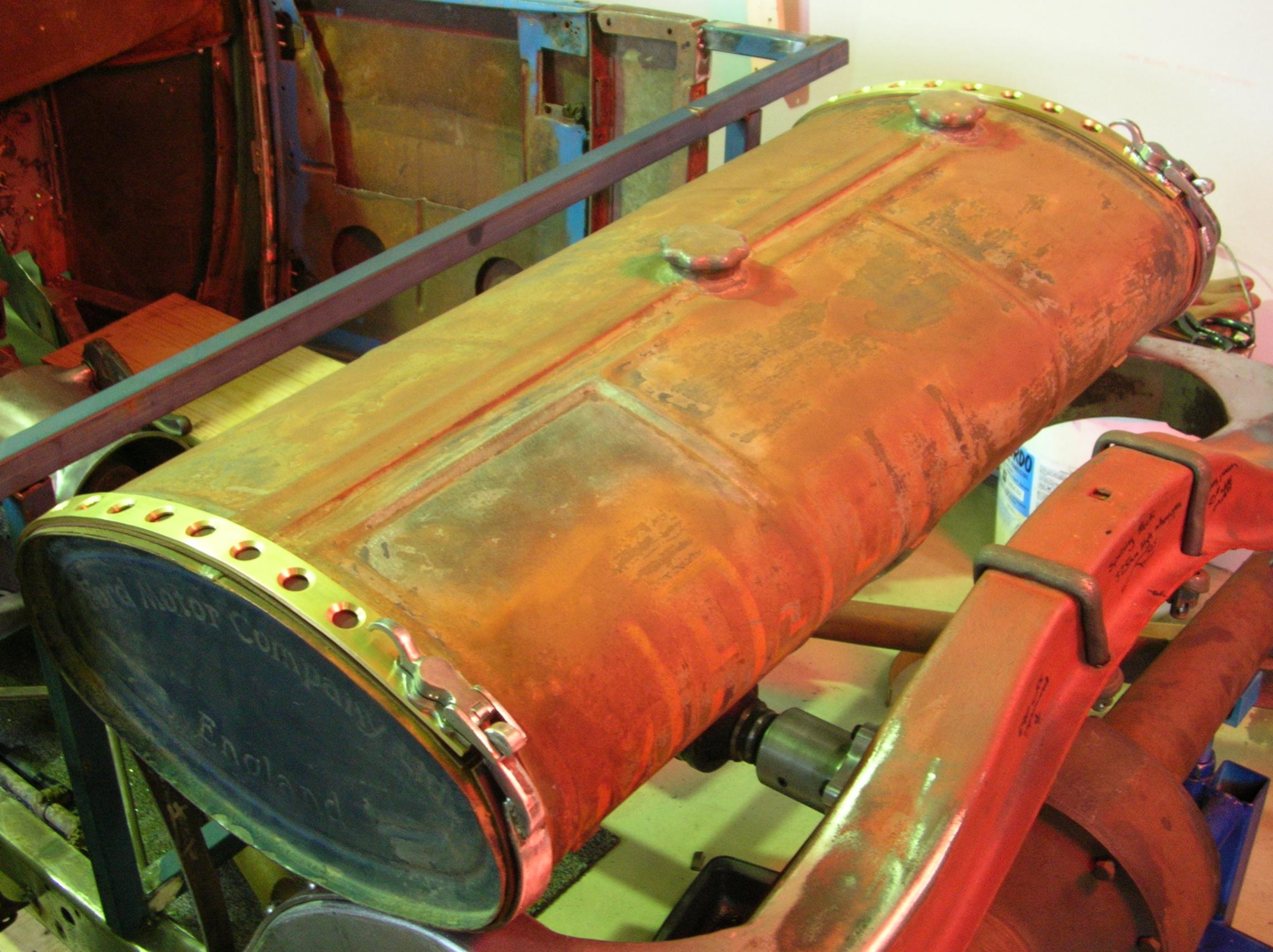

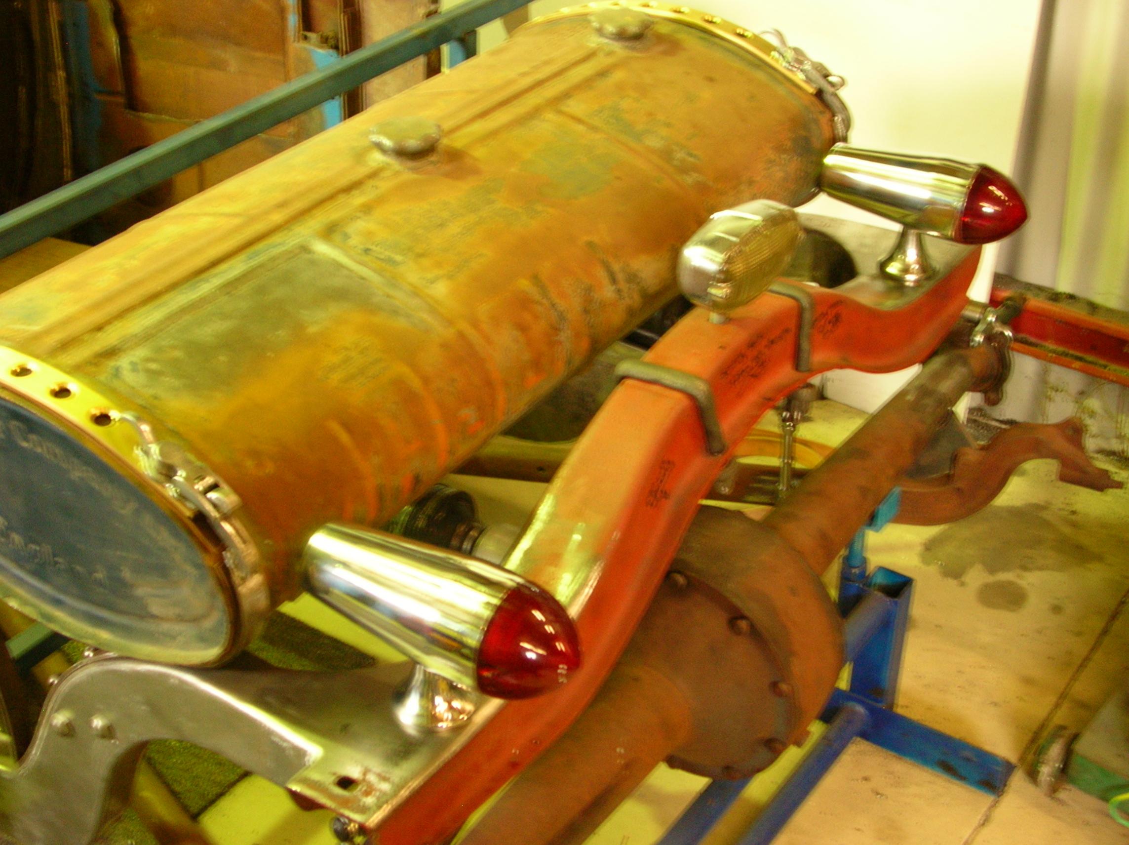

    from australia

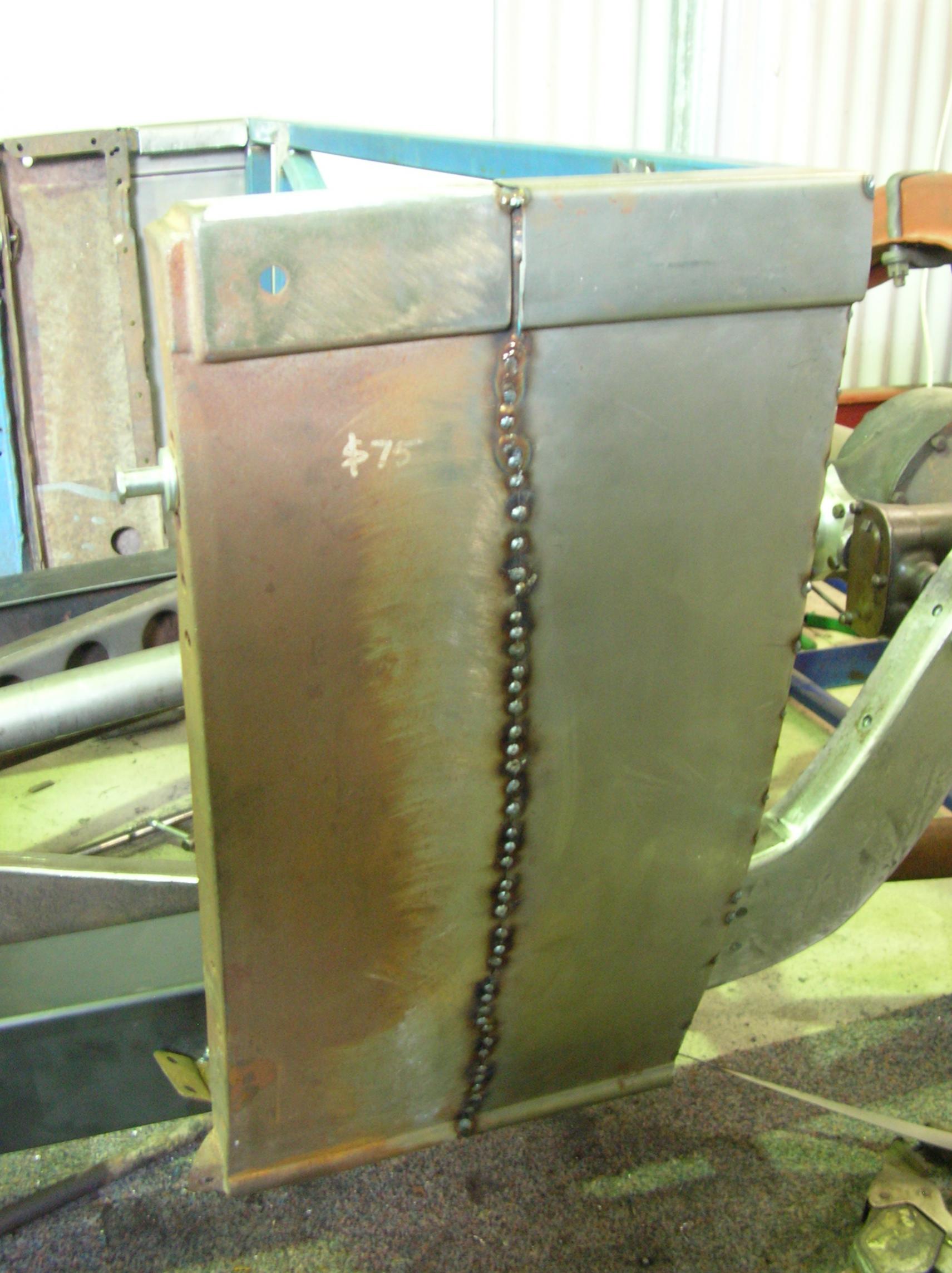

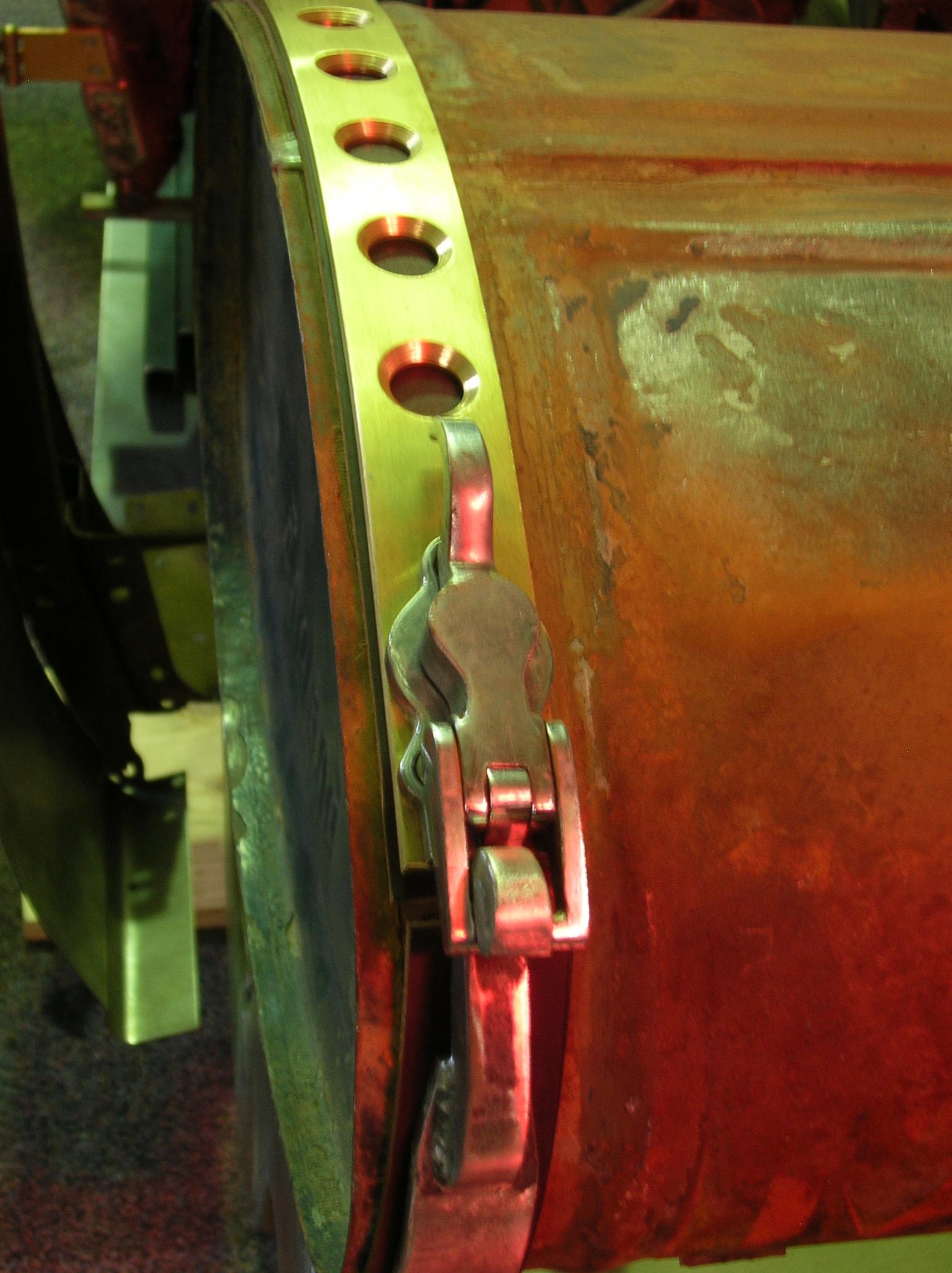

    setting tank up was one of the first parts i had

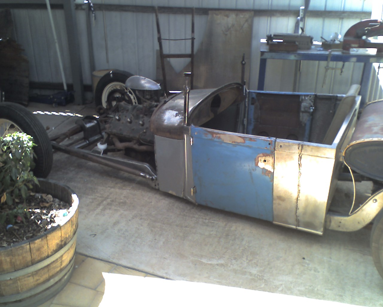

    from australia

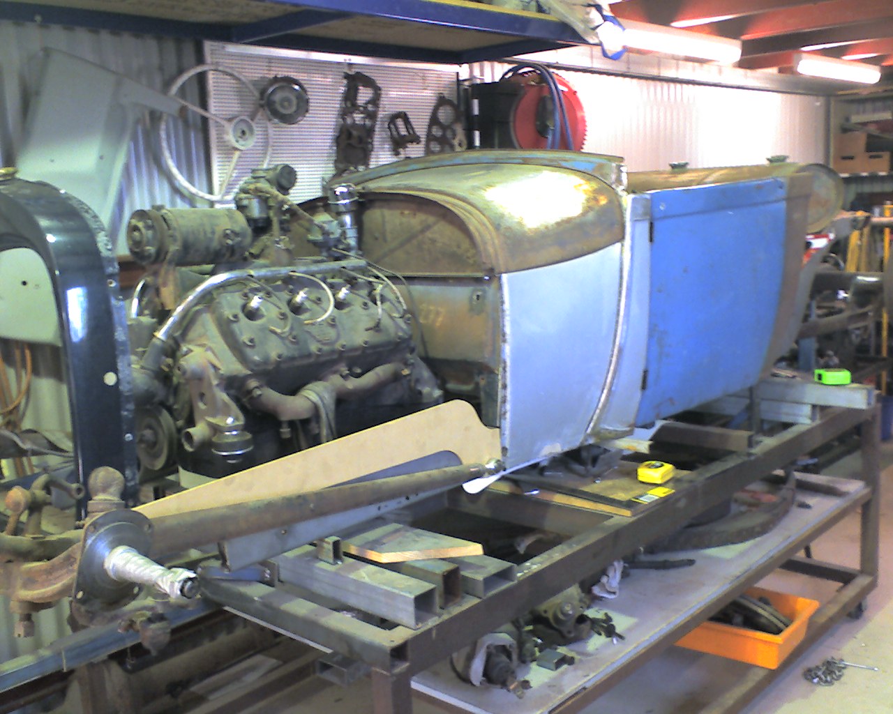

    a quick mock up on the table and start

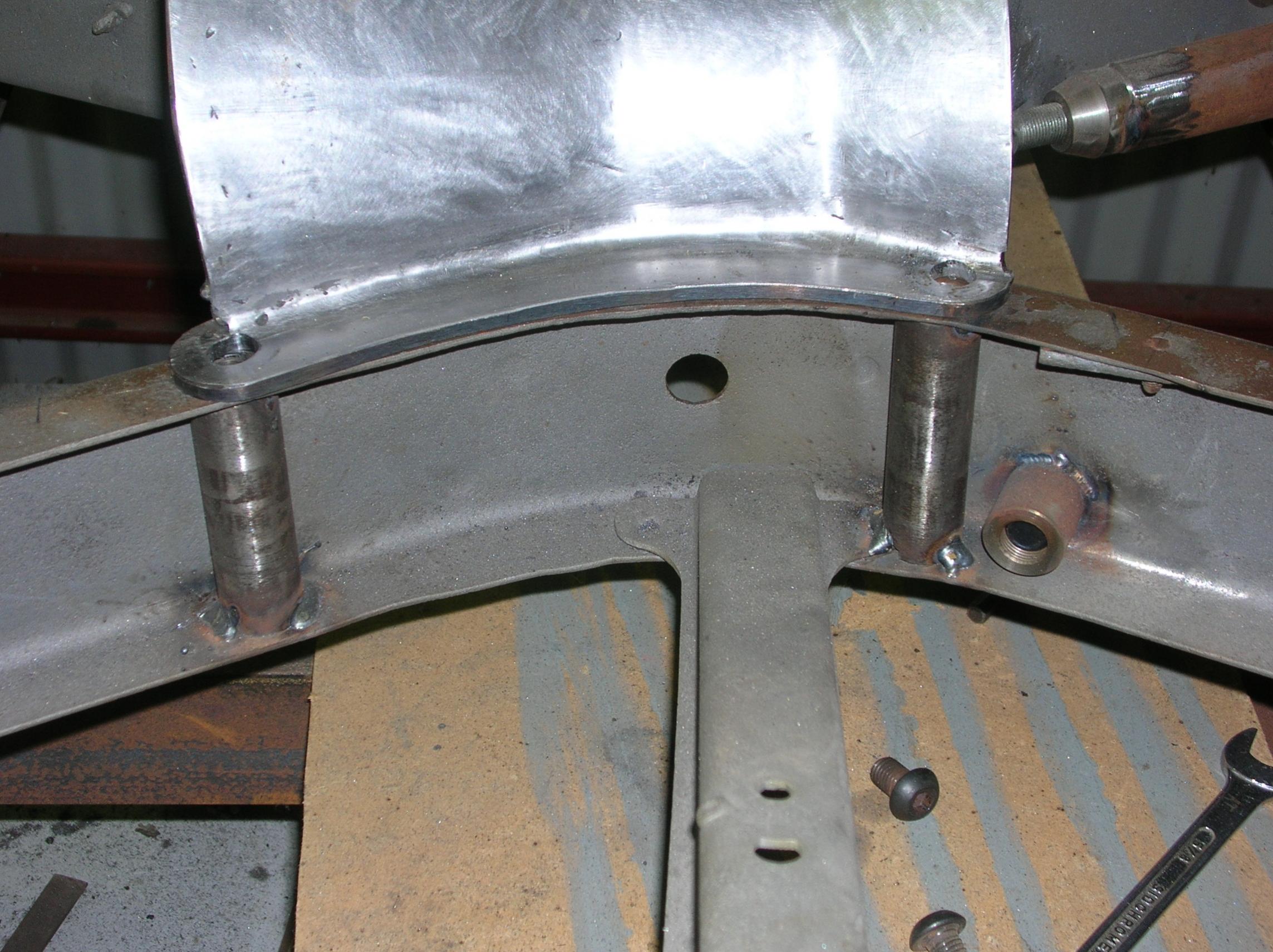

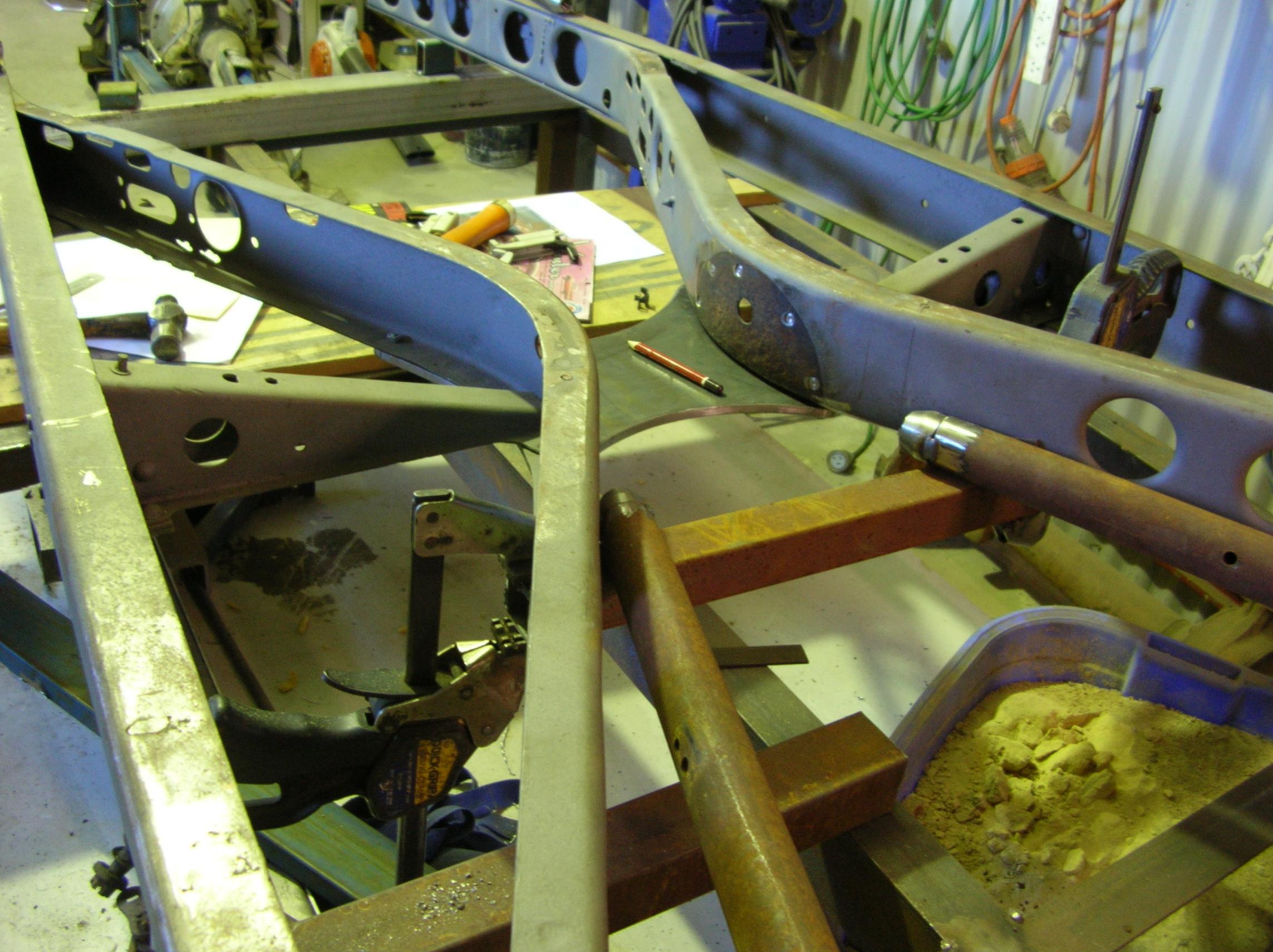

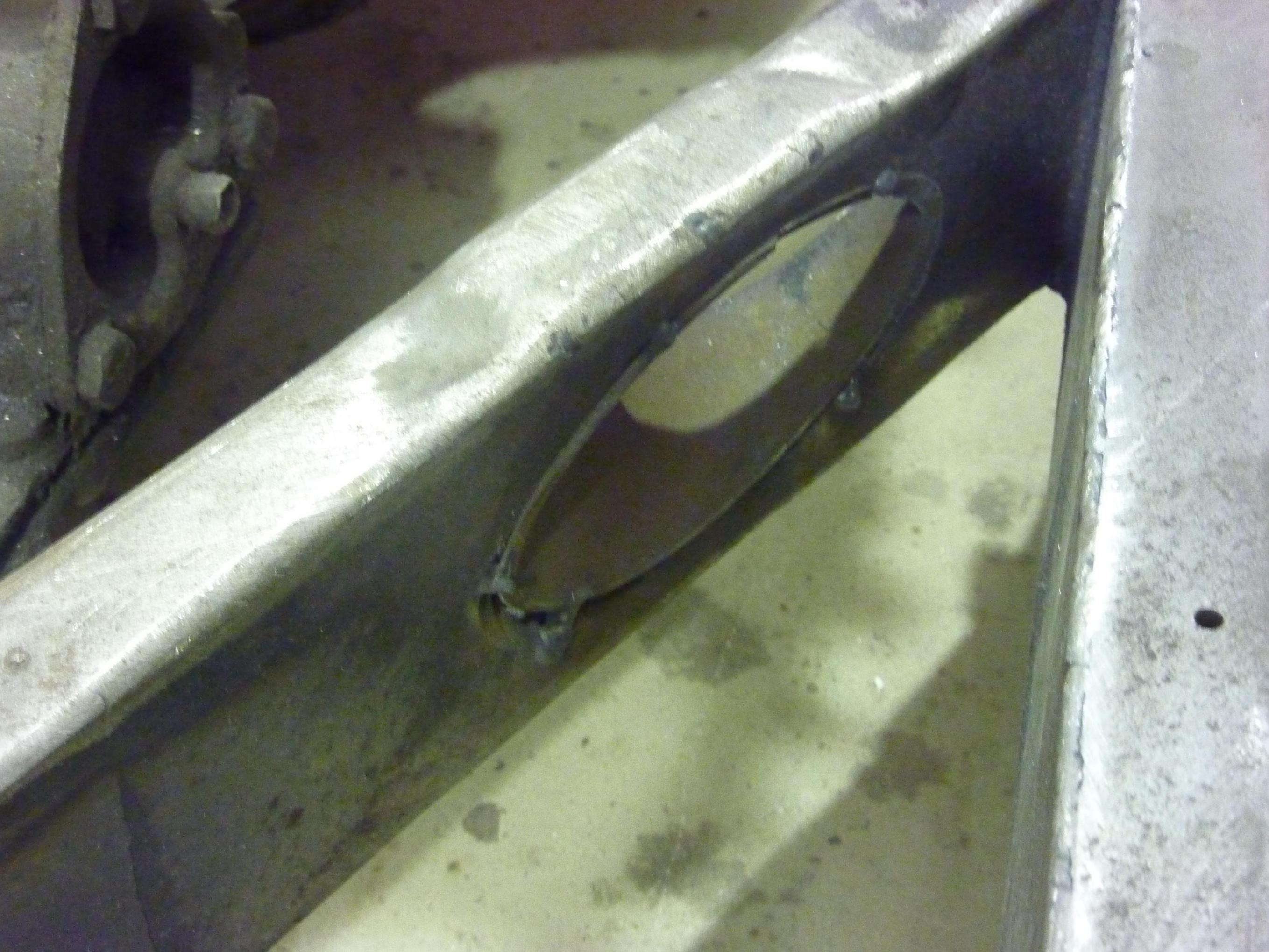

    from australia

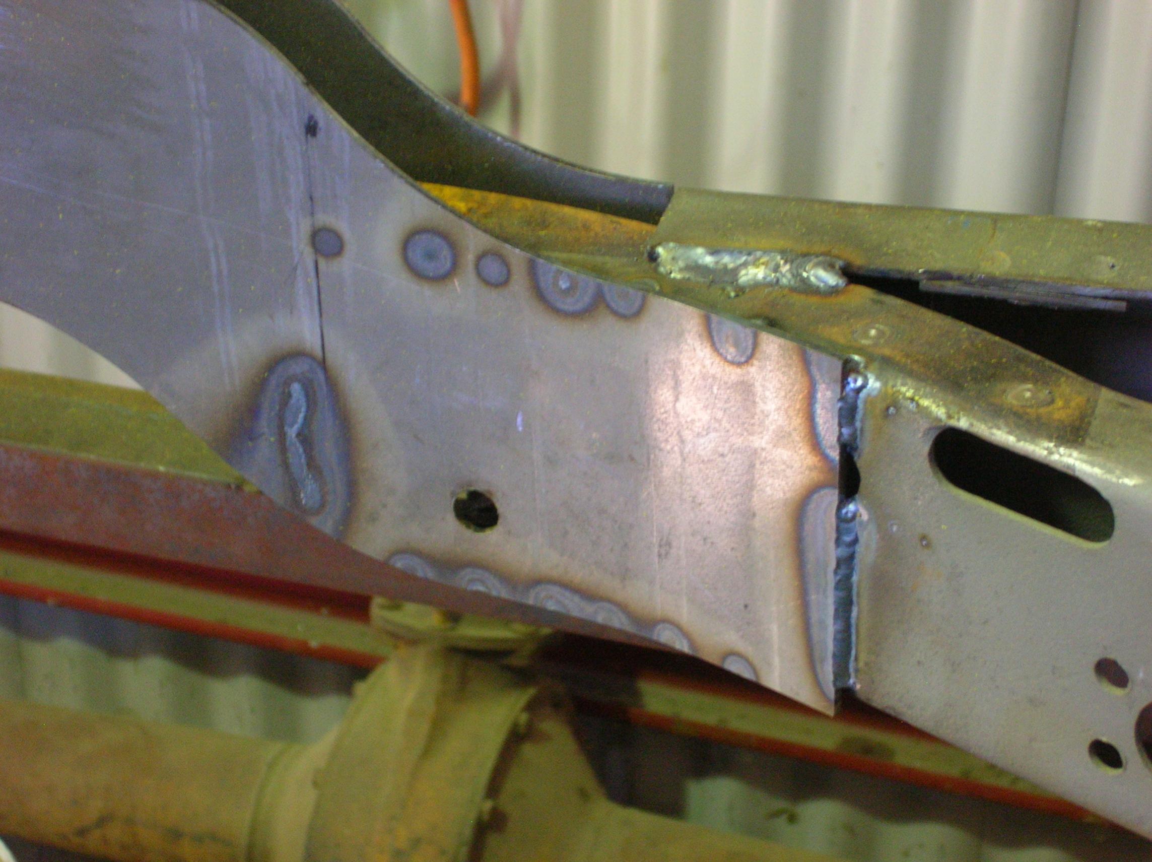

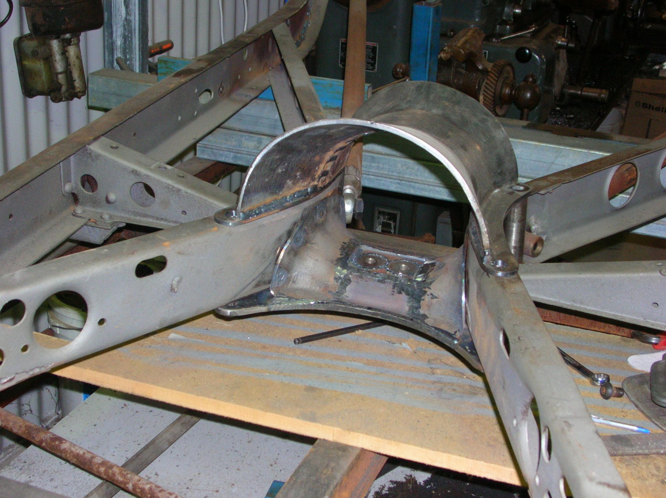

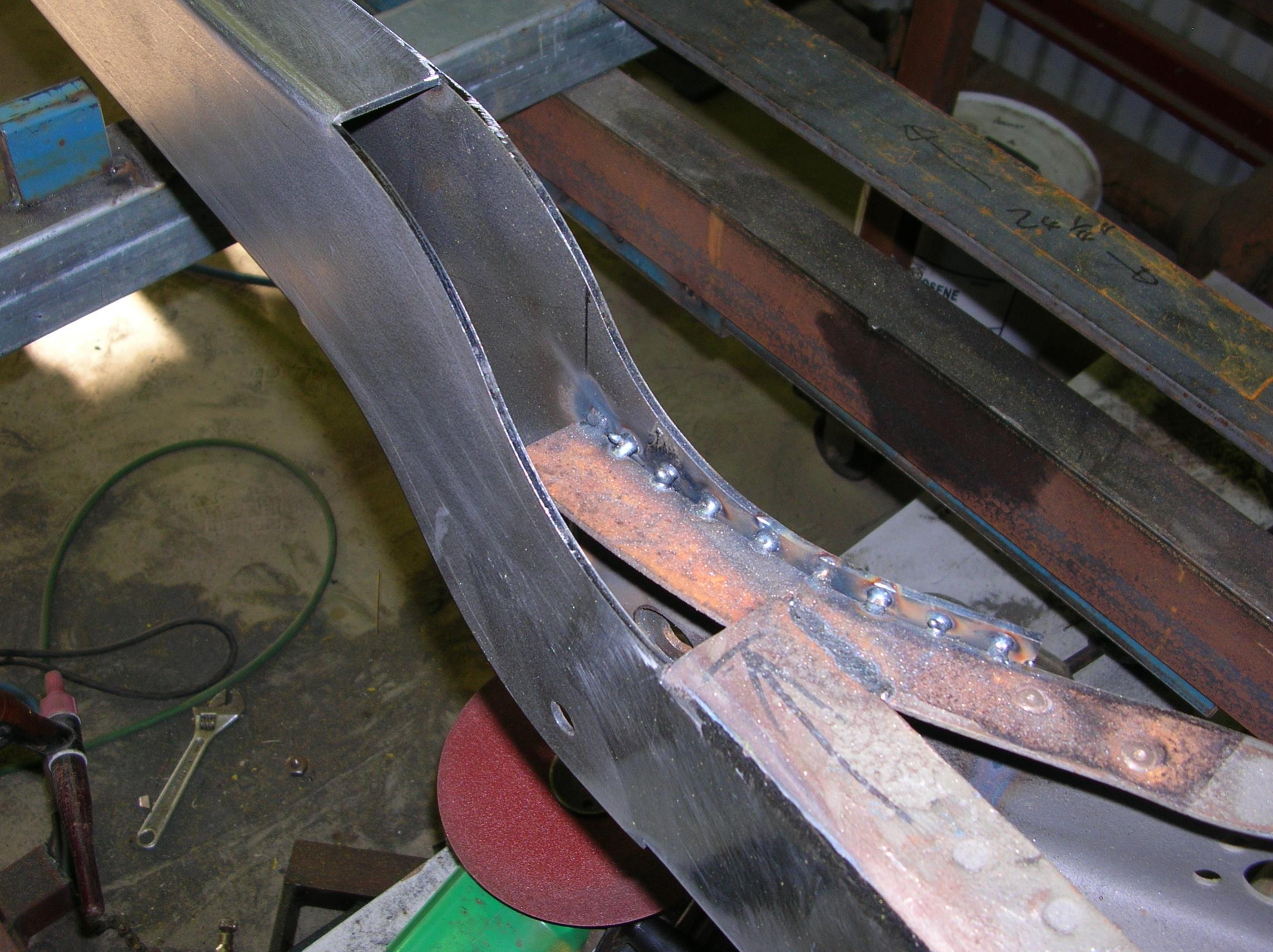

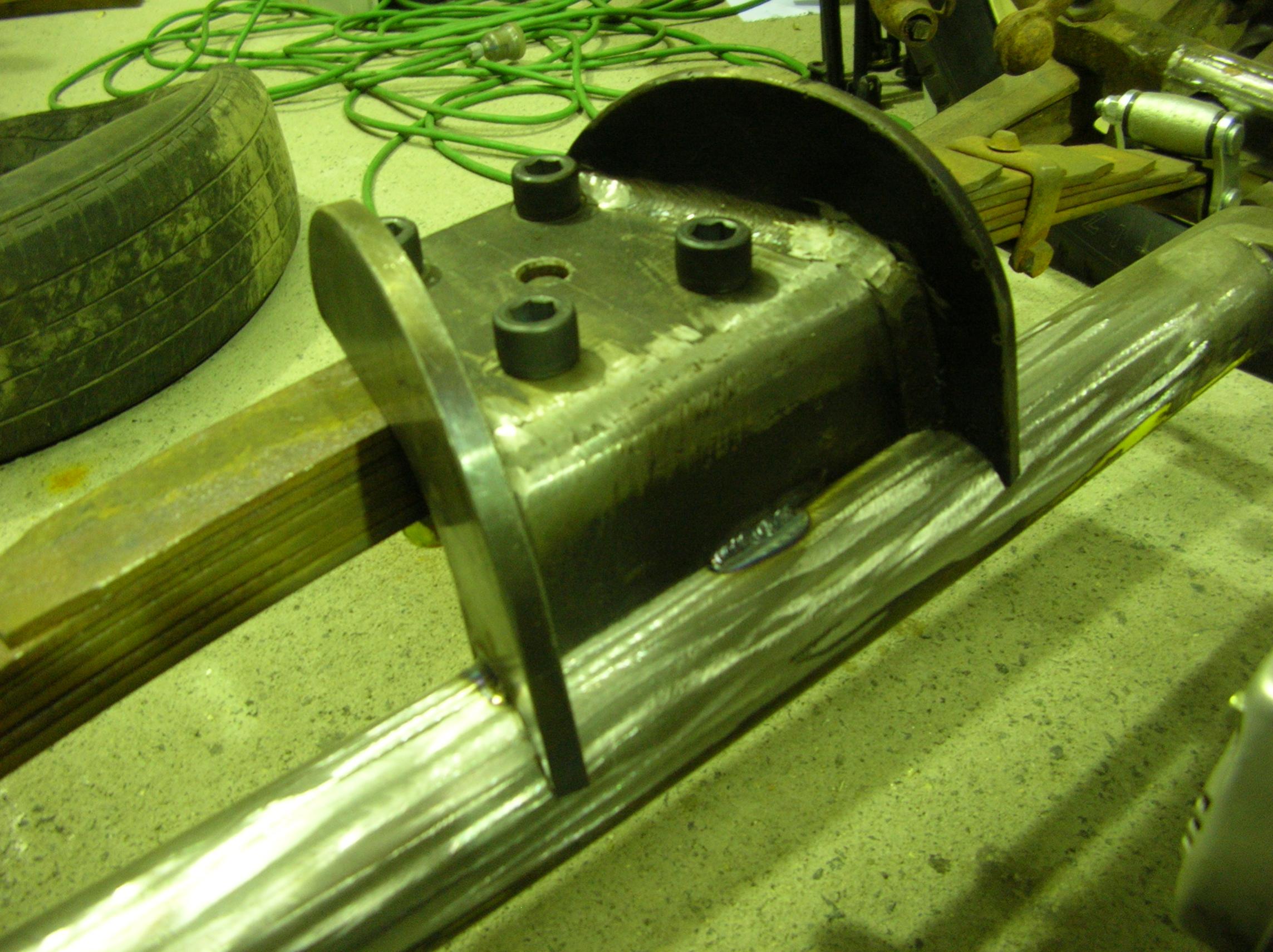

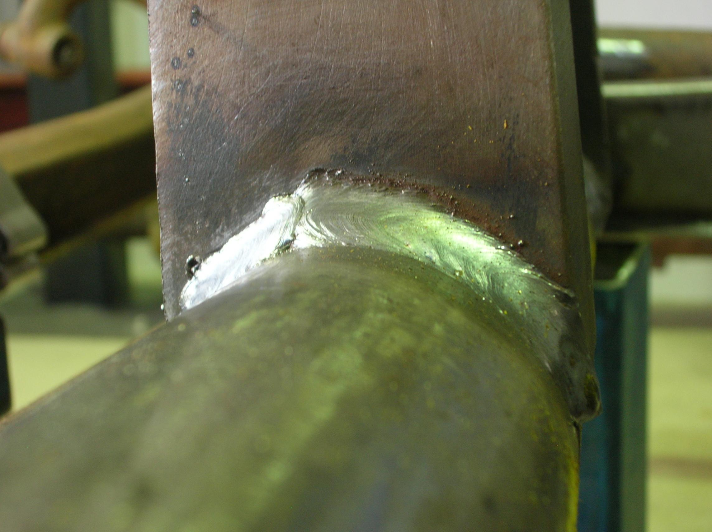

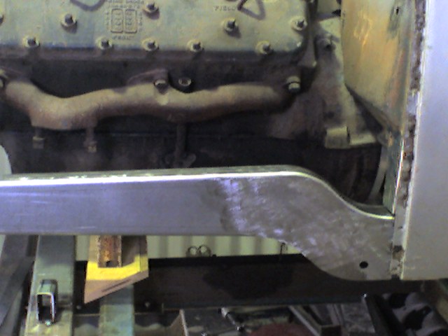

    Vic engineering regulation demand a 100mm or 4 inch over lap of of new material added and for fish plates
  9. 1928arat
    Joined: Dec 16, 2008
    Posts: 48
    1928arat

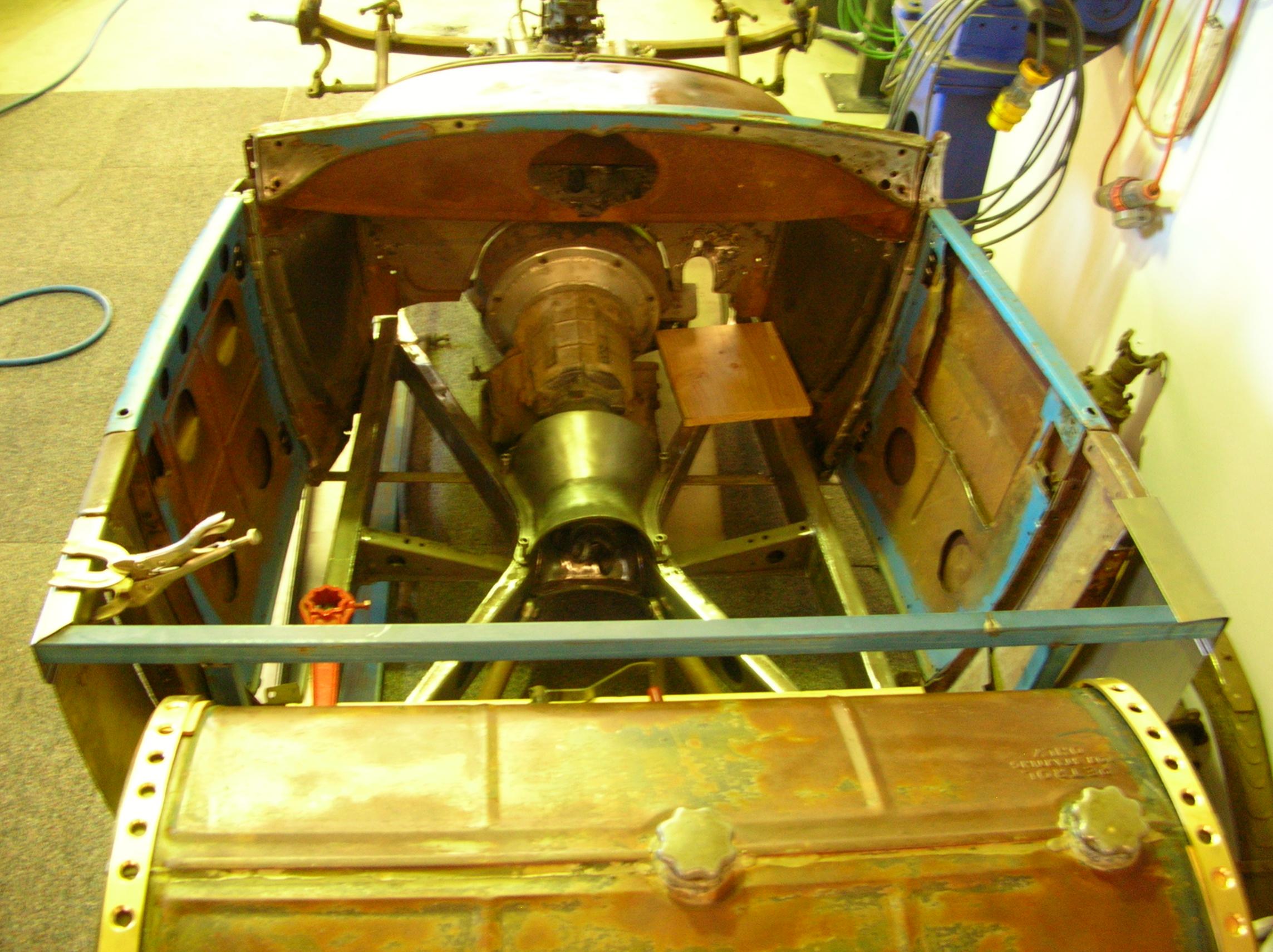

    from australia

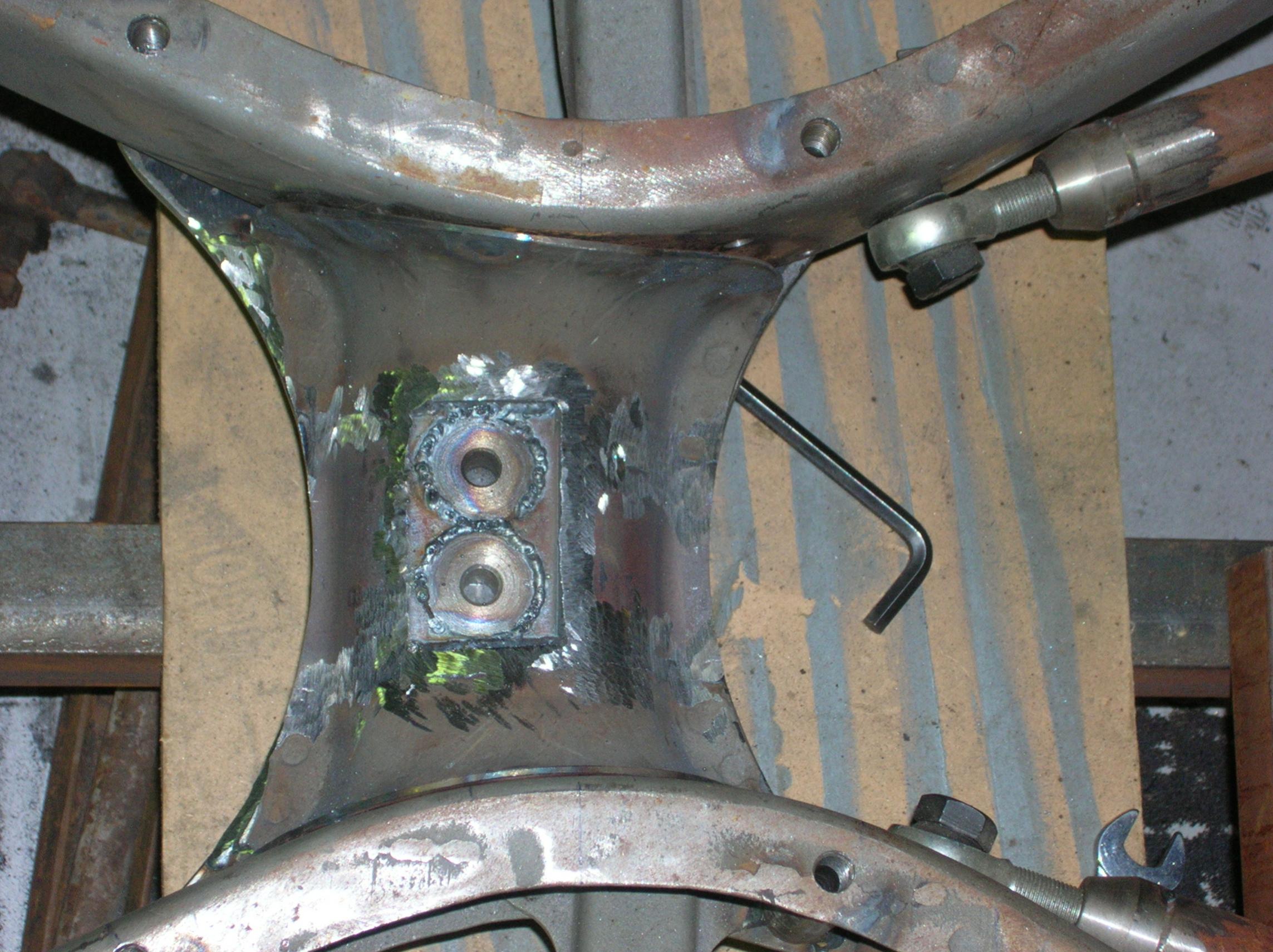

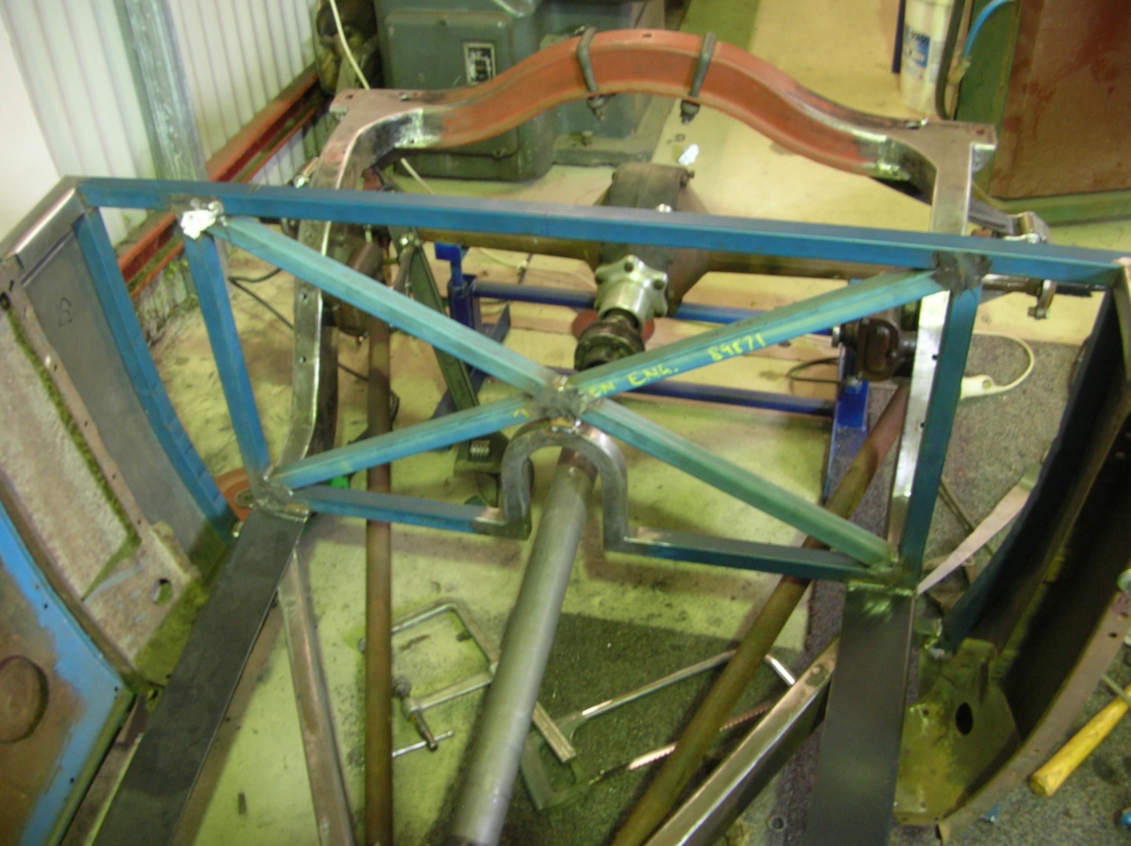

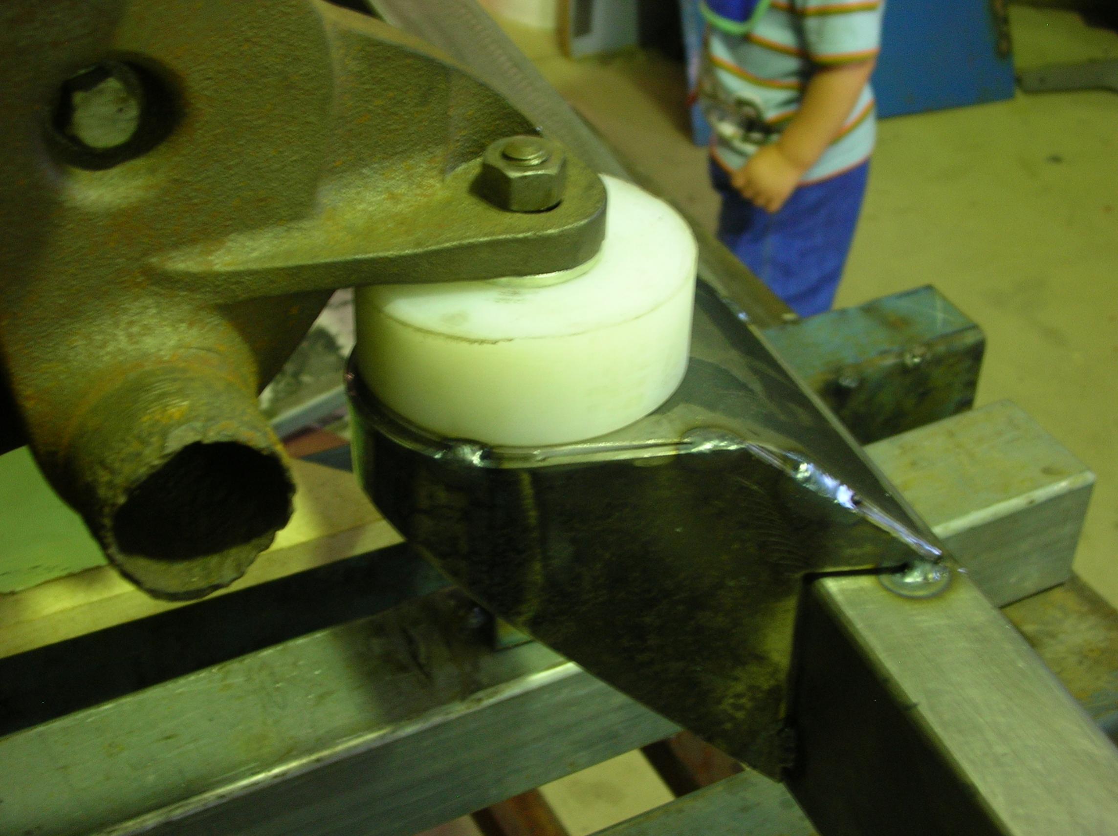

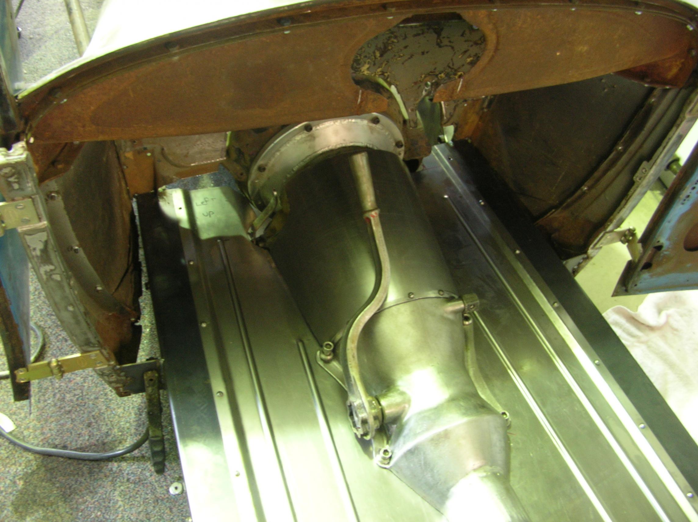

    bottom center of cross member is removable and top centre of cross member becomes catch tube for drive shaft and mount for gear lever (pics to come)

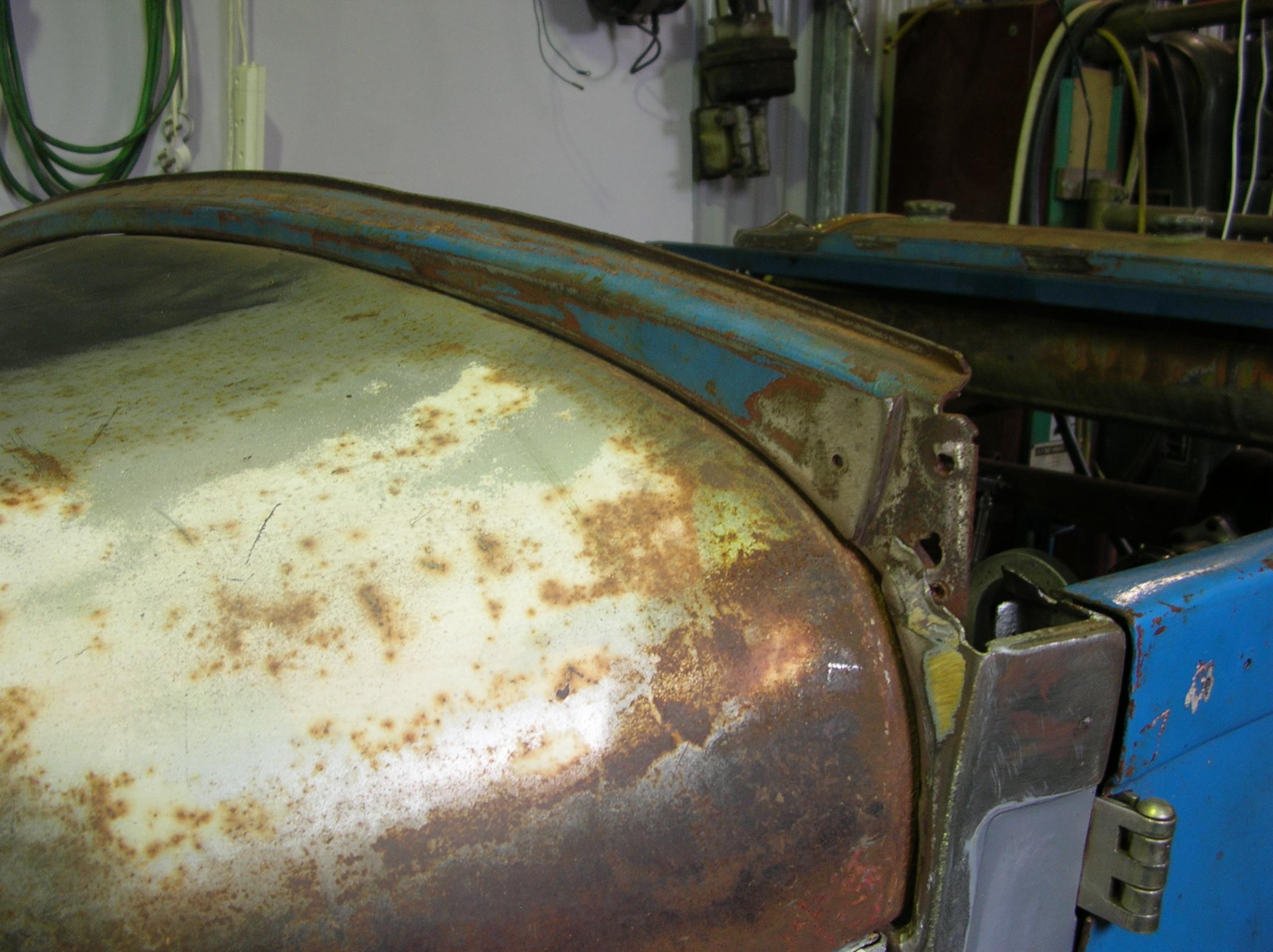

    from australia
    Put body back on and start to mack up rear section of cab i used original B pillers and made two press dies to copy the top and bottom body lines.

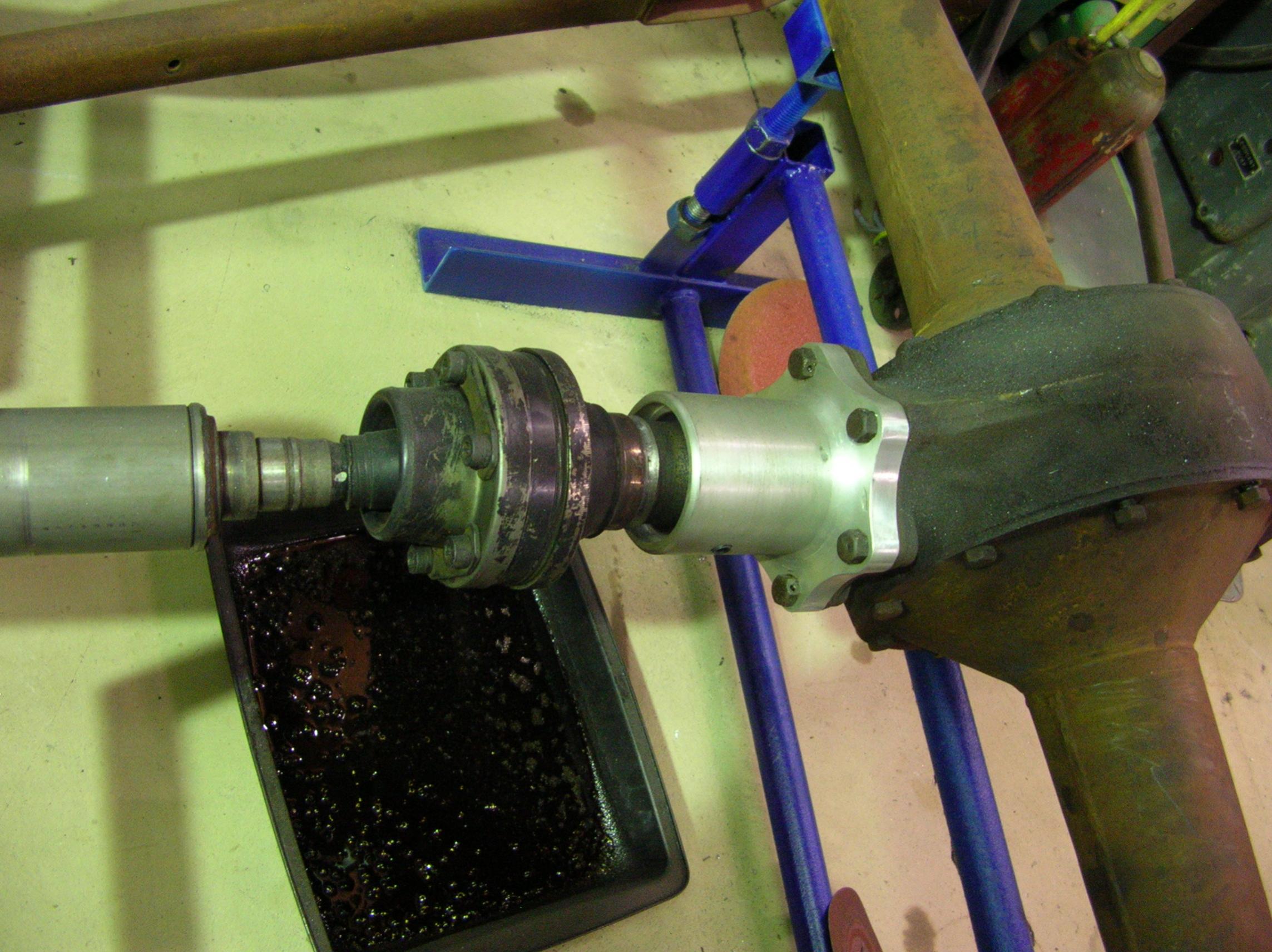

    from australia

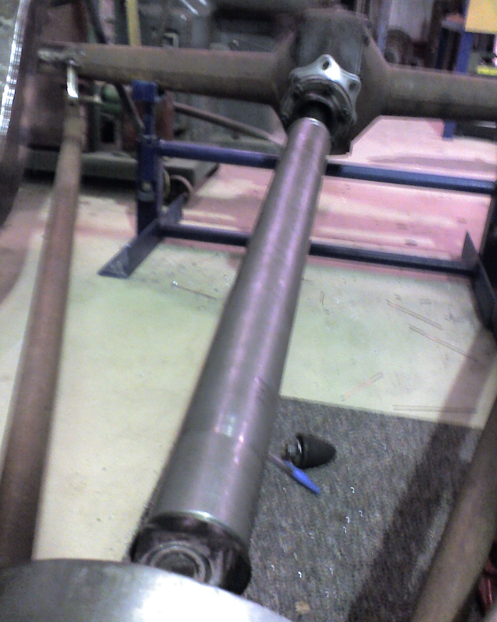

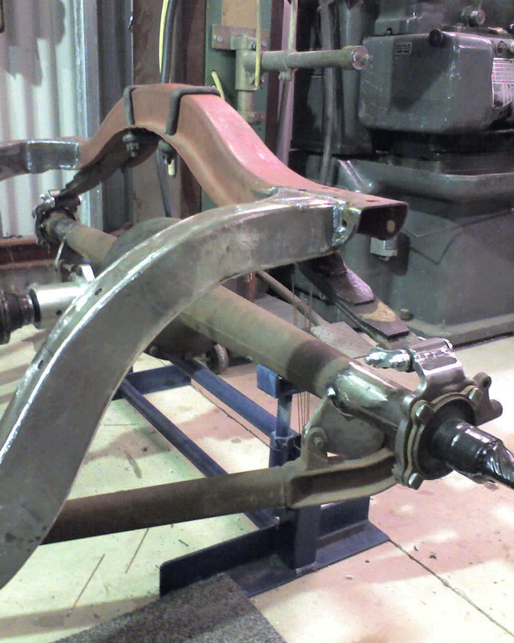

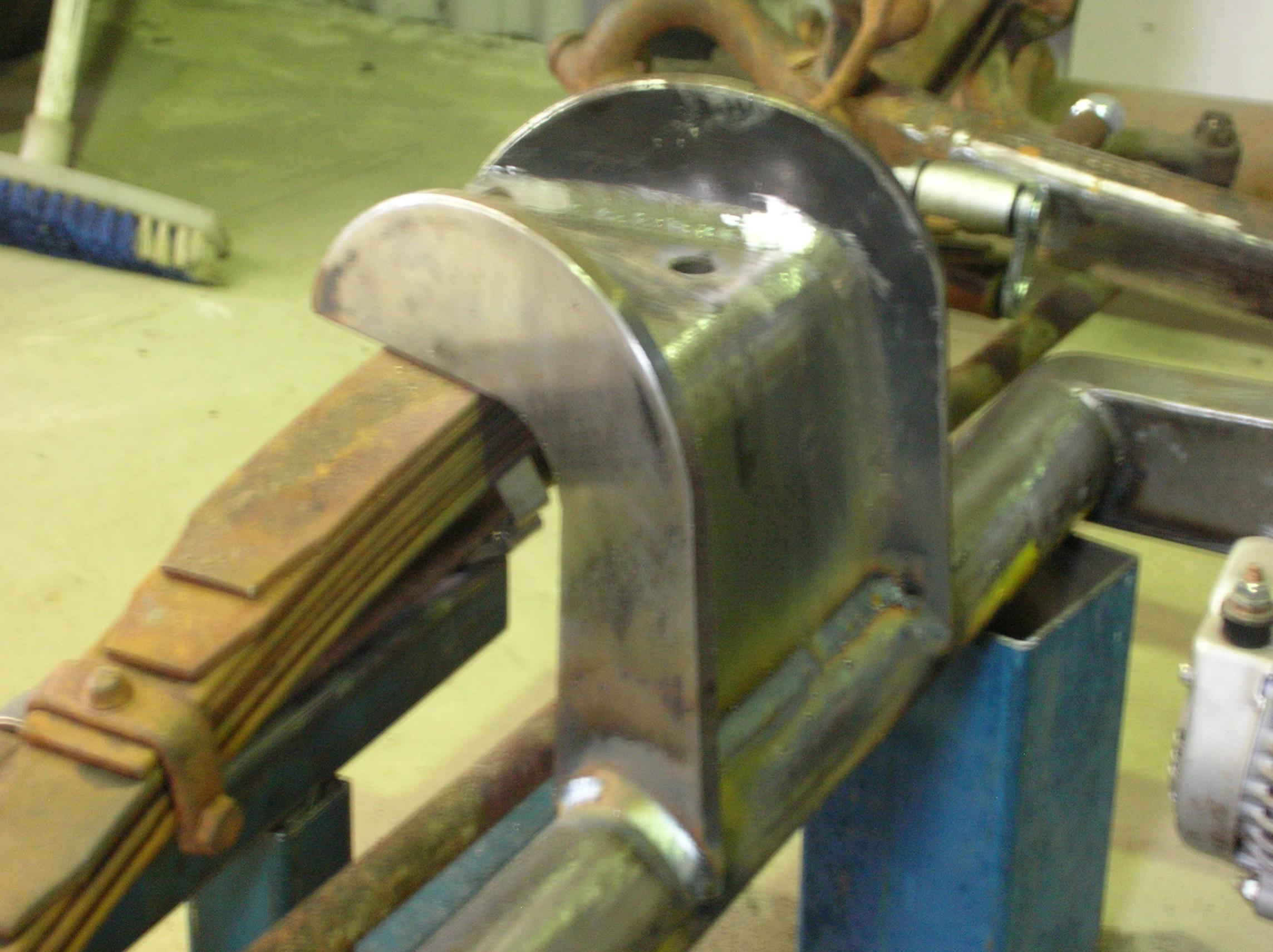

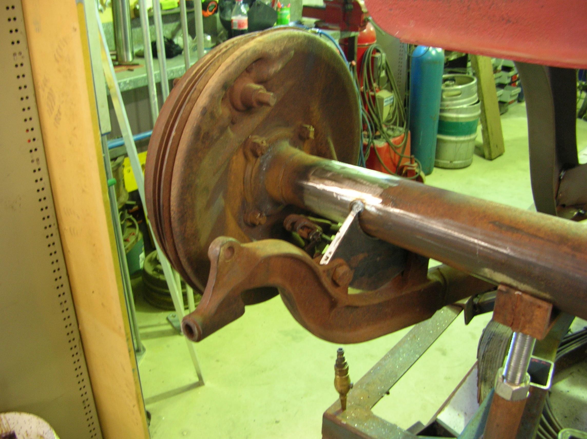

    Make tail sharft and and fit rear spring and make sring hangers

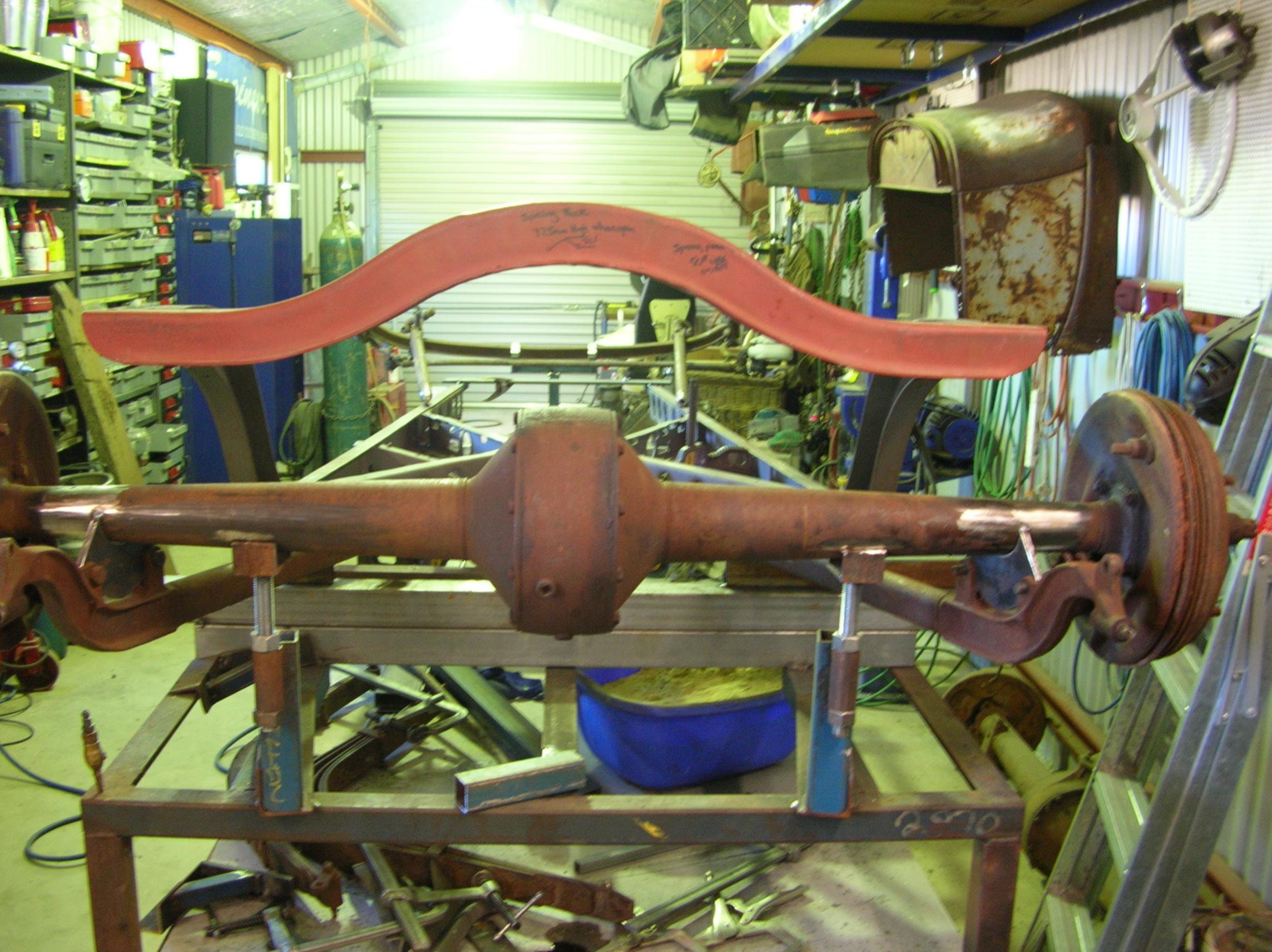

    oj

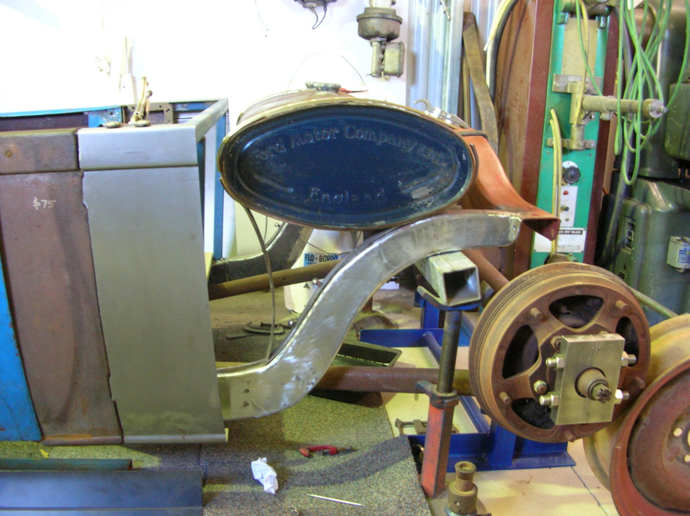

    Is that a model 'a' rear?
    I like the curve of the kickup at the rear, i might have to copy that some day. That little kickout from your frame jig looks very handy, i can see a couple of those cropping up on mine.

    from australia

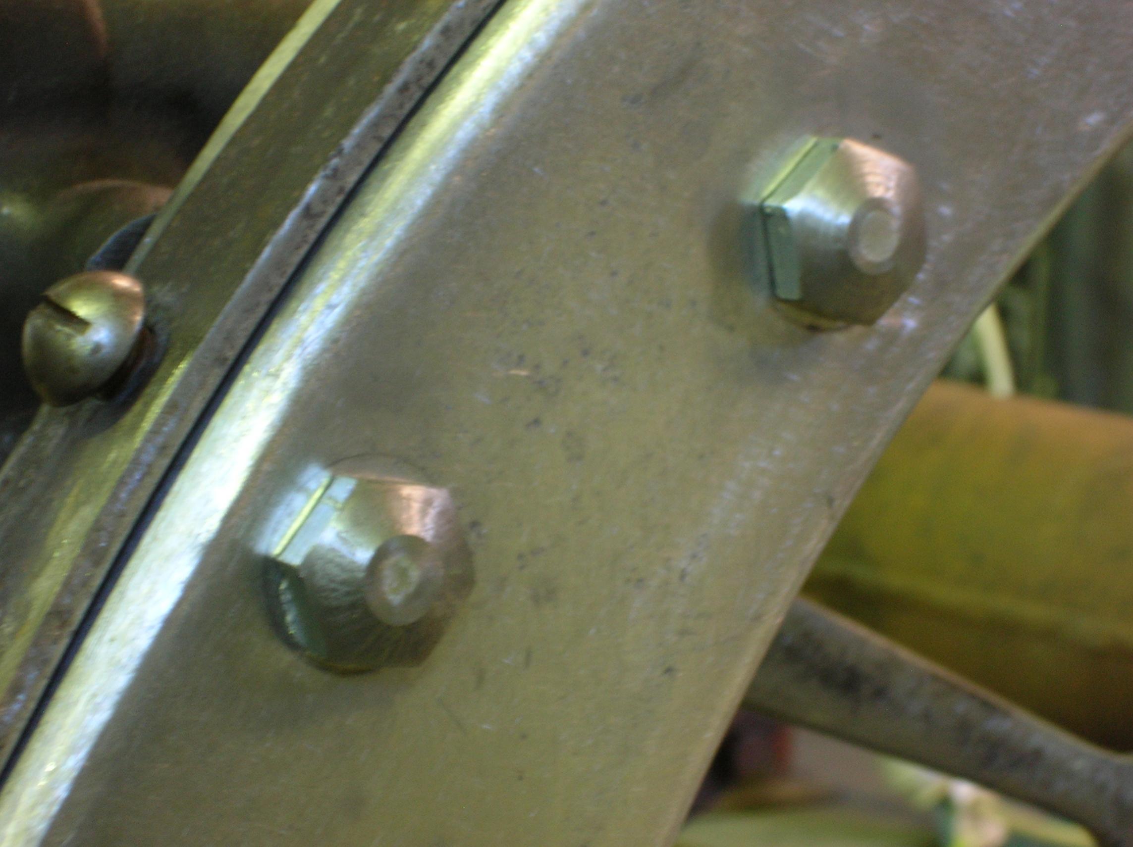

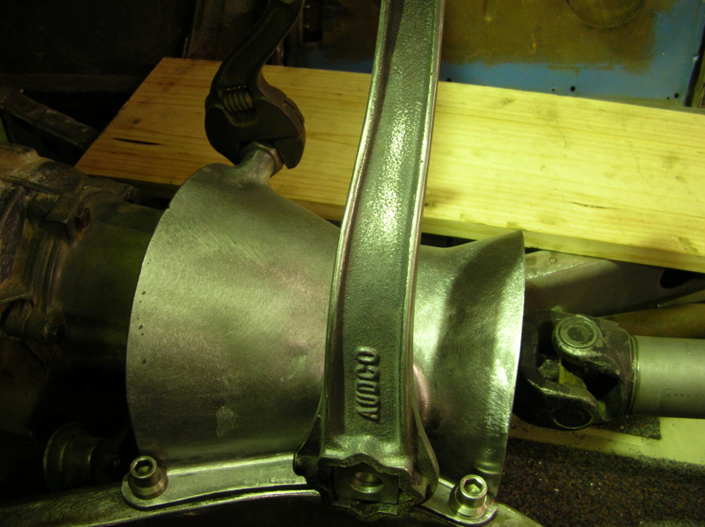

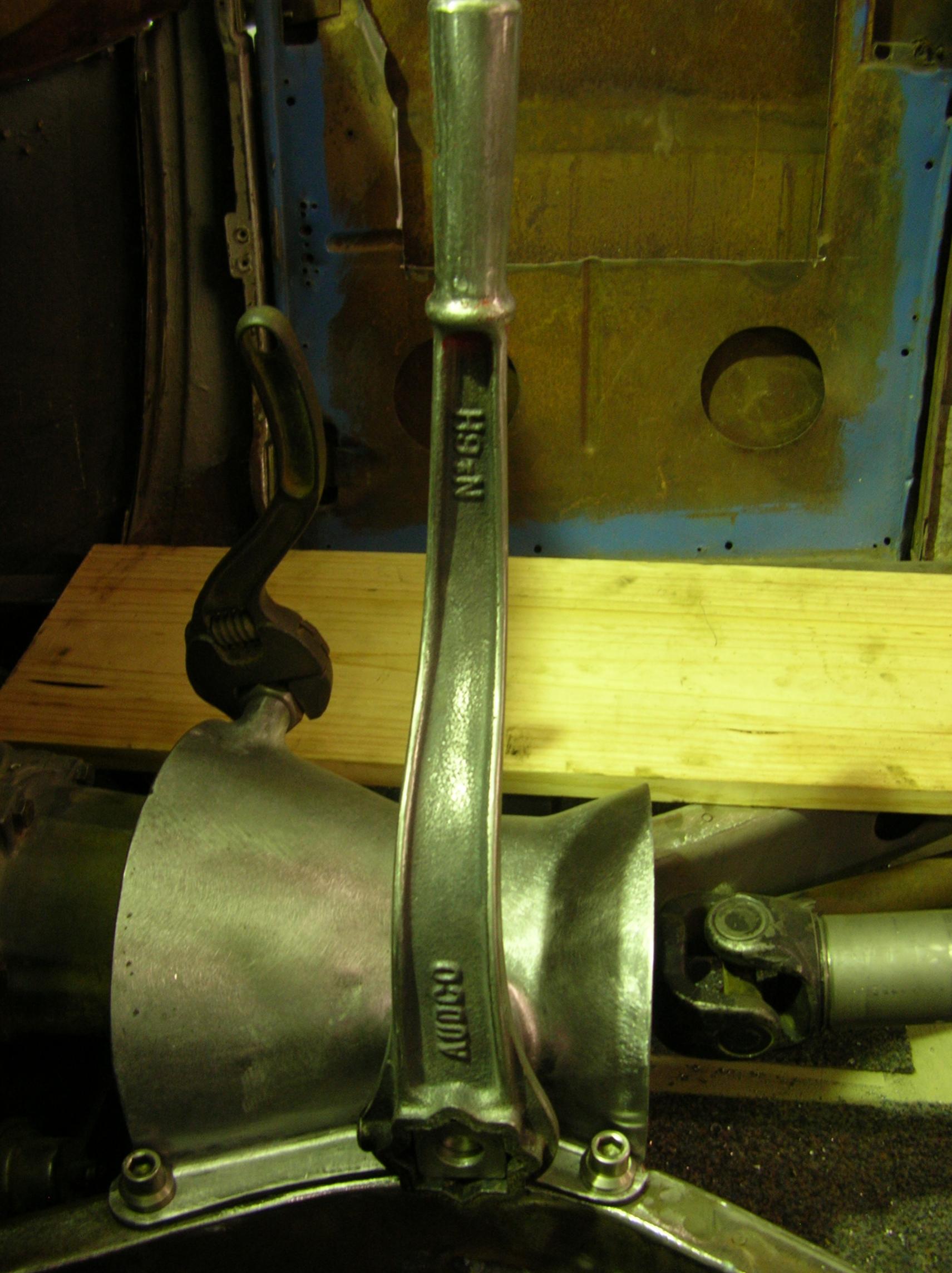

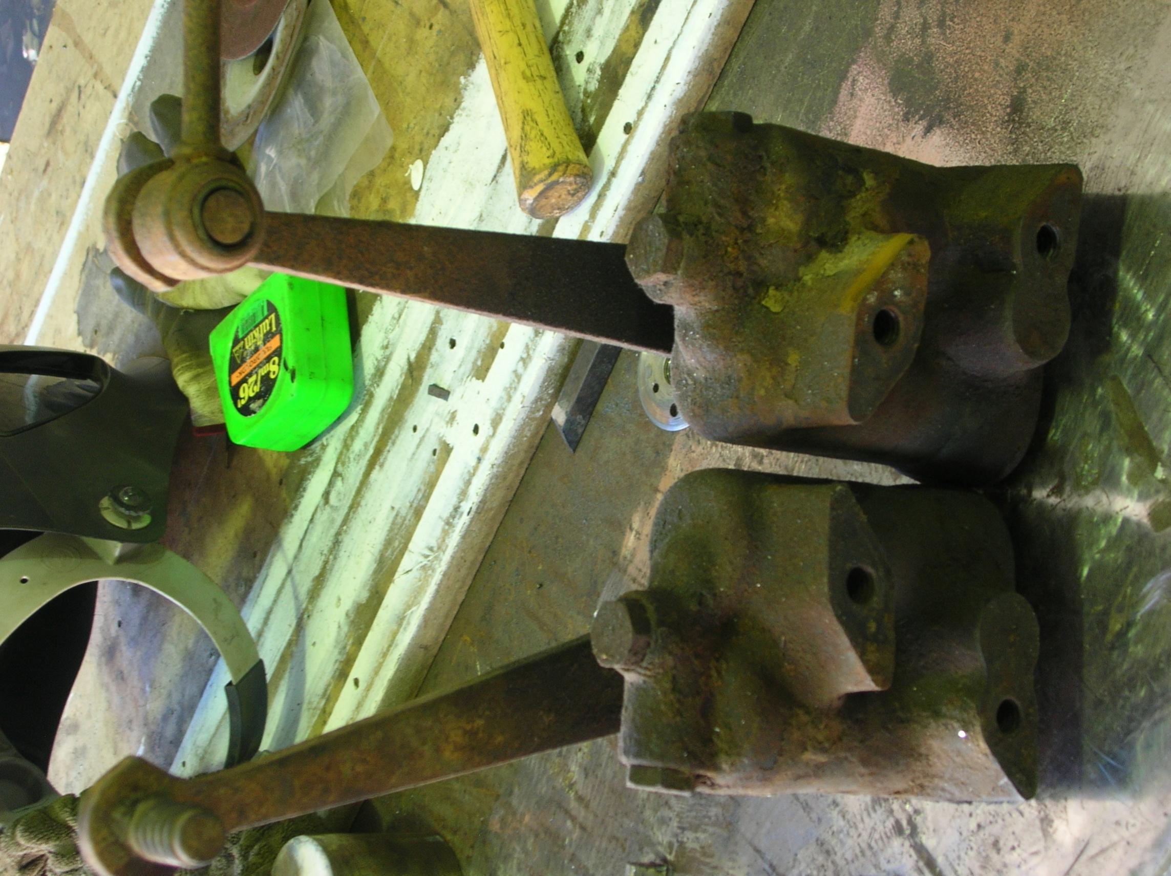

    This was my 1st idea for a gear shift and hand brake but thing change and i got rid of the small adjustable shifter and left the large valve handle as the the gear shifter. the tank strap latches came of a 90 year old soap press were i used to work they are solid brass and nickle plated.

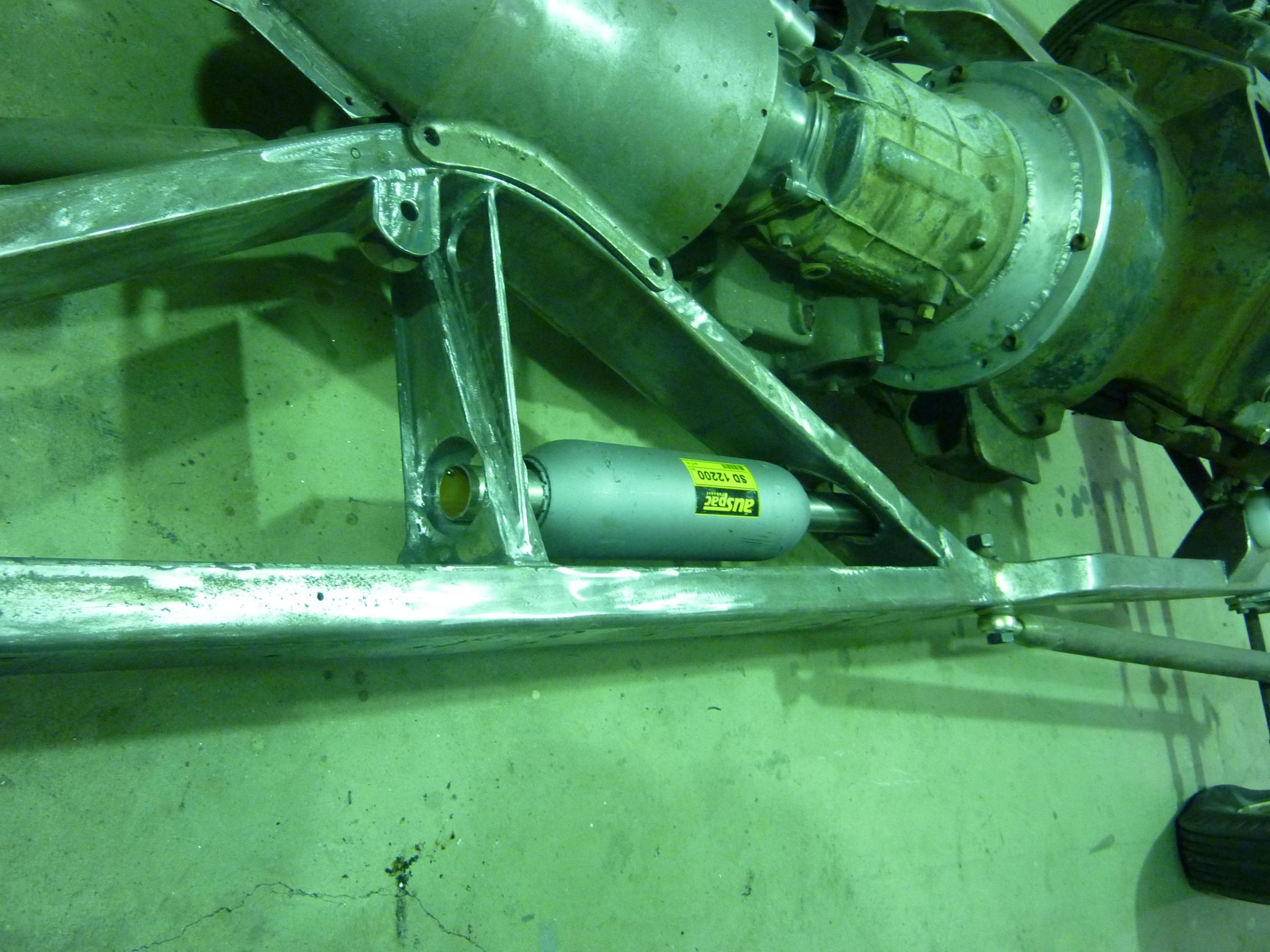

    Rear shock came of a dodge or chev not sure they were on amates farm and free still full of oil and working.

    from australia

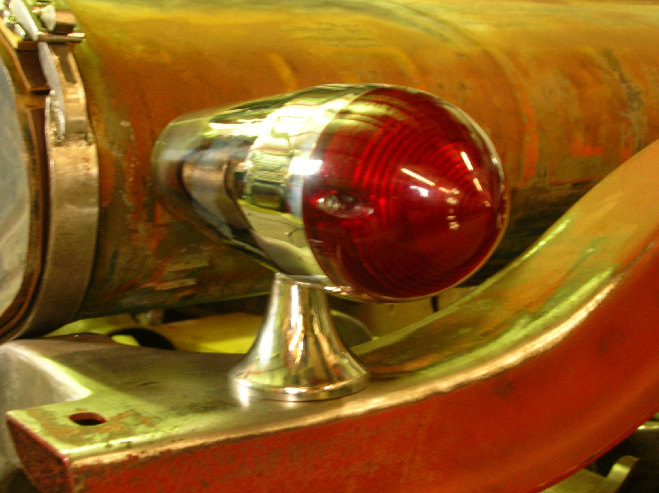

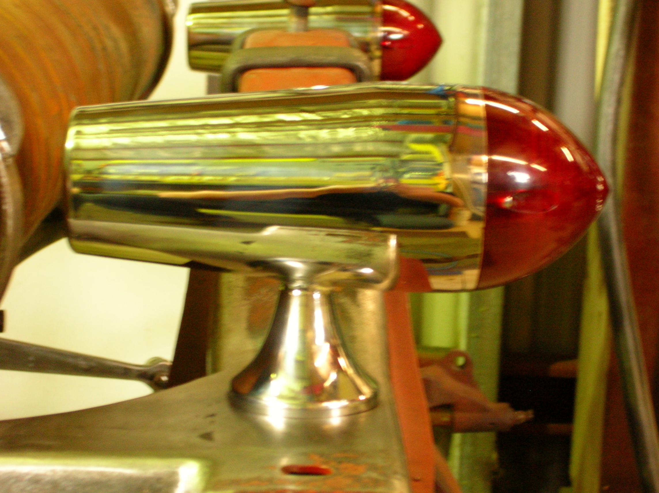

    Rear taillights can any one gess

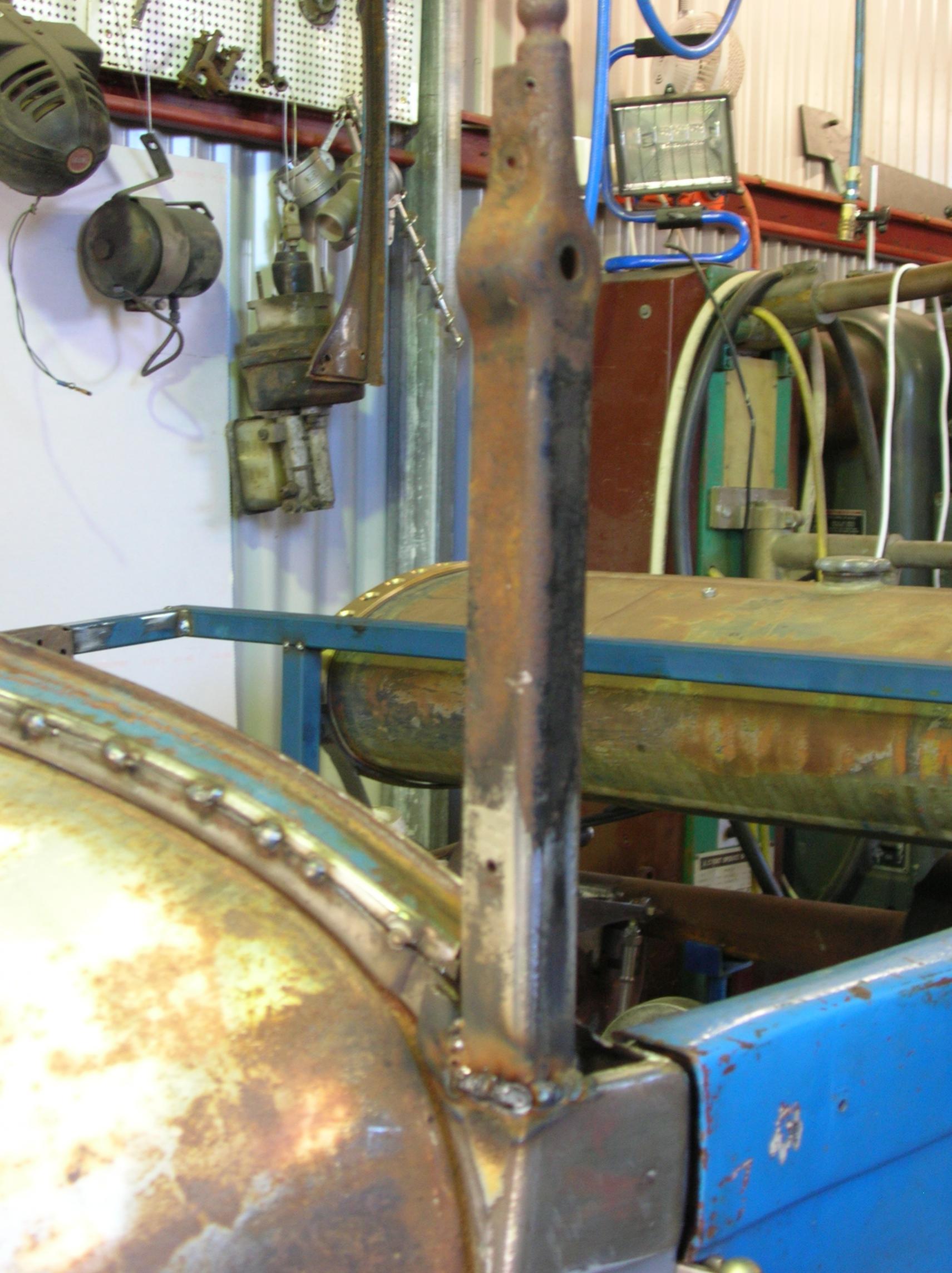

    The a pillers on this body were gone when i got it Broken off in the nomal places A,s break i found these posts at a swap meet for $20 i Yhink There 1927 Chev a bit of cutting and they fitted ok.

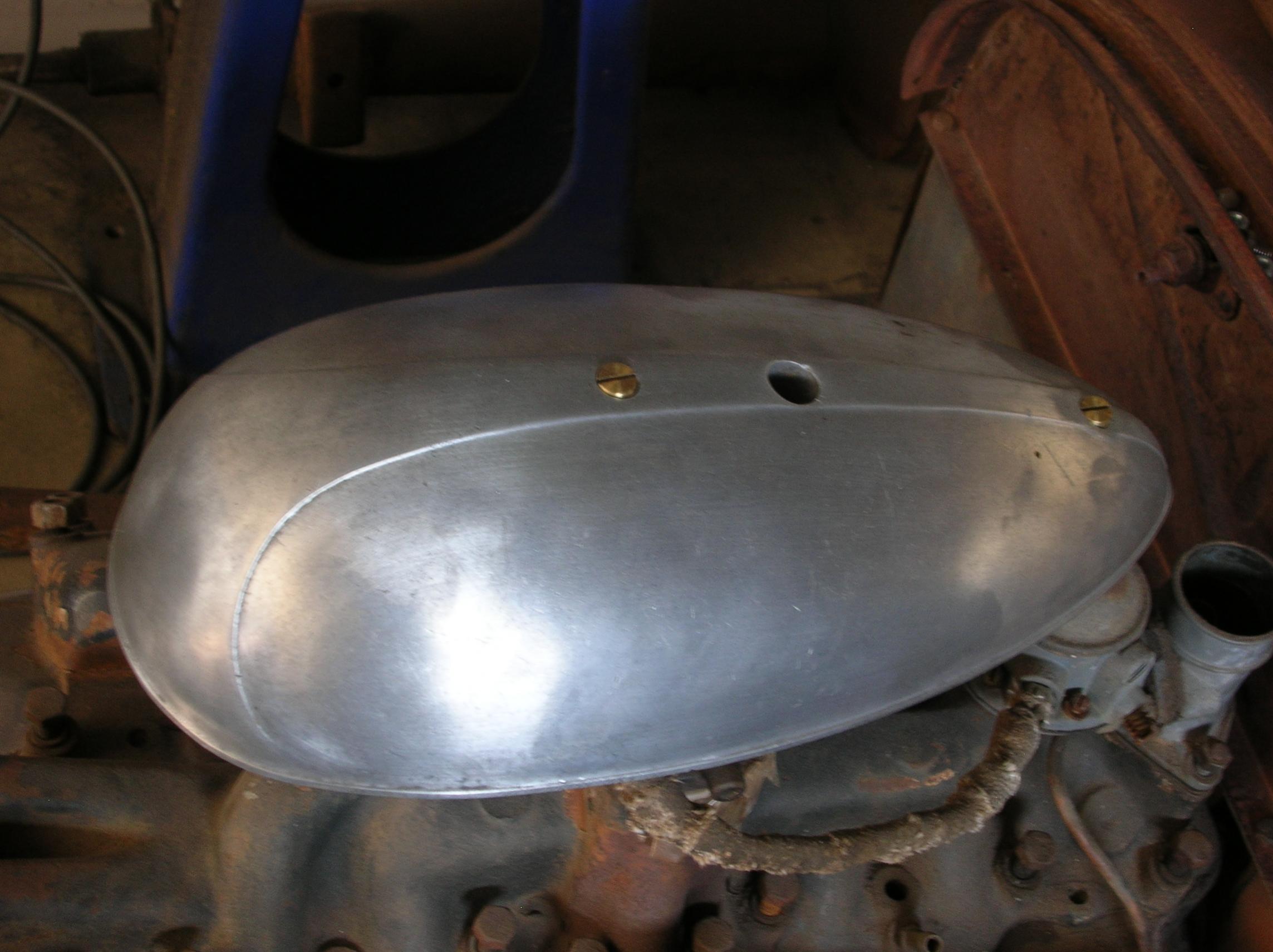

    I found this at a locaL SWAP MEET 1920'S cotton motor bike crank case side. The bloke nearly cried when i tolled him i was going to cut it up, and use it for a air cleaner cover.

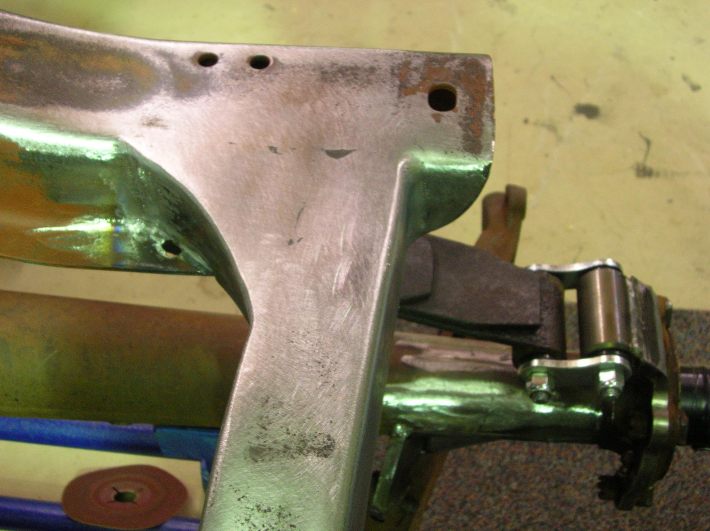

    front spring perch way to high cant even get a golf ball under the sump

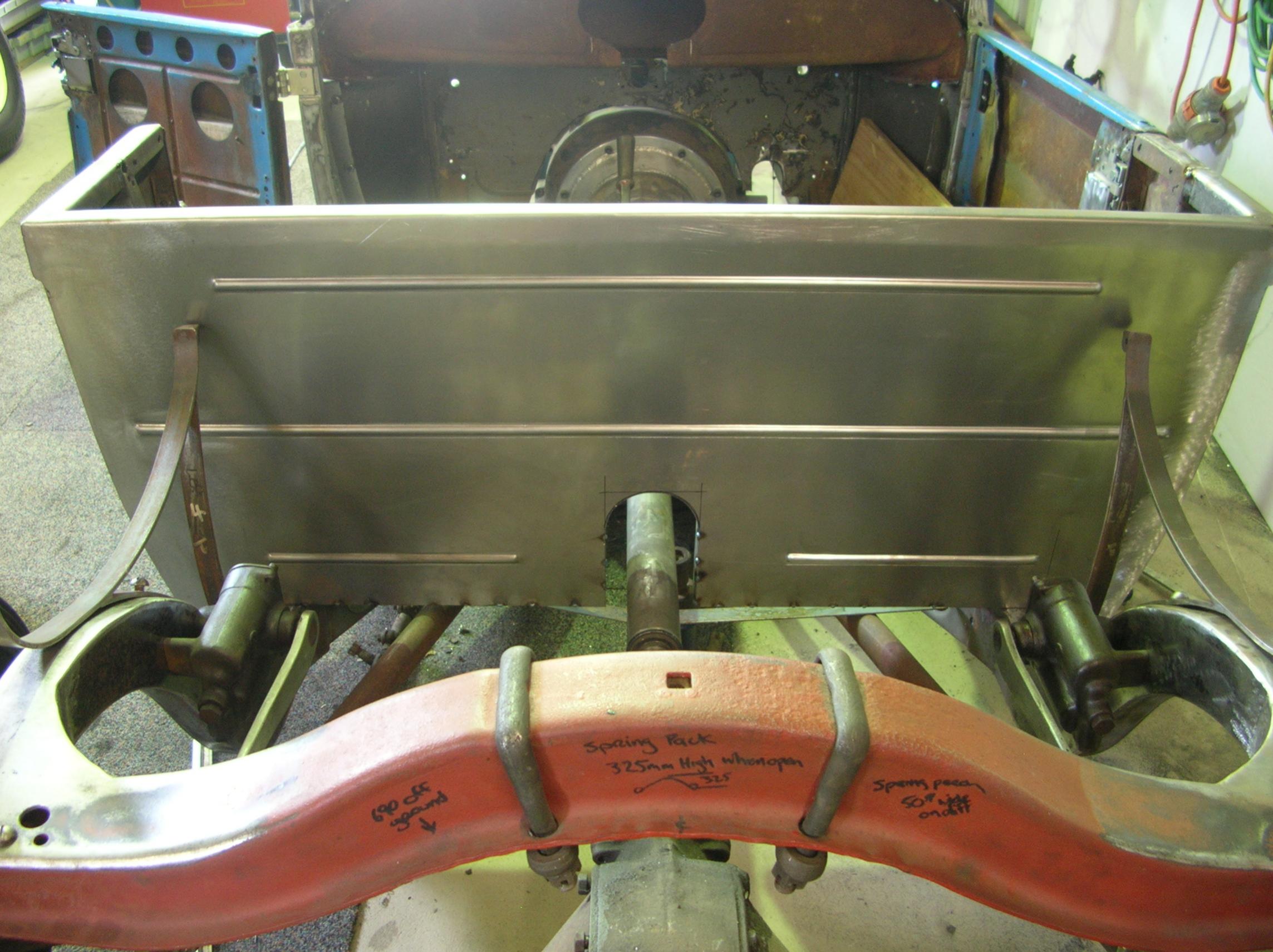

    from australia

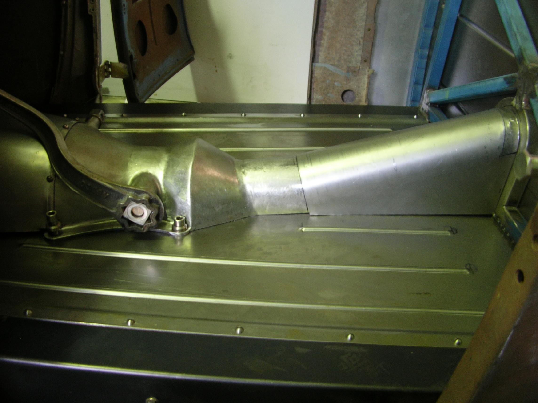

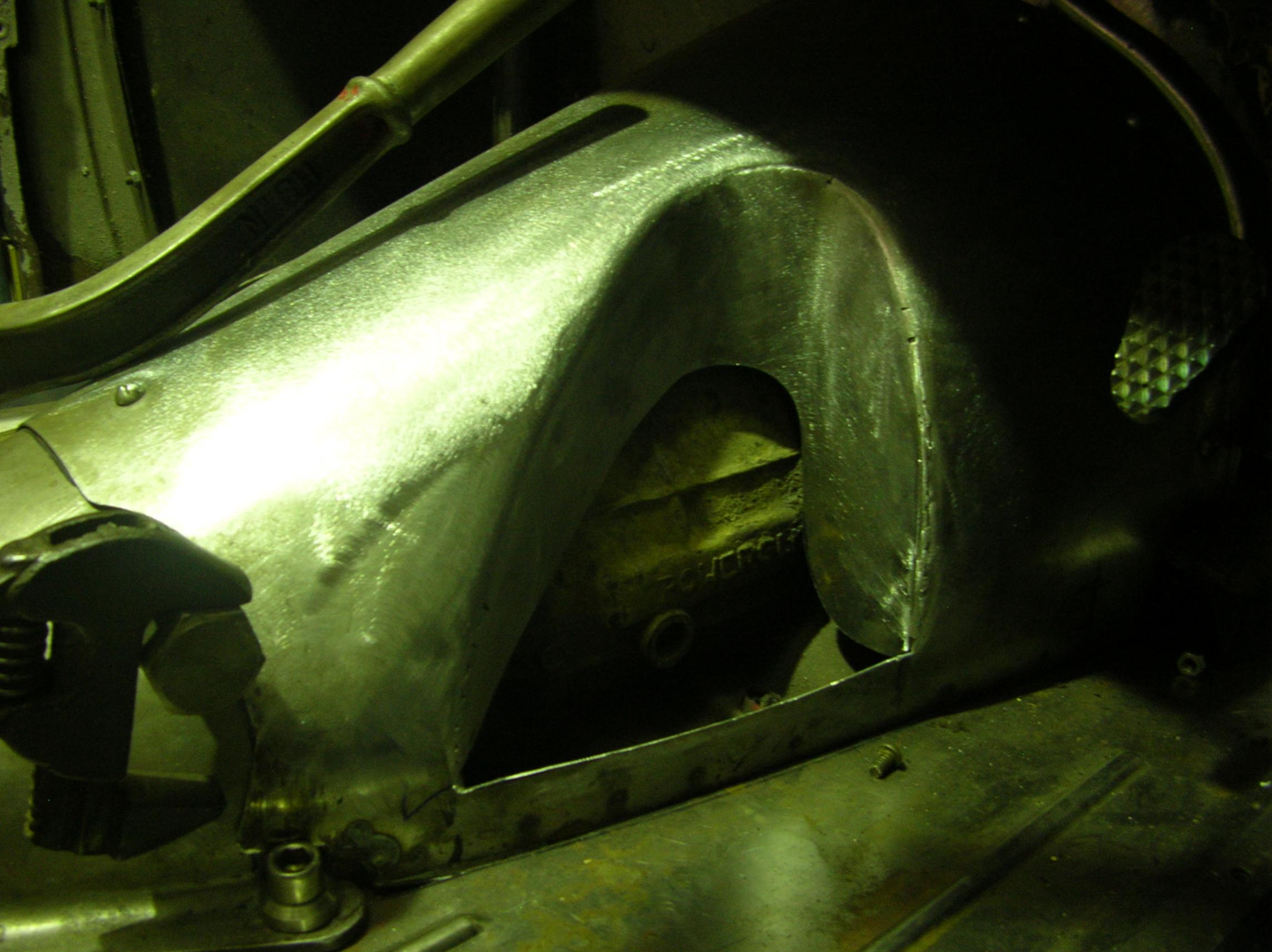

    Rear fire wall and floor pans i used works P5 pullmax when they had it.

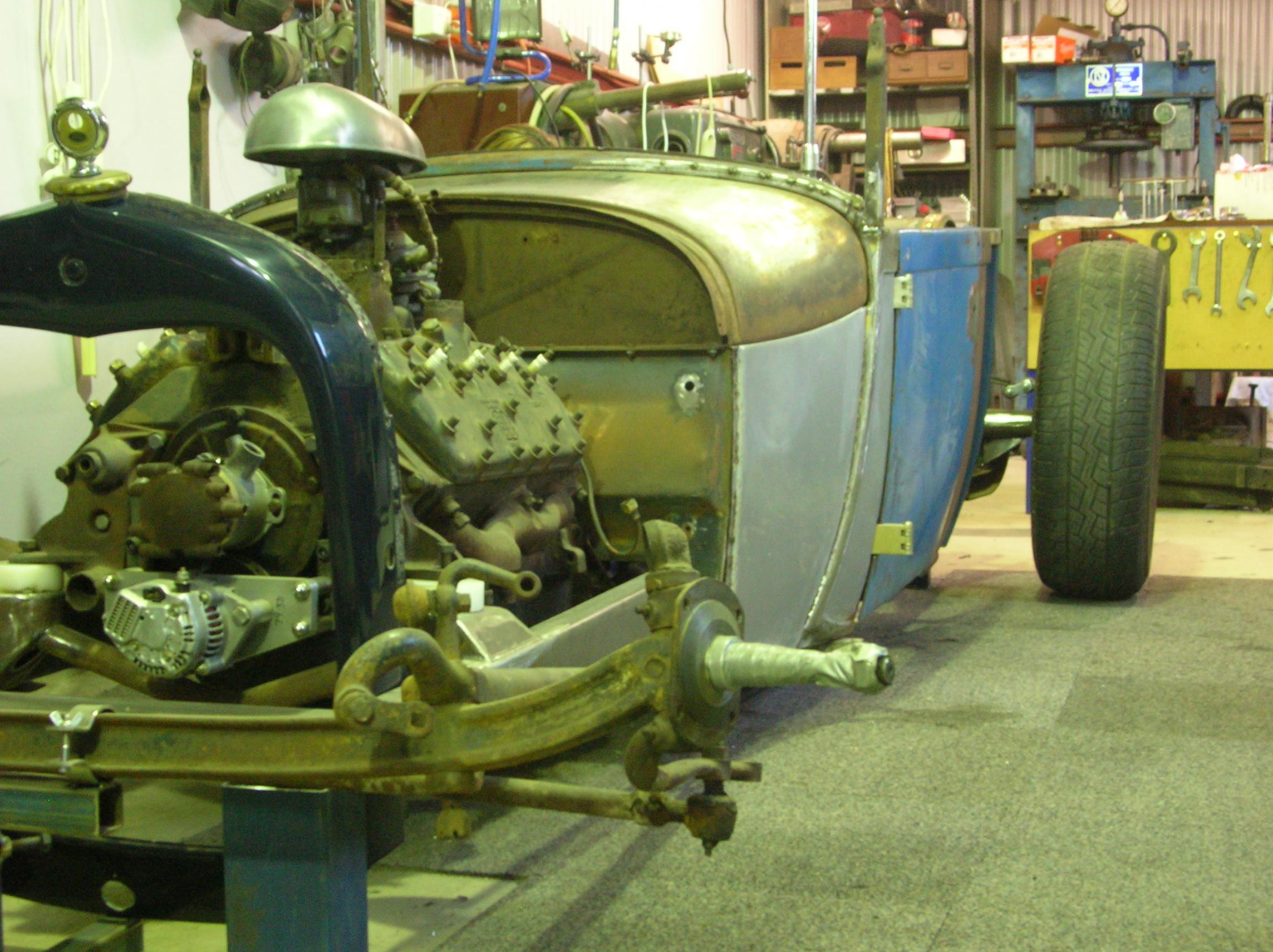

    Bit low cut 2 inches out of front perch sit good now
    Head light not sure another swap meet find the bloke i bought them of told me they are early ford prefect.
    started on cowl steering, bow it VW i think fit well and works well.

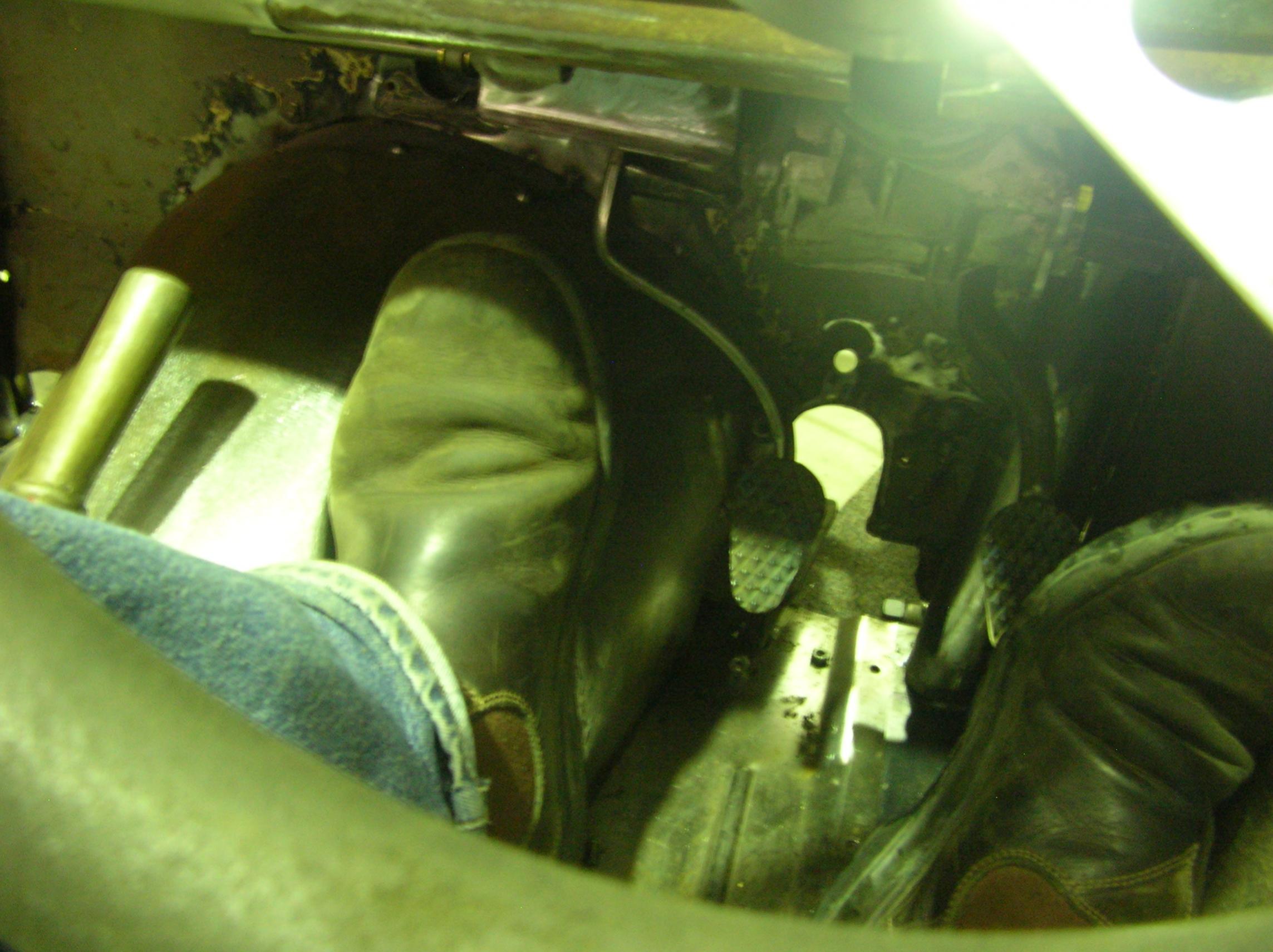

    Swung pedals and cut in more room for feet

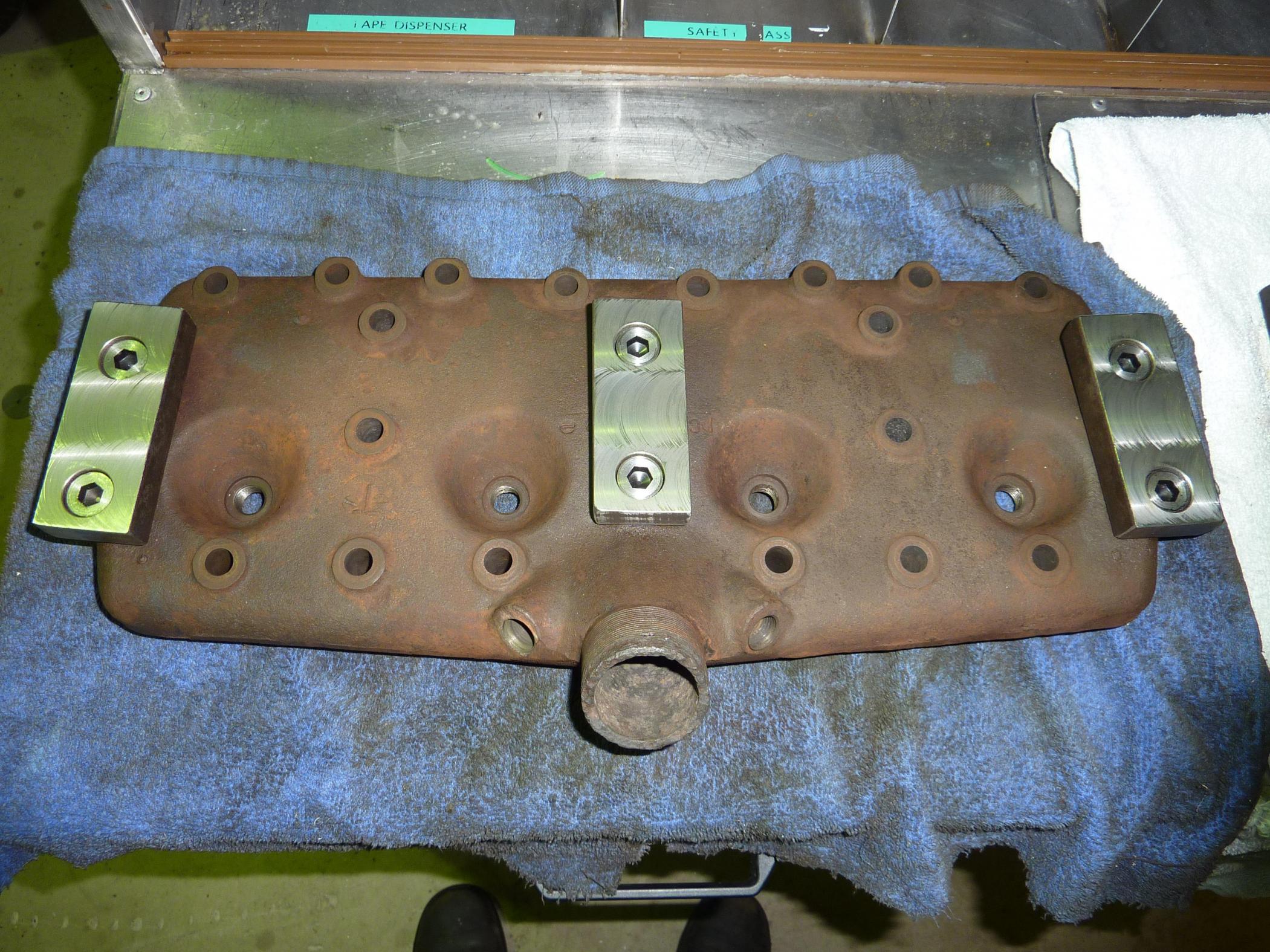

    from australia

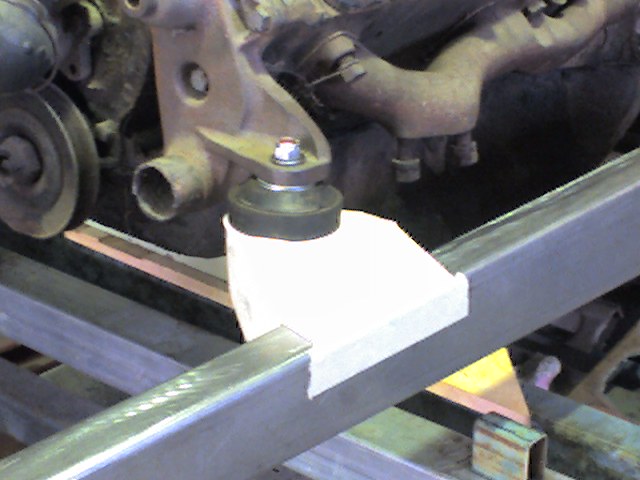

    Started on the motor 99A merc sorry no pics of pull down motor was sitting in a shed for 20 od years with the heads off seized but dry and still full of oil. i taped the bolt holes in the heads and made some blocks to bolt to the head, clamped the head down and machined them flat, tuned the head over made a fly cutter and macined 10thou of the heads to just clean up.
    Motor will be stock for now untill i get the car up and running i have another block i will try and get a bit more power out of.
