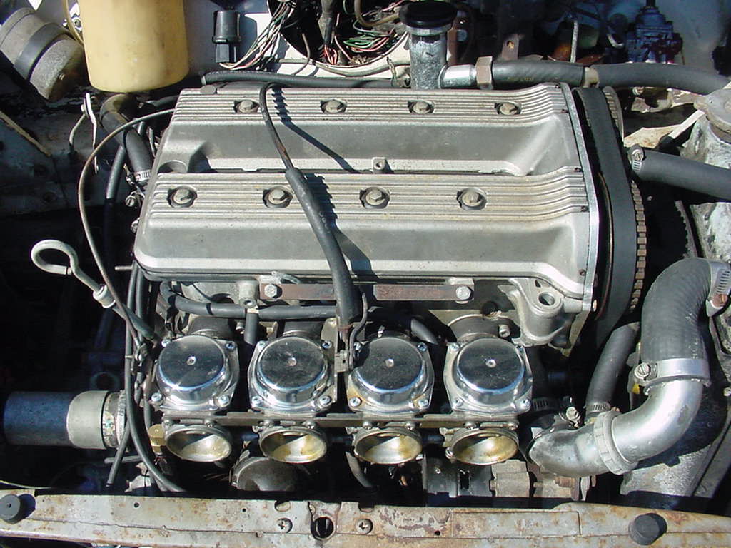

    As to the original topic — apologies for the tangent — a modern cylinder head often adapted to a traditional-era engine is the 1983-on BMW K-series "brick" motorcycle cylinder head on the BMC A-series engine, as found in the original Mini:
