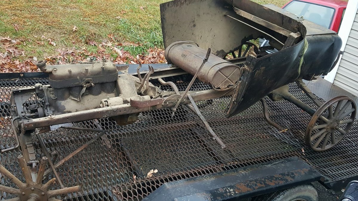

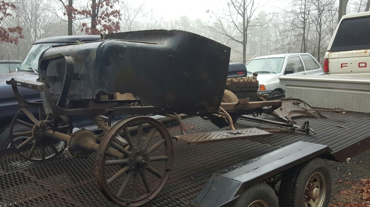

  1. 20151129_144701_resized.jpg 20151129_144715_resized.jpg 20151129_144728_resized.jpg 20151129_144728_resized.jpg 20151129_144815_resized.jpg 20151129_144906_resized.jpg 20151129_144943_resized.jpg 20151129_144952_resized.jpg 20151129_144928_resized.jpg 20151129_144916_resized.jpg I've been awol for awhile now. Life kicks in an such. However between all the excitement I have still been playing. I'm in the midst of building a period correct speedster that will have a few modern items on it along with my twist. So let the fun begin.......
    Picked up this pile of goodies out of a barn where they had been sitting for 20+ years. We were told that it was the left overs from when his father had restored his T in the 1980's. We turned the engine crack handle and to our surprise everything turned over with ease. Engine, trans, torque tube, carrier, all the way out to what was left of the wheels was turning/spinning. We have our foundation.

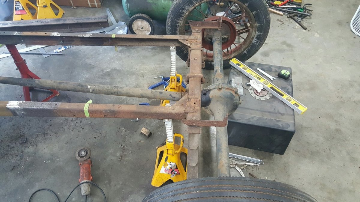

  10. After leveling the Warford, I hooked up the torque tube assembly. Well when you add a Warford something needs to change. In this case, the axle/torque tube assembly gets shoved back. Now the axle with leaf spring are out past the frame. 20160719_190736_resized.jpg 20160719_190745_resized.jpg 20160720_175436_resized.jpg 20160720_175446_resized.jpg

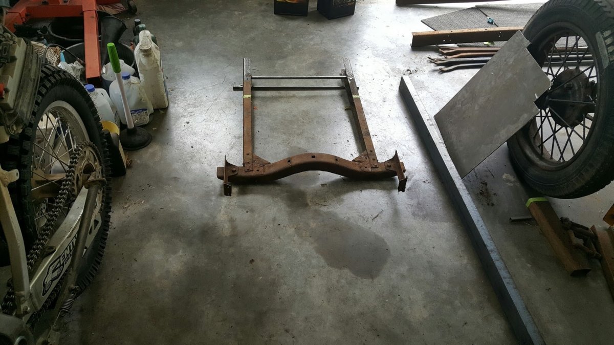

  11. What better way to fix that than stretch the frame. Seems a lot easier than cutting down the torque tube, driveline, and radius arms.
    In the final picture one will notice that the leaf spring is back in its pocket, however the axle is still sticking out past the cross member. More to come on that later. 20160720_175501_resized.jpg 20160729_195719_resized.jpg 20160731_112451_resized.jpg 20160731_112446_resized.jpg 20160731_164942_resized.jpg

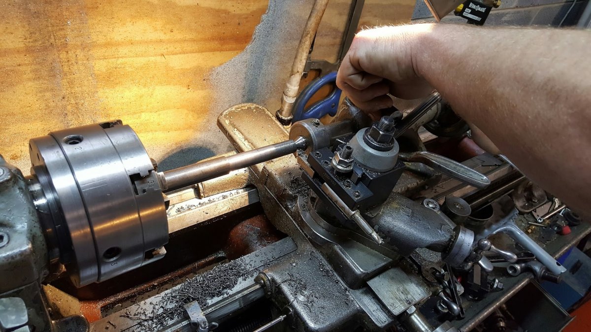

    Second picture, grab a chunk of rod and throw it the lathe.
    Third picture shows factory Ford spring hanger with aluminum race/sleeve/inserts (easily replaced when worn out), with rod that was turned in the lathe.

  17. Shackle time. Back to the lathe. 20161107_112618_resized.jpg 20161107_121734_resized.jpg 20161109_202730_resized.jpg 20161109_214429_resized.jpg
