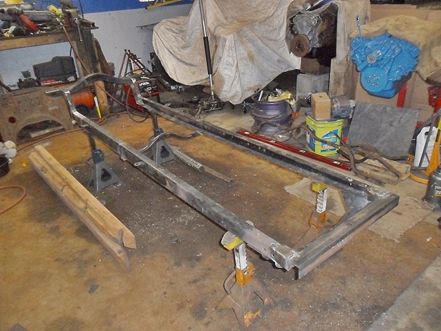

    I think the last major chassis work is putting on the wishbone brackets. I don't have a engine/trans yet, the "plan" was to build a new one for my stock T and take that one and put it in this. For those of you unfamiliar with T engines, the engine/trans are basically one unit that share the same "pan" (sitting in the chassis). So it's not just a matter of building an engine, its the whole package = EXPENSIVE to do right. But maybe I'll get lucky and pick up a used one along the way. For now, I just want to complete the rolling chassis.
    The weather is starting to turn, so soon enough I'll be couped up in the house where it's warm, and can work on the rewooding of the body--will probably start that around December.

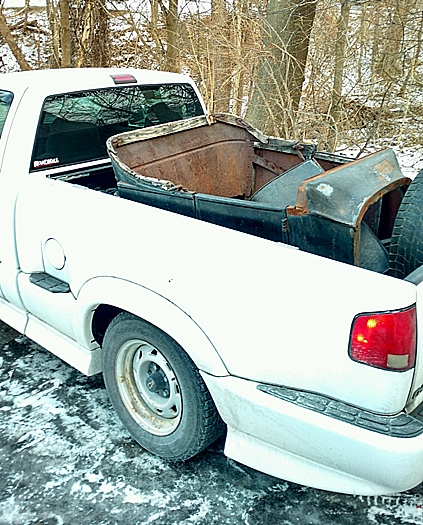

    Oh boy, Oh boy, winter is here. I am totally unprepared, and assumed I would have at least through Thanksgiving to get ready. Ahh, such is the great northeast.
    Today I had off from work, so I seized the opportunity to get out before the temps are expected to plummet and more snow drives in tomorrow. It was a comfortable 40 with no wind today, so I managed to get a nagging project done.
    I retrieved the '24 cut off touring body from out back and brought it up to the garage. What I needed to do was separate all of it so I could remake the new wood structure. Now mind you I am what I would call a "rough work" wood worker---you know, building things with 2 x 4's and plywood and such like that. I have actually done some finer work--mostly trim stuff, and one fireplace mantle under my belt for a friend, but I am no cabinet maker by any stretch. So this will be a journey for sure. I own a table saw, a band saw, sanders and a router, so I think I can make this happen. As wanting to keep true to the period, and being a Model T guy, there is no substitute going to happen here for the wood. I have also purchased two pieces of 8/4 x 10 feet long Ash boards to use and a set of body wood plans.
    I took a whole bunch of pics for reference of how the heck this stuff is supposed to go back together, as well as hold onto the original screws that I could save so I can purchase similar new stuff (Slotted head screws of course). Being this has been sitting out side and it has been a extremely wet year, all the old wood was super soft and was hard to keep from disintegrating at the various spots I needed to dissect. All of it is now in my basement for some of those cold winter days when I want to do something but don't feel like firing the kerosene torpedo heater up in the garage and waiting 4 hours to get to a comfortable temp.
