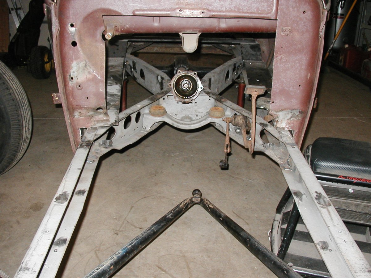

  8. Sorry I don't have a Video for you. These photos have been around here several years now. This is a 36 X member, pretty much same as 39. I didn't let the tranny mount dictate where I mounted the X unit. I mounted my Body and positioned the pedals in relation to the floor/firewall. I also used a 39 pedal unit, non split front bones and closed drive. Kind of the same as Aaron D only different.
    The Wizzard
    Aaron D. likes this.
