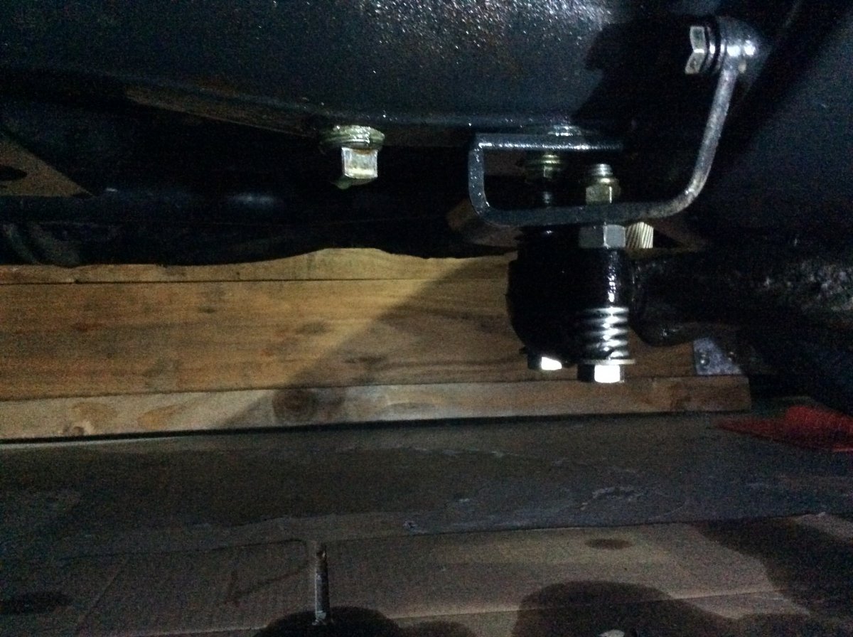

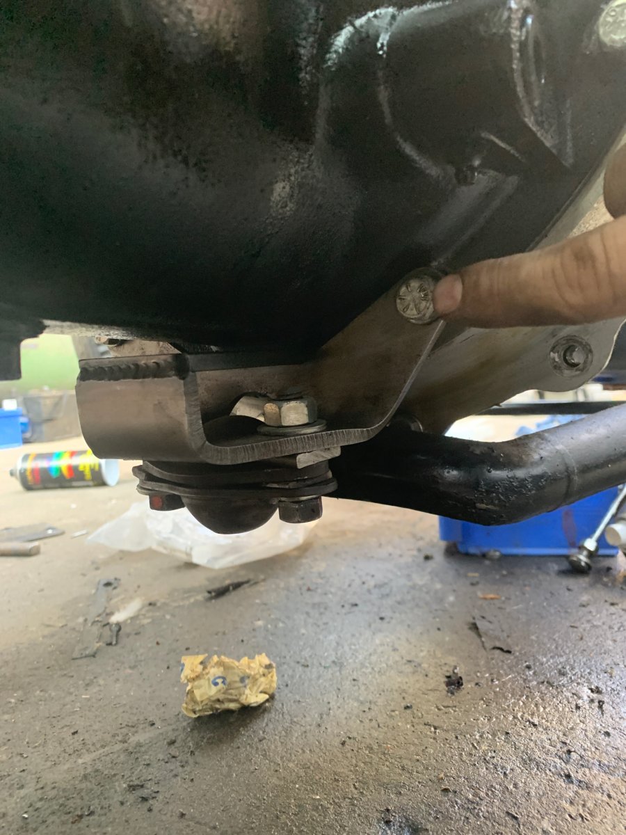

  1. Hi guys, is it just me ? Looks scary to me, if i hit the brakes the whole weight of the car is on this two tiney bolts? How did you fix this problem? Because of the law in switzerland i can’t split the bones:( 61093D85-C2A1-4100-BE1C-724557A8759C.jpg

  2. Are you running a torque tube?

    Should be adequate. I see you have grade 8 bolts.

    Id run it without a second thought.

    that wishbone was designed to absorb bump impact but also when you are going 60mph and stomp the brakes the wheels want to stop and the car doesn't... lots of stress when you have to lock them up...
    I see you are bolting through the bell housing bolt holes,
    IMO they are not that strong... science guys to the front...

    I agree with you, I would make a mount that spreads across the frame.

    On a model A the transmission is the wishbone mount so its not that far removed from what was there. Fuck it if your not comfortable with it change it. Can't enjoy a car you dont have faith in.

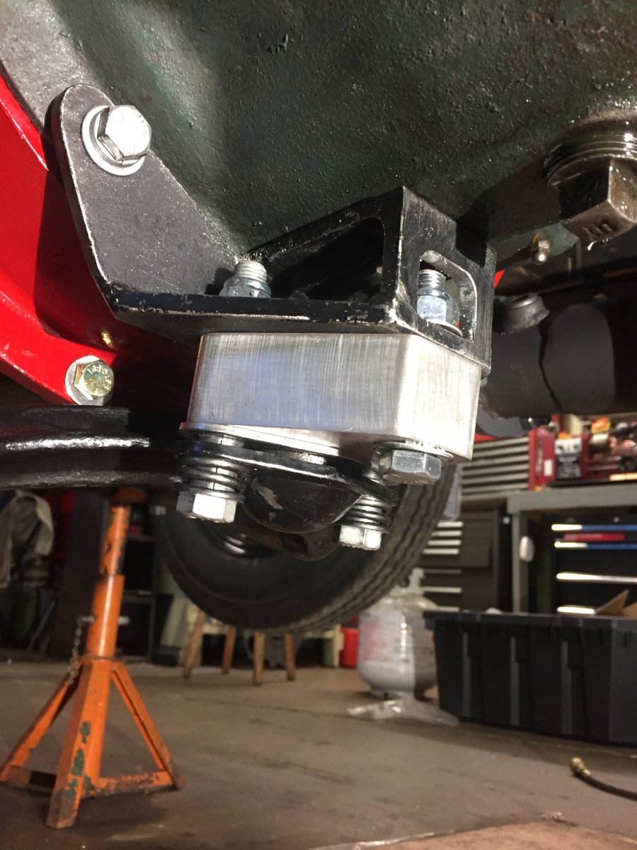

  16. Need springs on those bolts so the ball can float lightly . Going by memory I thought I drilled a third hole for a third bolt
    I try to check my AV8
  17. Yep your missy the center third bolt F71F64C1-B500-470E-B035-F70340284D3F.jpeg
    Nailhead A-V8 and tb33anda3rd like this.

    when you are braking the wishbone force at the ball is going up towards the transmission. I would think if you could modify the bolt on support such that it rests against the bottom of the transmission would improve the mounting. To carry it further if you extended the mounting brack to the rear and added a couple of additional mounting points at the rear of the transmission (rear torque tube / u joint bracket?) you would eliminate the bending that can occur with the current mount, since you have a bending moment occurring from the flange of the transmission to the centre of the wishbone ball.

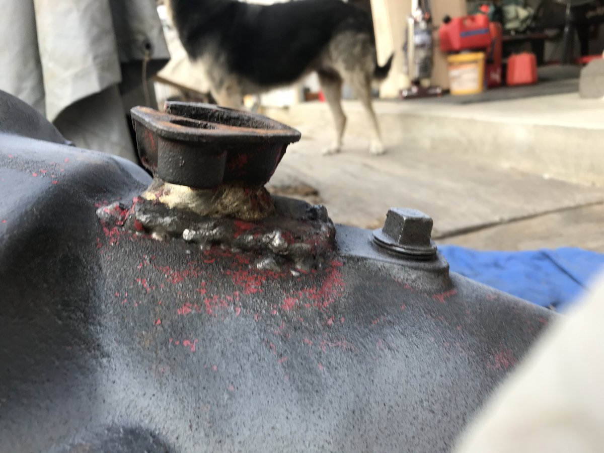

    Street is neat....shows a picture on how your mount should be installed ! The grade 8 bolt UP through the bottom of bell is strong/clean install. Your problem at this time, is that you have to MARK HOLE location now while you have adaptor properly located.
    Then trans has to be removed to place thru bolt once hole is drilled. I use a self locking nut withred locktite and cotter ...if you like.
    You may have to shim adaptor with a Large washer to level !
    There is one other way that this can be done. If picture comes thru, it will show a trans with adaptor WELDED and BRAZED in place.
    I have this frankentrans now. It has ‘32 rear mount; ‘39 gears; 3” fork and adaptor welded. Good ole American genuity !
    Dont know what case is ? NUMBER: 68-7222 ?

    Tune in Guys: 51... has it and Street... nailed it with a picture. Such brackets have been around for ages with bolts from two angles. Quite common to find the hole through the bottom of the trans already drilled. Home brew brackets may not have the third bolt without a clue. Good Luck: Fred A

    You’re missing the third bolt for that bracket.
    See pic.

  23. As @4bangerbob mentioned, as you brake, the wishbone yoke is pressed up into the transmission.
    At no point is the whole weight of the car on that point. The weight is carried by the front and rear springs and weight is transmitted to the axle and tires.
    On a Model A setup, the wishbone ball is captured by two bolts and a cup into the bottom of the transmission. Doesn't look much different here.
