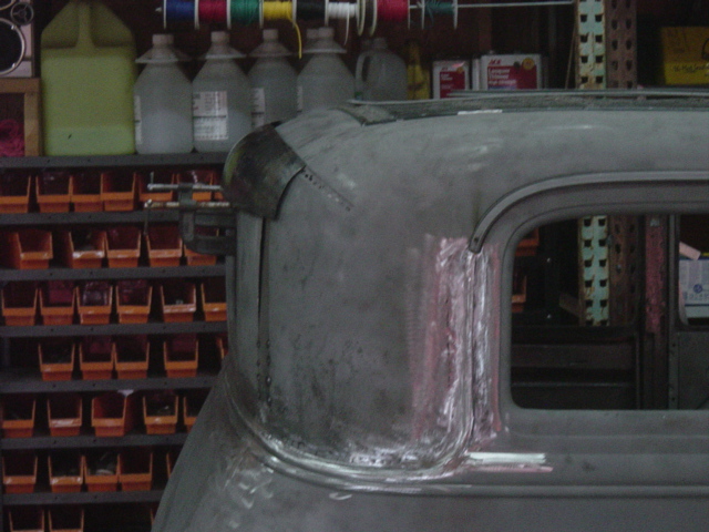

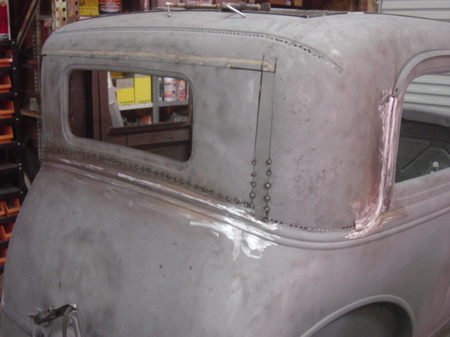

    This is a Model A Vicky that was changed from a leatherback to a steel top years ago.
    They used parts off another Model a to do it ( probably a 2Dr Sedan )
    And the new roofsection was dropped on top of the original metal and brazed all the way around.
    So there was lots of warp and big sections of overlapping metal...
    Which showed up once the bondo was blasted off.

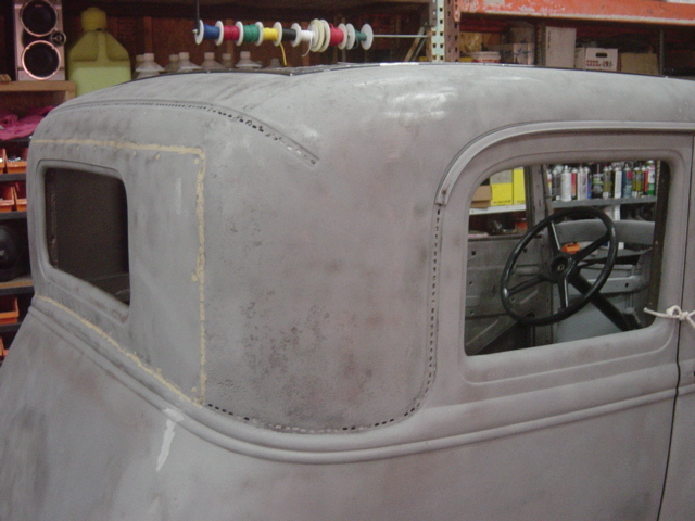

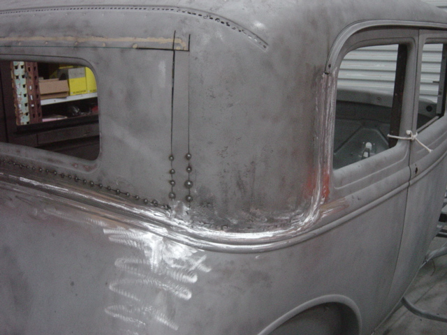

    The leatherbacks have perforated strips in the roof to attach the material.
    These strips are recessed too.
    These were bondo'd over as well.
    So I started by making a template, going by pics of restored cars.
    The tin tops have a beadline behind the 1/4 window that the leatherback doesnt have.
    So I made a piece with that beadline in it.
    Cut the old metal away.
    Anw welded in the new.
    ( I mixed pics from the left and right side of the car, because I used the pics that were the most clear...)

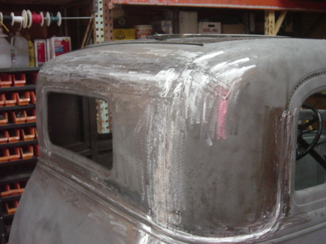

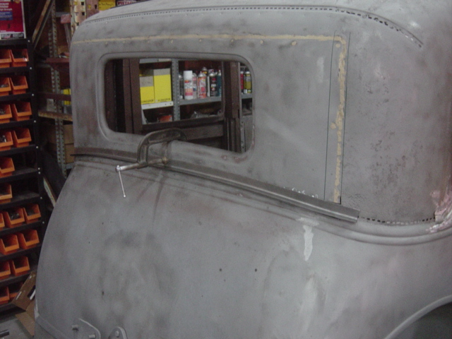

    To get rid of the brazing, I started with the lower edge.
    This is the piece that came out.
  4. metalshapes
    Joined: Nov 18, 2002
    Posts: 11,138
    metalshapes
    A new piece made ( it tapers and curves in two directions, and is almost 4' long )
    Partially welded in and ground down.
    And some more perforations gone.

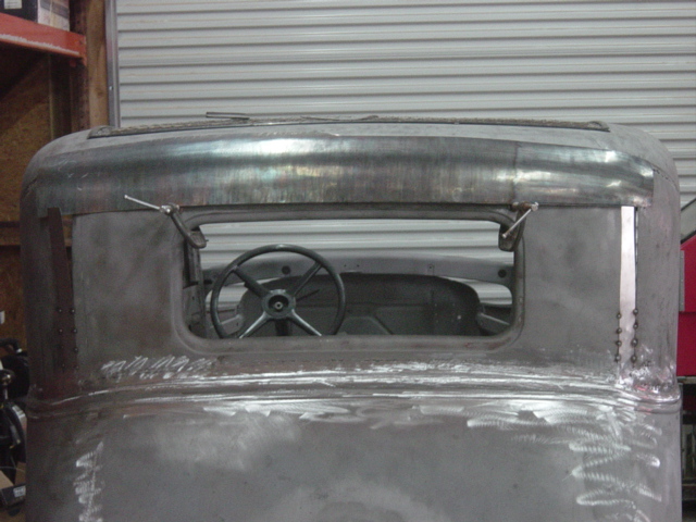

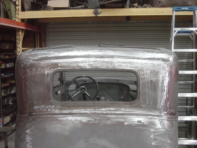

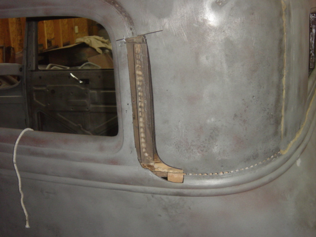

    The strips at the sides of the rear window were just two pieces with a little bit of curve in it.
    But the top was harder...
    There was a lot of warp from the brazing, and I also had to get rid of the perforated strip.
    So I made a new piece for that.

    Welded in and ground down...

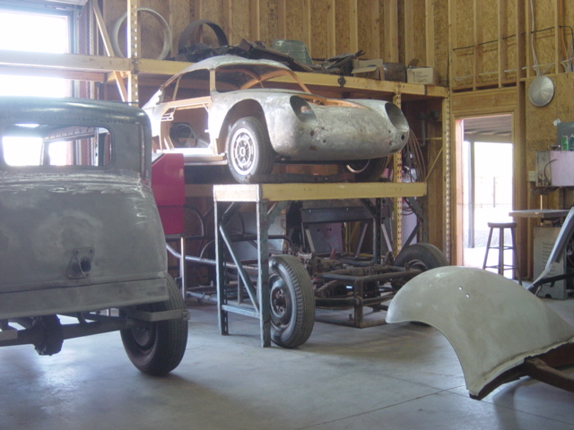

    Serious cool, any more shots of progress on the Zagoto in the background?:)
    " Do not reach greedily for the Kool-Aid ''
  16. metalshapes
    Posts: 11,138
    metalshapes
    Work on the Zagato has stopped for a bit.
    Thats why I put it where it is, with my Special under it.
    When I start working on it again, I'll post updated on this thread.

  20. That piece under the window is not as easy as it looks. I had to do mine up to and around the first detail line around the rear window.
    Are you planning on removing the perforations behind the rain gutters too?
  21. metalshapes
    Posts: 11,138
    metalshapes
    Havent decided on that yet...
    I'll ask the owner what he wants done.
