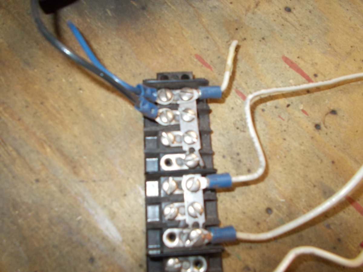

    I see you made 3 jumper wires to make connectors for wiring,
    my local electrical equipment supplier had thin steel jumpers that screw into the neutral block,
    making [4] hot connection with [1] jumper,
    I used [4] of them and that made connections for all my acc. wires... about $1 apiece...
    pix are not my wiring just scraps from the box...
    posted this in case it helps a builder add a wire with out surgery...HIH.
    .owner snapped off the barriers between connections and ran them lengthwise... [4] for acc. [3] for on... [2] for hot...
    .I screwed the jumper widthwise to show how you can add a jumper and it lets you screw down 2 connections and slide in another...
    .if needed you can run [2] jumpers, point one in each direction, same [2] screws, with a slide on connector on each side... screws are long enough...
