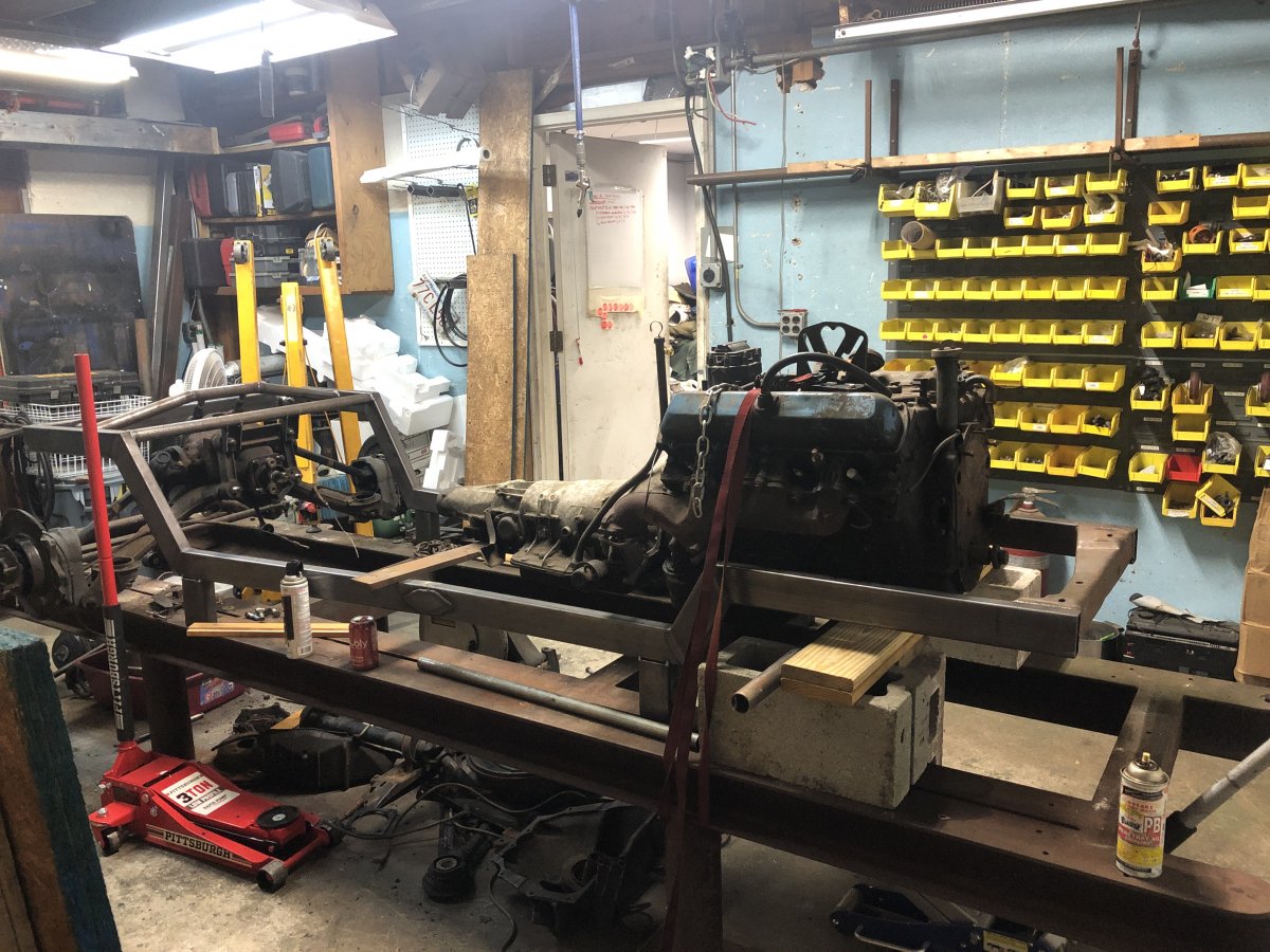

    Hi all,
    Long time lurker. I have begun a custom scratch build of a 1928-1931 tudor sedan. I have the perimeter frame built, rear axle mounted, engine sitting in it's location I think. I am trying to locate the motor front to back(455 Olds). What has me stumped is that I do not know far back the front of the stock firewall is back from the center of the radiator mounting holes(that is my front reference for now). I see all of the overall pictures of body dimensions in reference to wheel centerlines, but none that I have found have refence to firewall and wheel centerlines. I hope I explained this well enough.
    Thanks,
    Matt

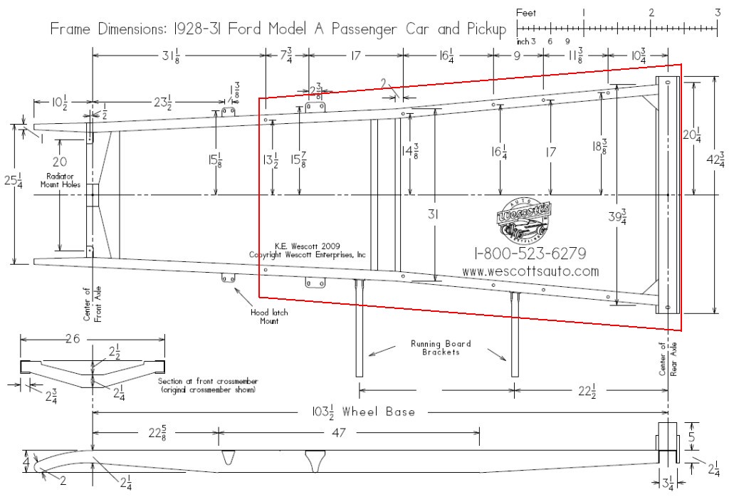

    Model A Gomez
    I copied Wescotts Model A frame drawing, 28-31 bodies will all fit. All Models have a 103" wheelbase, the axles are straight under the crossmembers. There is a bolt just inside the cowl an all years and it is the first hole in the top of the frame, 31 1/8" from the center of the radiator mounting hole. The firewall is ahead of the mounting hole, the picture is a 30 with a stock firewall, hope this helps. View attachment 4804928 View attachment 4804929

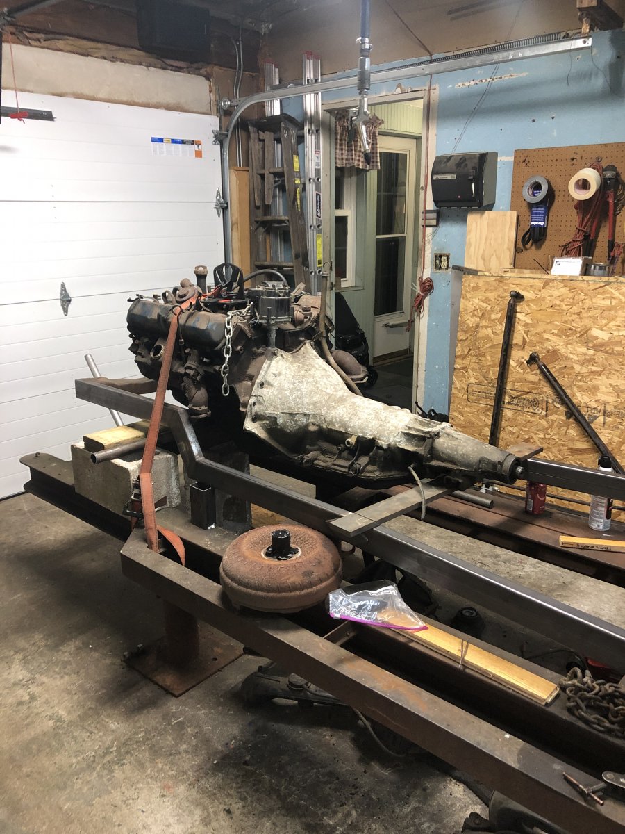

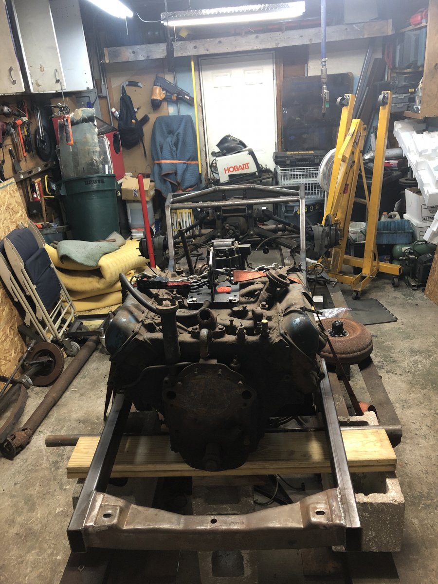

    Hi all,
    Thanks for the replies! Didn't expect so many this quickly! I attached/uploaded pictures of the build. They are current as of last night.
    This is a custom designed frame that was built on top of the old Total Performance Model A frame jigs(friends with one of their former welders). I know that the front and rear cross members are located correctly and that the rear is located correctly from the front mount as shown in Gomez's dimensional picture. I just was wondering if anyone could tell me the tape measure reading from the front of the stock firewall position to the hole used to mount the radiator. I don't have access to the old jig or paperwork from TP.
    I would go by what most are saying about mounting the body first, I just don't own one of those yet. I am trying to build as much as I can before I have a body. I only have a 1 car garage and am trying to be efficient with space. I am also doing it this way because of parts availability(I already had the frame and all of the other stuff has been given to me by friends).
    Thanks! Matt

    All,
    My main point of questioning myself comes from having a chassis that isn't conventional(6-1/2" kick in the front and 13" kick in the rear) compounded by a rather hefty motor. I'm just trying to get an idea as far as where the front edge of the cowl is in relation to the back end of the motor. It is currently set up with a tall-ish HEI distributor and seems like a tall motor. I just don't want the top of the valve covers/distributor to be sticking up through the cowl. The body is also going to be channeled by 3" and then chopped 5-1/2" to 6".

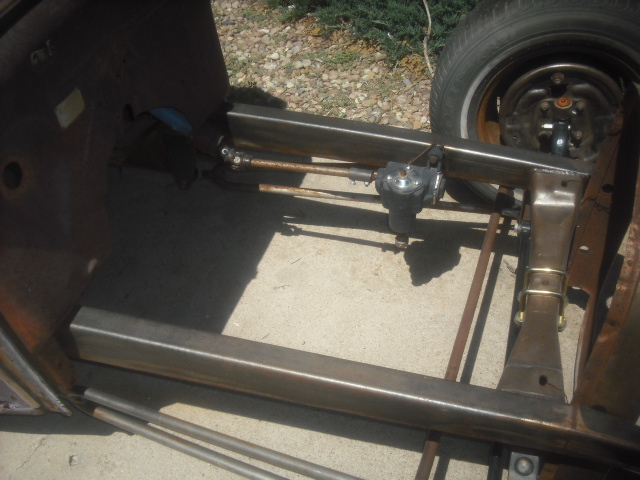

  17. panhead_pete
    Joined: Feb 22, 2006
    Posts: 3,487
    panhead_pete
    You didnt extend the wheel base at all when you built the frame? Just looking at your pics the Z in the front of the chassis seems well forward of where the cowl will land based on where the engine sits? On this frame here the Z is at the cowl so hidden.
