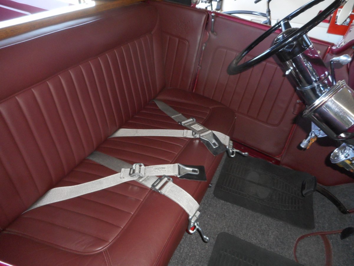

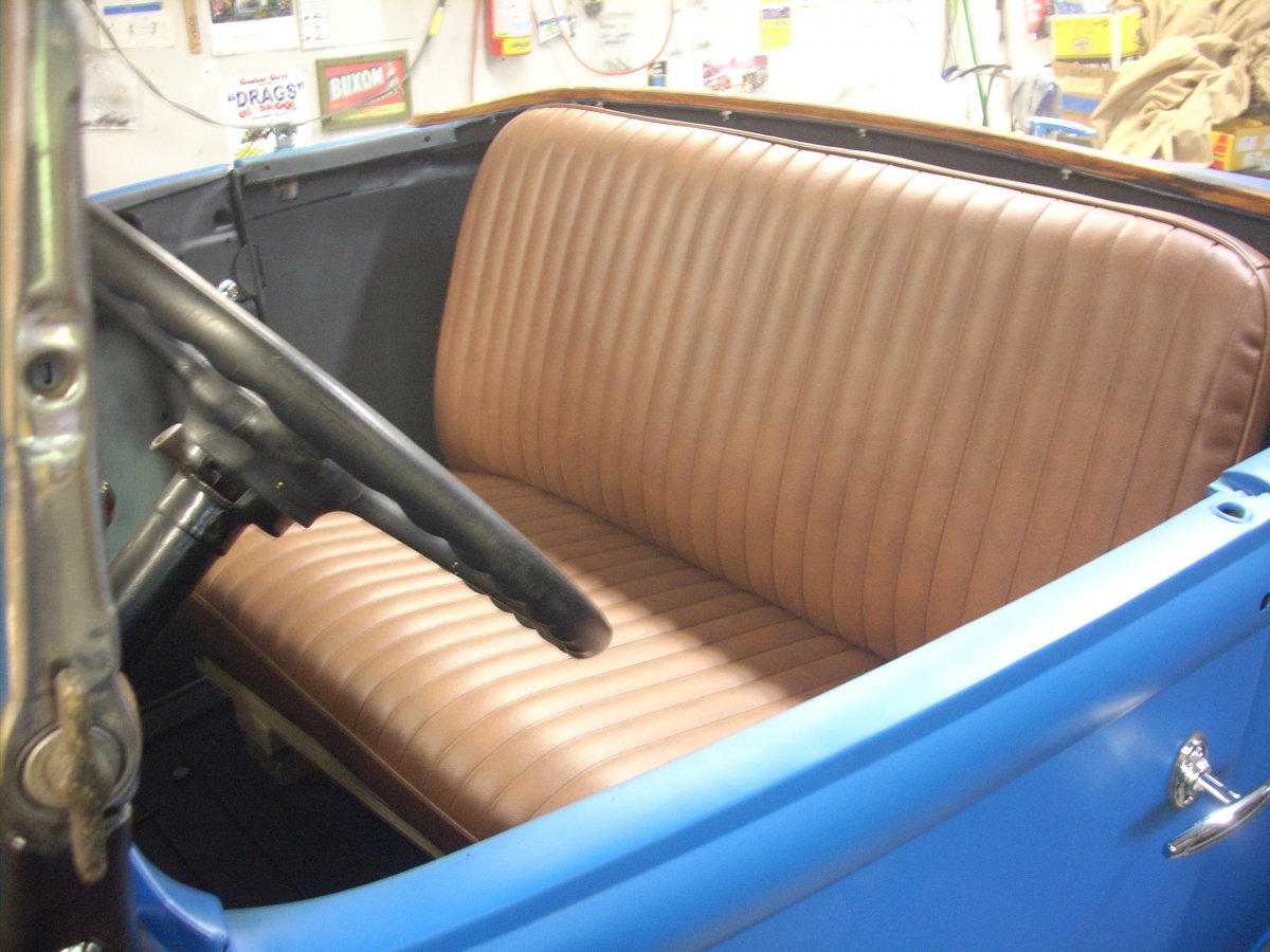

    Model A roadster pickups have precious little room to start with, and if you have any kind of firewall set back to accomodate a later V8 engine, it really gets cramped. I have a Dodge Caravan seat in my 30 Model A coupe, and it fits like it was made for the car, but I don't think it would be the best choice for the RPU. Like everyone's been saying, a fabricated seat made from plywood and foam is the way to go, whether you use the stock seat riser or cut the stock one out as mine is and fabricate a shorter one. By doing a fabricated seat, you can better fit it so that it fills up all the space between the sides of the cab for a more finished look without costing you any interior space that you really need. Any upholstery shop should be able to come up with a plywood base and the foam, as others have suggested. Here're pictures of the interior in my 29 RPU. The seat is pretty minimal, and interior space is still tight. 7-27-16 Pickup 007.JPG 7-27-16 Pickup 006.JPG 7-27-16 Pickup 007.JPG 7-27-16 Pickup 006.JPG vintage Ford 015.JPG vintage Ford 015.JPG

  15. Craig Owens
    Joined: Jun 28, 2006
    Posts: 464
    Craig Owens
    The seat belts are from Rich Design...you'll have to do an internet search, but they use vintage hardware and new belt webbing. Very nice belts...expensive, but nice. Here's what my truck looks like now. Incidentally, after seeing the picture someone posted of a Caravan seat in a roadster pickup, I have to admit, it is a good fit. Fred's 12-21-16 004.JPG IMG_20160702_160615104_HDR.jpg IMG_20160702_160724052.jpg

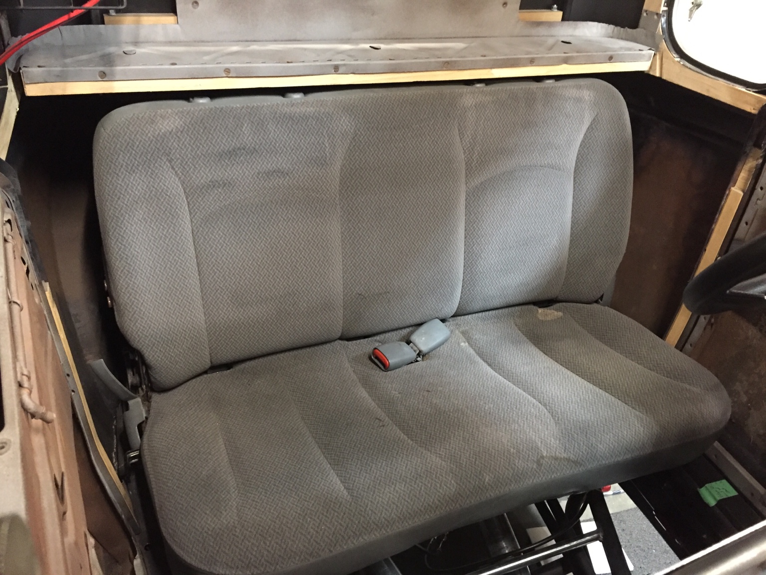

  19. Fitnessguy
    Joined: Sep 28, 2015
    Posts: 2,020
    Fitnessguy
    [​IMG][​IMG]
    Mine is a 2000 caravan middle seat as mentioned. Yes the seat folds down. I had to cut the folding handle down and re weld as it was tight against the body. Fits perfect in my opinion. Try and get a seat that the foam is in good shape on like this one as it will be easy to get recovered.
    Dino 64 likes this.
