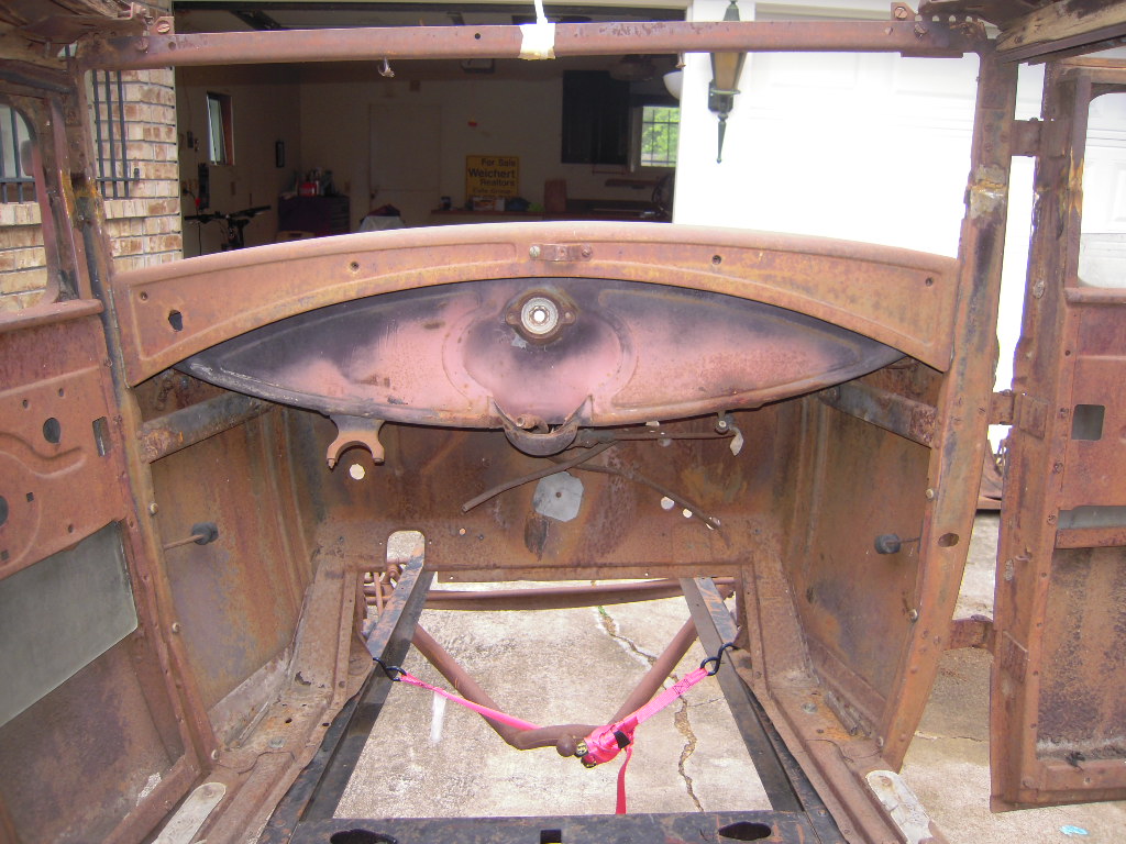

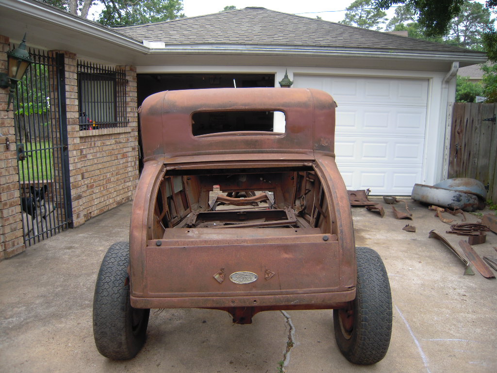

    Hello everyone. My name is Chris and I've had a acct since 2013, I've got on here for some research or hard to find answers to the many ,many, many questions I've asked myself since I drove to Valdosta Georgia to get that ol' rust bucket, but unfortunately haven't posted or commented on anything. Of course entirely my fault, but I have good reason, I hope........ I always dreamed of one day having a old hot rod I could call my own. On May 5th 2013 it became a reality. Well, kinda. DSCN0867.JPG DSCN2106.JPG

  3. Doesn't look too bad. My project is also my first. In my experience, do your research, be brave and jump in. Many things on my project are the first time for me and I haven't messed anything up too bad yet. Go for it!

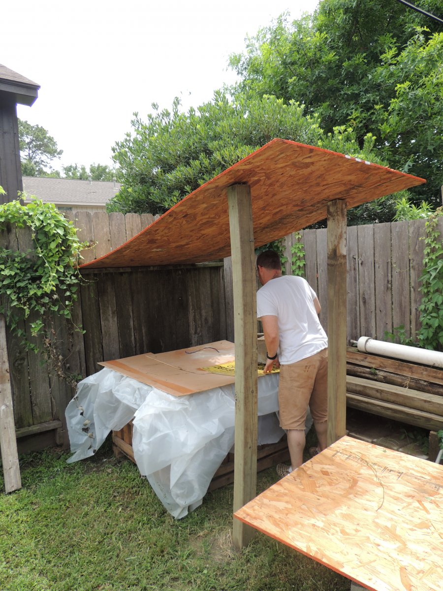

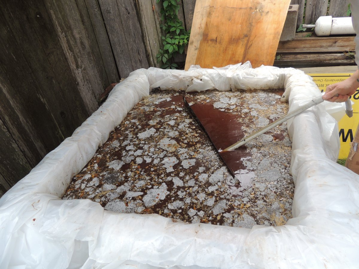

    When I first started researching methods for removing rust without damaging existing metal,m I can across the "The ol' Molasses trick..... It actually works! Well , it will only get for a few months( As long as you don't let rain water get into it),but you would be surprised at how well it stops rust.

    Oh, and if anyone wants to try it. Its 1 gallon of molasses to 10 gallons of water. Your local feed store should have all the molasses you should need.You really don't need the "store" stuff , which is for human consumption. Plus it would cost too much , especially if you have a 100 gallon tank like I did.

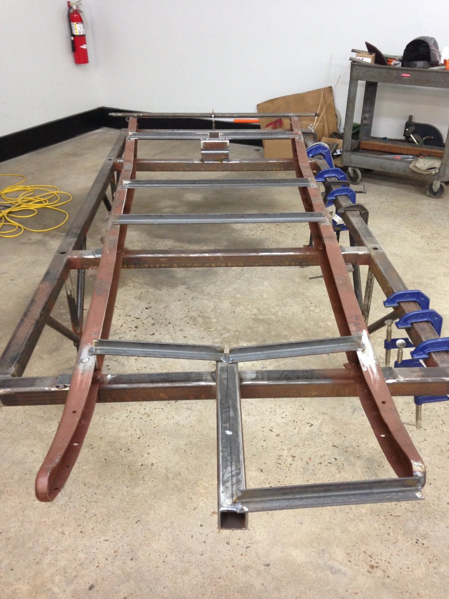

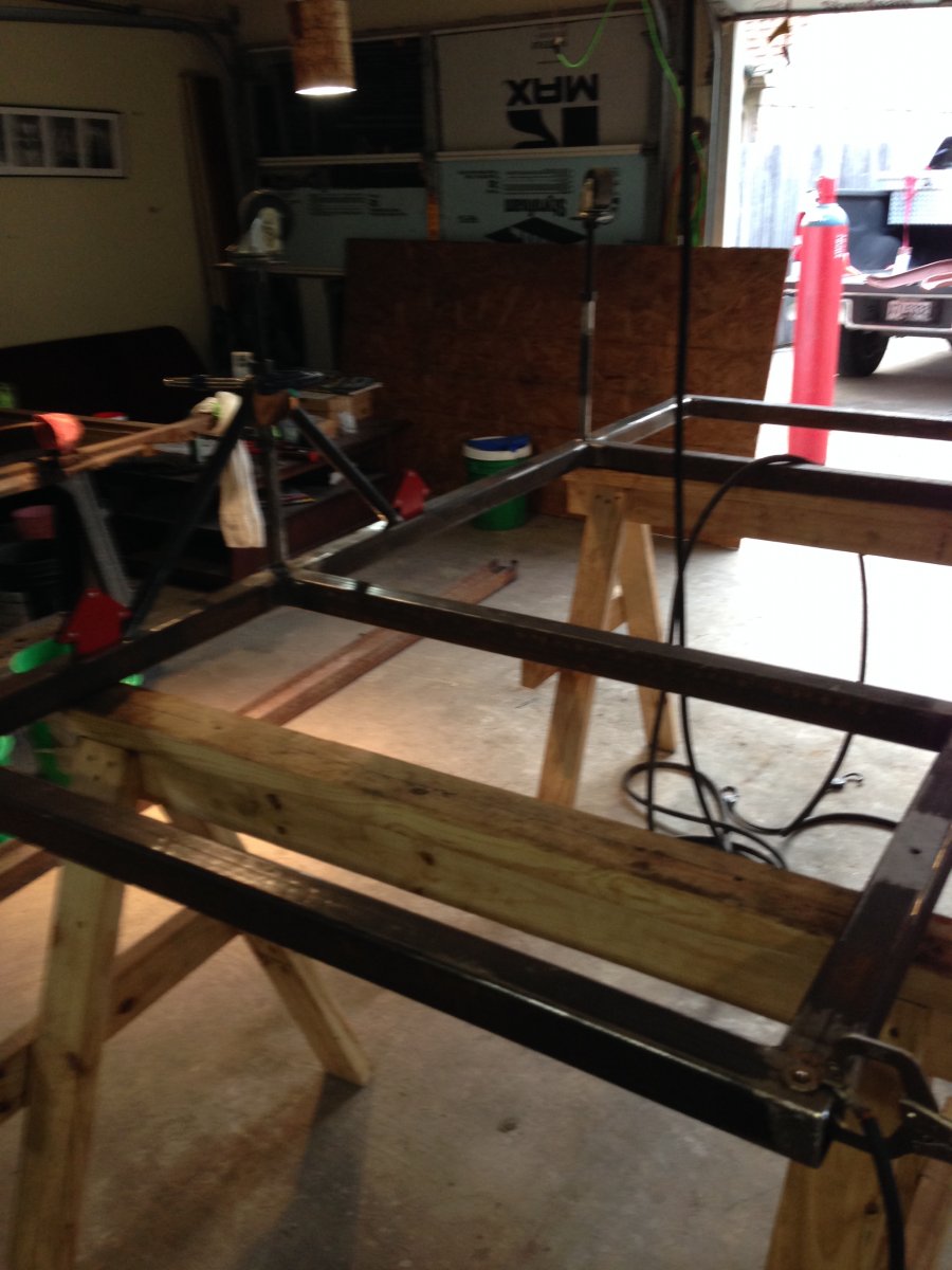

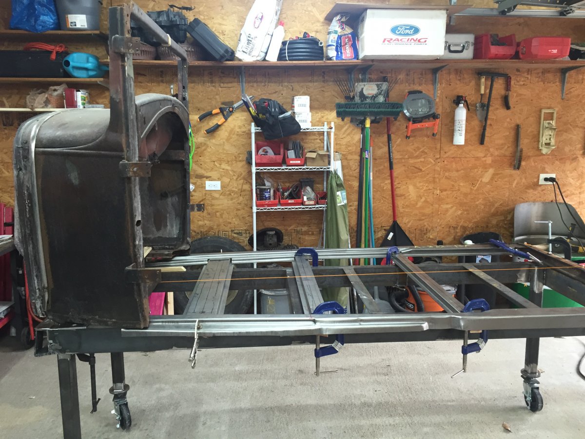

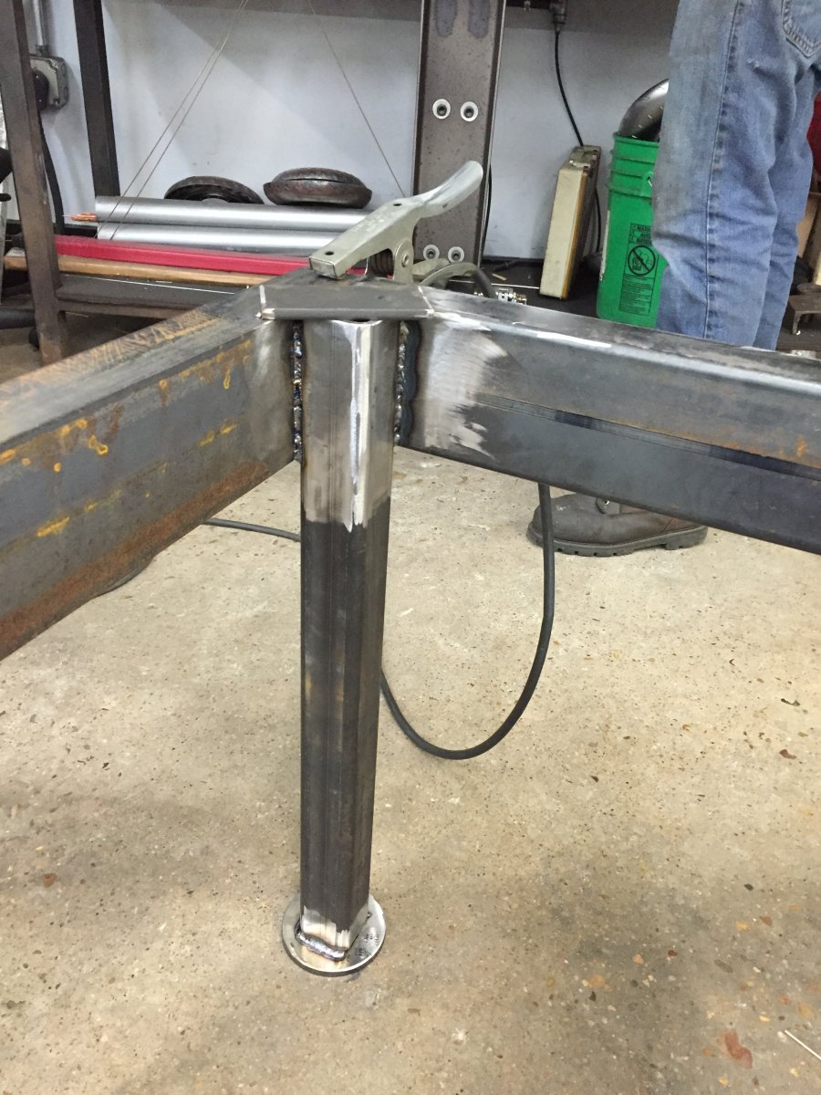

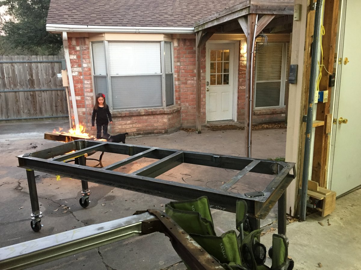

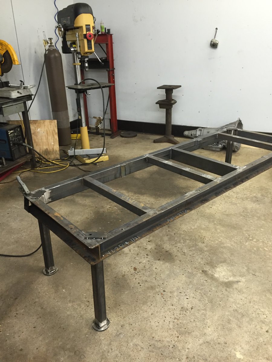

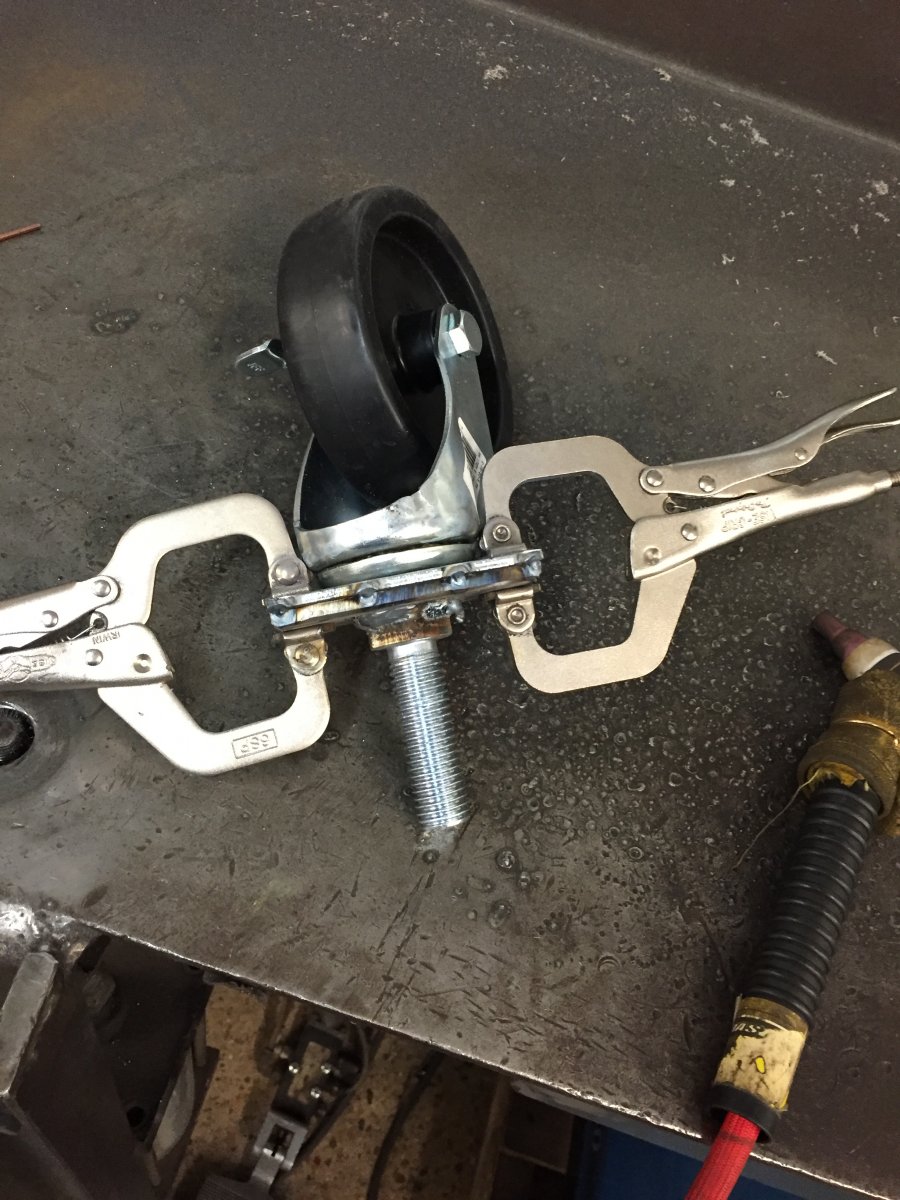

    This is from the jig I made of the frame. I had a second hand millermatic tig and no idea what I was doing.....Adjust-ability is key and not to make it too tall.(my first mistake)

    Looks good to me.I reckon you are doing fine.What are you going to use for an engine?

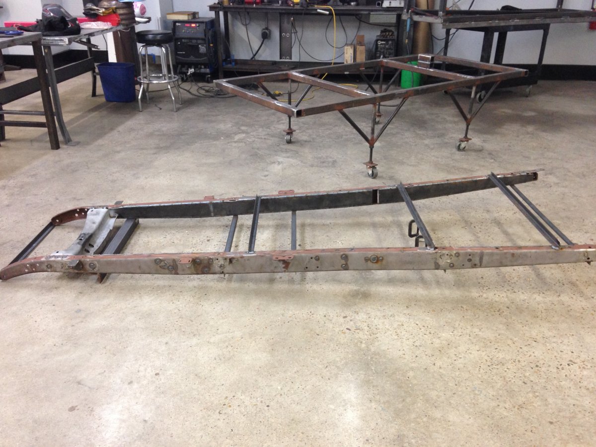

    I welded up the cracks on the front cross member and was going to reuse it, but changed my mind a little later. Of course after I welded it all in.....

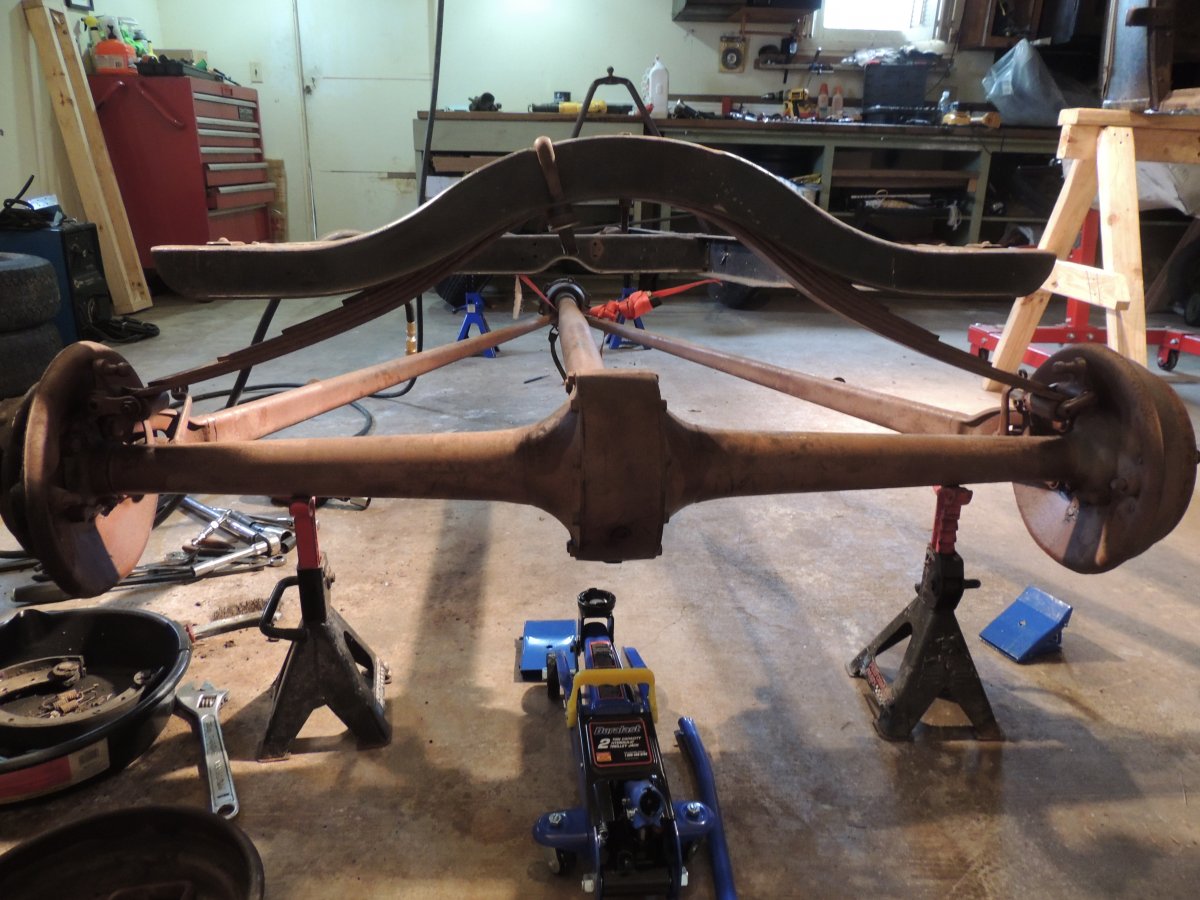

    Thank you Sir. Well got the fuel injected 4.6 mod motor. Dropped straight axle in the front. Took a 8.8 rear out of a junked explorer. Installing rear coil overs. Putting disc brakes all around. Still hashing out ride height for her, so really just have the stance in my head.

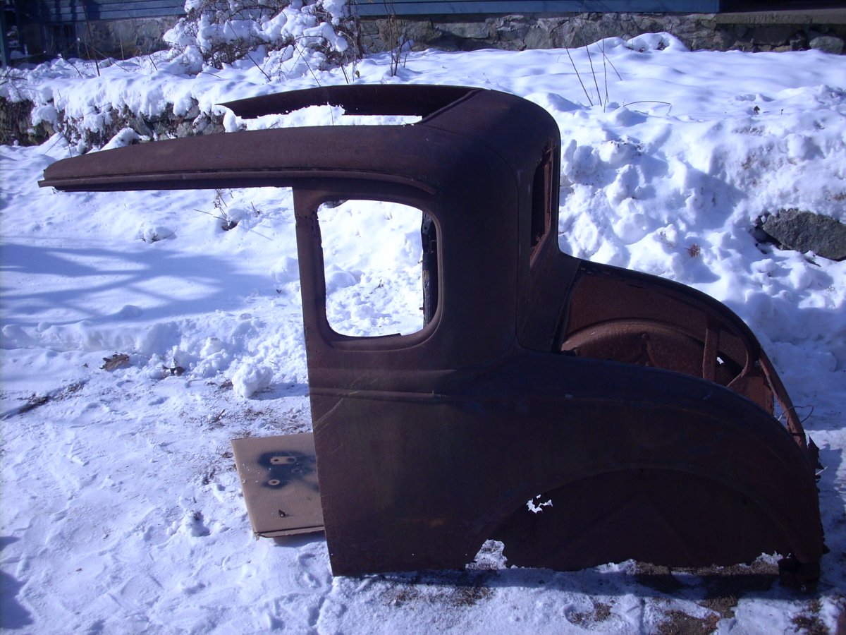

    Trying to get the body somewhat back together. Got to finish the rolling chassis too.
