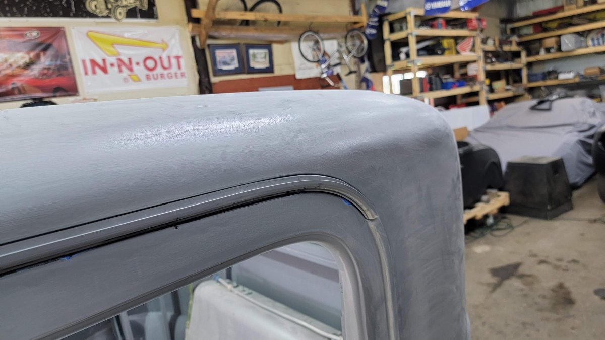

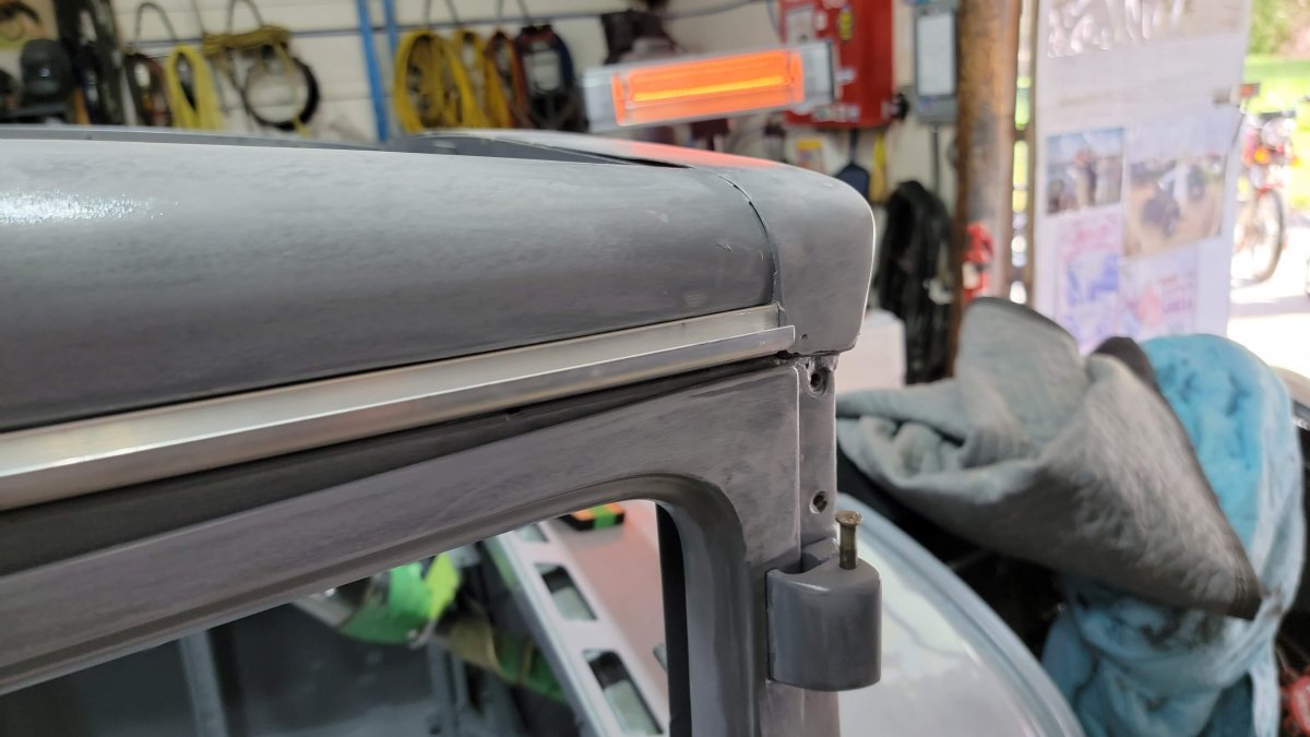

    I've been working on my Model A Tudor for about 8 years now. My Henry Ford body came with no rain gutters, so I've been trying to figure out how to fix that for about 5 years now.
    My Dad decided to just fill the grooves with Bondo (without telling me), that was never going to my way of doing it. So I wire wheeled the Bondo out and ordered me some new gutters.
    I got some aluminum (2 piece) gutters from Macs. Knowing myself, I ordered 4 sets, giving me 2 "kicks at the can" per side.
    I made up a wooden buck, mounted some metal channel to it and bent away. 20210326_104937.jpg

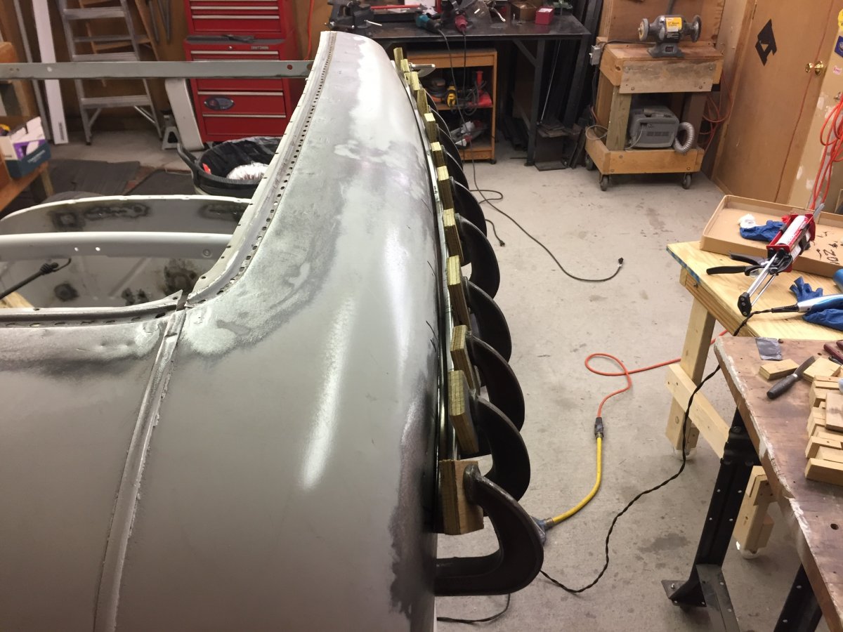

    The bigger problem now came trying to mount the inner piece onto the car with tiny nails, then somehow "pushing" the outer part onto the inner part. Long story short, it didn't go well...
    I let it sit over the winter and thought about a better solution. One day it came to me:
    Now I know this isn't the "traditional" way to do this, especially on a traditional car, but when I couldn't figure out another way to make wood, metal and aluminum work well together.

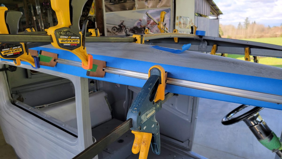

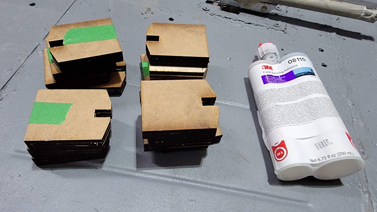

    I needed a way to apply pressure onto the rail without crushing it, after a bit of time on the computer I came up with a simple design that I cut on my laser engraver.

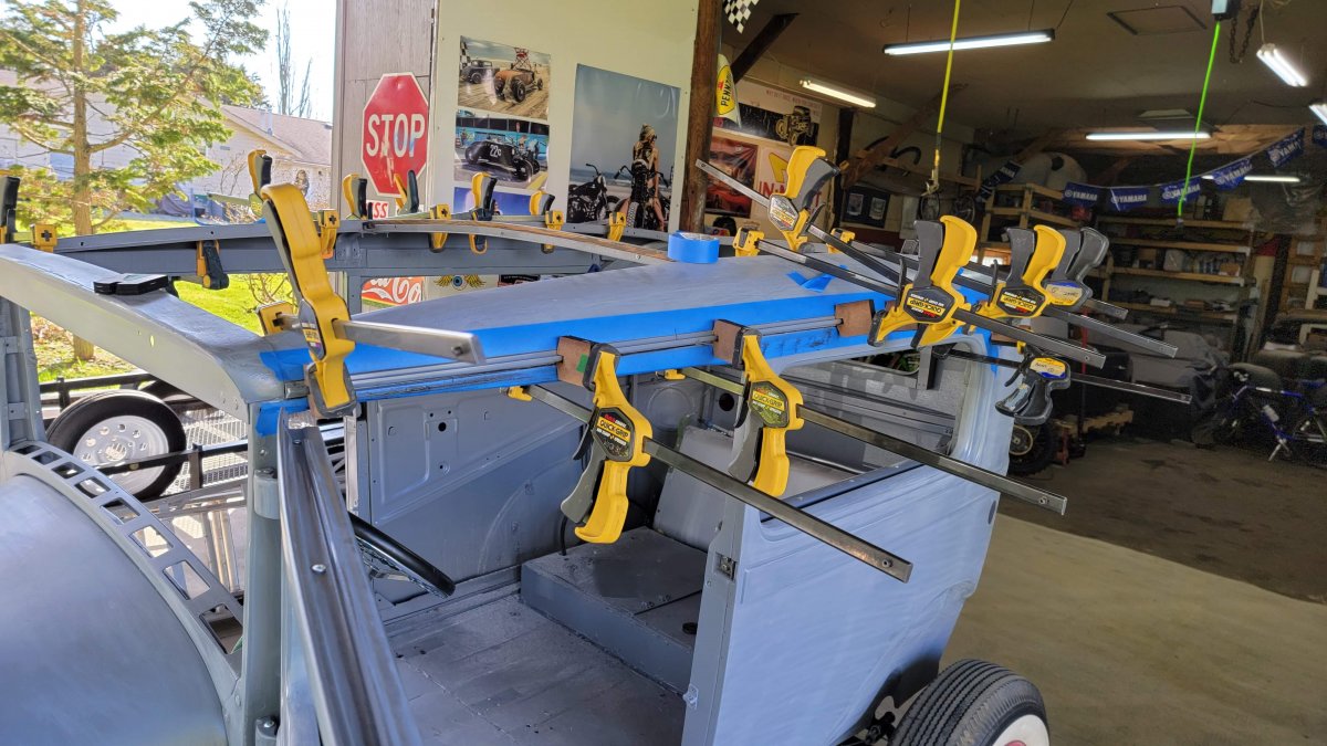

    Then I generously applied the panel adhesive to the backside of outside gutter piece (the inner piece is no longer needed) and borrowed about 18 clamps from friends and crossed my fingers.

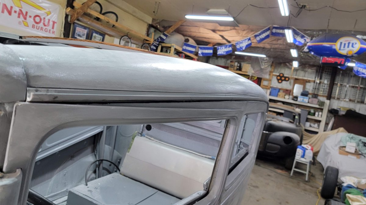

    After letting it sit all night, we took a deep breath and removed the clamps...
    It worked really well. I wish I had the idea 5 years ago, but in the end it was a really easy way of doing what everyone said was a "tough job". The 3M panel adhesive is used to put together high end cars, if it'll hold carbon fiber to aluminum on a 2020 Lambo, it should hold some aluminum onto some steel and wood on a 1929 Ford.

    THANK YOU! That solves a future problem I would have had. Bob

    Me too! My Morris Minor woody doesn’t have its drip rails either. I have one stick of Mac’s drip rail but I wasn’t sure how to make it work. The top skin is aluminum nailed to wood. Your solution may work for me as well, thanks for posting.

    Great solution...liquid weld...I worked in aviation and glues have replaced rivets to anchor parts on Aircraft so yeah it is certainly a viable option that looks factory fresh...
    It's not the first time it's been discussed here as It is widely used in modern body shops...
