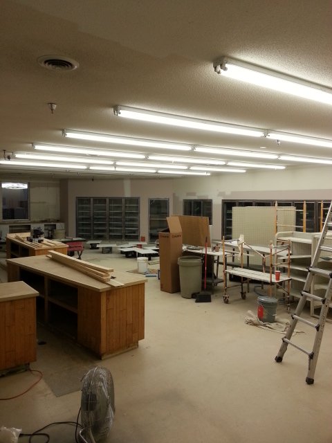

    Maybe...
    This has to be a fully stocked and functioning convenience store in 2 weeks. 1407463980526.jpg
